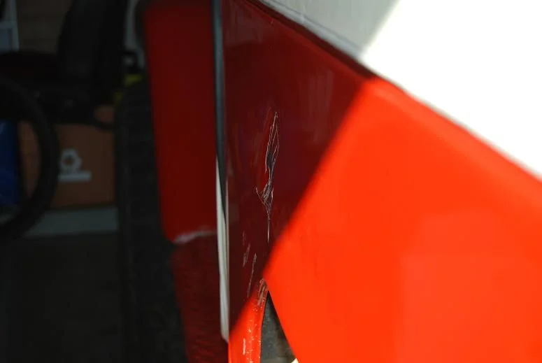

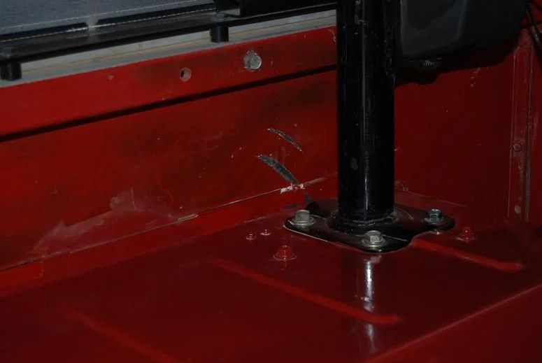

So my PO had all the fun with my 40 and now I am doing all the repairs....sound familiar??? Anyways, can anyone with some experience reccommend a good set of body repair hammers/tools? I am fortunate as almost all the dent/dings are easily gotten behind of, although the L Rear Q panel has a nice dent just lateral to where the roll bar is inside. Maybe a around the corner tool with a flat surface. I have actually used a block of wood from the inside and a rubber mallet to improve it somewhat but really need the right equip..................help! Pics enclosed
Due to the thickness of fj40 metal a torch helps alot, you can use a hammer and dolly, for some dents using off dolly technique works. Shrinking hammer doesn't work real well without heat. The dent you have is going to require some shrinking due to the metal being stretched right there.. google shrinking metal with a torch..
