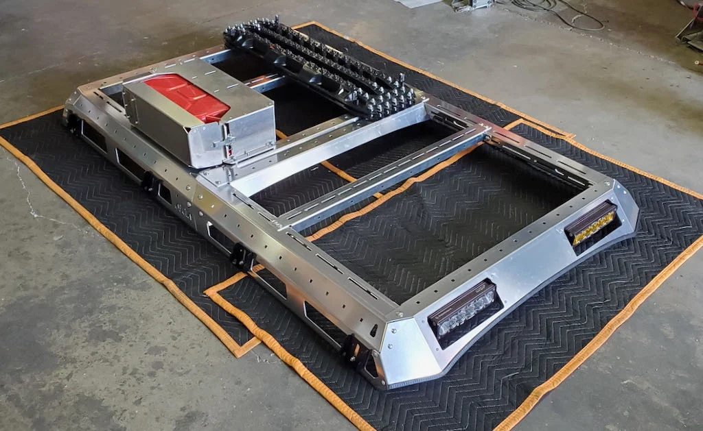

Design:

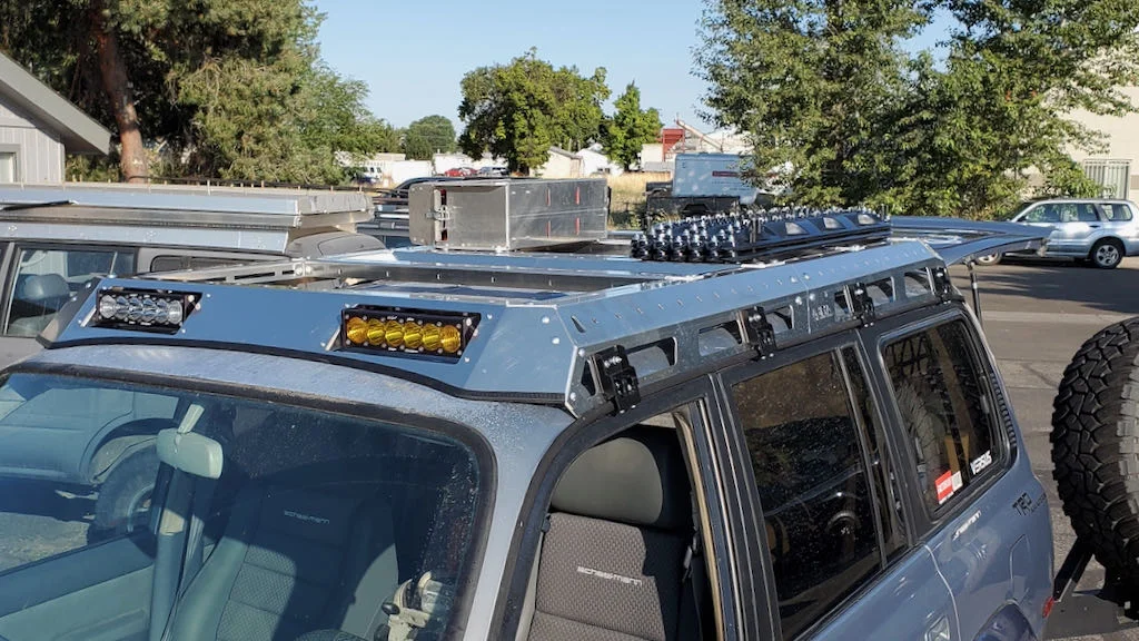

I was pleasantly surprised to see the production version of the rack have a very low profile design that I believe compliments the natural angles of the 80 roofline, but adds in a bit of modern flare…just like the delta bumpers that I have been running for years do. The rack definitely looks like it was designed specifically for the 80 vs other racks out there that are generic with just gutter rail brackets designed for the 80.
I have now had a Gamiviti, a Bowfin and now a Delta rack on my 80, and all have been great racks for me. The Gamiviti was a custom spec steel rack, the Bowfin and Delta are both production spec models. I have enjoyed all of the racks I have had, but I find the lines of the new Delta rack to be the most attractive of the 3…my opinion. As with most other Delta products, the use of carriage bolt slots are all over the rack on almost every face. This makes mounting items very easy with all the flexibility the design offers.
Another factor that may be important to some is the ability to run just the rear half rack, or the whole rack. I personally will be running the whole rack, but it’s a nice touch for those that may not need a full rack all of the time.
Weight:
One of the biggest differences I noticed right off the bat when comparing to other racks I have had or at least handled, was the weight. The Delta rack is only 44lbs including hardware, this is significantly lighter than any other full-size rack on the market. Putting the rack on was super easy to do, and as long as you have a step to step up onto the tailgate, it can by done single handed. A major plus for those that don’t have or like to call in favors to help with your truck.
Strength:
When you look at how the rack is designed it’s immediately apparent that this was designed to be structurally efficient. While the rack only weighs 30lbs, the way that 30lbs is engineered with compound structural bends is impressive. While we were at Expo, Dave climbed up on top and started to bounce in the middle of one crossbar on one foot with his full 250lbs. There was very little deflection at all. Knowing how much deflection there is/was on my other racks when being super careful with foot placement, let alone bouncing, was really impressive. Subsequent to that demonstration, I have been all over my rack mounting my awning and tent, and it doesn’t matter where you stand, the rack doesn’t move. It’s very very stout.
Awning:

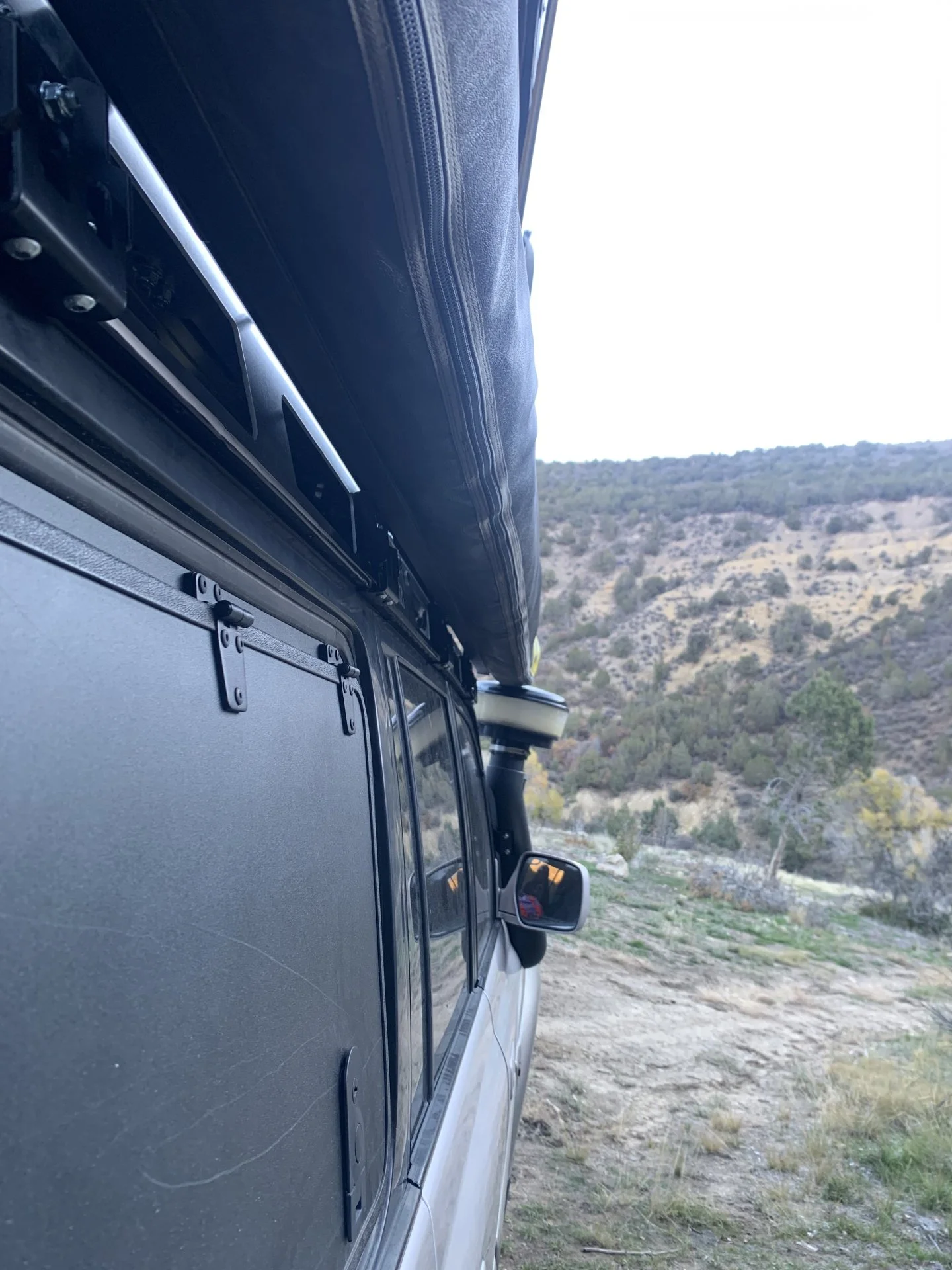

I have had an Eezi-Awn Bat 270 for the past 3-4 years, and it has now been mounted to three different racks. Delta is still working on their awning brackets, but I didn’t want to wait for those since I already had a set of brackets that I figured would work. I was able to mount up my awning nice and tight (about 1/2” clearance from the new tent passenger side). I am only using two mounts at the moment, which is a departure from the 3 that I typically use, but it it not moving or flexing at all…so don’t really see a need to add another bracket.
Roof Top Tent:

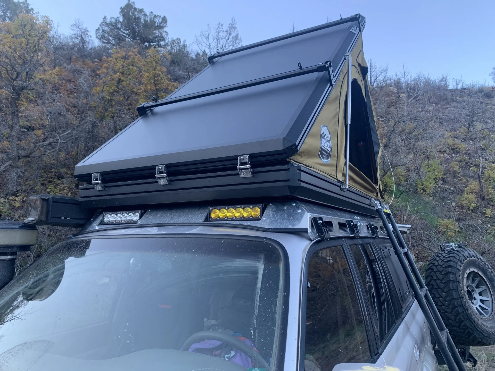

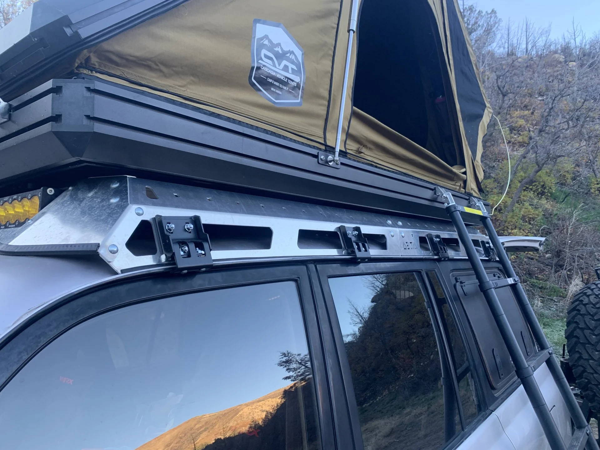

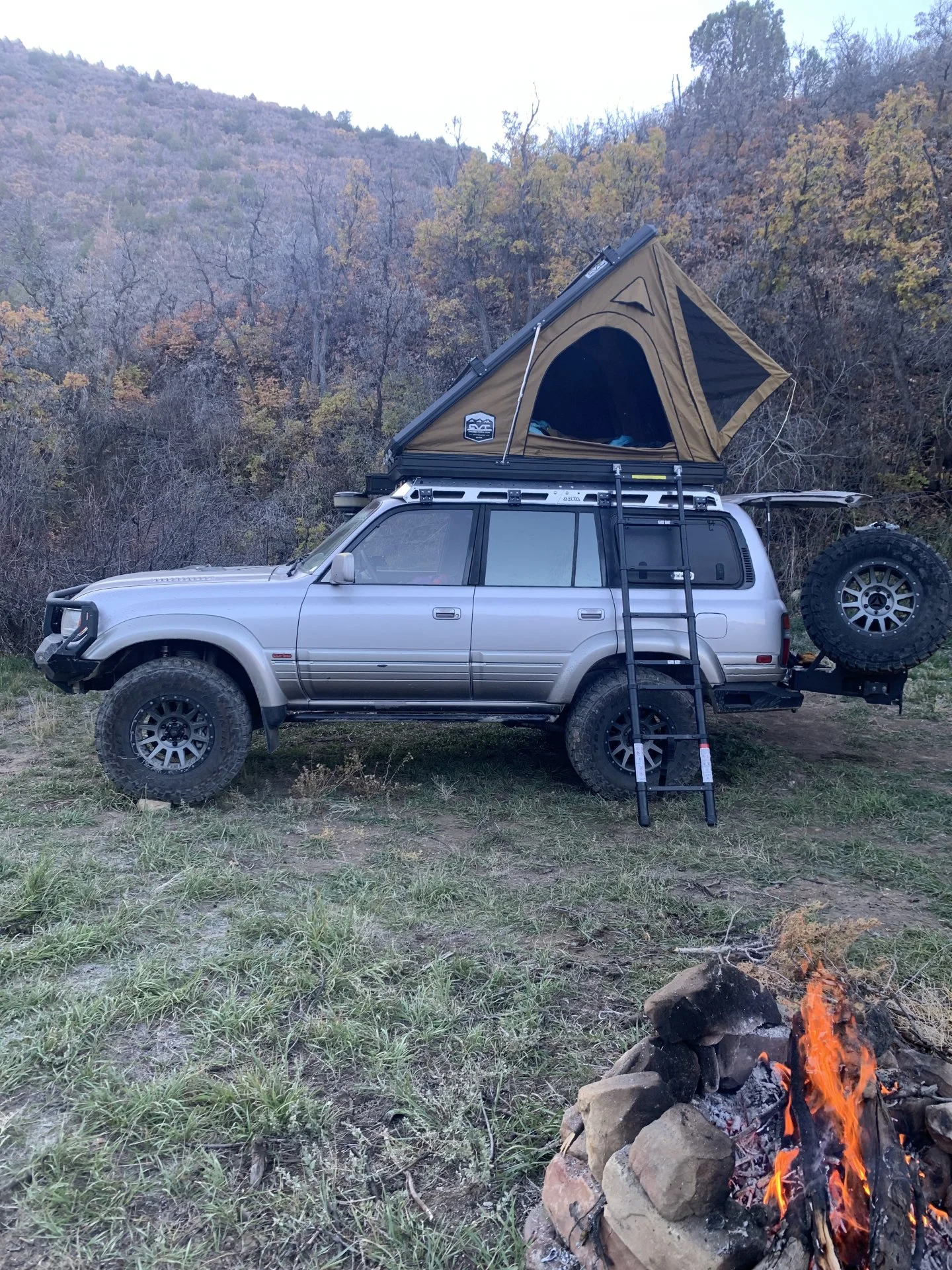

The modular design has already been very useful to me. After getting the rack I went on the hunt for a suitable RTT that would compliment the sleek rack design and not stick out the sides like a mini wing. I landed on a 50” CVT Mt Hood tent, and quickly got to work mounting it. I wanted the tent at low as possible, which is about 1/2” or less above the cross bars. With as low profile as the delta rack is, I knew it would be a challenge to get man sized hands underneath to fasten the tent. Instead, I unbolted two cross-bars (there are 8 3/8” carriage bolts per cross-bar), measured and bolted those bars to the tent on the ground and then lifted the tent with pre-installed cross bars up as one unit, dropped it into place and put the bolts back in. Those bolts are all accessible from the side and sunroof making it super easy. If I were to do it again I wouldn’t bother removing the front cross bar as you can bolt on the tent hardware through the sunroof very easily.
This weekend I got the family out into the mountains to go camping, and everyone was up and down the ladder all day. Zero creaks or rattles whatsoever. I am thoroughly impressed with yet another awesome Delta product.

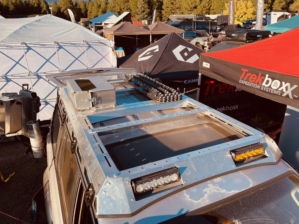

This might be a giant PITA but is there any way you could post up some pictures of just the rack without the tent mounted? This is by no means a pressing request, as I already have a roof rack....oh, who am I kidding, this is MUD and we all want to see it. Pictures, man. Moar pitchers! :bounce: :hillbilly:

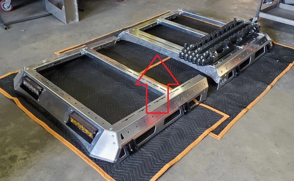

Anybody have a pic of just the half rear rack installed? I'm wondering if you order the half unit what the front facing looks like?

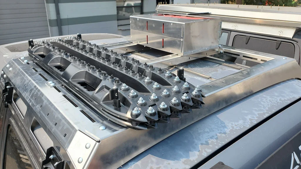

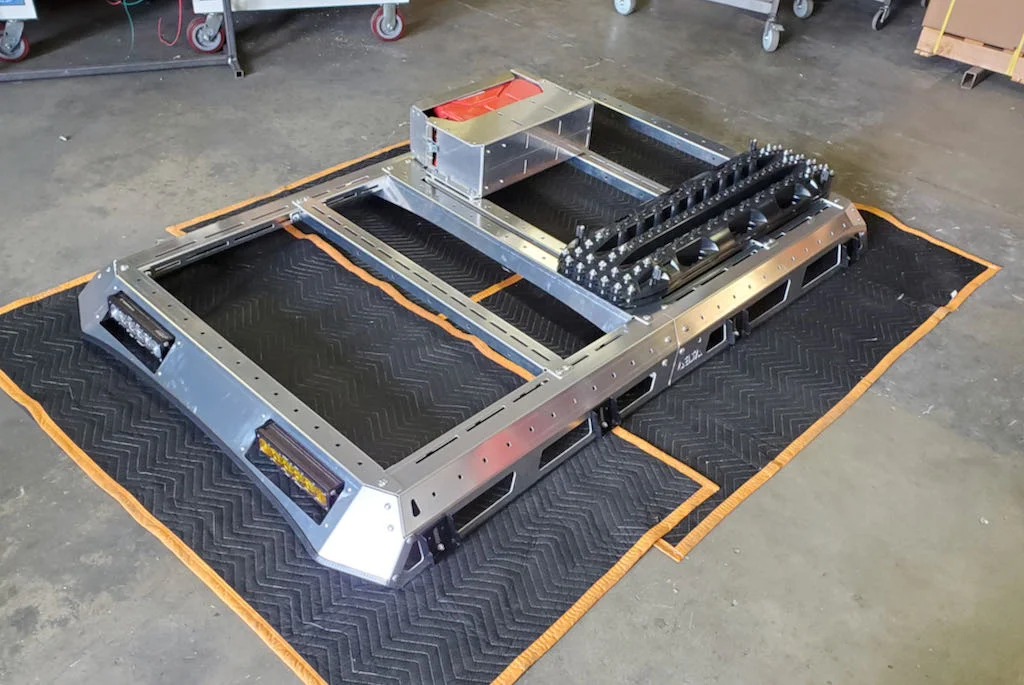

Instead of Morgan taking things apart, I'll add some here.

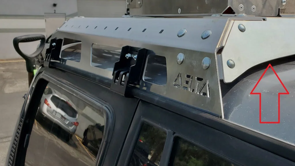

Thanks for the additional pics and I did check out the website. I just was unclear if the rear standalone half-unit shipped like this without a front facing:
Or like this with a front facing:
Your red arrows are actually pointing at the same piece of metal. It gets used on both the half rack and the full rack. Just uses different holes.

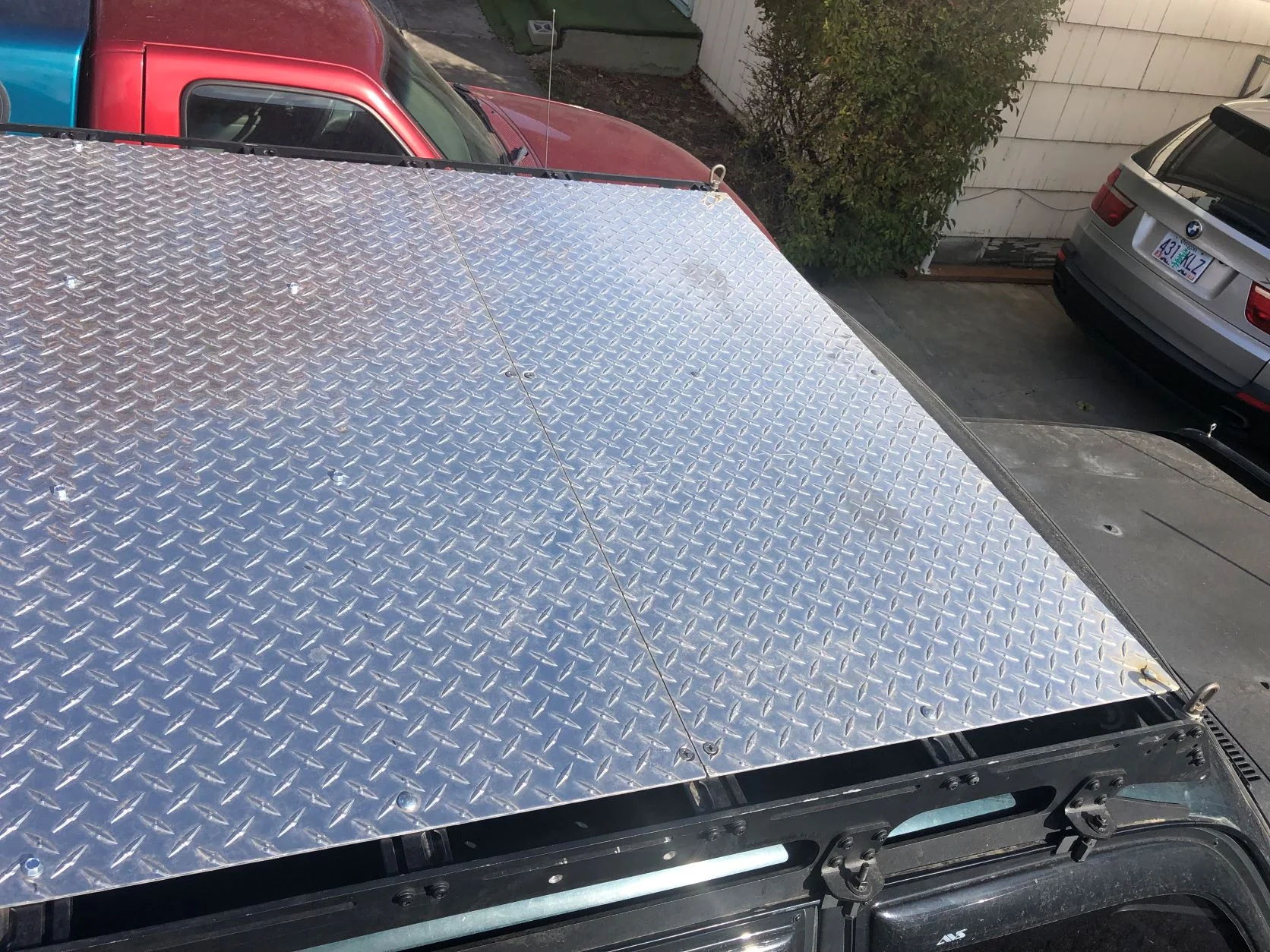

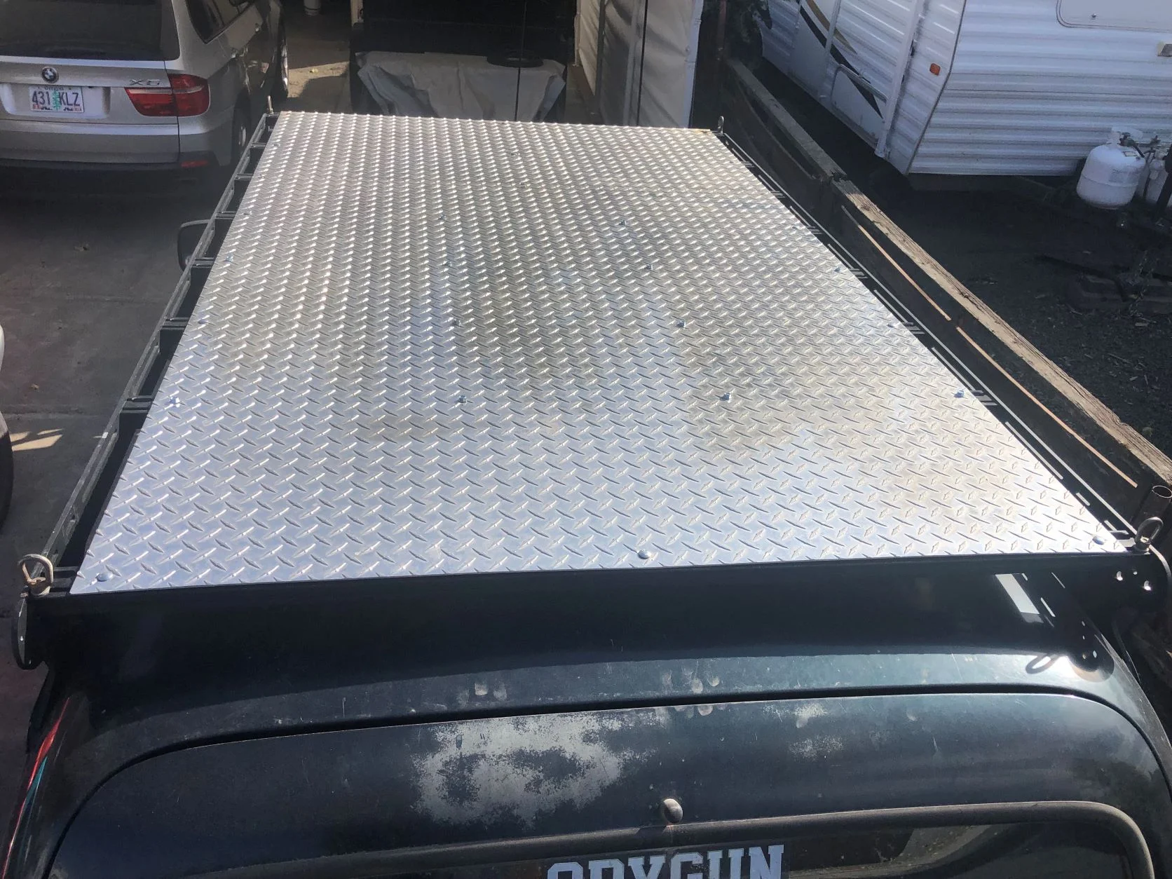

I added a 4' X 8' diamond plated sheet of aluminum, cut to length to my Prinsu (pics provided). It is also cut to allow the section above sunroof to be removed if desired. I find myself leaving it on though to give weather protection to the aging sunroof weather stripping..lol. You might consider a sunroof protection cover option.
If you look closely, you can see the sun roof section joint:
The full sheet left attached also gives the roof protection from the sun and with the darker paint color, makes a difference in cooler interior temps when parked & locked.
