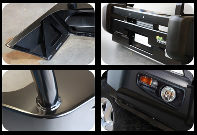

-The tubing measures a very large 8 inches around...
That would make those 2.5" (65mm) OD tubes.

Looks like a cheapo market competitor, look how small the bars/metal are. Not necessarily a bad thing every item has its place, not everyone needs all that strength, but in comparison it does look like a cheapo to me.
I think the original Ironman bull bars may have been smaller, so that stock photo is old. If you look at the info for the current ones they are 60.3mm (vs 65mm for TJM), so not a big difference in diameter. I can't speak to thickness of the steel bars of either though.
The one I saw on the 100-series definitely looked as beefy as the ARB on the 200, both in bull bar size as well as the thickness of the steel bumper itself.
Note: I'm not trying to push the Ironman bumper, just providing the facts as best I can for the audience.
I believe the wall thickness of the tube and how it is welded to the bumper matter than the OD.
Agree.
Here is the inside of the TJM, showing how the top bar extends fully through the bumper for additional welds and bracing. So the welds are not relied on for strength, but simply points of attachment. The main bumper frame itself keeps the bar secured against movement upon impact.

I'm pretty sure the ARB extends through...except for the Sahara Bar's "hoop." The 100 series in my avatar shows that hoop. Years ago when I ordered it, I was pretty noob, and did not realize it was just for looks. Connects with just two small bolts.
Some more info on Ironman, if I had not already bought my TJM I would have got one and saved $800. Looks like the hoop is just welded to the top plate.
Might hold up to a deer (or a fawn) strike. Probably not a bull
