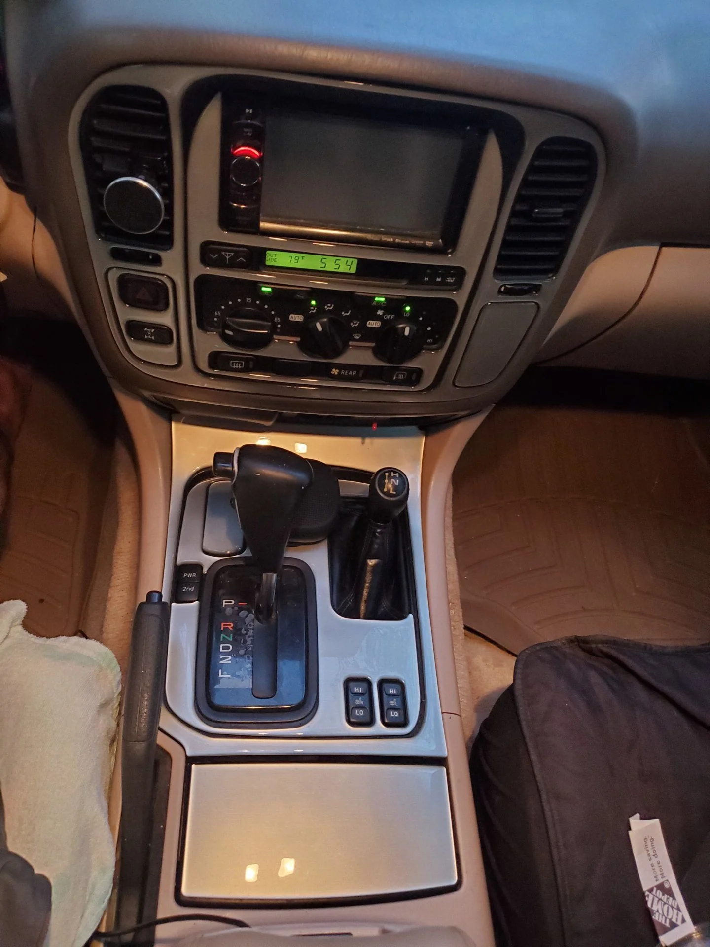

My Mattress and my Dometic CF25 arrived yesterday. I figure I'll work on ripping out my center console this weekend. It's already a bit foobar so it shouldn't be too bad. I'm going to see if I can cut up one console to make the dometic install look cleaner (I have a spare console from the PO) and I'm going to play with the mattress just because.

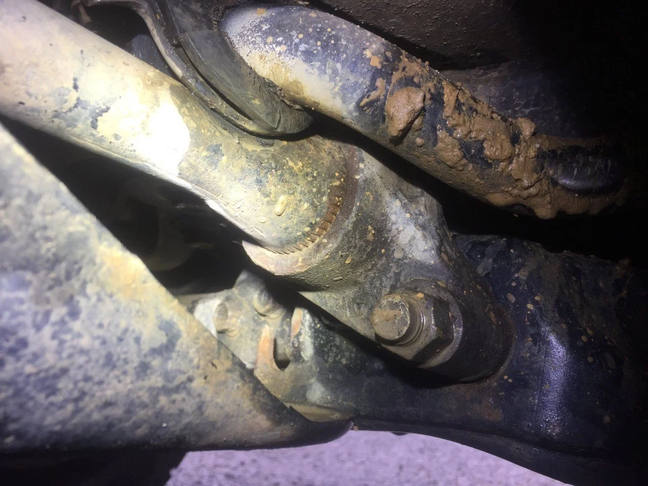

With those Moog LCAs I'd suggest installing Torsion Bar Reinforcing Brackets:
or:
Read more about them here:
THIS THIS THIS THIS THIS I HAD A MOOG LCA BREAK ON ME IN MOAB SUCKED SO MUCH NEVER AGAIN
