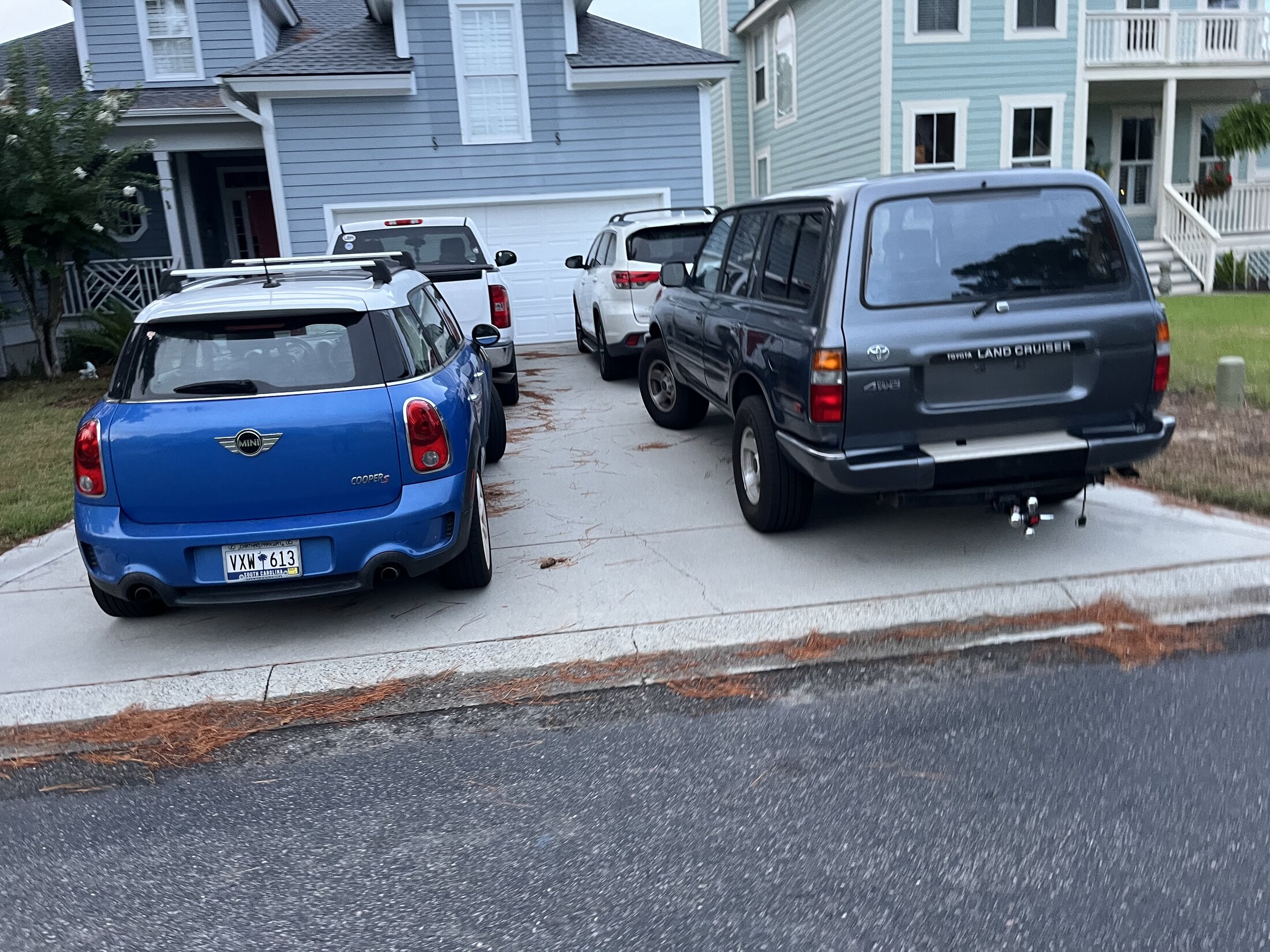

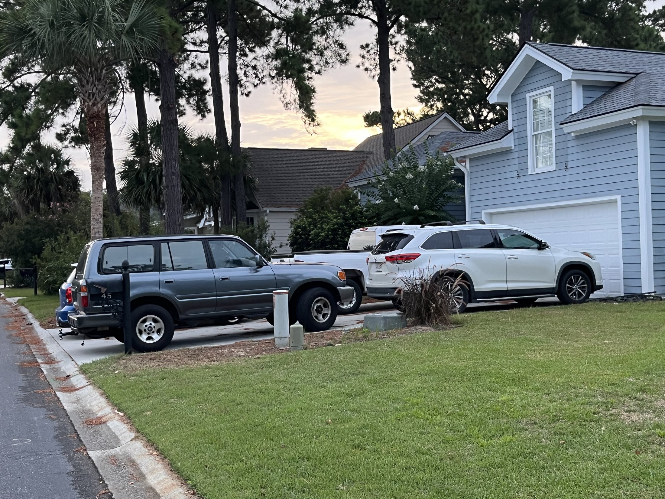

I was sad at first then started looking again that evening to find what you see below. Better shape, less KNOWN issues, and made the 4 hour drive home flawlessly. I feel I should thank the guy for selling the other one but I don’t know he deserves it.

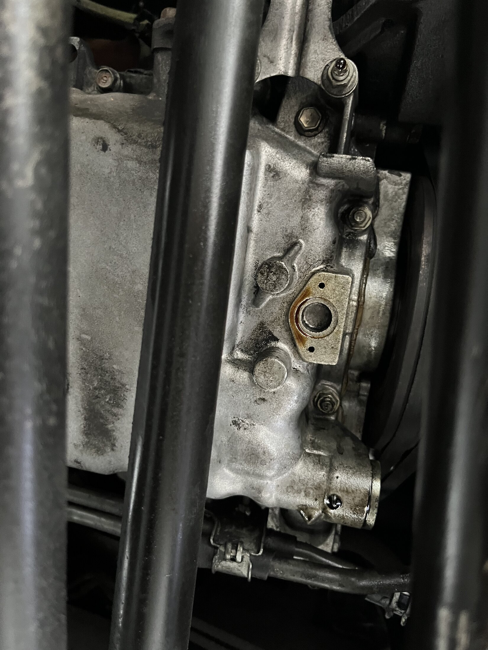

Next step is a full fluids flush and hose replacement. Some of the hoses (PCV) seem so hard that I don’t think it is normal. Others are brittle and crumble when touched. Small oil leak from the oil pump cover.

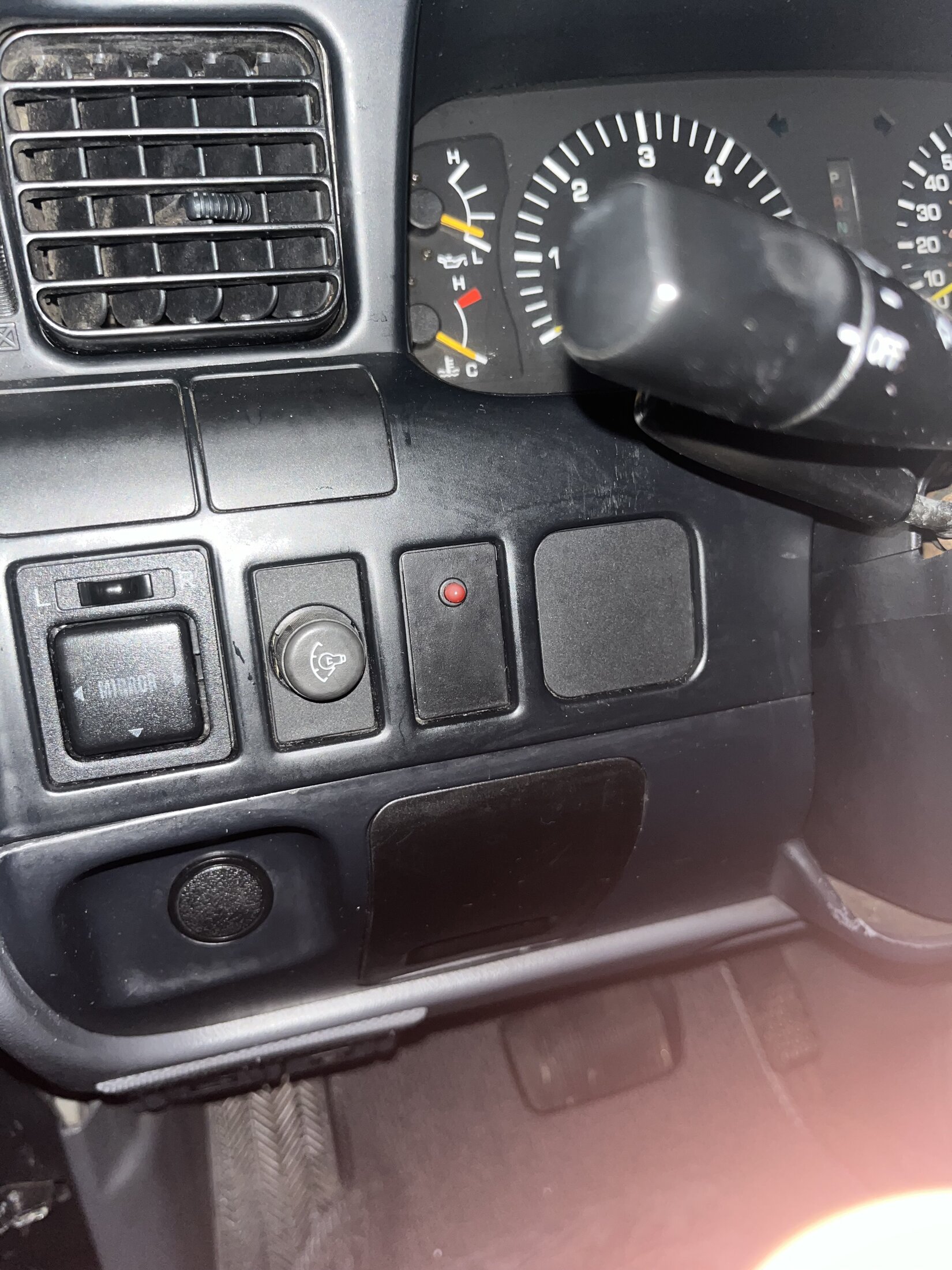

First off will be hoses and fluids along with the oil pump seal. Also have a bunch of dash light out. “D”, “L”, O/D, CEL, not sure what light come on with 4 low but I don’t get any there rather. Need to figure that out so I can get the CEL. That’s most important to me.
I’ve heard of LEDs working but I haven’t found a solid informational on it yet. Seems like people make the. Whatever color they want. Would be nice to get a rebuild kit with all the original colors.

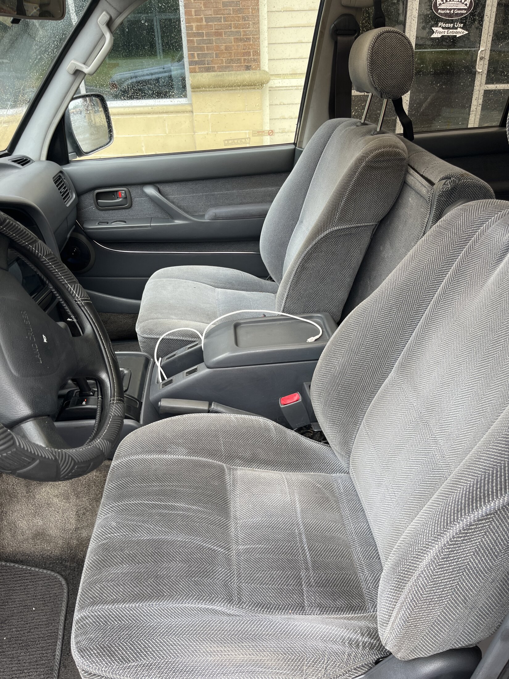

Does you rig have cloth ?

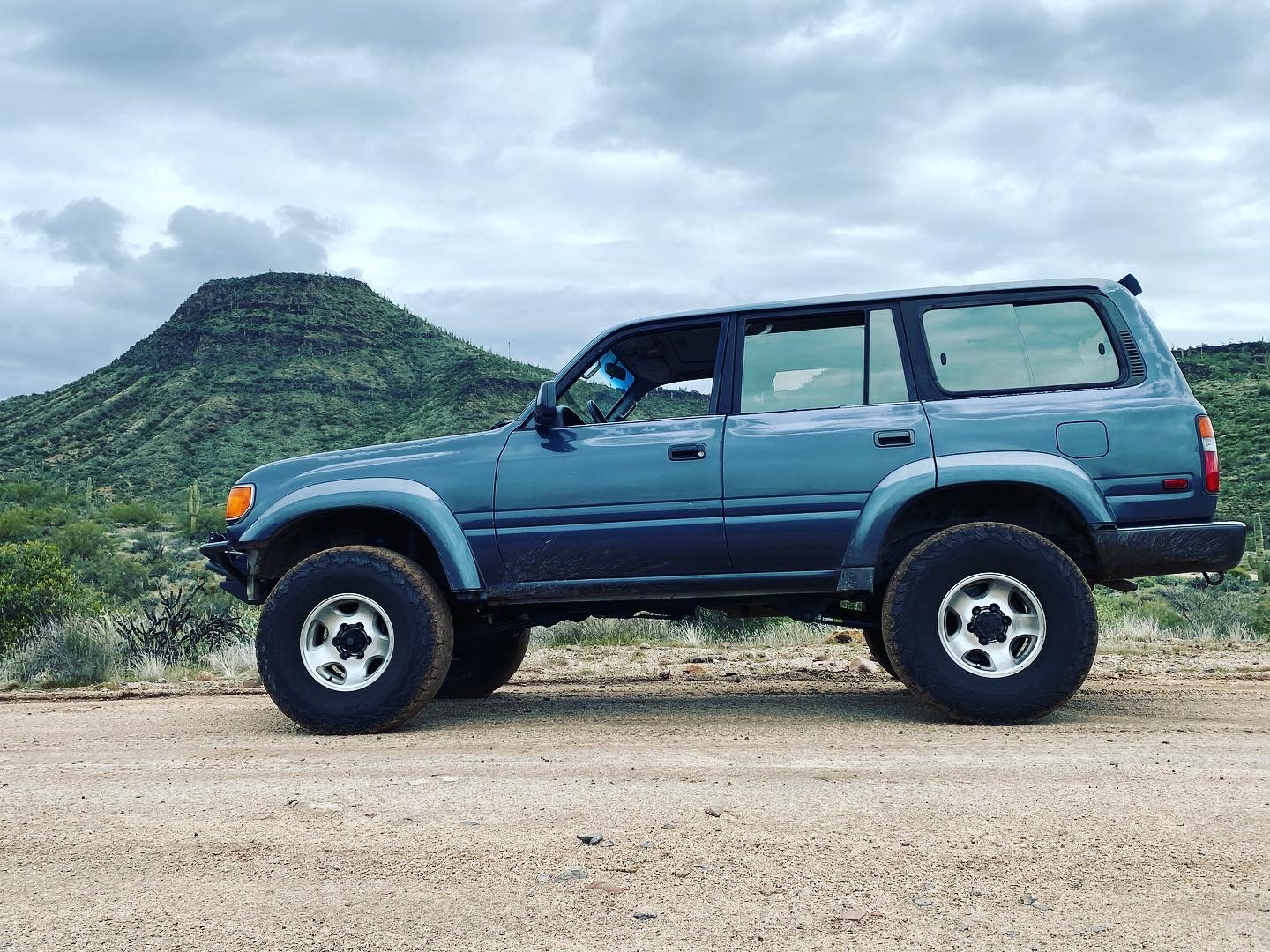

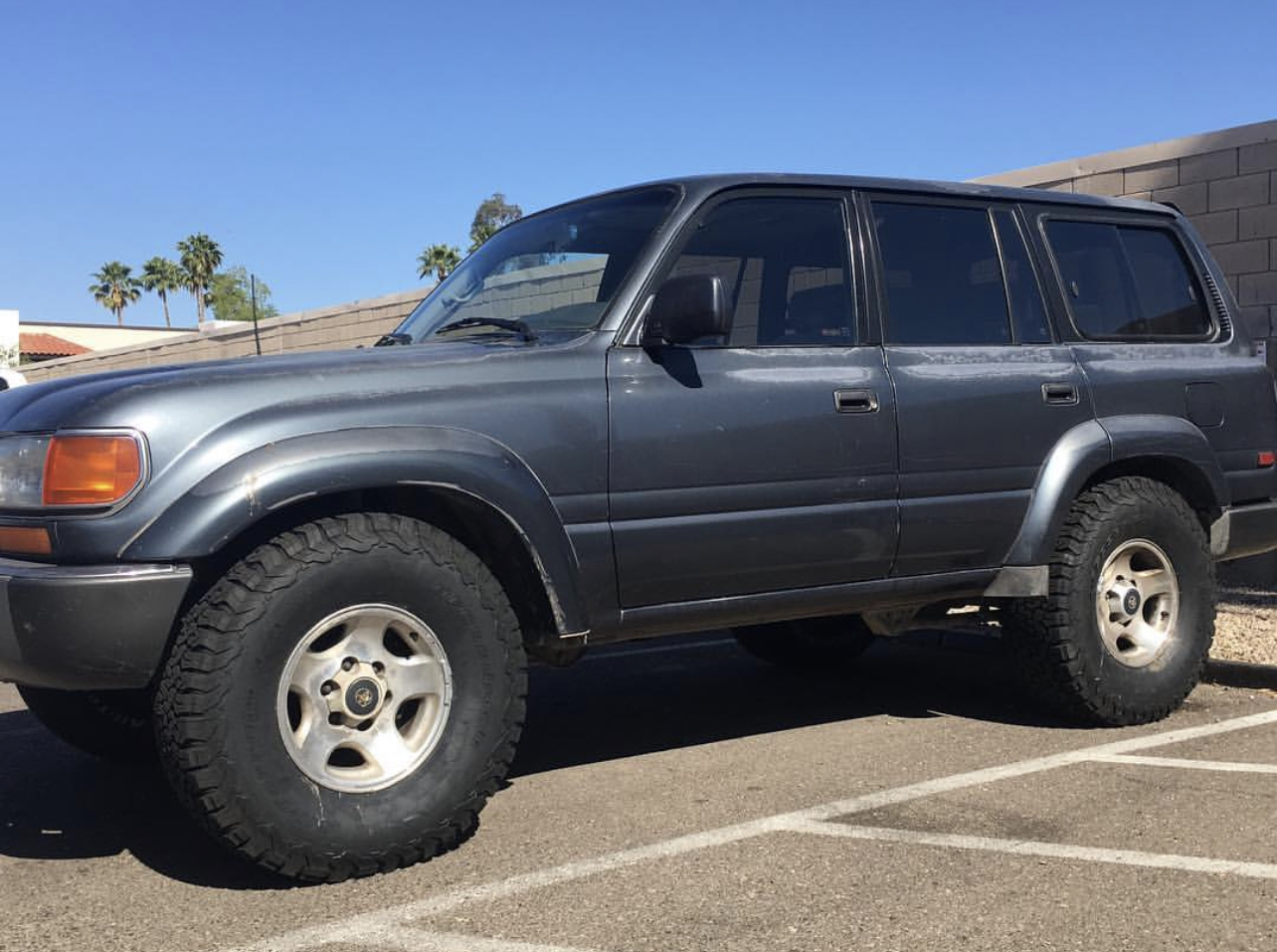

It appears to be the same color mine was in it's glory days. Being an Arizona vehicle the paint I like to call has been sun kissed.
And before I lifted it, sitting on 315/75-16
