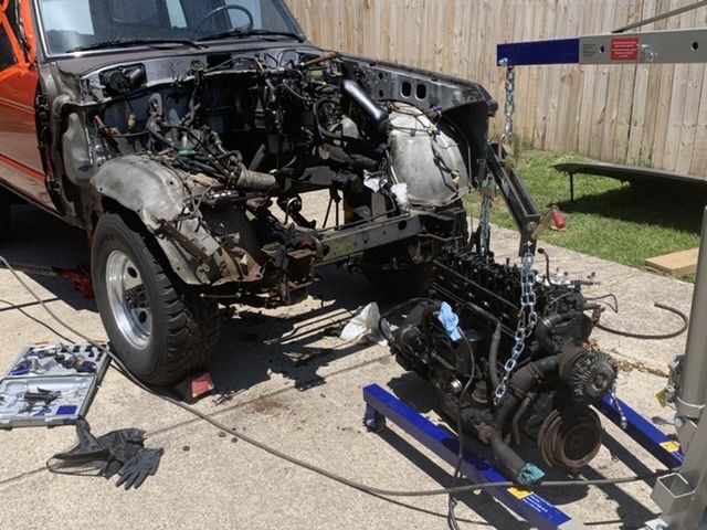

Ok folks...semi real-time project question here. I’m pulling my first engine today. 1985 FJ60. Just pulling the motor by itself, not motor and trans. Searched threads and read up, but didn’t see any pics to confirm I was understanding exactly what they were saying.
Where I’m at currently: I’ve removed the hood, front fenders, radiator, front grill assembly in it’s entirety. Disconnected radiator lines, ground straps, and electrical lines that attach to the motor. Loosened motor mounts. Have the clutch inspection cover off.
From here?? .... attach lift chains to hooks, place jack to help support trans. Unbolt motor from transmission; is it the 4 big bolts I can see inside the clutch disc housing on the trans side threading in from rear to front (might be easier to remove front driveshaft to get to the bolt heads)? Start lifting and moving out; work slowly and watch for hang ups?
It was getting dark so I couldn’t really see, but where do I disconnect the clutch fork?
Withall the body stuff out of the way, a 2 ton crane, and load leveler, it should be pretty straightforward right?
What am I missing?
I do not know the entirety of your project but I can tell you this much, it is much easier (at least for me) to pull motor/trans/T case together then split it while out. Your crane can handle it and with the front clip off the truck you have great access. Just food for thought, plenty of different ways to skin a cat.
@NCFJ If I take that route, then I need to move farther back and disconnect rear driveshaft, trans mount and support, remove shifter lever, pull up and out while working the angle the assembly comes out?
Yes, disconnect both drive shafts, drop cross member, remove shifters. I use a rolling ATV jack under the T case and it rolls with the crane as you pull it forward. A moving dolly can do the same thing.
Getting the motor out by itself is much easier than putting it back in and getting everything all lined up with the trans into the pressure plate and pilot bearing while under the truck.
I’m pulling the motor for a buyer that coming by this evening. After that, I’ll be working on stripping everything down and doing the body work.
Trans bolts are the four going from rear to front as you referred to them. Disconnect the clutch by unbolting the two bolts holding the slave cylinder to the bellhousing and letting it hang.
Rest of the wires, fuel lines, coolant lines you missed will become self apparent when you start lifting. Go slow, check for snags, you'll be fine.
Thanks guys. That was pretty easy. Took about and hour and a half by myself. I’m an hour ahead of schedule. I might be able to just get this on a pallet for the buyer and he can just turn and burn. Cool.

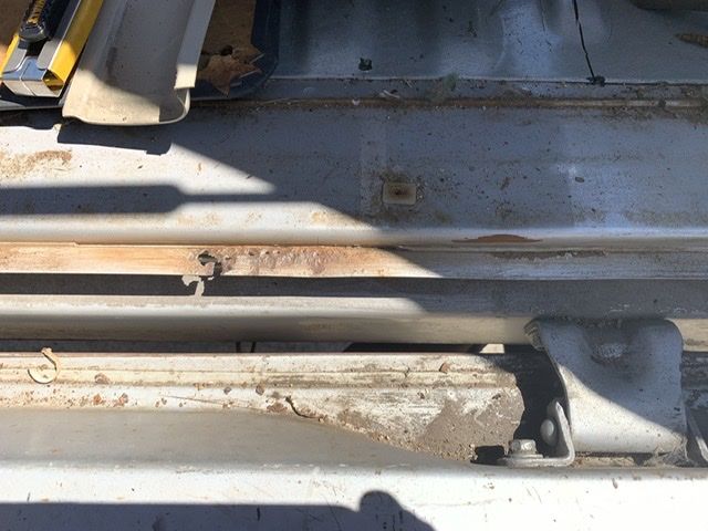

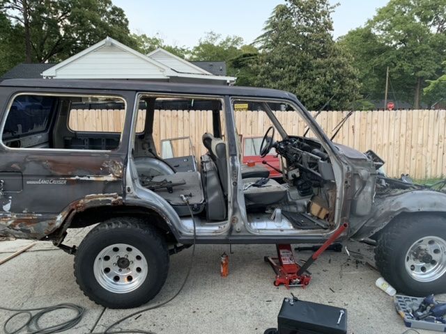

Got pretty far stripping it down today. Not as much hidden body rust as I was thinking I was going to find. It’s probably only about a day or so worth of work to patch the rust. Front of the frame looks really good too. So far C-channels look like they’ll be the most difficult part of the repairs. Oh...and the C-pillars are already threaded for 3-point seatbelts!
Rear body
PS rear window
PS windshield

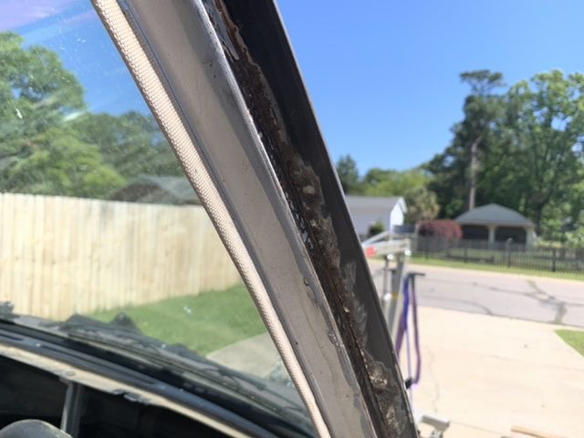

Worst of the two rain channels
