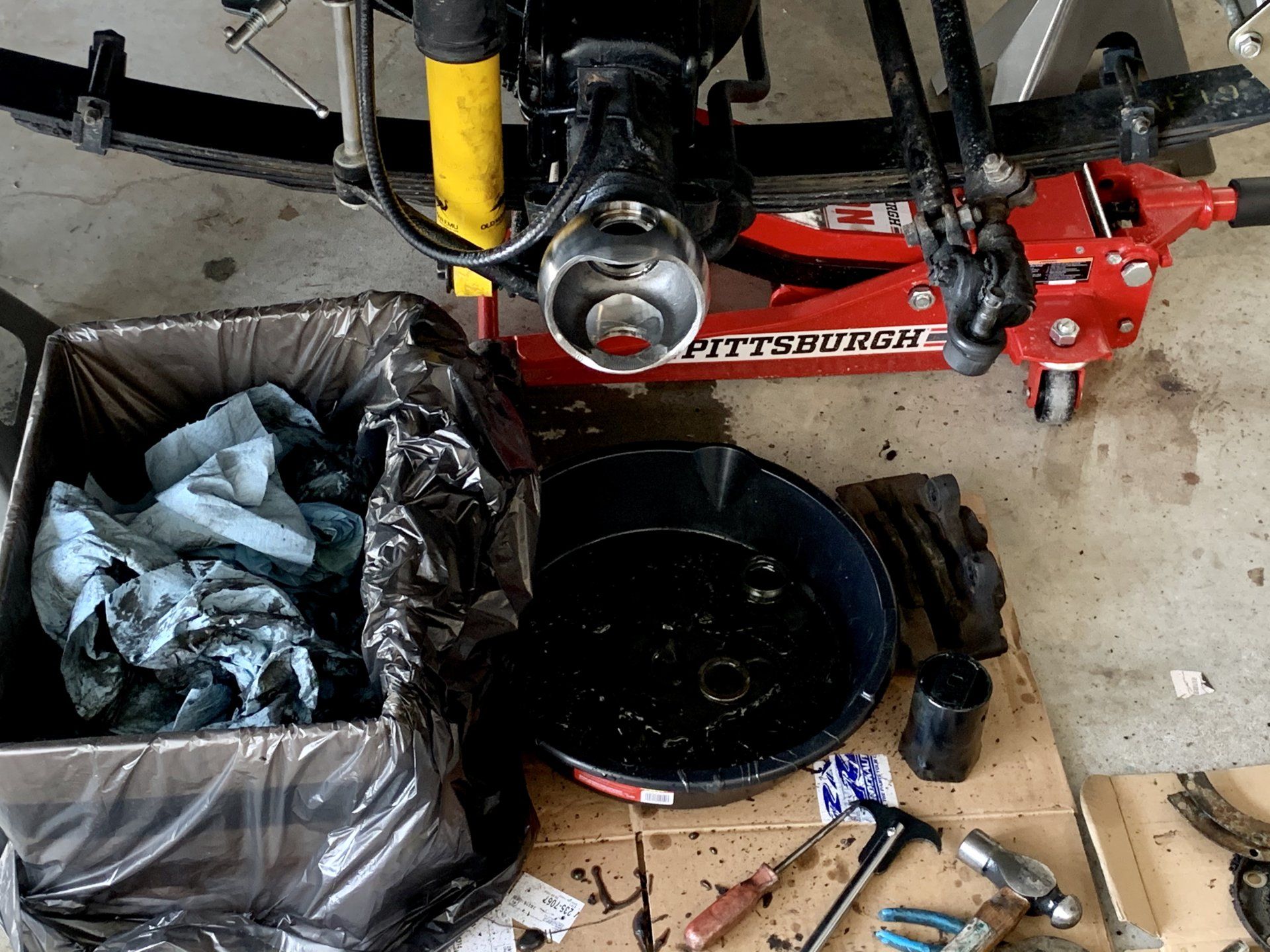

Not sure if you got it off or not, my o-ring and some oil basically turned it to a laquer. Used a slide hammer...gently, but enough to pop it right out.
I did get it. Lightly tapped around it with a rubber mallet and pried some on the tab. Ended up giving it a good steady pull while rocking crank pulley back and forth some. Popped out after a minute or two.
No questions yet, just a who lotta grease everywhere.... fun day.
All done... Besides the disgusting mess, actually not too bad of a job.

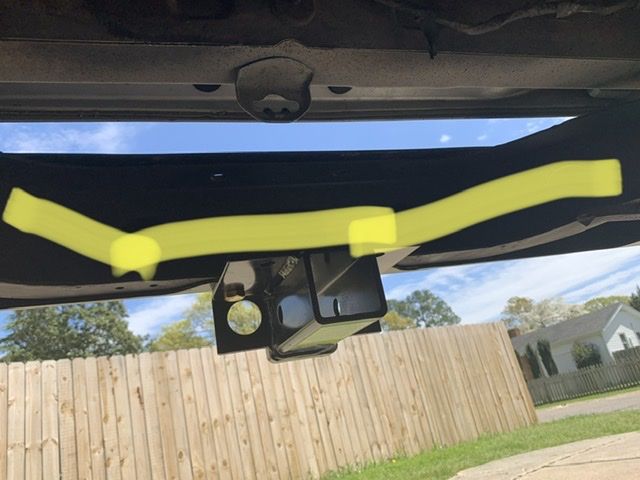

Minor fabrication question...I want to have the ability to tow a lightweight trailer and mount a receiver bike rack. I picked up a simple 3500lbs step bumper hitch receiver from HF. The two front mounting holes line up with the two existing holes in the stock bumper and the two holes in the tame that have captured nuts on the back side. Now I’m not exactly sure how to mount the two rear holes on the receiver. Other ones I’ve seen just have a piece of rectangular tube that mounts to the frame on either side.
I was thinking of welding up a “clipped A-frame”, welding the receiver to the top and he bolting the legs to the frame.
Not the greatest description, but maybe you get the idea...
Any issues doing it this way?

The two bolts attached right now are through the bottom of the stock rear crossmember?
No issues I can think of, but you're not going to have much capacity at all.
