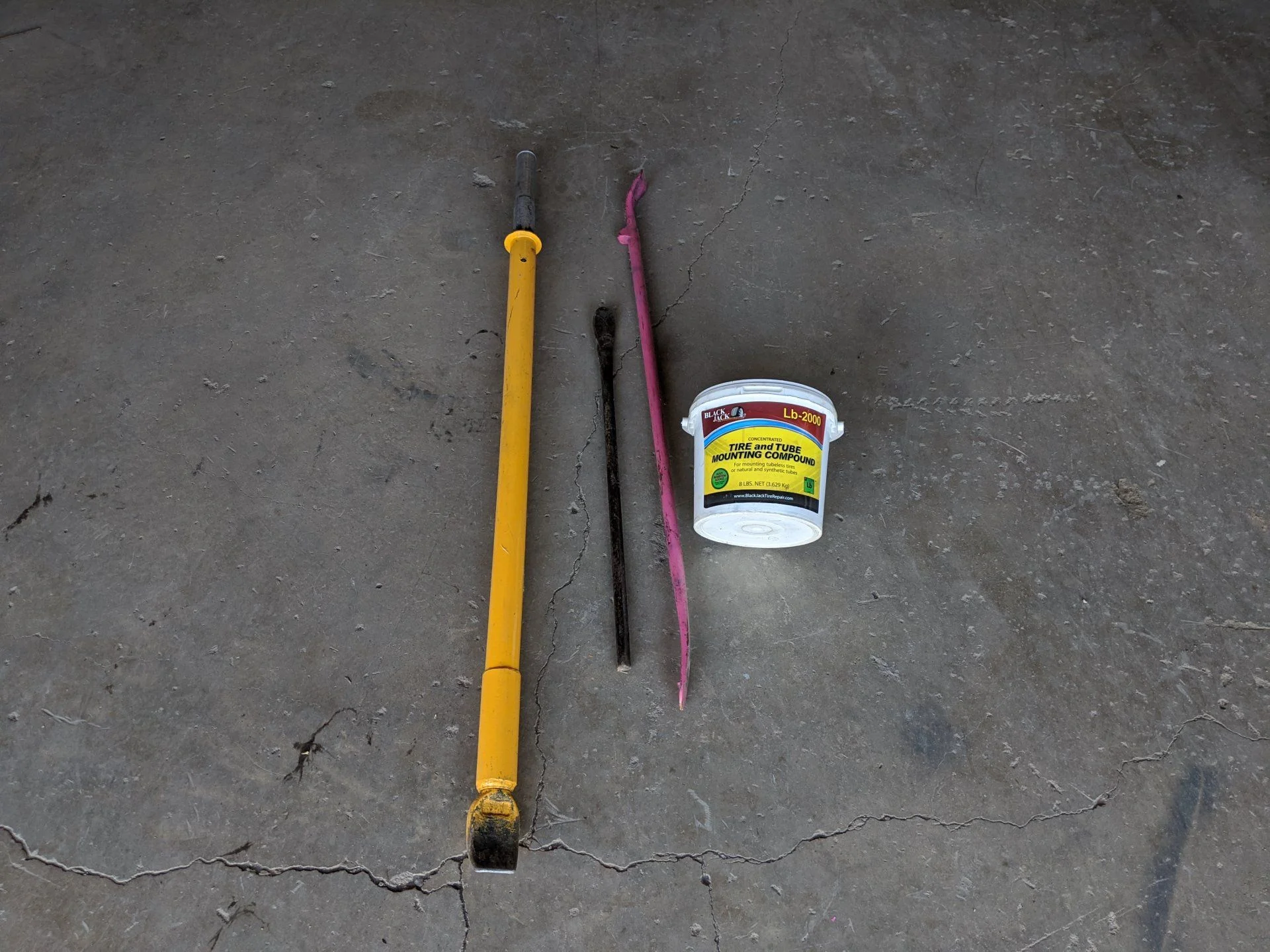

These are the tools I use for tires. I bust a lot of tires and these work great. The slide hammer is about 30 pounds and can break most beads pretty quick. The pink bar is a Ken-Tool 34645 and it is the bees knees for both dismount and mounting. Also don't forget the lube! Black Jack is pure vegetable soap and doesn't cause corrosion or eat rubber like dish soap or oil based lubes. You can also use the lube to help seat stubborn beads.
I had 13 tires to swap around and decided at $25 per I might as well get the tools. For aluminum rims you also need rim protection or they will at least scratch and at most dent. Was able to do 114 load easy. 125 load was harder, but achievable. 129 load I had no chance of getting it mounted before I was going to damage the rim. Had to pay for that set. Ended up with two Ken tools, three shorter levers, bead cream, a box of stick on weights, a box of plastic bbs, and Bubble balance jig.bubble balance gets it close, and then the bbs deal with dynamic balance and mud and stuff. Using floor jack and ratchet strap to break bead.
^ very helpful to see some numbers on the rating issue! Thanks.
Do you think you could have done the heaviest ones if it were a steel rim?
If I didn’t care about scratches, sure. That makes it much easier. A steel tire lever on aluminum rims is delicate. Also the 129 load were three ply sidewalls, while the 125 and 114 were 2 ply. That may be a factor as well.
