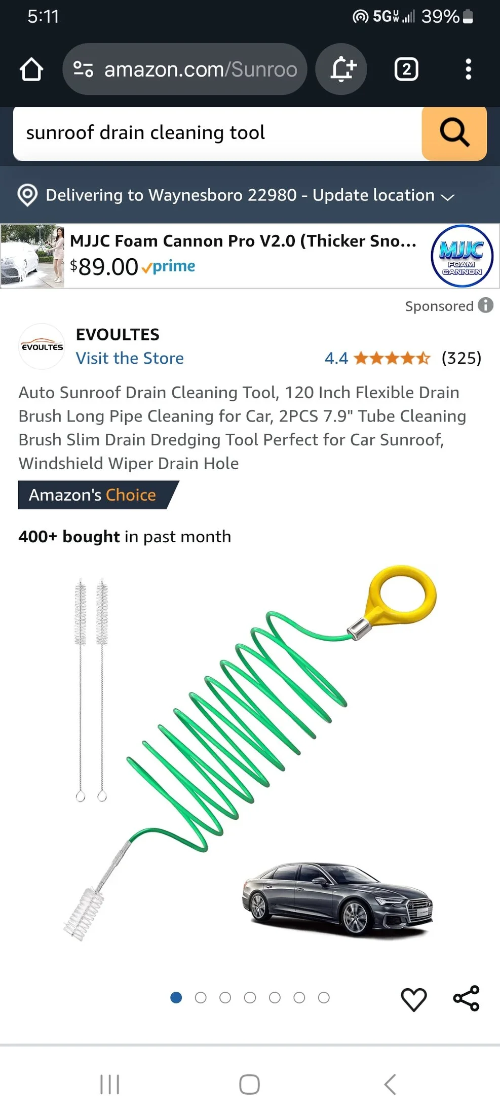

The rear sunroof drains exit at the far back of the landcruiser on each side coming out at the rear cargo area should see a black hose just sticking out each side under the landcruiser. Culprits are usually clogged front drains you can access them by opening the sunroof there will be one at each corner opening is about the size of a pencil eraser. I use a little brush on a wire made just for cleaning the front drains can use the same thing for the rear but need to run it up through the back because there isn't a way to get to them unless dropping the headliner and removing the sunroof assembly witch you should do anyway and fix whatever is wrong with the sunroof and get the tape off the landcruiser and fix it the right way poor damn thing sitting outside now give your gift some love and attention.
