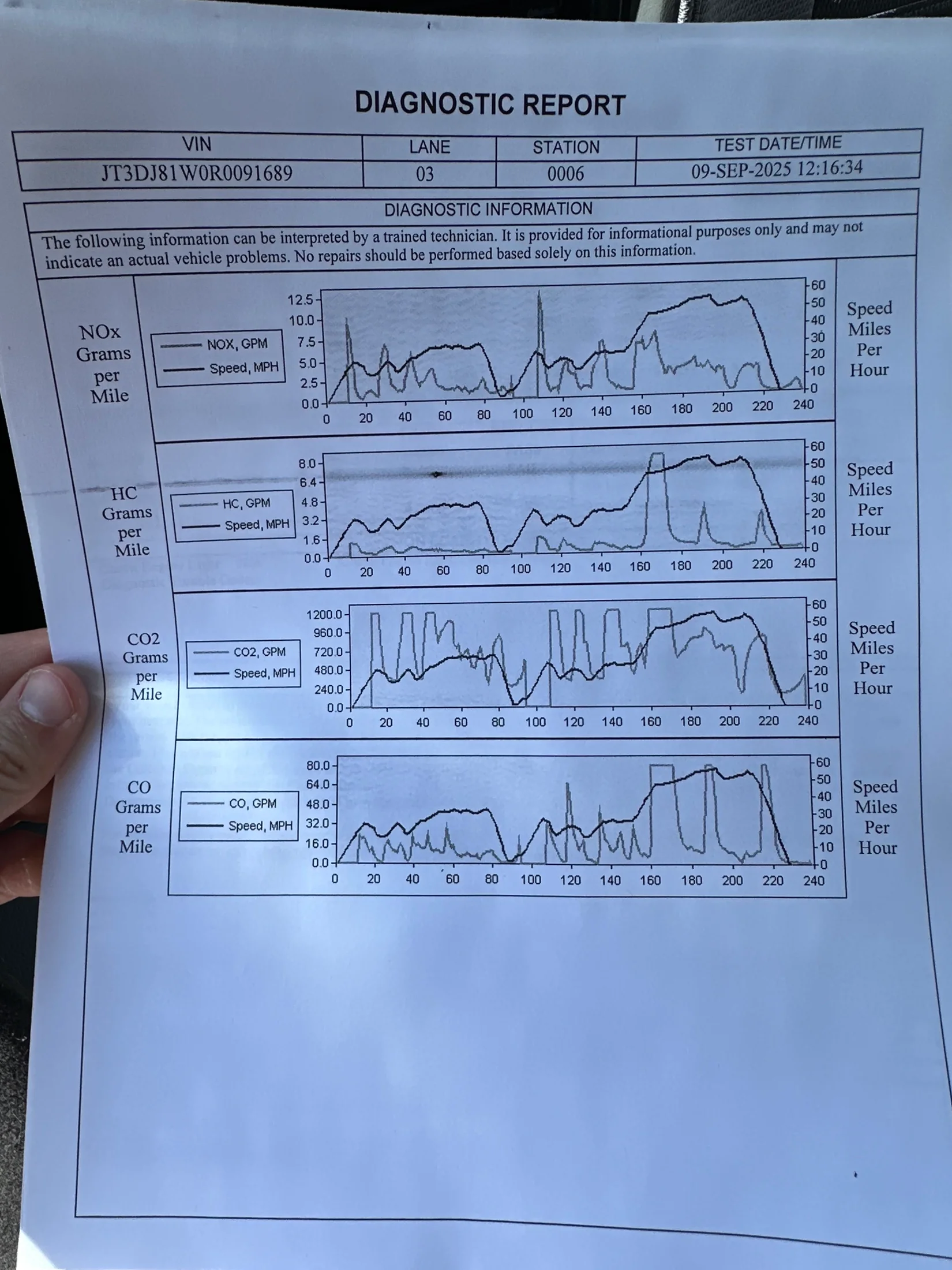

Any insights? Here are the results as well as a graph from Run #2

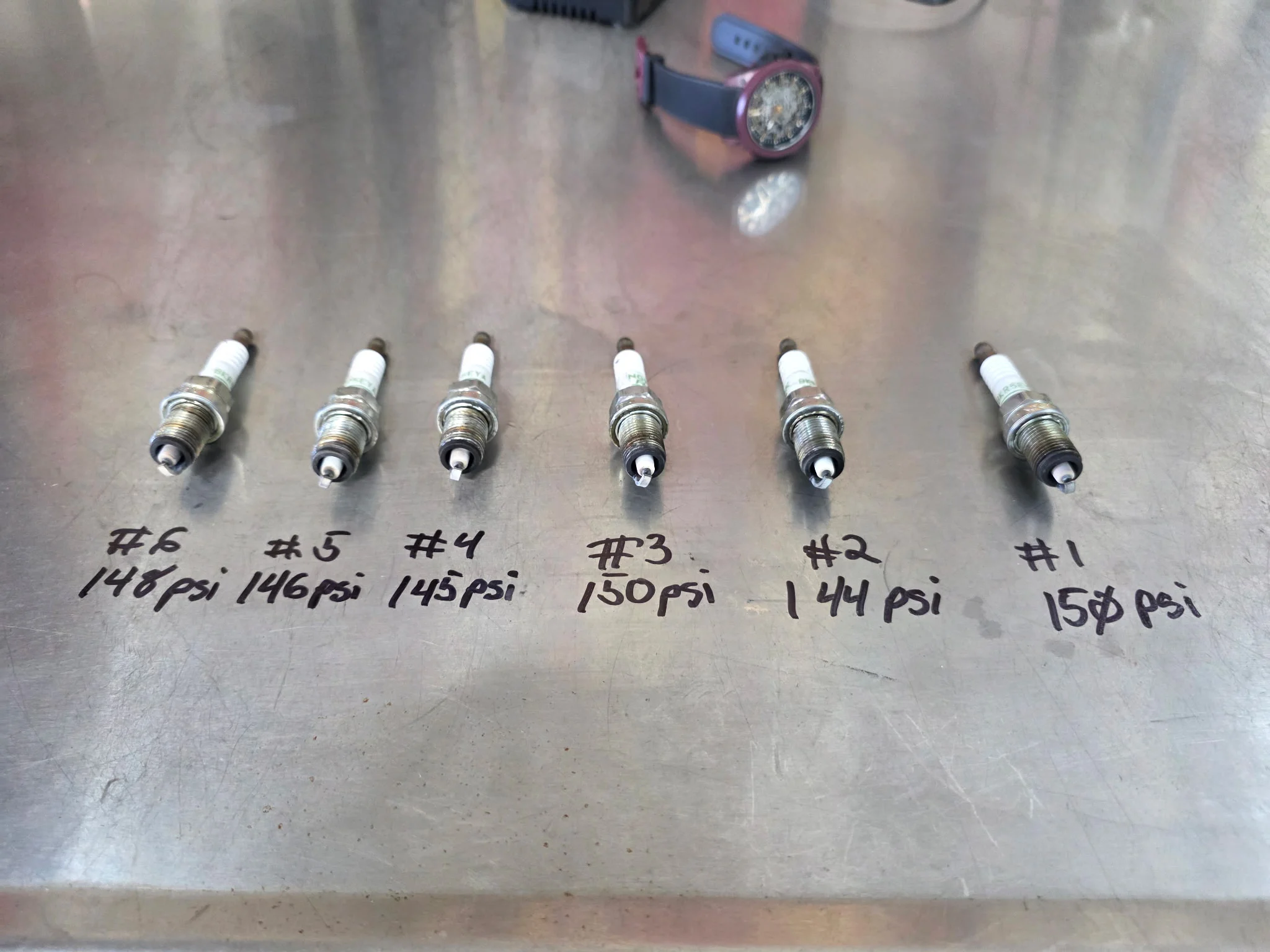

I have added photos of the 3k mile old plugs from a compression/leak down test run about 100 miles ago and after the trip cross country.

Ok, one challenge is while she works for a guy who is a long time Audi mechanic, we do not have an established relationship with a Land Cruiser facility in Denver. We know of several, but I am hesitant to shotgun this from experience in DC. Colorado offered a diagnostic service a we were there this morning and got the attached report.
Ok, to tidy up. I had originally ordered 2 new O2 Sensors from Japan for the car (89465-69115). The outboard sensor had a bad heater element and had to go. The inner sensor had 30k miles and 7 years on it. It was also beyond my skills to reach and remove. Functionally, the inner O2 sensor appeared to pass the FSM testing. In the process of getting it through Front Range Emissions, she took the car to some state facility where they diagnosed the likely issues. Super helpful guy named Justin there felt the inner O2 sensor was slow to respond and was the low hanging fruit in terms of passing. He also had concerns that the vanes in the AFM were not responding quickly enough. I did not want to get into that. So, we had a local shop get the inner O2 Sensor out and the replacement in.
I thought the results were surprisingly good given that from what I could see the sensor should have been good. Perhaps this is why Mr. T wants them both changed as a pair?
