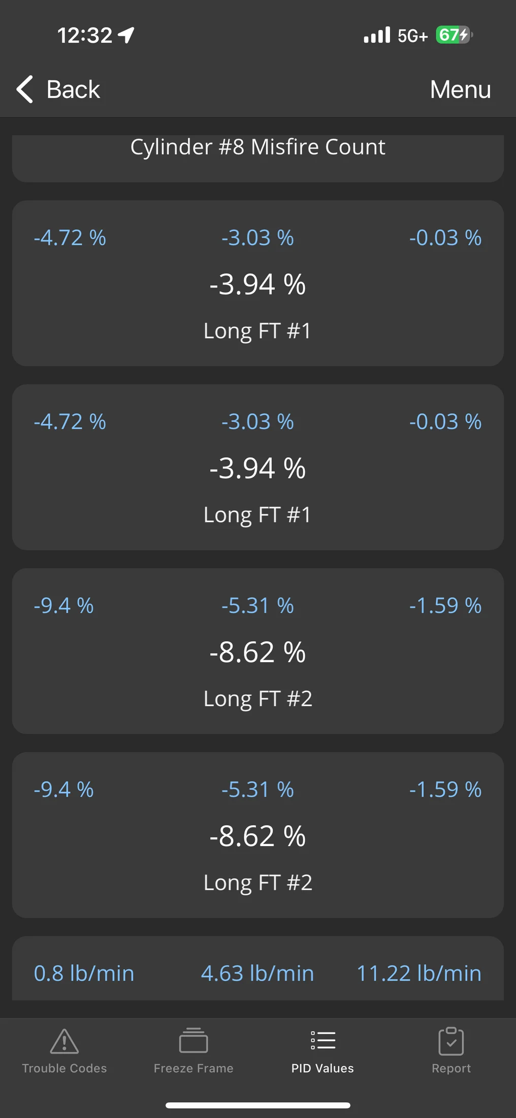

Looks like my bank 2 fuel trim is setting at above 9% at idle. It is the same on both sides while driving. Reading some of your other injector threads that is sounding like injectors may be the issue. What do you think?
I like to see RPM & MPH w/LTFT & STFT. On HWY ~65 MPH steady (no hills, no change in RPM or MPH)
I'd, also go through all I did above in post #12. Gathering all the clues first!
I don't think -9% LT is causing your misfire...sure it's taking away fuel, MAY cause a rich code eventually but not taking enough fuel away to cause a miss......at least I don't see it.
