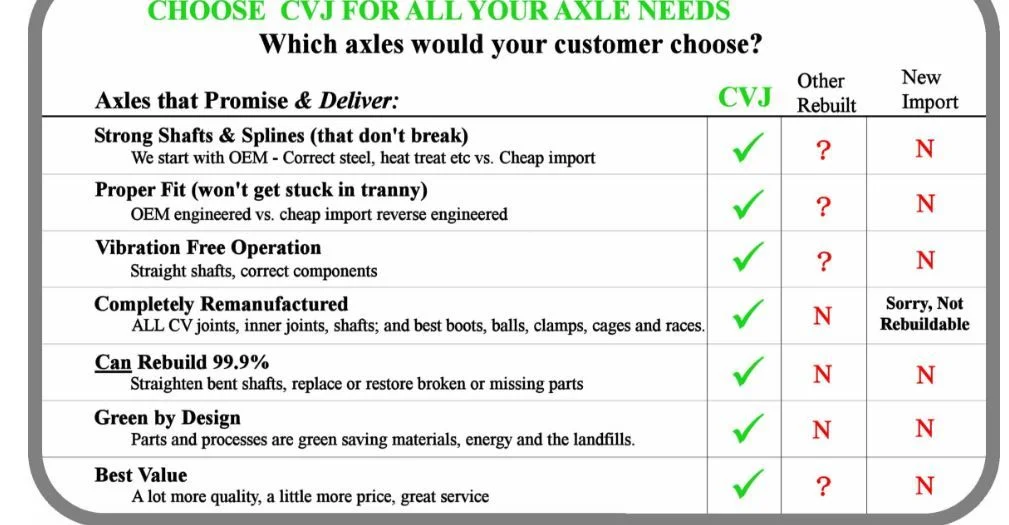

Has anyone has bad luck with the CVJ axles? Does not appear to be just a re-grease and reboot on the axle.
