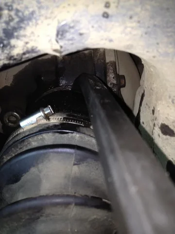

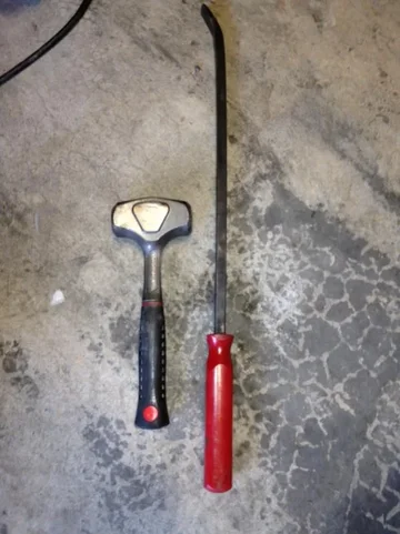

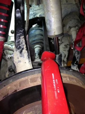

For those of you re-installing, I'll repost this as it makes such easy work of getting the cv seated back into the diff. image-1323165032.webp image-1998992841.webp
I've rotated it 9 ways to Saturday and fought it before trying this. But I'll make a mental note of this next time. My little prybar thing took no time at all.
Does it work both ways? If you paint mark the housing can you clock it to 'tdc' and get it to release easy as well?
