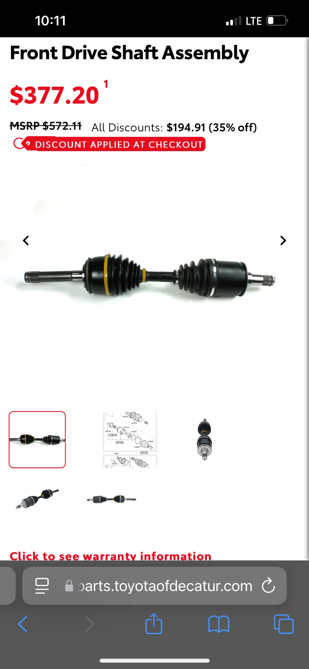

@Bisho I've gone through their site as well as others and the part numbers. They don't show fitment for any particular vehicle, but they do put the part number to the side. Every part number i check is for other vehicles. Yes, they have remans for about $320-370 on every toyota parts page. Most of them are for corollas and other models - even when I have the Landcruiser and its vin entered. Maybe I'm doing it wrong. If you have a link, drop it to me. I ain't looking for somebody to do all the work for me, but I'm not proud either. I'll click a link/learn a lesson.
nevermind I'm dumb. figured out what I had entered wrong @Bisho . THNX
It’s called a front driveshaft assembly, which is probably what throws you off. The price is further discounted as you go through the checkout process. This shows for a 2000, but they are all the same.
