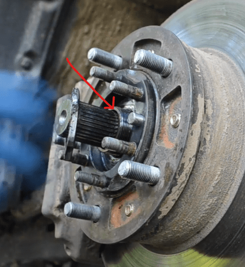

Please excuse my ignorance with these questions since I am just getting all my tools together to perform my first wheel bearing maintenance.
  1. Is the concept of greasing the spindle bearing with the new tool that the grease is pushed in the gap I marked in red? Yes that is the correct area where the grease is pushing in.
  2. Is there a benefit to being able to grease the spindle bearings without removal of the wheel or locking/adjusting nuts? The benefit is you don't mess up your preload so you don't have to sit there for an extra 20min per side with a fish scale trying to dial it back into spec. Don't those items have to be removed to grease the inner/outer wheel bearings or is it possible they get greased at the same time while installed with this method? Yes they normally do have to be removed to access the wheel bearings. However, not everyone follows Toyota's recommended service intervals especially with the spindle bearings so some people may find themselves with newish wheel bearings but neglected spindle bearings. I do not believe you can force grease into the wheel bearings effectively without completely removing them from the hub. They need to be packed using the palm of your hand.
Either way, seems like the tool is really useful and I will be interested in picking one up when they are ready.

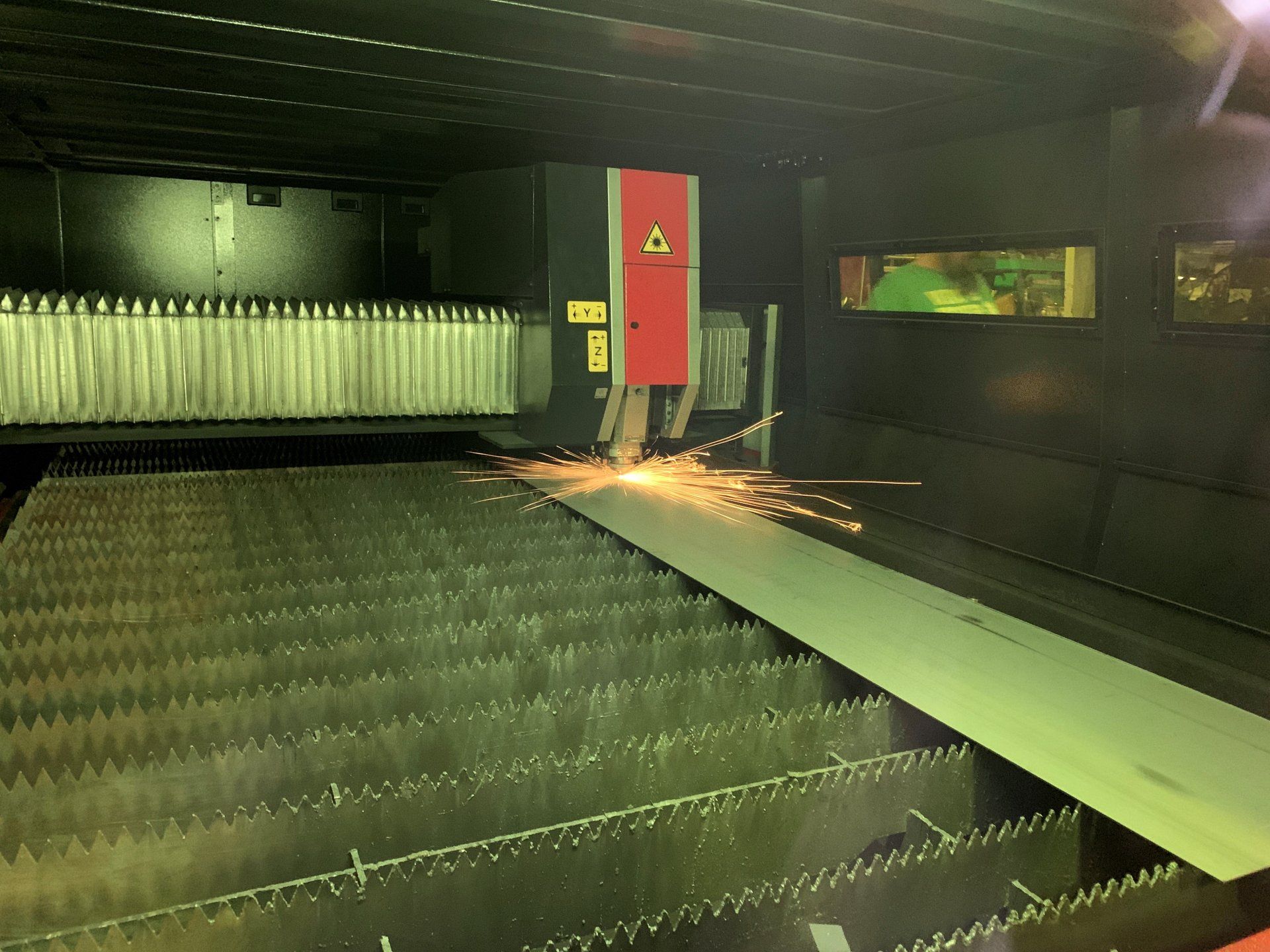

14ga. galvanneal cut on an Amada Ensis 3015AJ fiber laser, broken on an Amada HD2204NT, possibly welded in just a couple spots along the seam but still trying to decide whether it's worth it. With the precision I can achieve it's basically an interference fit, and when the bolts are tightened down the pieces only come together even more. This surface takes paint very easily which will be nice once I get a few coats on it. Still messing with a few things but I most likely will be going this route in the near future.
Nice toy, big capital investment too. What's the max available power for this puppy? Is this the "baby" 3kW flavor or the full hog 12kW flavor?
If they are doing what I think they are doing to get to 1.08 micron output, it's very slick and is a real world application of my username!
Hah this is just the "baby" nominal 3kW (actual rating is 3.15kW) 10.4kVA laser, and you are correct it does have a 1.08 micron wavelength. We primarily cut and etch 22ga-12ga galvanneal, 304 & 316 stainless, and aluminum so we don't need anything too crazy. Even with the lowest power rating in Amada's lineup it can still cut max 1" mild steel or 0.5" aluminum & stainless which is more than enough for what we do. The cuts require no finish work which is great. It also modulates the beam as a function of material thickness and movement, so even if the piece begins to bow on the table due to the heat, the head of the laser will move accordingly to maintain a consistent cut. Pretty neat!
