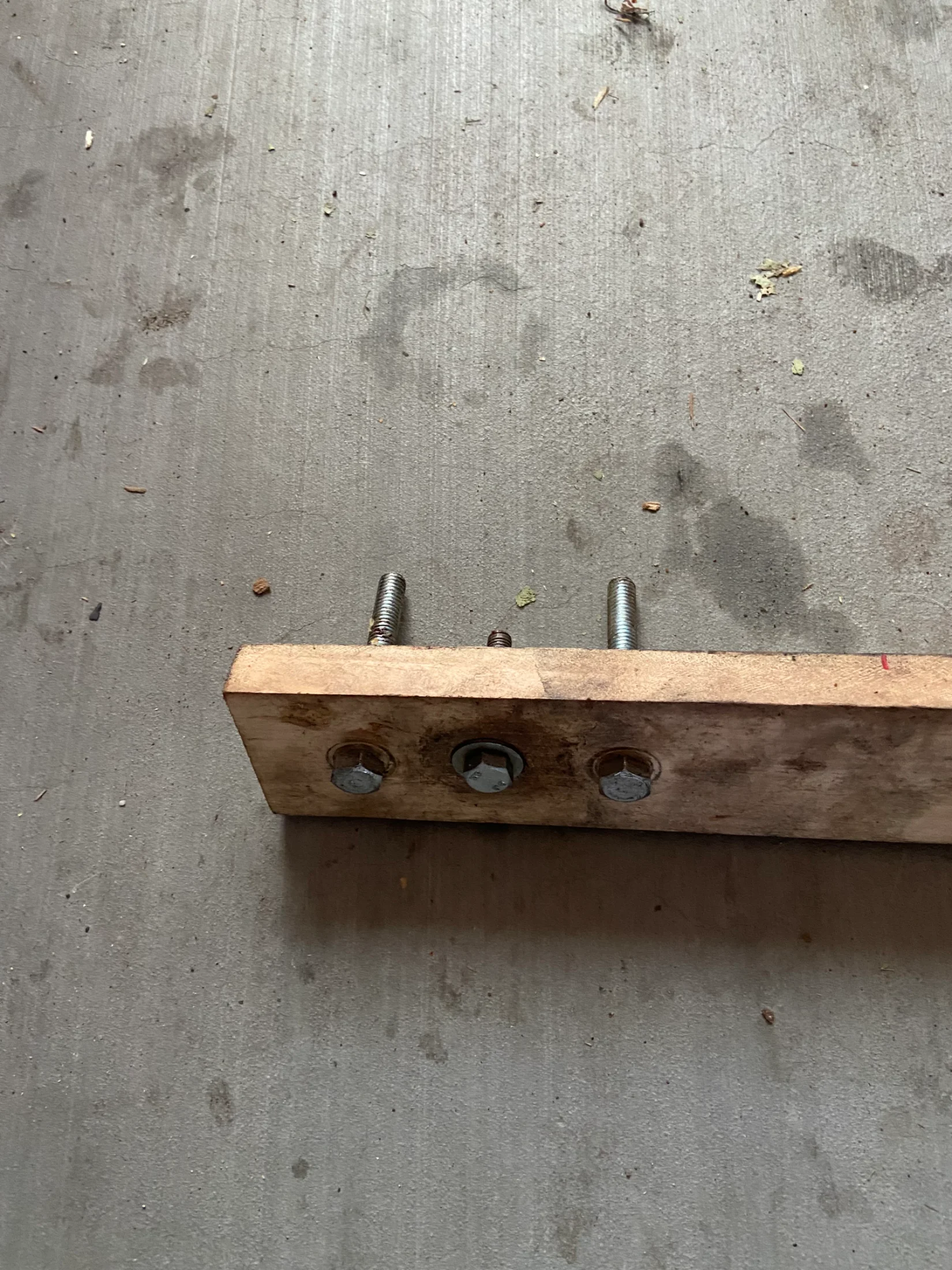

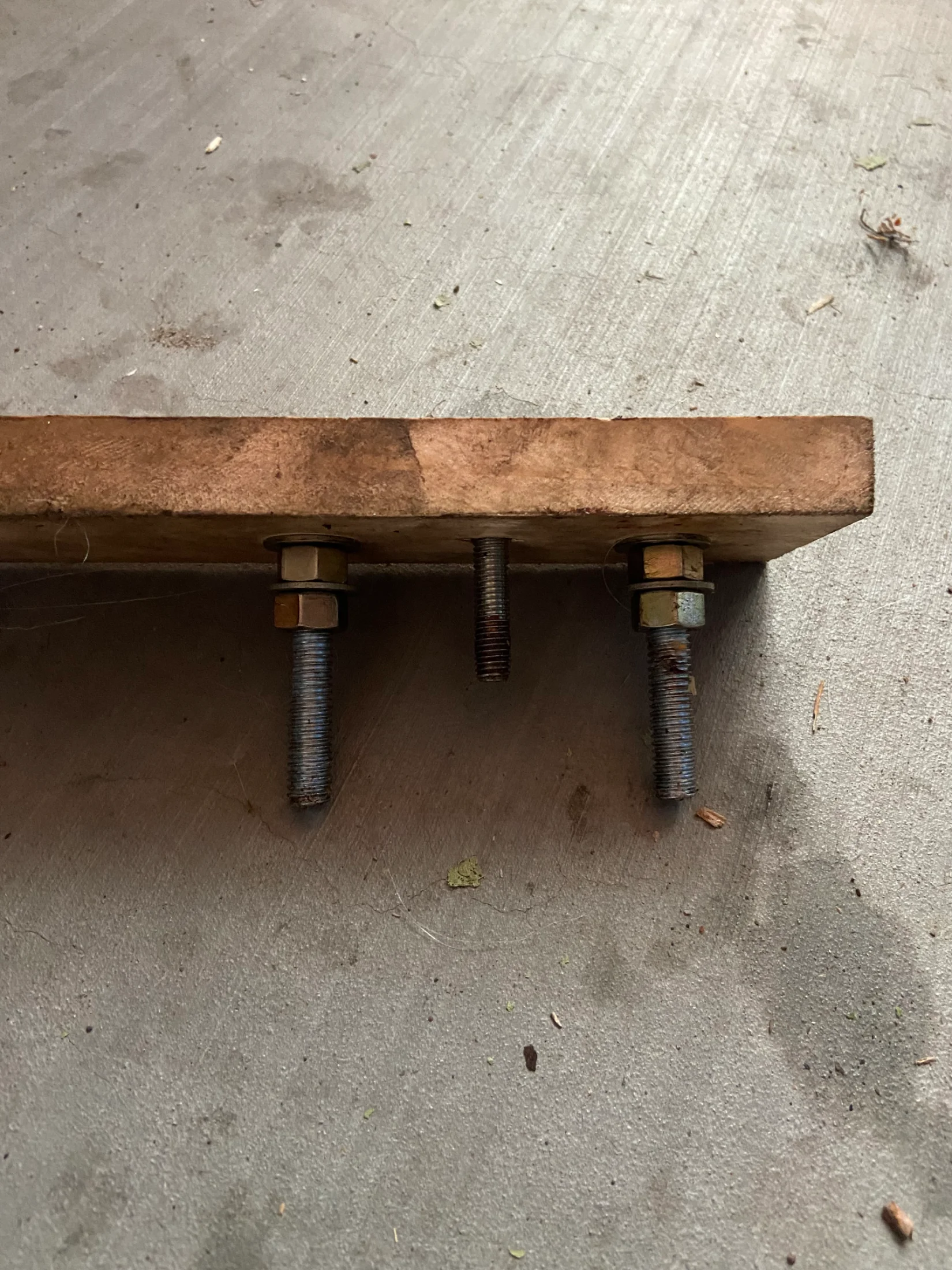

i made mine using some junk from the garage

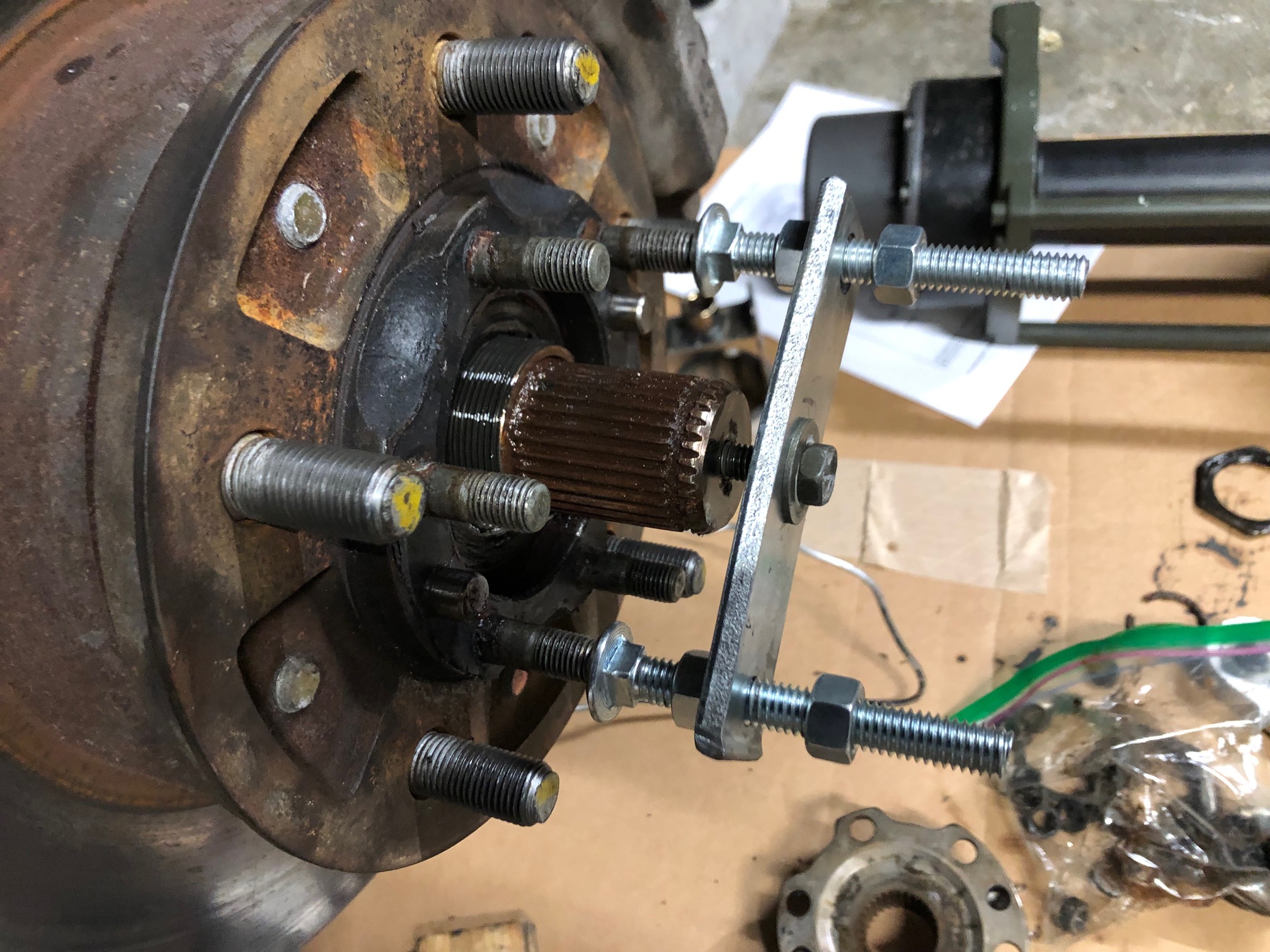

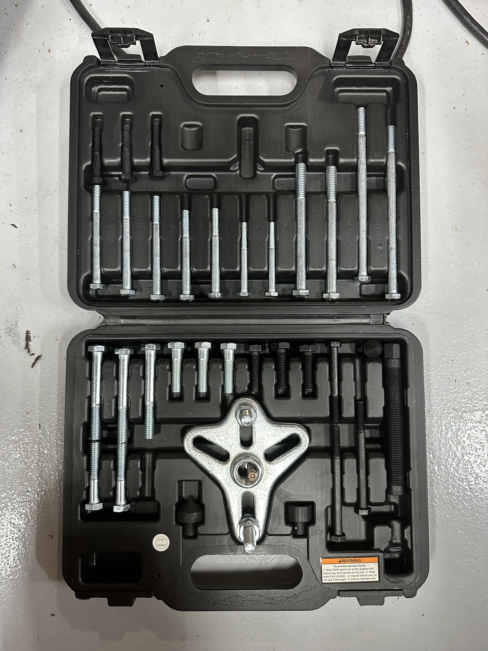

I too messaged TheForger and got no response about his tool. Harbor Freight carries the Pittsburgh Bolt-Type Wheel Puller Set. The bracket inside is the right size and the set is cheap (under $20). You need the bracket, (2) M10 x 50mm bolts, (2) M10 washers, (2) M10 nuts, (1) M8x1.25 x 40mm bolt, and (1) M8 washer. Here’s a couple of pics. The M8 bolt goes thru the middle of the bracket and the (2) M10 bolts push against the (2) raised nubs on the flange. Super easy.

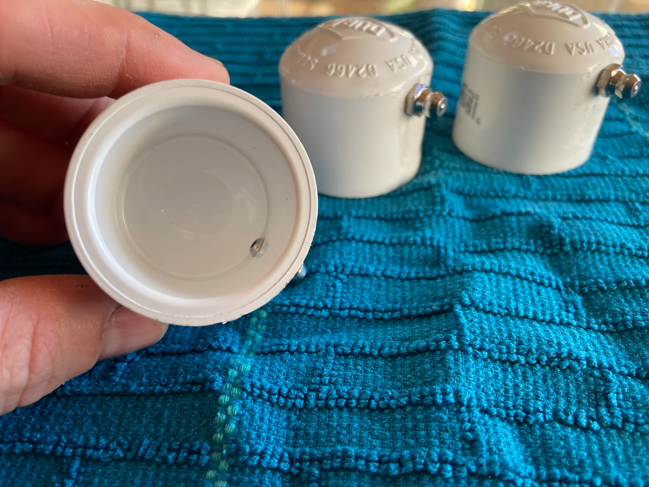

I just made a DIY tool based on another members work. Worked perfect. And I’m super glad I made it. I also made a copy of a DIY jig to grease spindle. After greasing, this puller came in super handy. It would have been a pain in the butt to try and pull the CV by hand.
