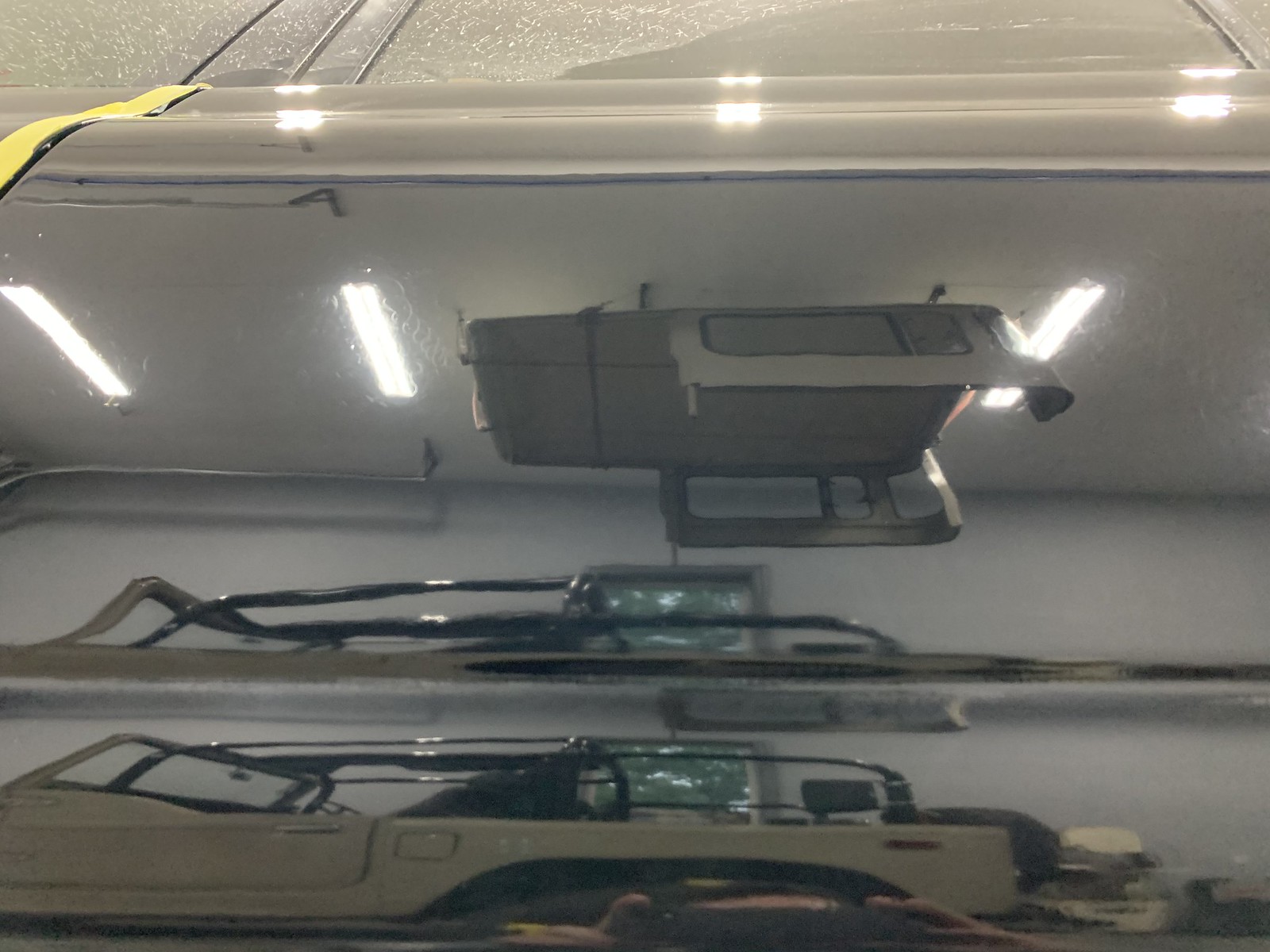

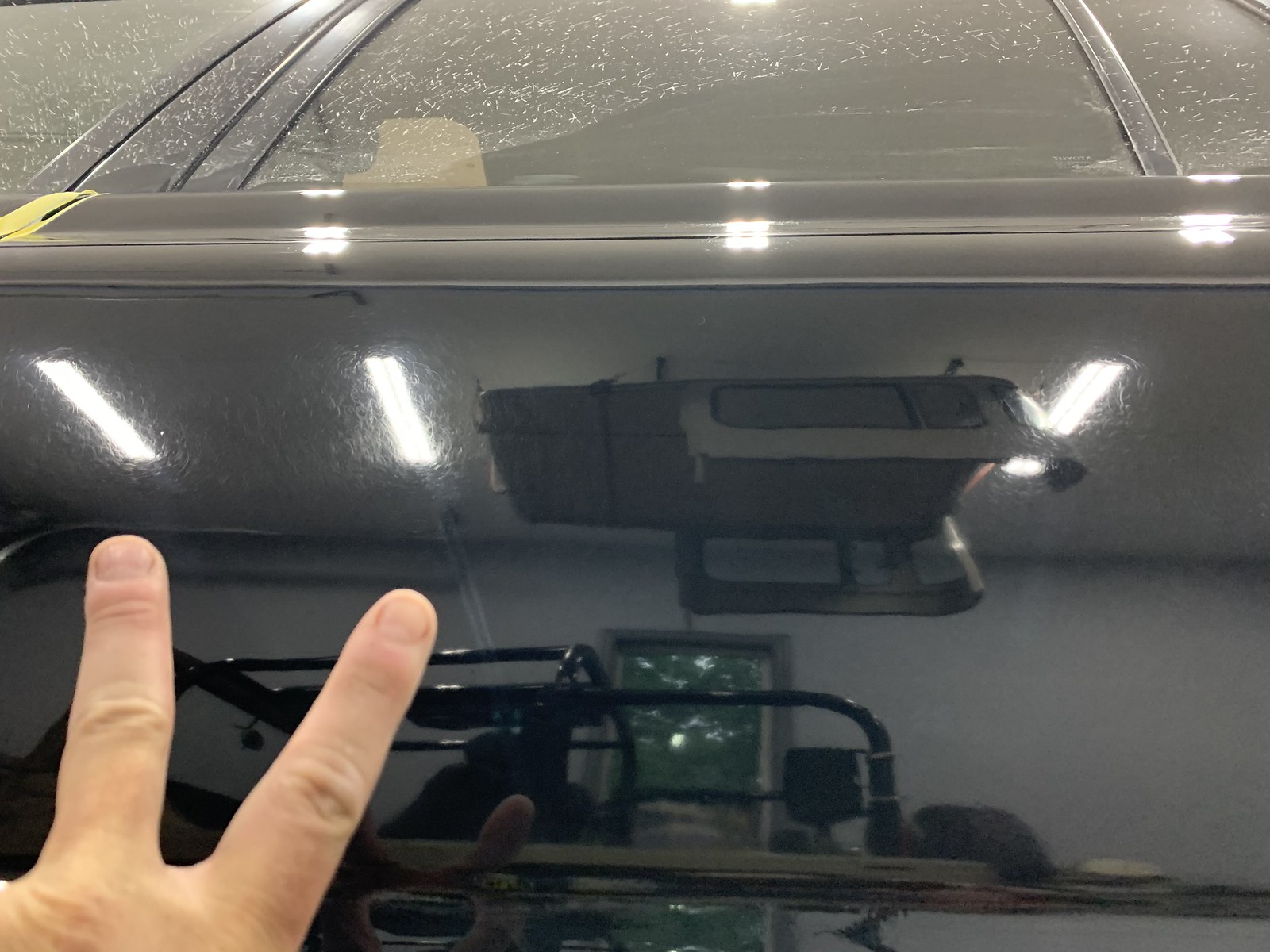

Because misery loves company, here are some "play by play" shots - It took ten cuts (meaning ten passes with megs 105) to go from beginning to end. My goal is to do one panel per day (the passenger door probably took 3 hours to tape, wet sand and buff out).
First shot showing contrast of first pass of compound (top) vs. bare wet sand (bottom)
Second Pass:
Third Pass:
Fourth Pass:
Sixth Pass:
Tenth Pass (still some swirl marks but no one will look at this angle anyway):
Before (zoom in to see the dimples):
After:
