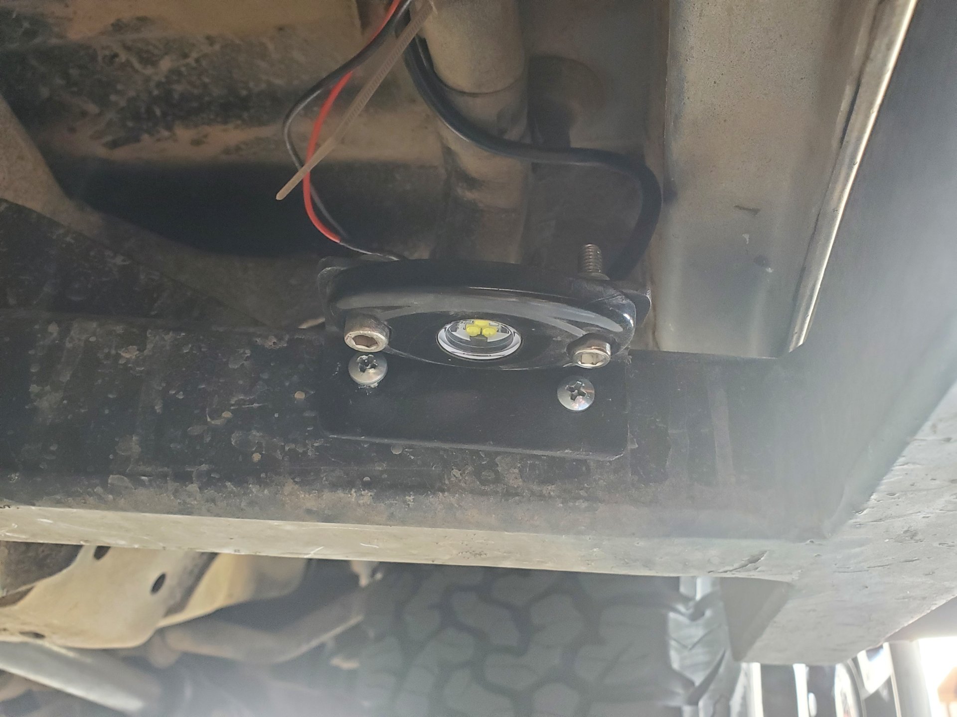

I wanted to do the same as you @qwertyisdead . I was able to grab a set of the MetalTech sliders on a Group Buy through our Club and I had a couple of Rigid's A-Series pods laying in my drawer. I agree, there are very cheap alternatives for lighting choices but I had these collecting dust.
Upon removal of my OEM side steps, I clipped the wiring below the OEM connectors and I tied them into the OEM harness for approach lighting from underneath the rig. They come on with the key fob...and when you open and close the doors as designed.
