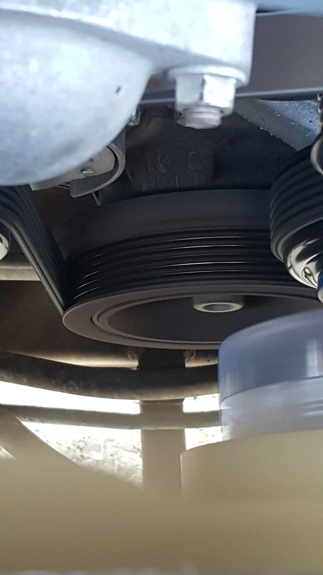

Just had my timing belt, waterpump, pulleys, serpatine belt etc replaced. Looking over my car it looks like the crankshaft pulley (is that what im looking at in the picture?) has a little vibrational movement while running. Is there a bearing in the pulley, or what exactly would cause this movement? The bolt looks like it has a 1/32nd of movement while rotating. Sorry for the bad picture and explination. Im at work so trying to be quick about the post. Jusy trying to figure out what I need to prepare for in repair or if i just let it be.

So after looking at it again it looks like the bolt has more wobble than the pulley. Do you think something more is going on, or do you think replacing the harmonic balancer and the bolt will solve this issue?

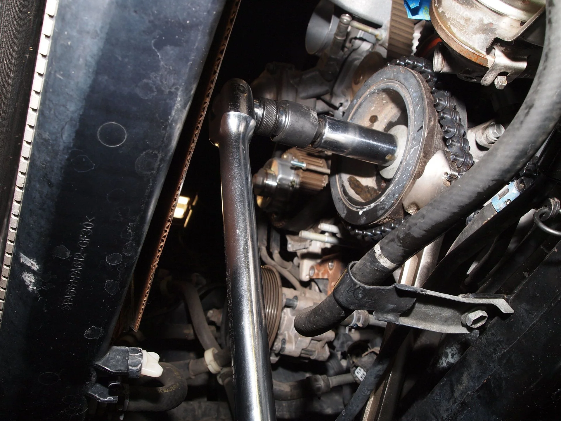

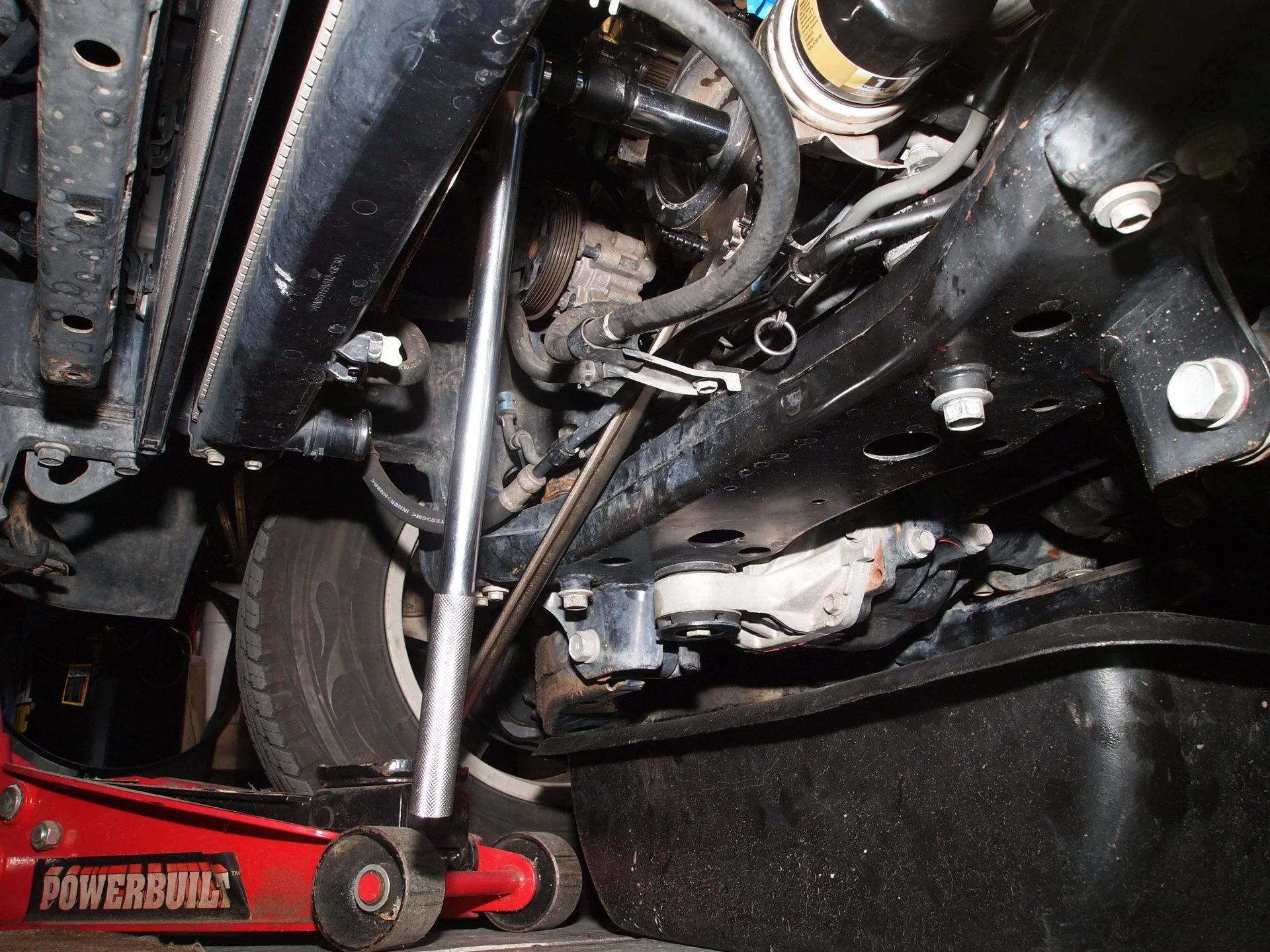

Okay after doing some research can i use the method in the this Youtube video ( ). I plan on tackling this from under the car, since the fan clutch will be in the way. Is there an easier way to torque the bolt with the belt on?

I remove and torque on the crankshaft pulley bolt, using a chain wrench from HF and old drive belt to protect pulley.

I finally got to checking the torque. I had trouble getting leverage on it, but i was able to get about 110ft pounds and it seemed tight. I also had to take a sawzall to my car for the first time to remove the camber/caster adjustment bolts. They seized to the upper control arm bushing. So i'm a little worn out and i'm going to wait to see what happens with the bolt, hopefully replace it in 87K when i go to do the timing belt.
Talked to my service guy who did the timing belt. He said the Sequoia and Tundras he sees with higher miles all look like that. I don't know if he was just saying that or its the truth.

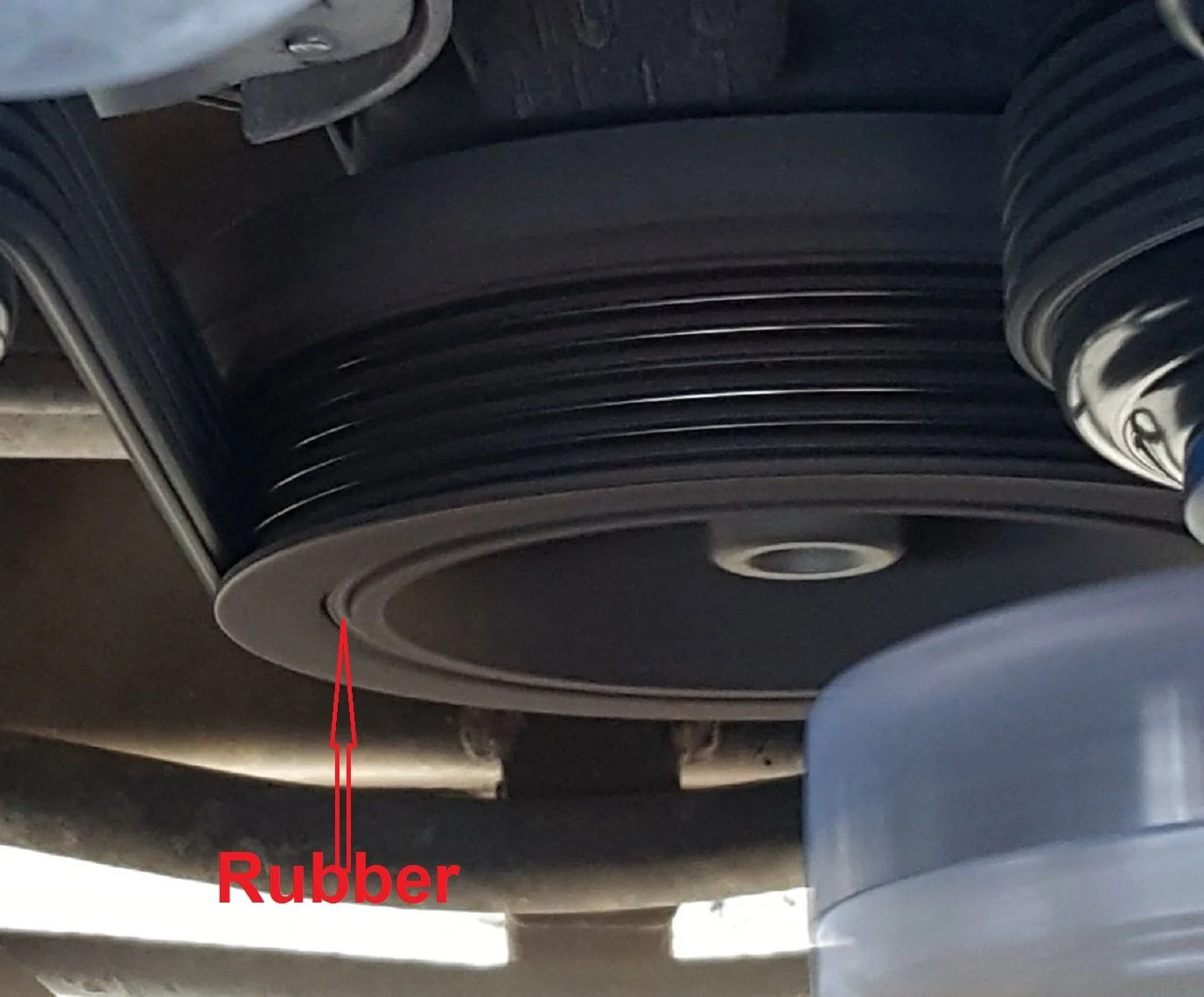

When the rubber damper (shown with an arrow in 2001LC's post) could go bad but I only saw one toyota crank pulley in my life

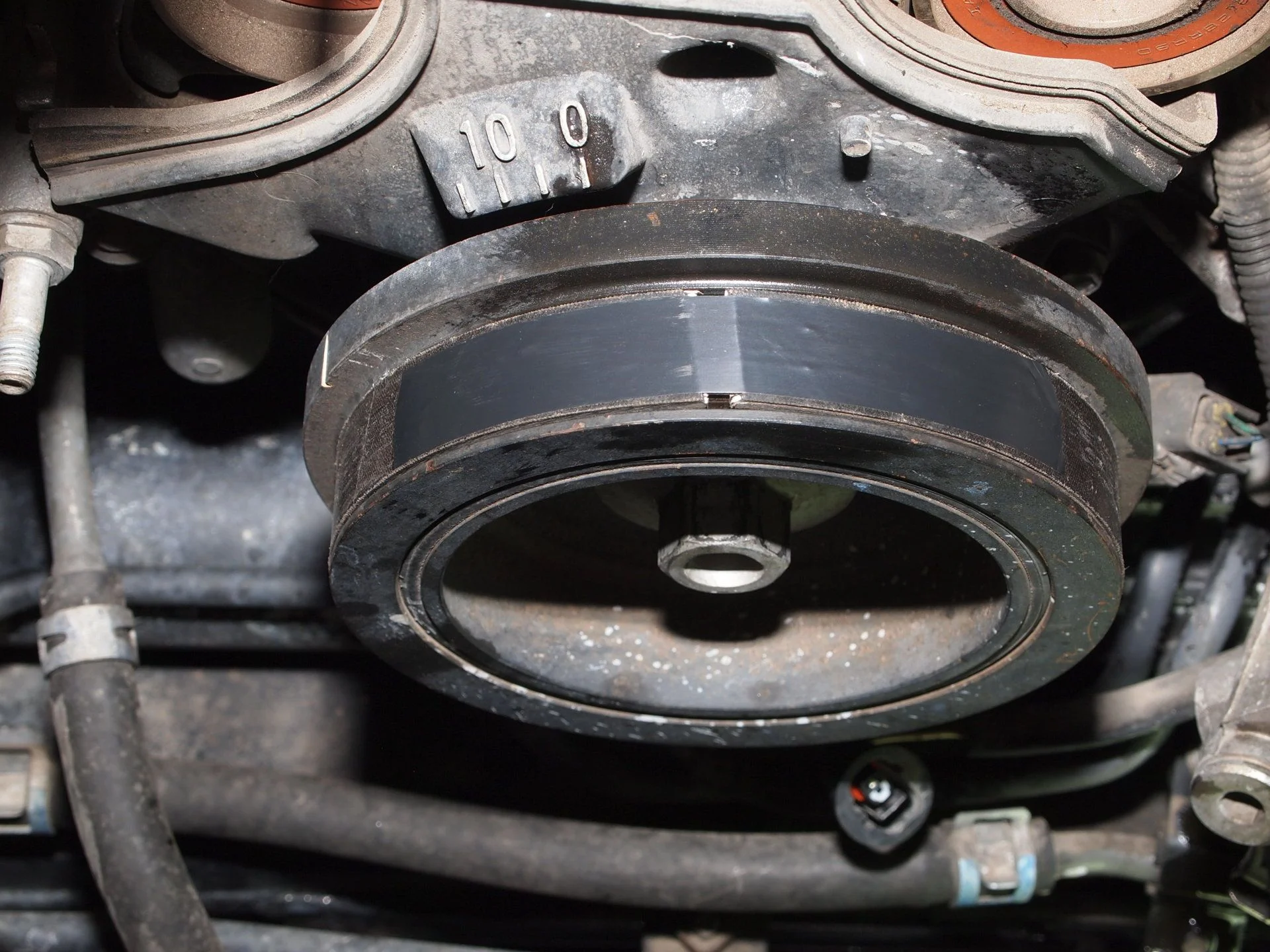

Can you move it in or out by hand, at all, even a tiny bit?
Try this. In the dark, use a flash to illuminate. Be careful not to hit fan blade with light, just pulley. See if it looks better.
Also: It could be and illusion. A difference in shen from dust, oil, moisture, etc could make it look like it's has "little vibrational movement".
If still unsure; hold a long bladed screwdriver propped against something like frame or line you see below, from below. Then slow angle tip of screwdriver against the pulley face near where I pointed with arrow. Just barely touch pulley. See if you get a constant sound, or does it skip like it missing a spot. Missing a spot would indicate a wobble.
That video looks like a broken damper.
