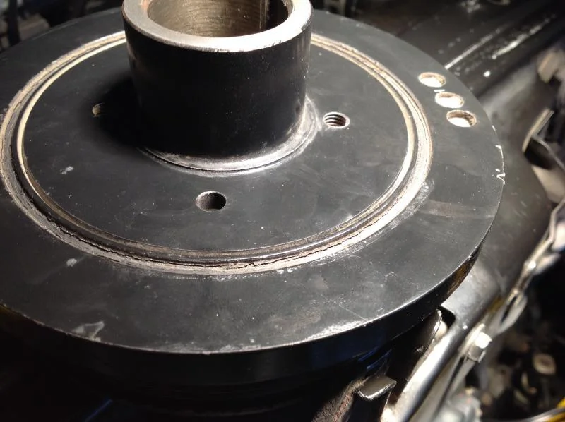

......but for a part that has a job as important as this one, I just can't be sure. This is my harmonic balancer. The rubber is cracked all the way around it on both sides. That seems like it could cause issues, but I really wouldn't know. Where are my harmonica gurus at?! Play me a tune!:confused:
One step closer to solving this problem....anyone have any thoughts so far?

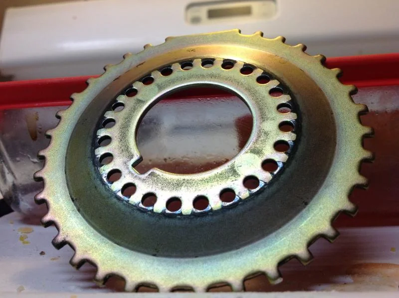

So, I am 99% sure I found my high pitched whine/grind. I believe the crankshaft sensor plate and the crankshaft sprocket have been bumpin uglies. But why?! Might this be the beginning result of a failing harmonic balancer? You can see on the sensor plate and also on the sprocket some wear from rubbing together. The very corners of the teeth of the sprocket are rubbed down a bit and you can see here on the plate grooves from the teeth? Is this normal?! Any help would be greatly appreciated! Thank you.

Using a chain wrench to hold the balancer to torque the nut has been known to damage the rubber on the balencer, just say'n. The reason for the two thread holes in the center of the balencer is where the correct tool goes to keep the load off the rubber.

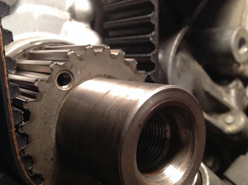

Here's a pic of the timing sprocket that's been slowly getting worked. No timing belt damage at all, but it got pretty damn close. I'm just going to leave this thing apart until I know for sure it was the cracked rubber in the pulley causing this potential train wreck.
Did you have the wobble prior to the timing belt job? When you used the chain wrench, did you wrap the chain around the outer ring of the harmonic dampener? If you did grasp the dampener on the outer ring, that may have cracked the rubber isolator when you untorqued the big crank bolt. Regarding the dampener slipping right off of the crank snout, that's pretty common on Toyotas. The rest of the parts look good. I'm thinking worst case scenario, you just need a new dampener.

Hey turd, you think that plate is good to go? No need to replace? Do you think everything will sit correctly once the new pulleyis on and hopefully not wobbling?
