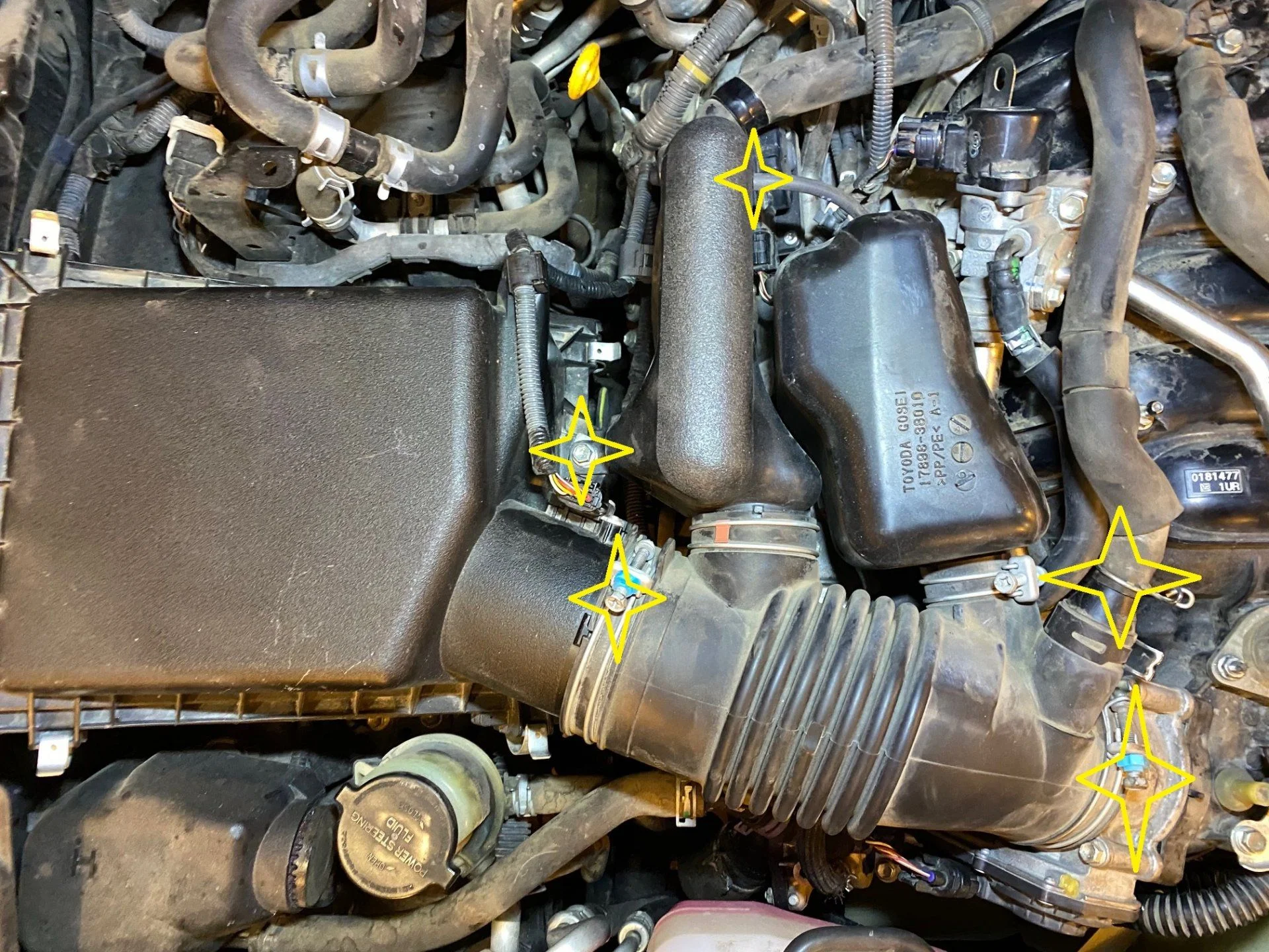

Here is a good thread on the coolant valley leak repair on the 460
You can see between that thread and the PDF I linked to how much less work is involved with a SAIP repair. There is no need to remove the intake manifold for the SAIP repair.
Keep in mind the GX 470 has the air pump under the intake manifold.. different animal.. it was moved to an easy location in the front near the power steering reservoir on the GX 460

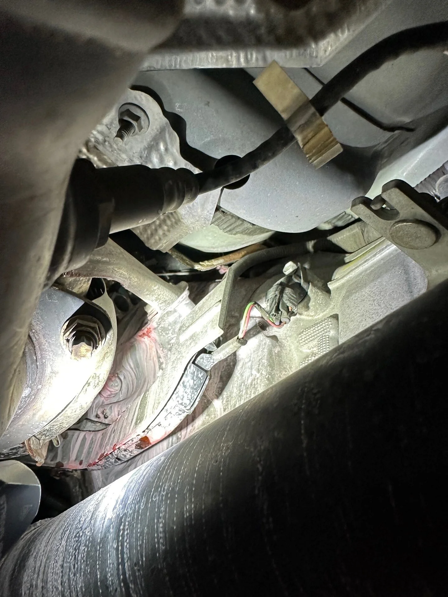

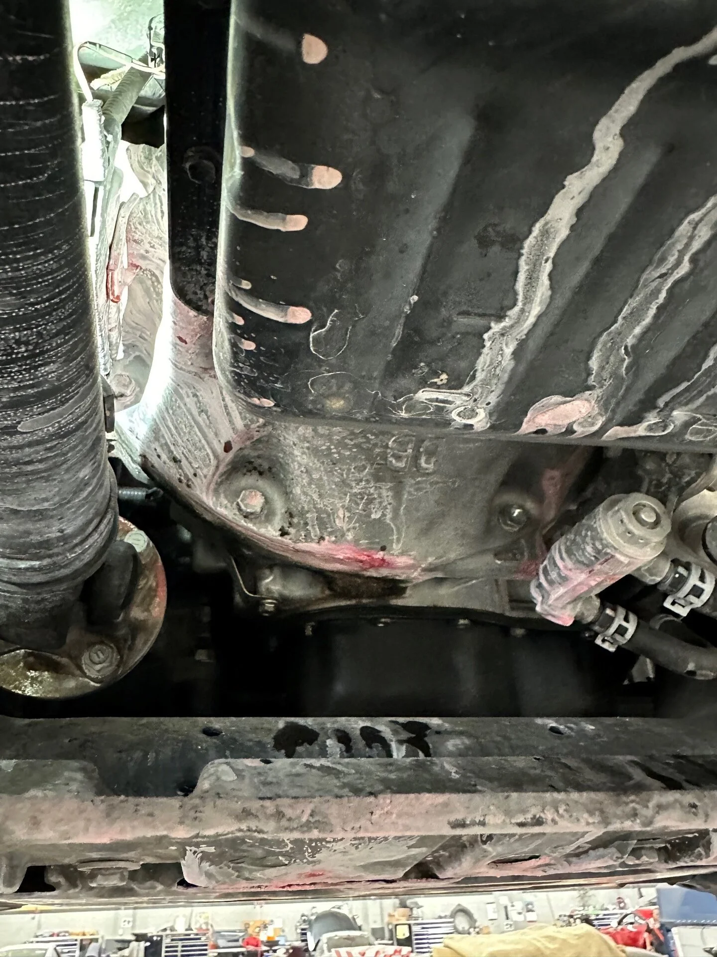

With all due respect to all the great and valuable folks who post, but why is everyone jumping to a valley leak? Albeit, I can't make out the location in the photos very well but does it truly look like that's were it's coming from in his pictures?
I have not been able to locate the leak location. The dealer put “valley plate coolant leak” to the report. Local mechanic said it’s leaking in valley between cylinder heads. I don’t believe either mechanic focused to check whether the leak was coming from a cracked hose.

Coolant Stains on rear bell housing like that almost always end up being coolant valley leak on the 460.
You could use a borescope camera to look under the intake manifold.

I agree with above, this is more than likely the coolant valley plate based off the location(same place on mine). The difference is I had months of coolant level drop before mine looked as bad as your pictures.
