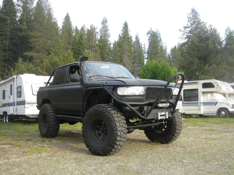

I would like to turn my truck from this...
To this (sans the stinger bumper)! Someday.... <sigh>
