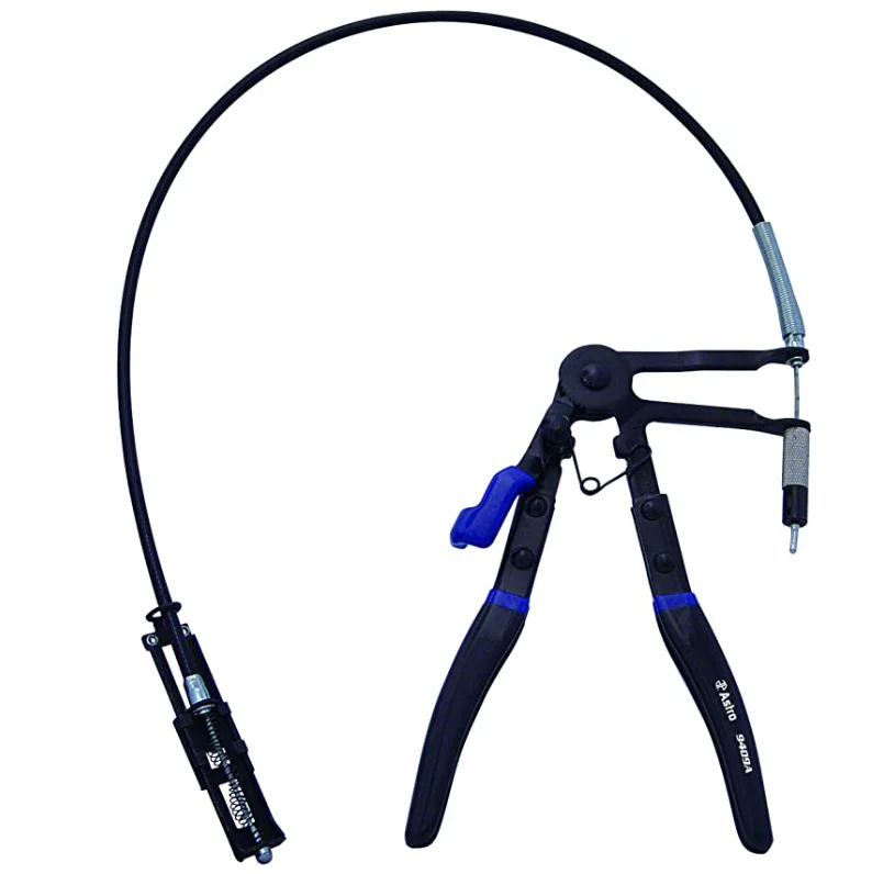

You definitely want (need) to own the special tool to fit and remove the spring clamps though.

special tool? no, I just use slip pliers and a 45-degree needle nose is all you need.
i guess if you really want one one of these would be helpful for the larger radiator clamps

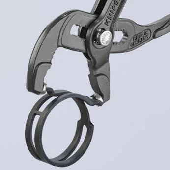

Knipex make an interesting set of multigrip pliers for these style clamps. In tempted to buy a set.
Don't know if knipex are available in USA. They make high quality tools IME
