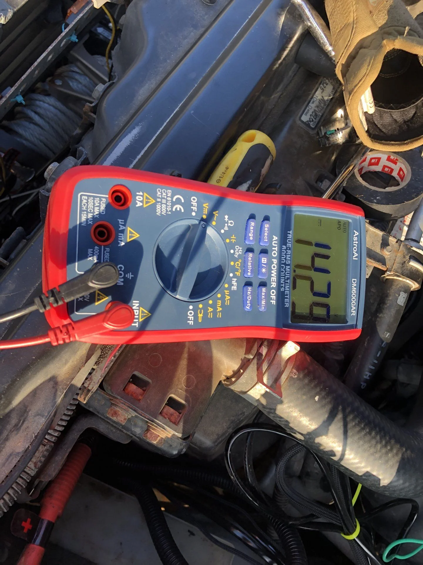

I'm updating this for search purposes for people in the future if they have the same problems. I took the alternator off again today to investigate the wiring harness. The 3 wire connector seemed a little ****ed up and the retaining clip portion of it broke off. It slid easily in and out of the alternator. It looked like it should still be making contact but clearly something is wrong because its not charging at all at the battery. So I ordered a new connector to see if that fixes it. The fuses looked good to me. I have a feeling its the cabling somewhere.
Success. Replaced mangled connector and new alternator shines bright.
