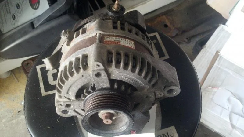

Or there's this option:
Amayama appears to have a new OEM 27060-66040 and the price is right,
only ~$1500 shipped to the US.
It’s discontinued. They don’t have it.
