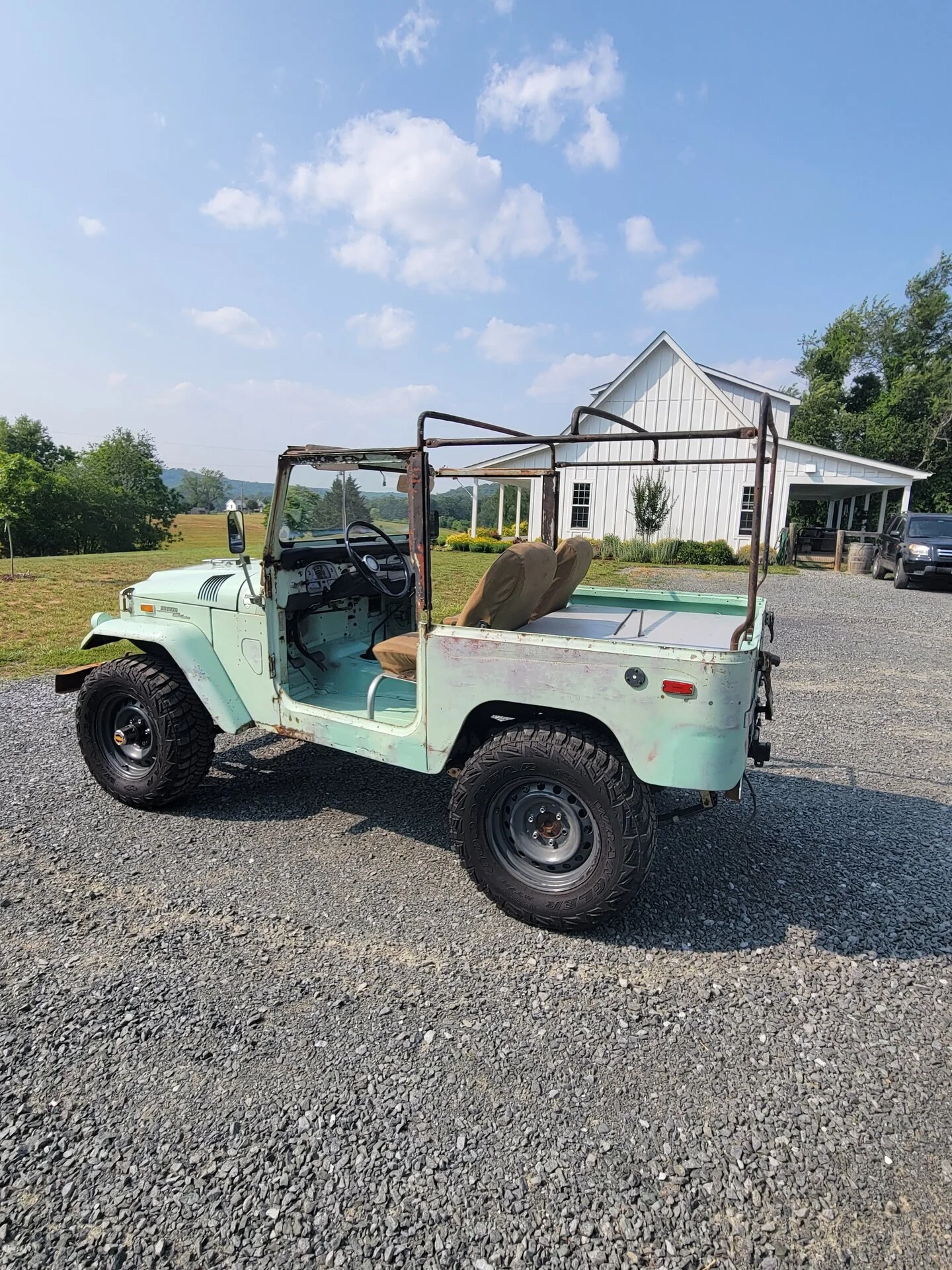

Got the soft top bows on today.
I think you will enjoy it the size it is, with the right lines, you can really have fun with it and it is so much more fun to drive on the road. Ask anyone who has wheeled with my in Lynchburg Lemonade, they will tell you, you do not need big tires.

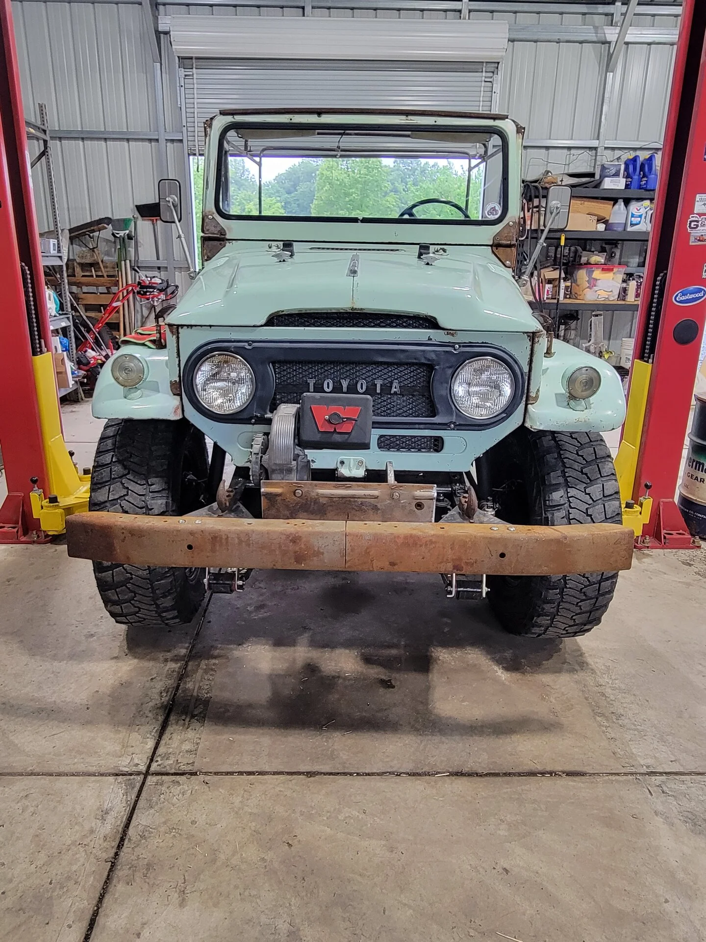

Still some work to be done to fasten it to the frame rails, but it looks pretty good. Not bad for $300. :hillbilly:
Sexy!
Those winches look right at home on the front of a 40
