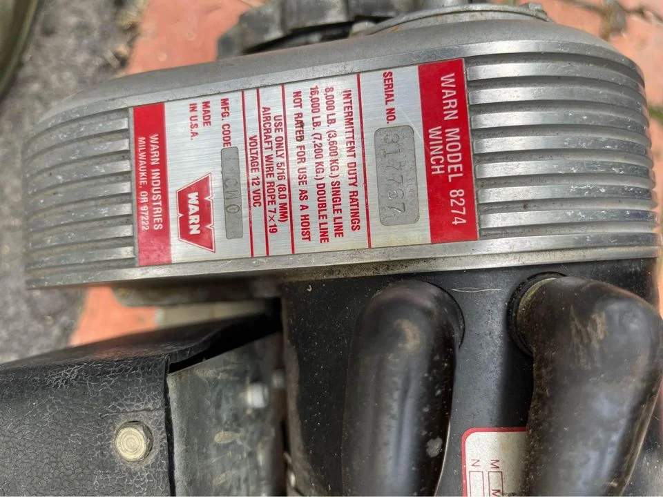

Got the 8274 mounted last weekend. Also had quite the death wobble happen last weekend when I took it down the road for a quick spin. Turns out that my u-bolts were hand tight! Ha! Just happened to see them this morning. It will be getting an alignment in the next couple weeks.

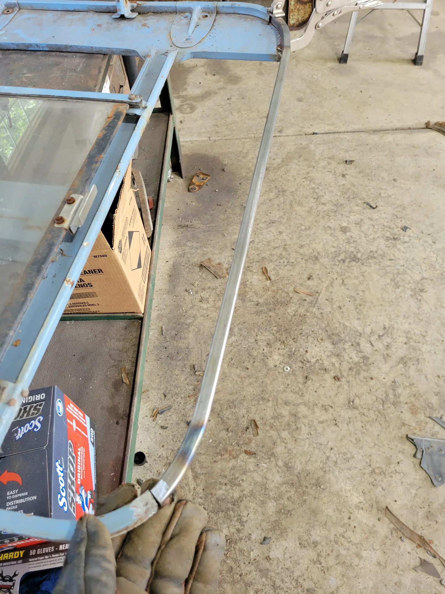

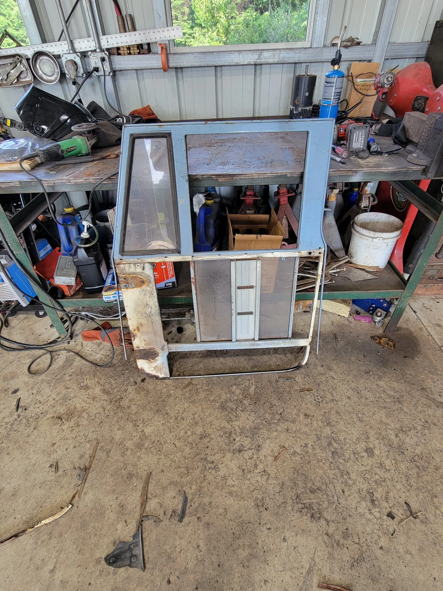

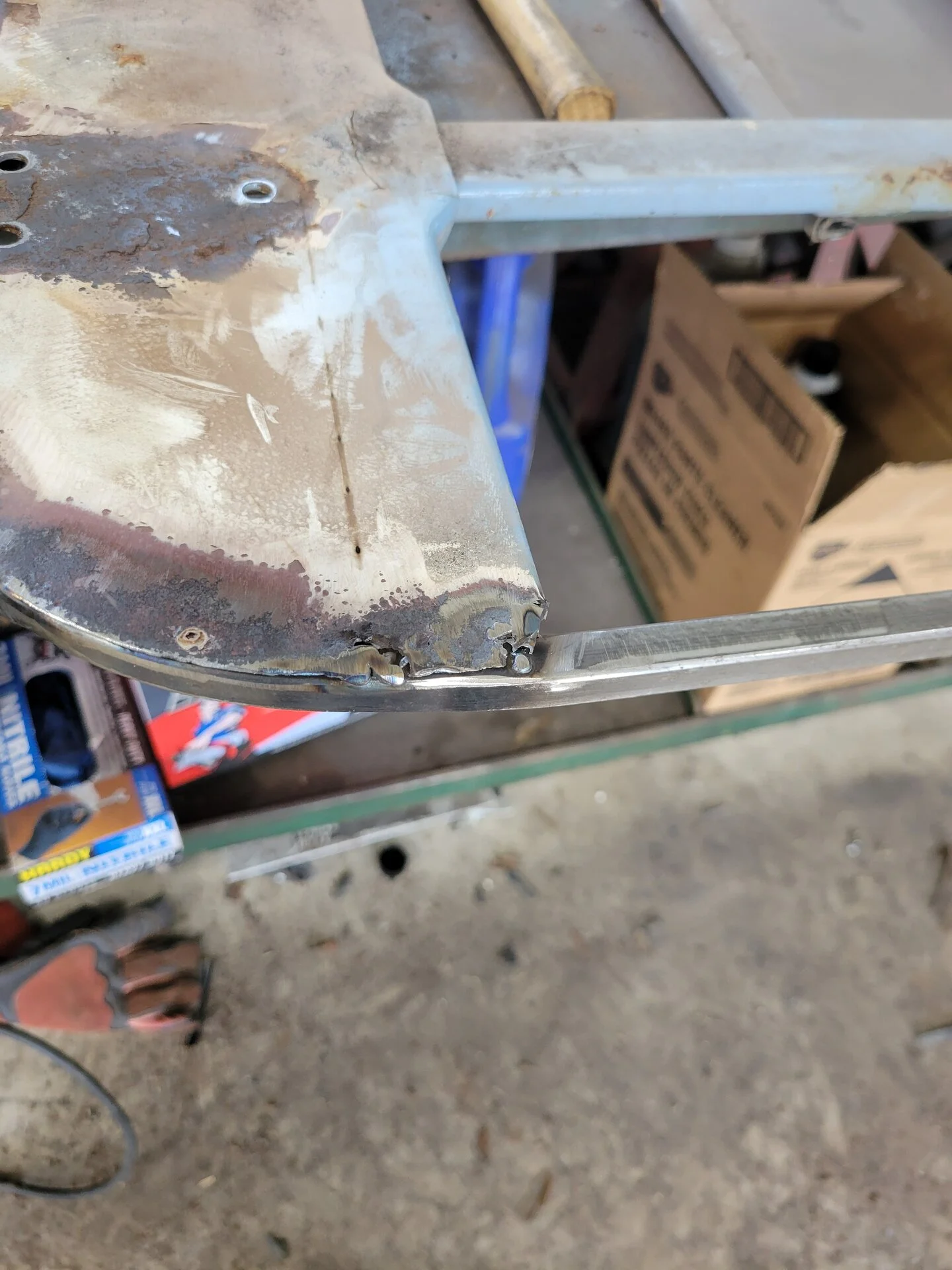

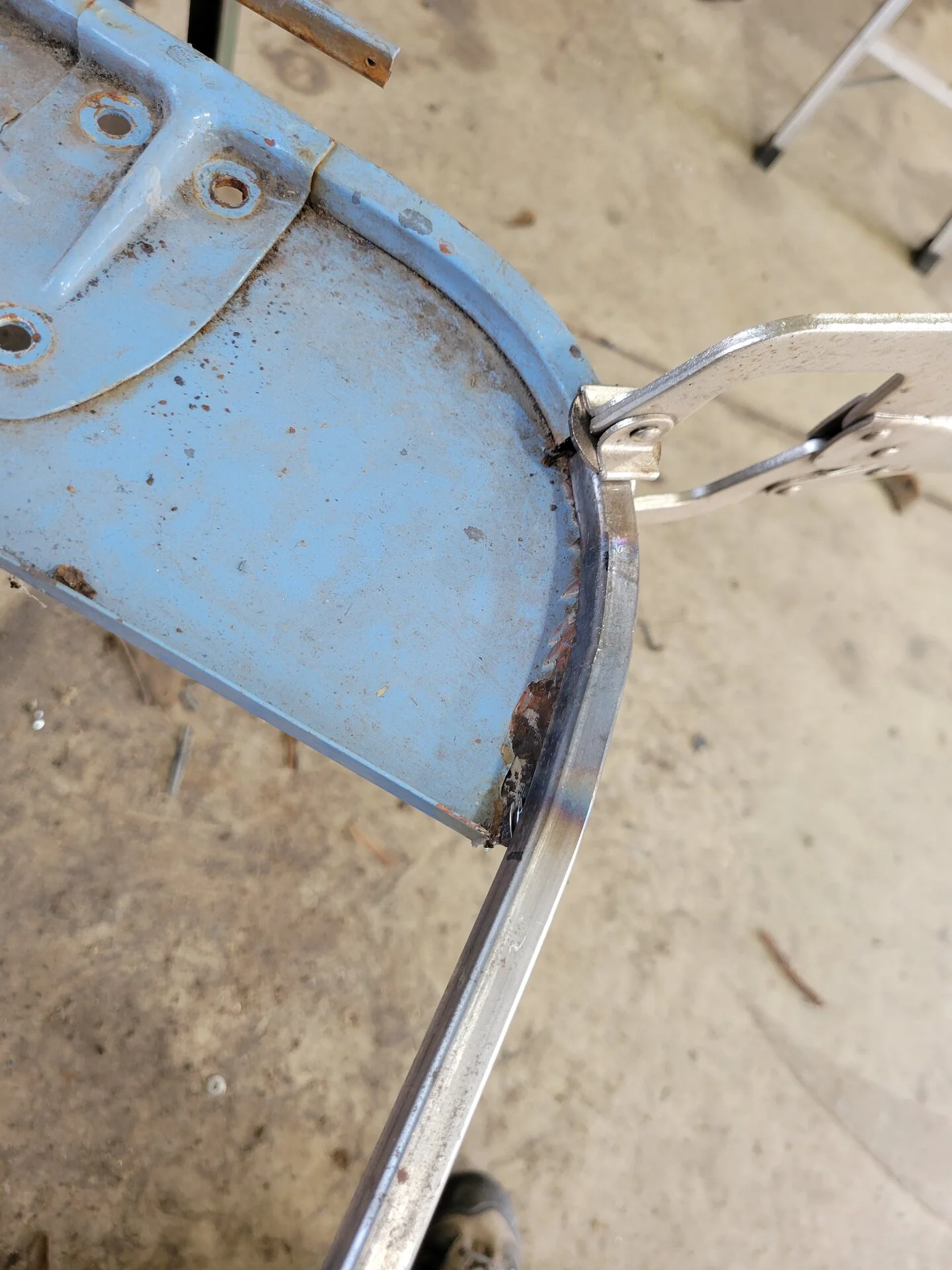

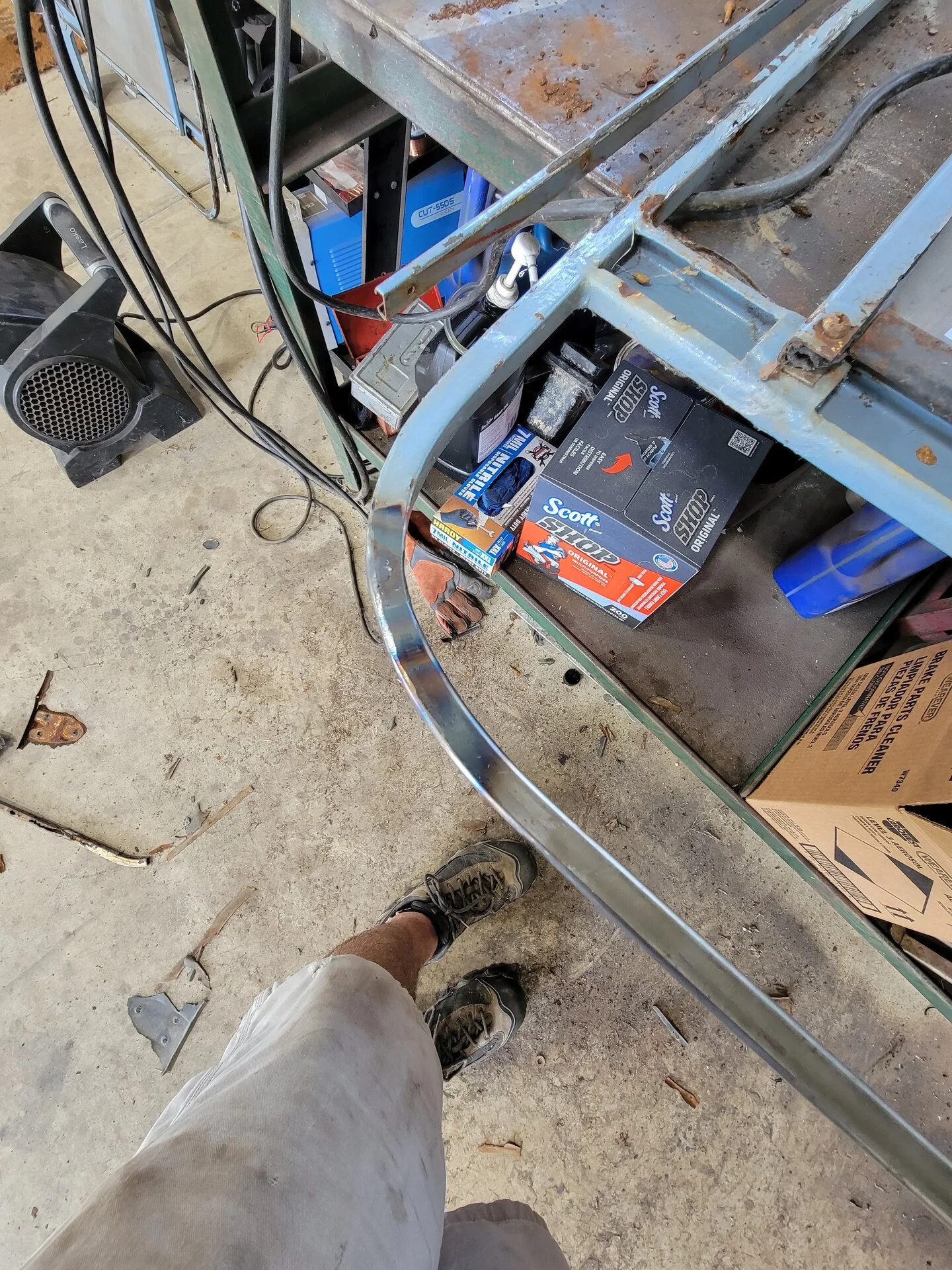

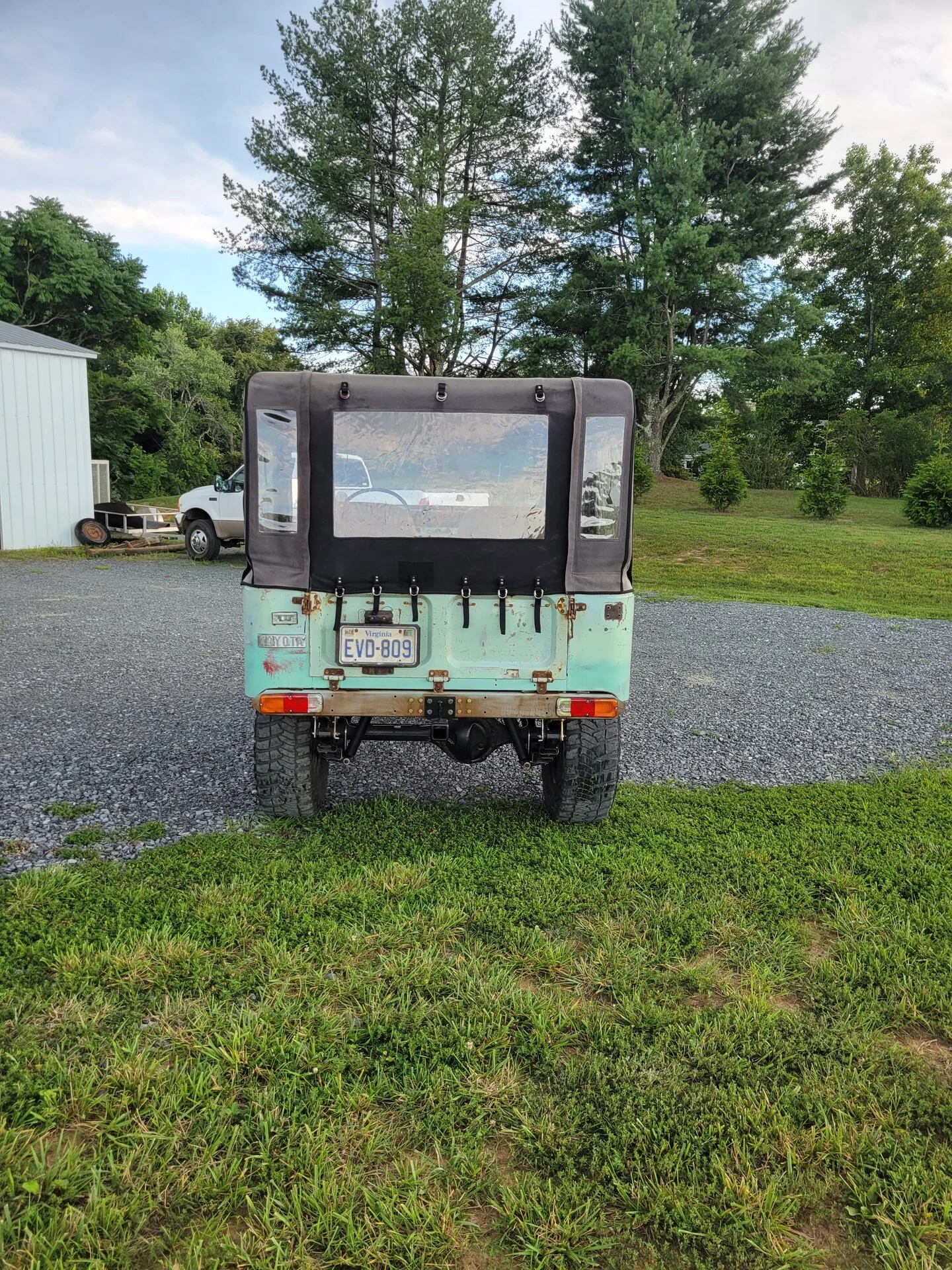

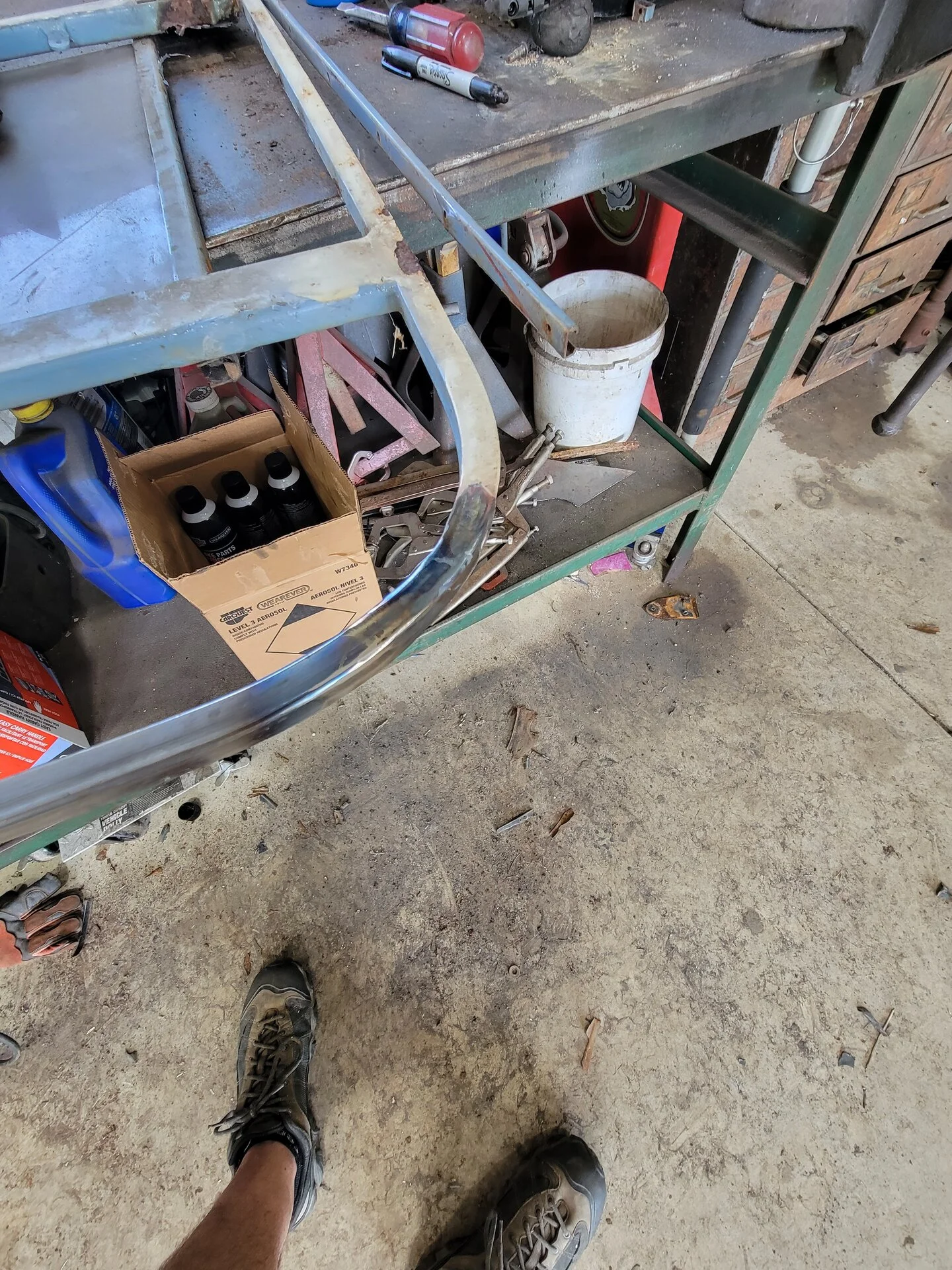

Fixed the driver B-pillar yesterday and got the top on today. Pulled it out into the sun to heat it up and stretch it to fit. Got new door skins and weatherstrip from sphincter off road, so that will be an upcoming project.

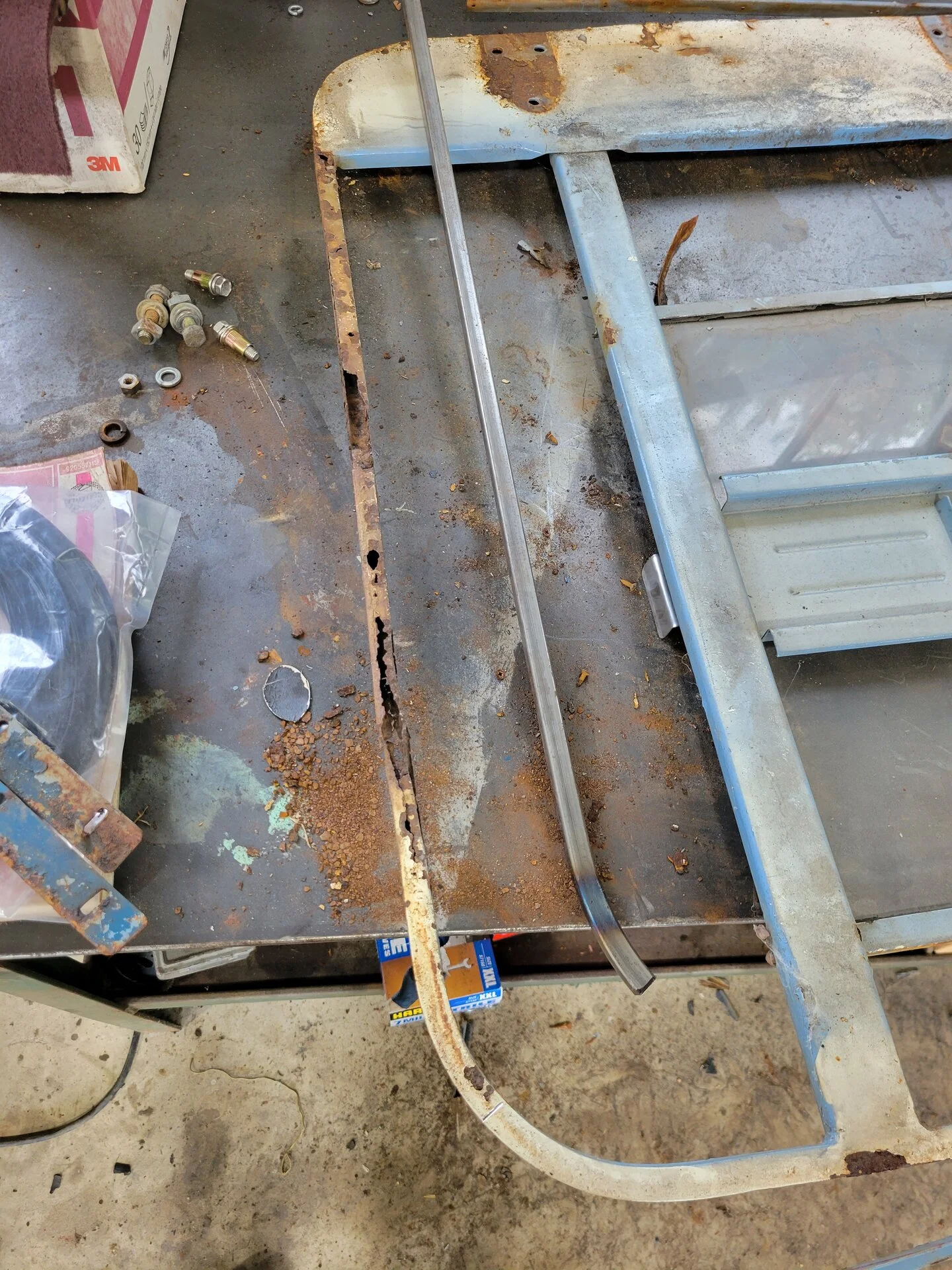

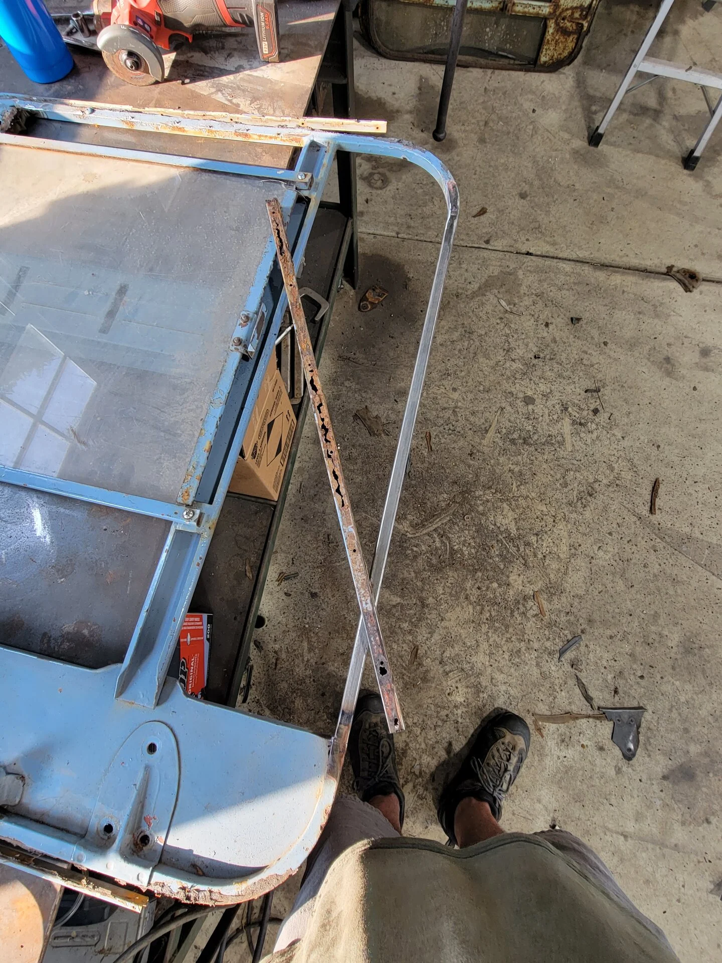

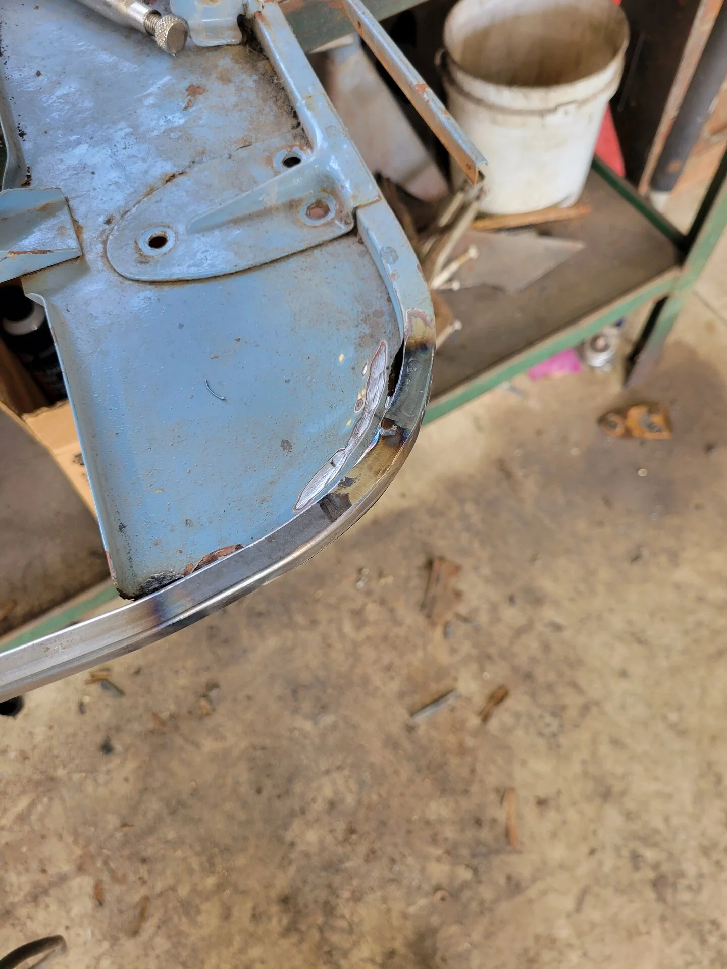

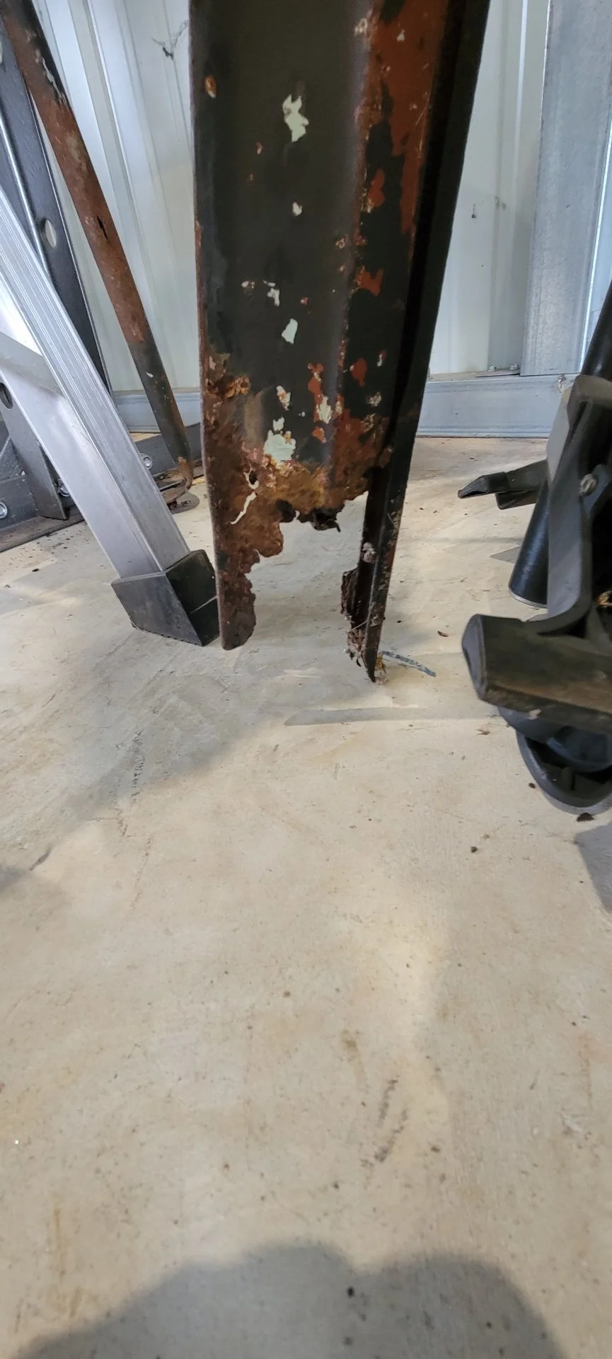

Got the bottoms of the FST doors repaired this past weekend. Paint is next , then new canvas skins.

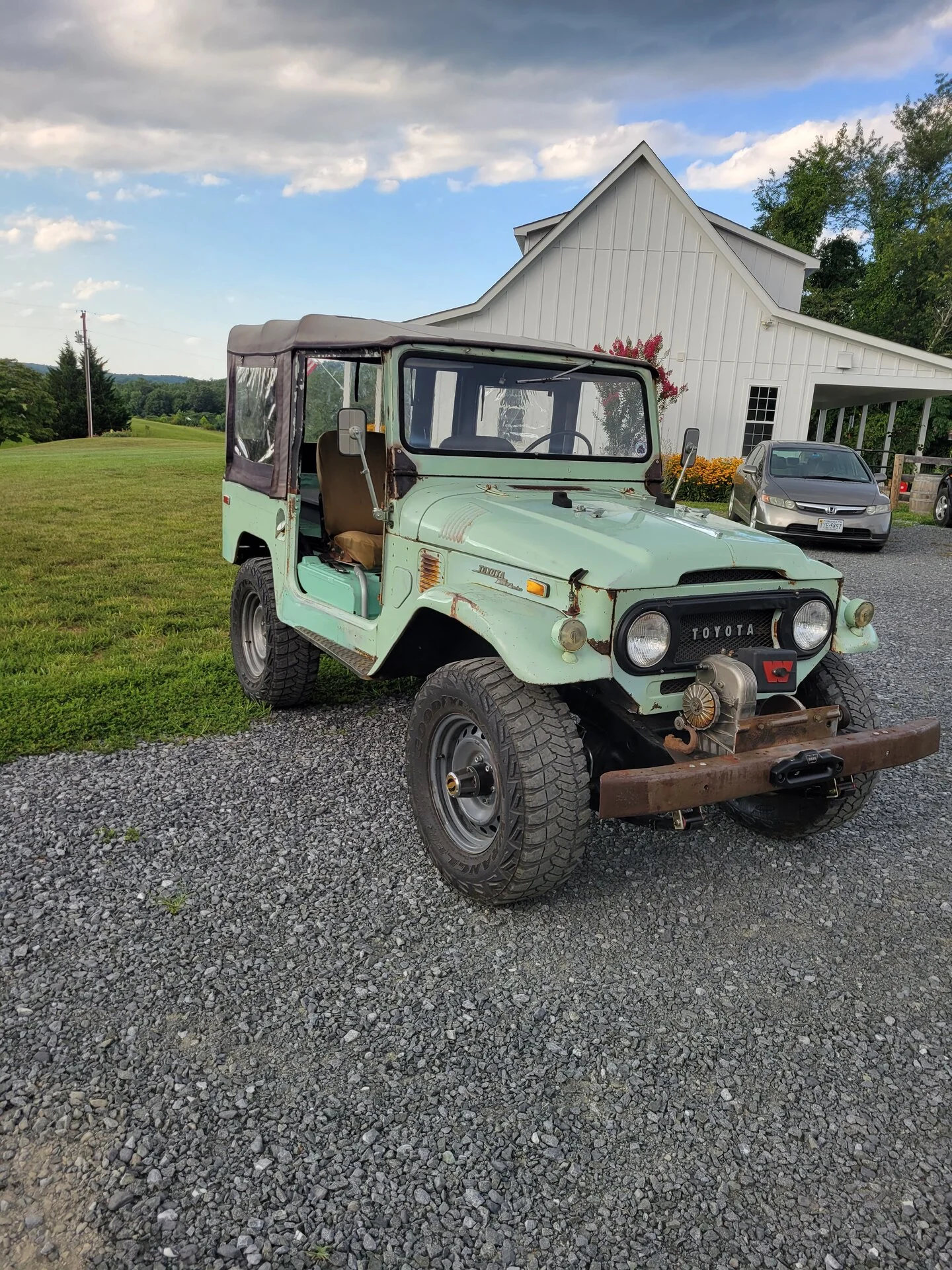

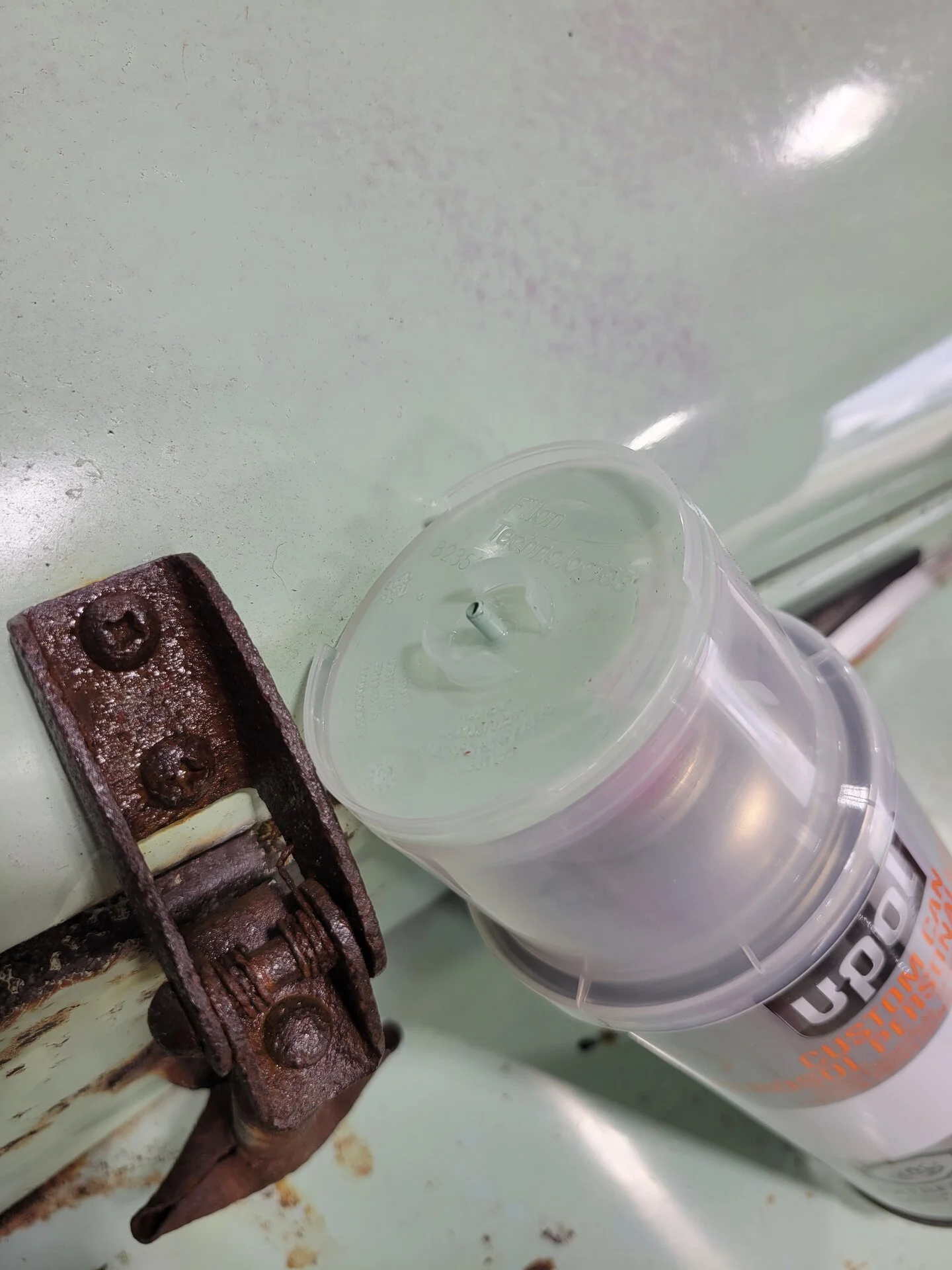

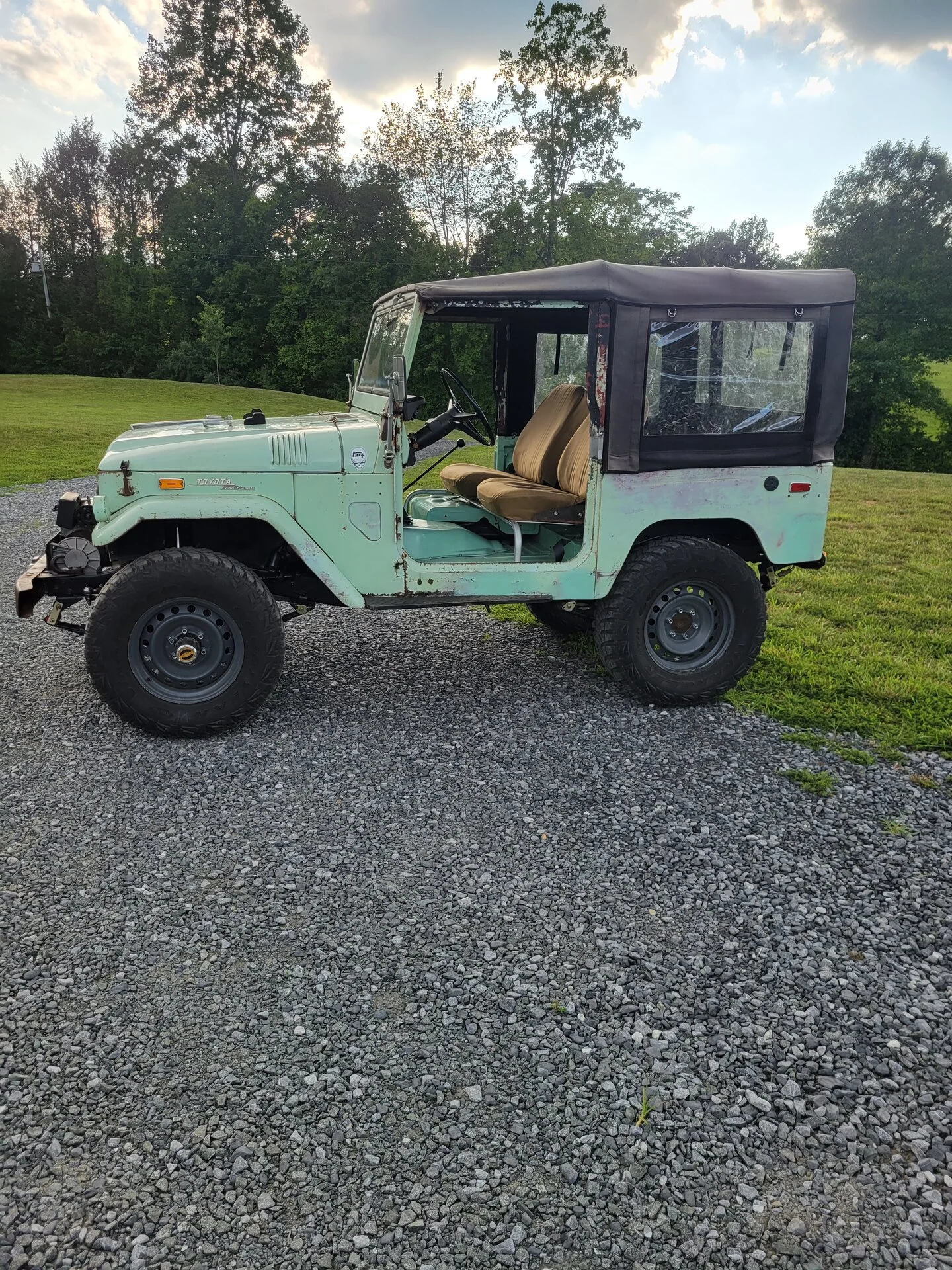

I didn't really like the way the new Spring Green paint matched the old on the body repairs I did. So this morning I went to a paint shop, that has done some color matching for me in the past, in Manasshole, and took a kick vent with me. The result is a perfect faded Spring Green in 5 spray cans. FST bows, doors and running boards will be matched to the patina on the truck. I will also be sanding and repainting the areas of body work I did. Pretty excited about it.

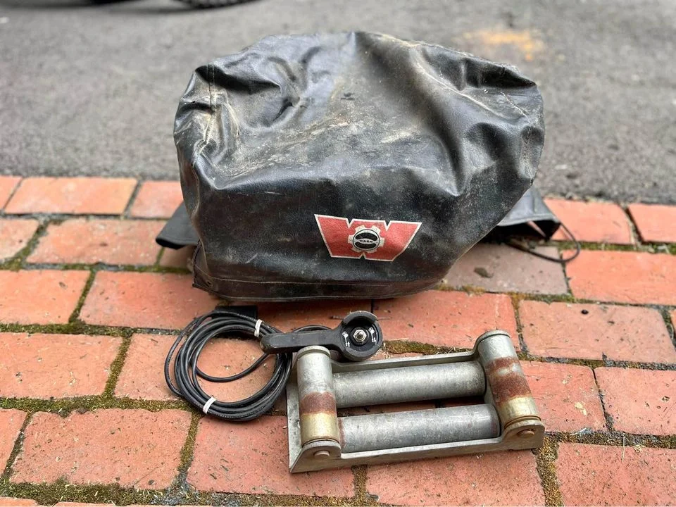

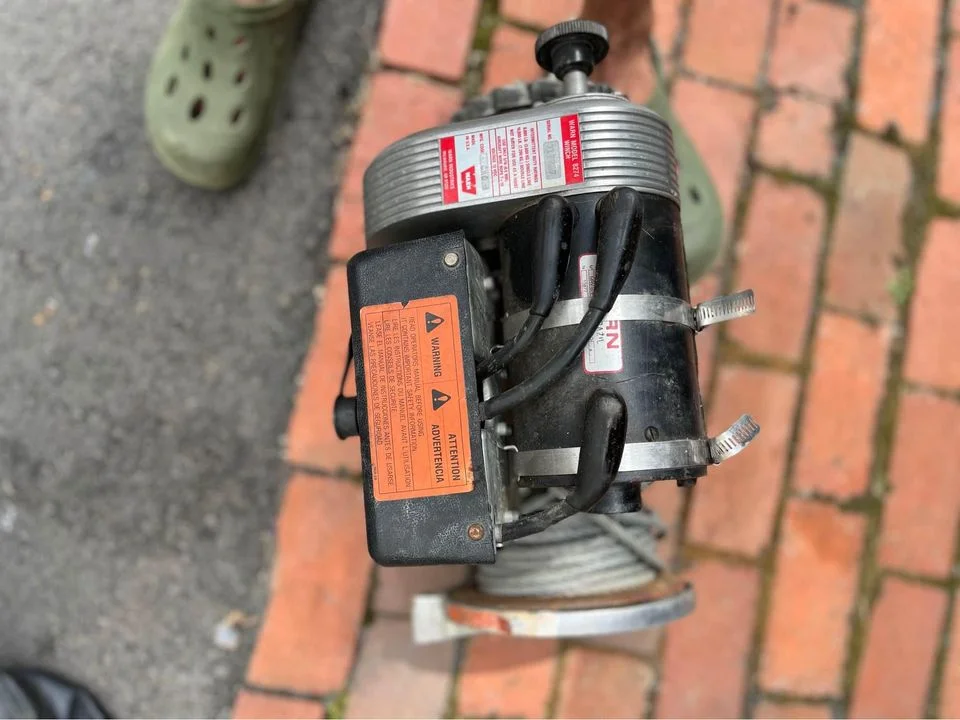

Snagged this minty guy for a great price tonight off Fakebook marketplace. March 31,1980. It was on a fire truck all its life. Going to go on my '76 40. Its dirty but really clean, if that makes since.
