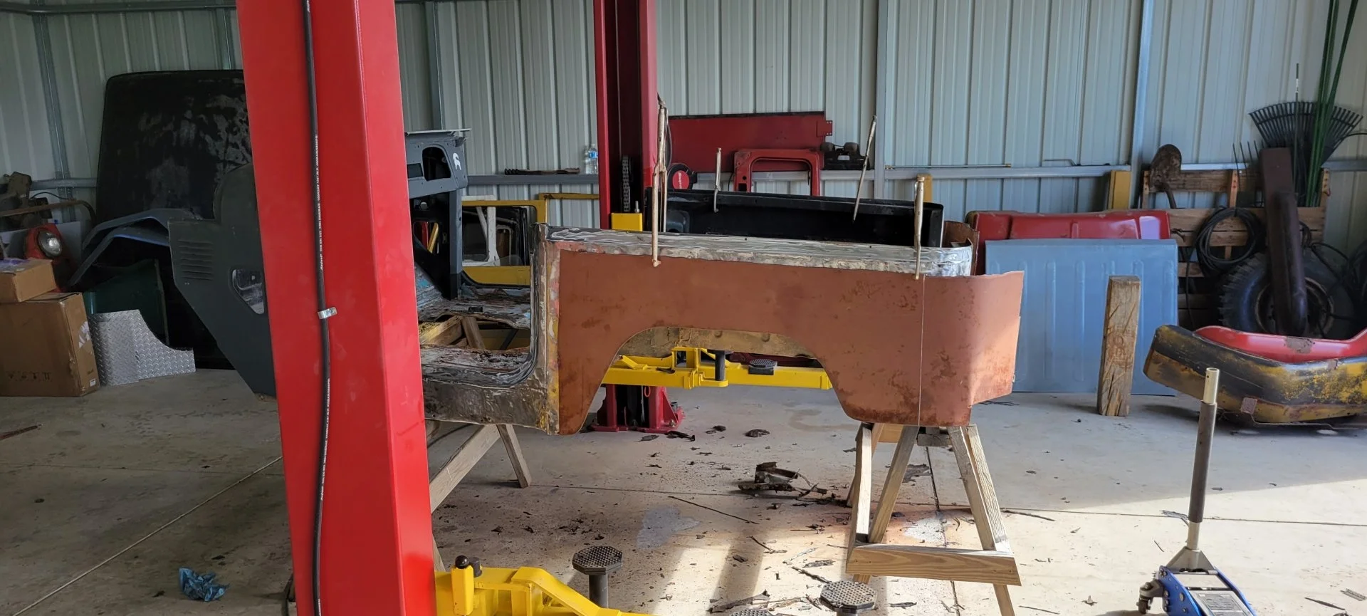

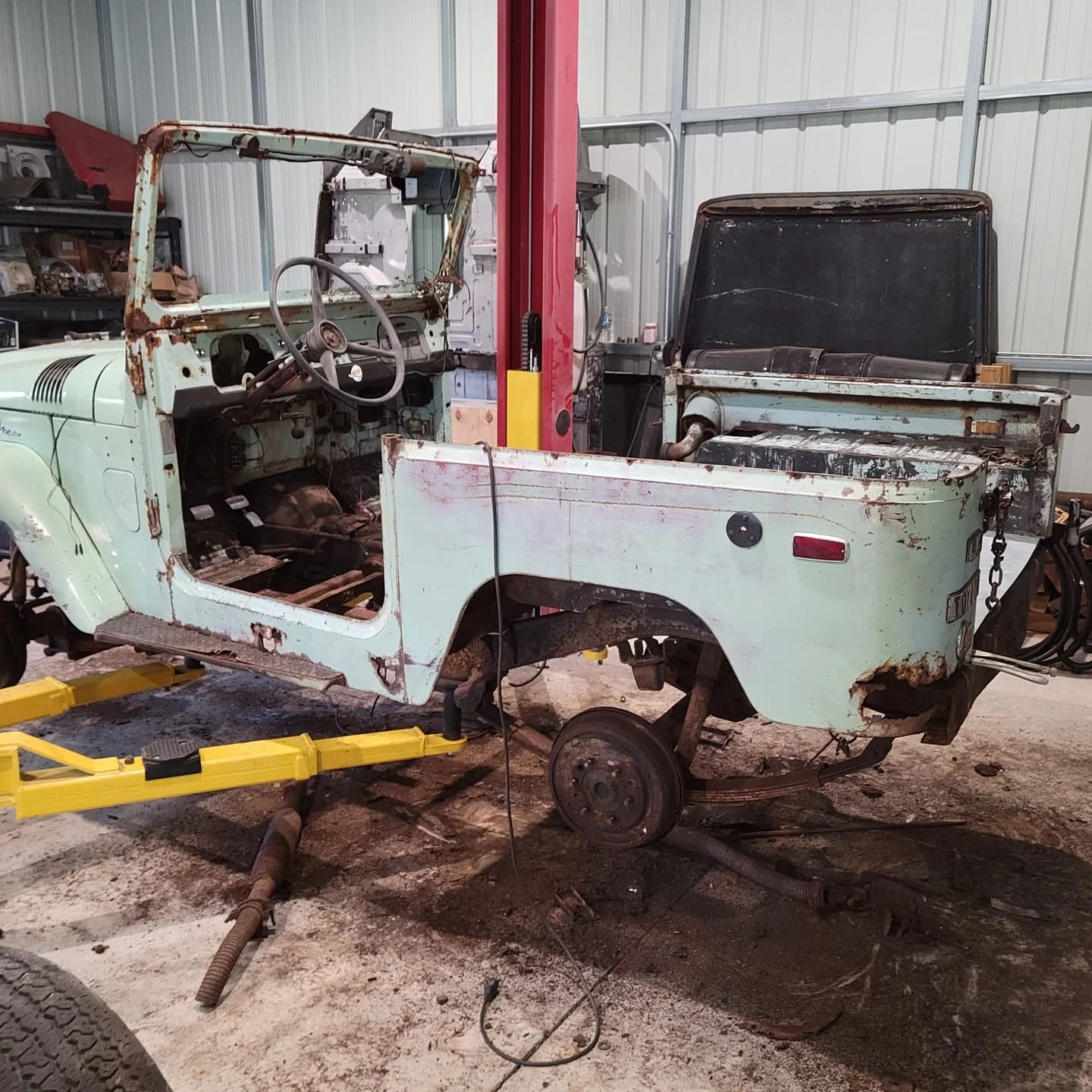

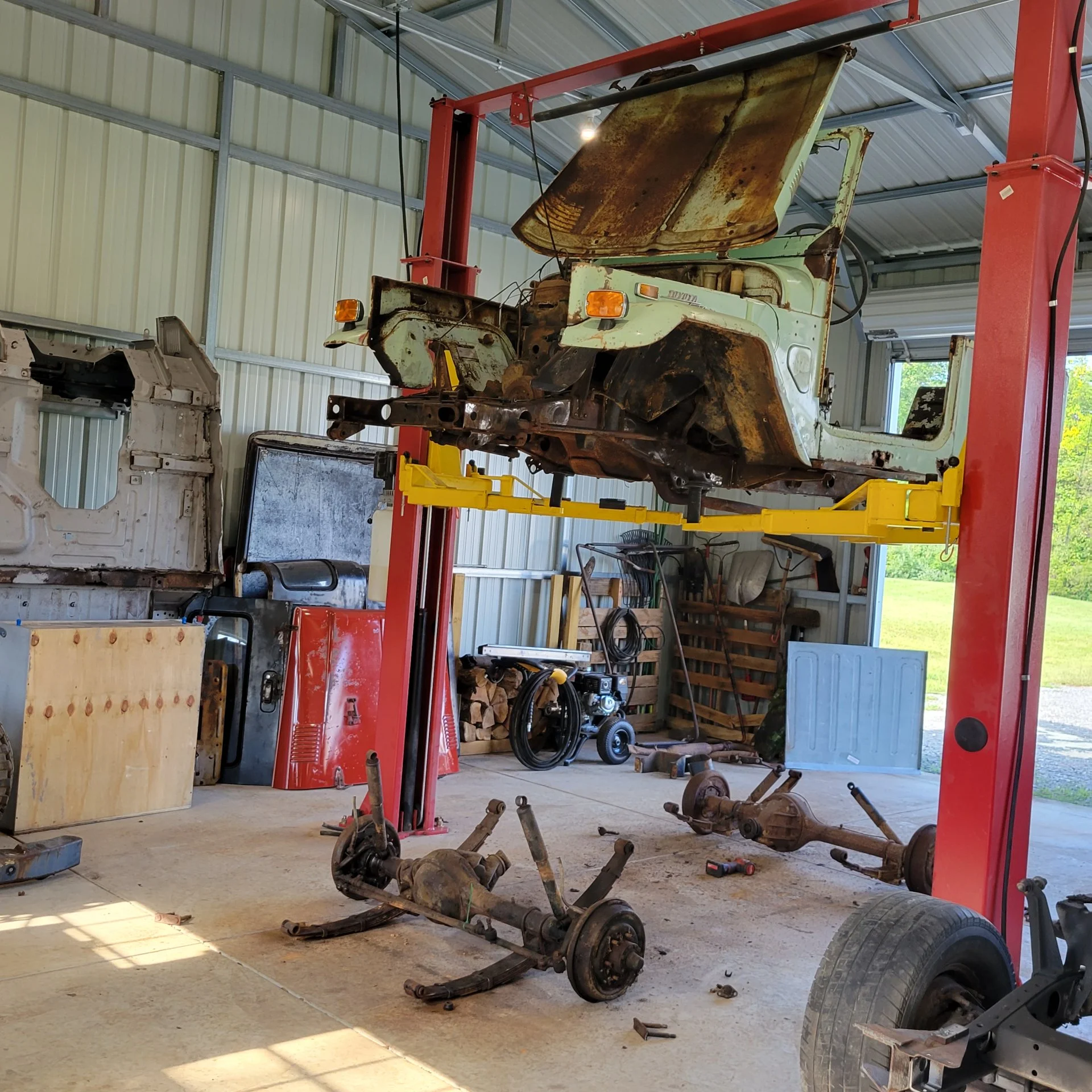

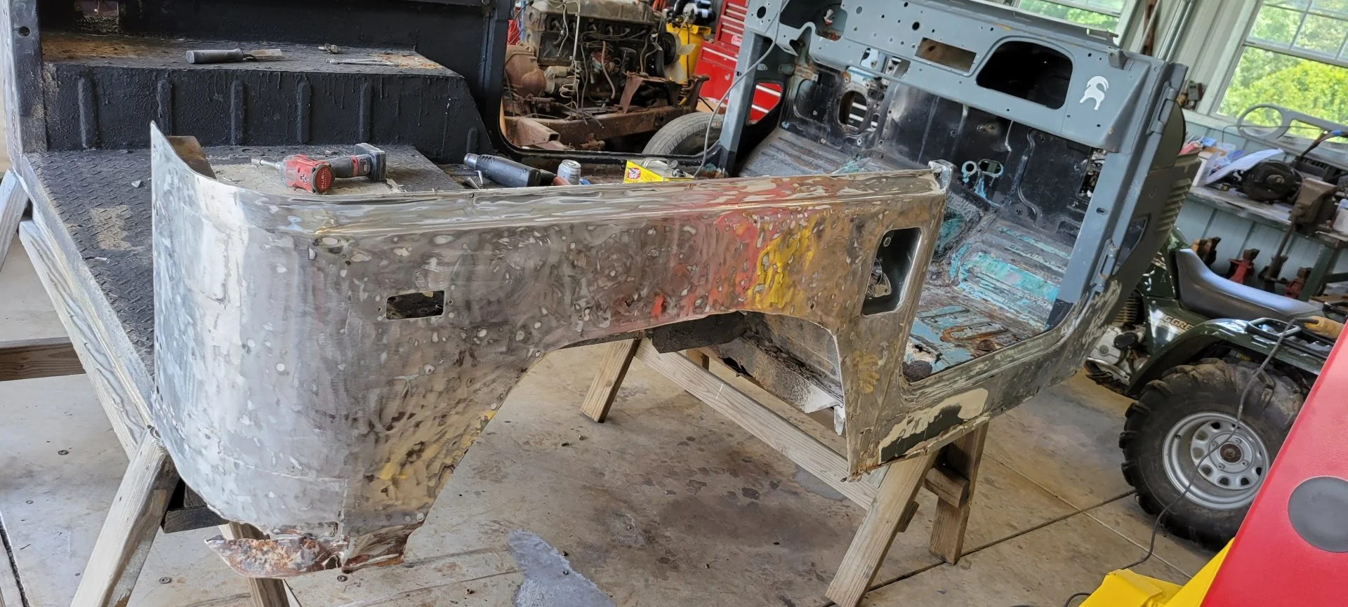

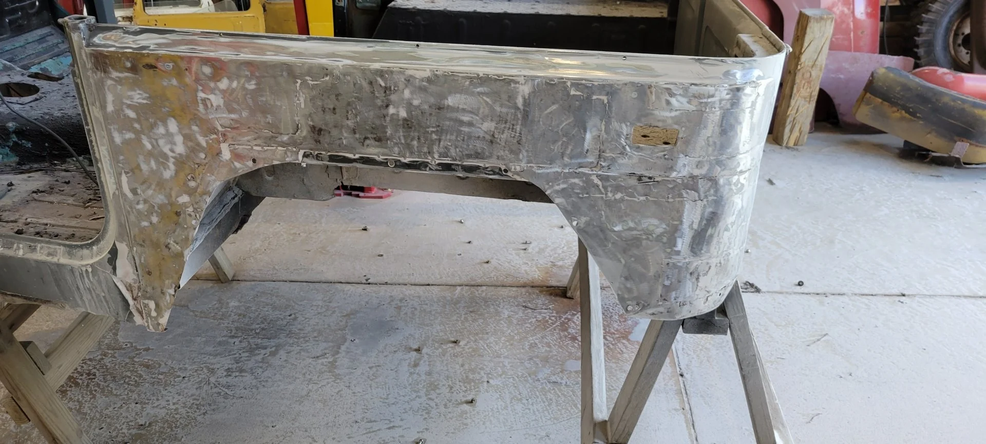

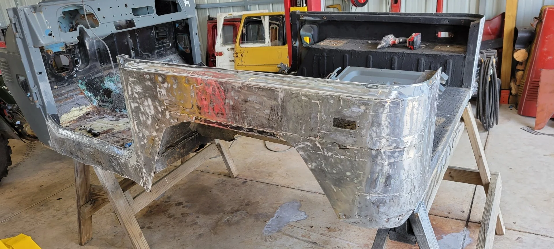

Pulled the old body off that was pretty rough with rust and half ass patching. Picked up a 73-74 tub to use instead. I like the barn door style better. Anyway, that had about 235lbs of bondo and 126lbs of fiberglass in it. Makes no sense to me, why people do that. So with all that off I gt a pretty good starting point. Cut the old quarters out of the '78 tub and mocked them into place. May have to go back some more once I flip the springs. Should push the axle back 4-4 1/2".

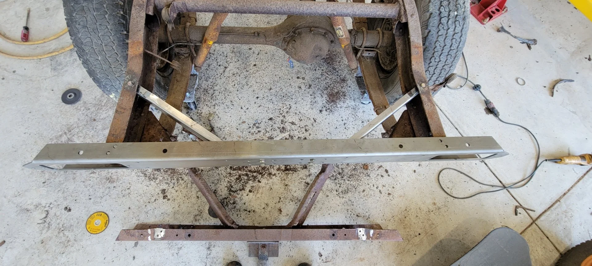

Cut out the old and mocked up the new rear cross member today. Will start fame patching next week.
Sandblasting on Saturday. Then the frame work will begin. Shackle reversal stuff came the other day, so that will start as well.

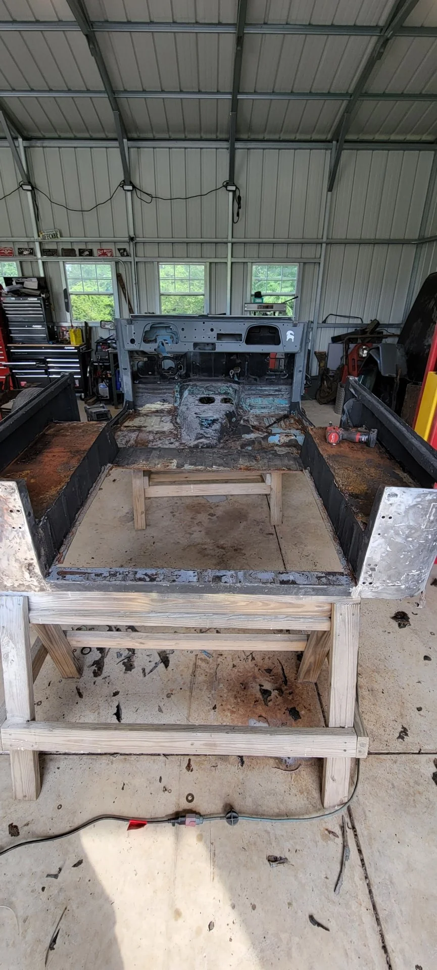

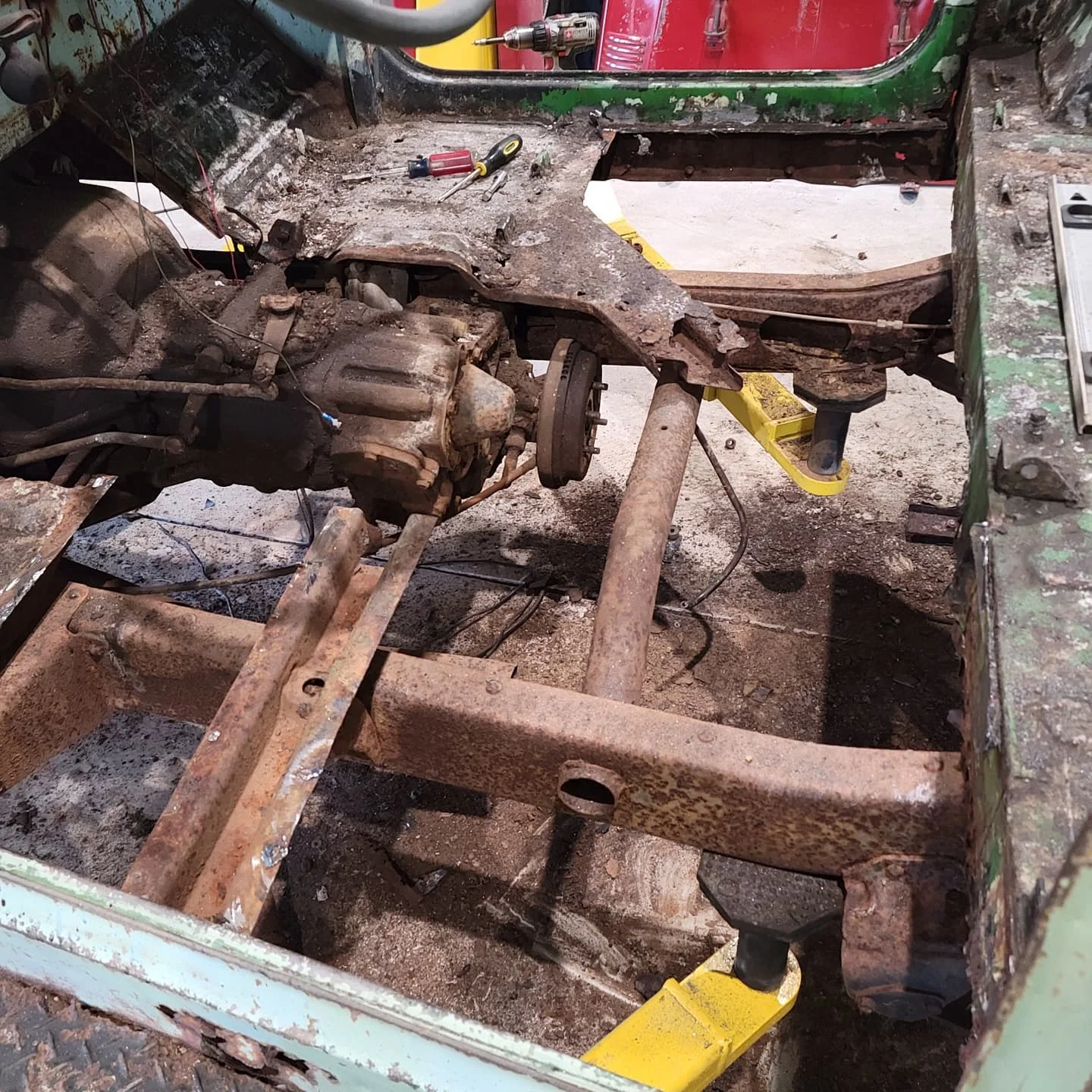

Frame repair today. Also got the rear floor pan mocked into place. rear sill, main cross member, bed cross members/ supports, and rear body corners are coming this week.

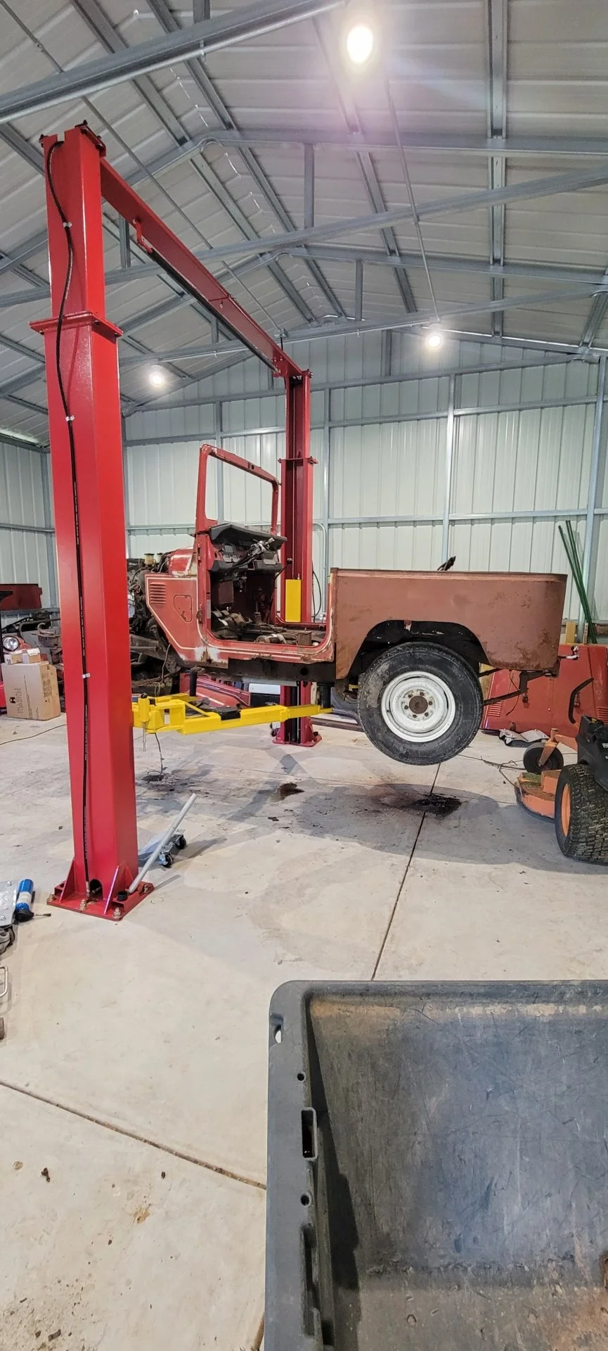

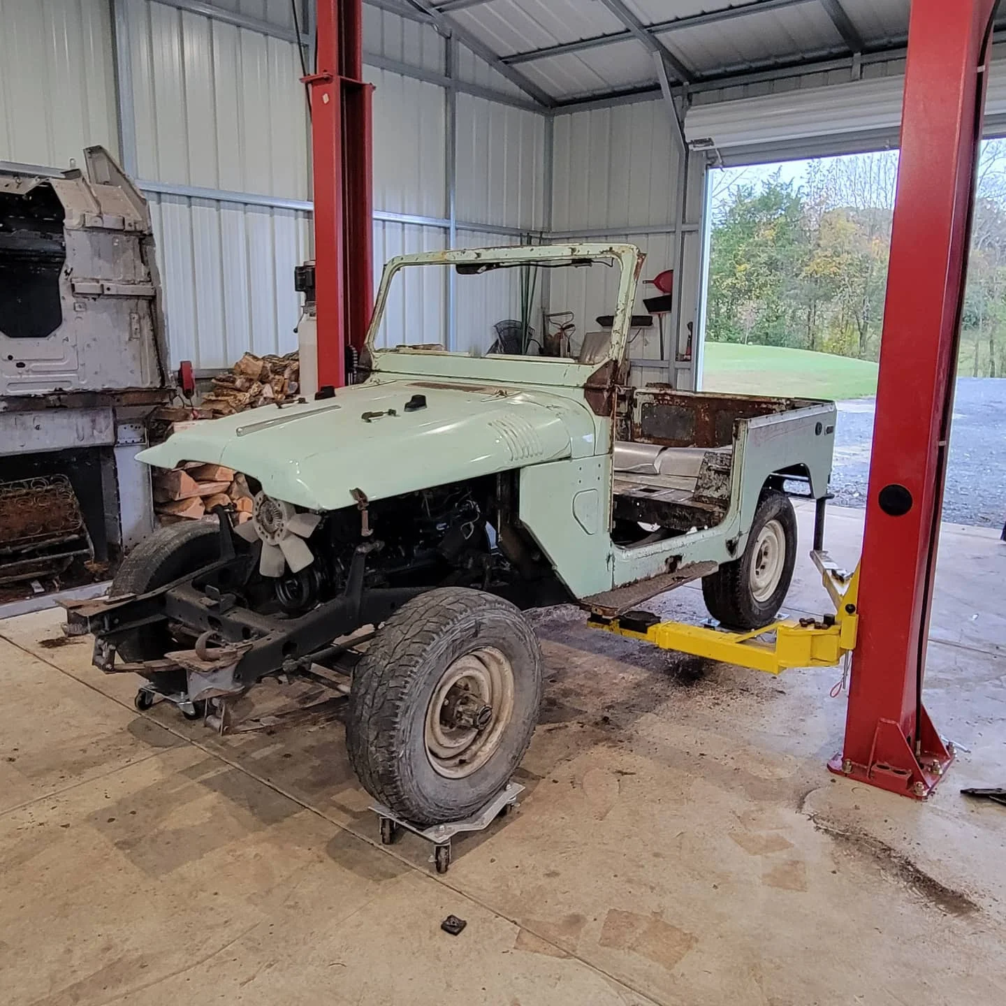

Picked this up Saturday. Like I really needed it. Floor boards, a little engine work, redo the seats and drive it.

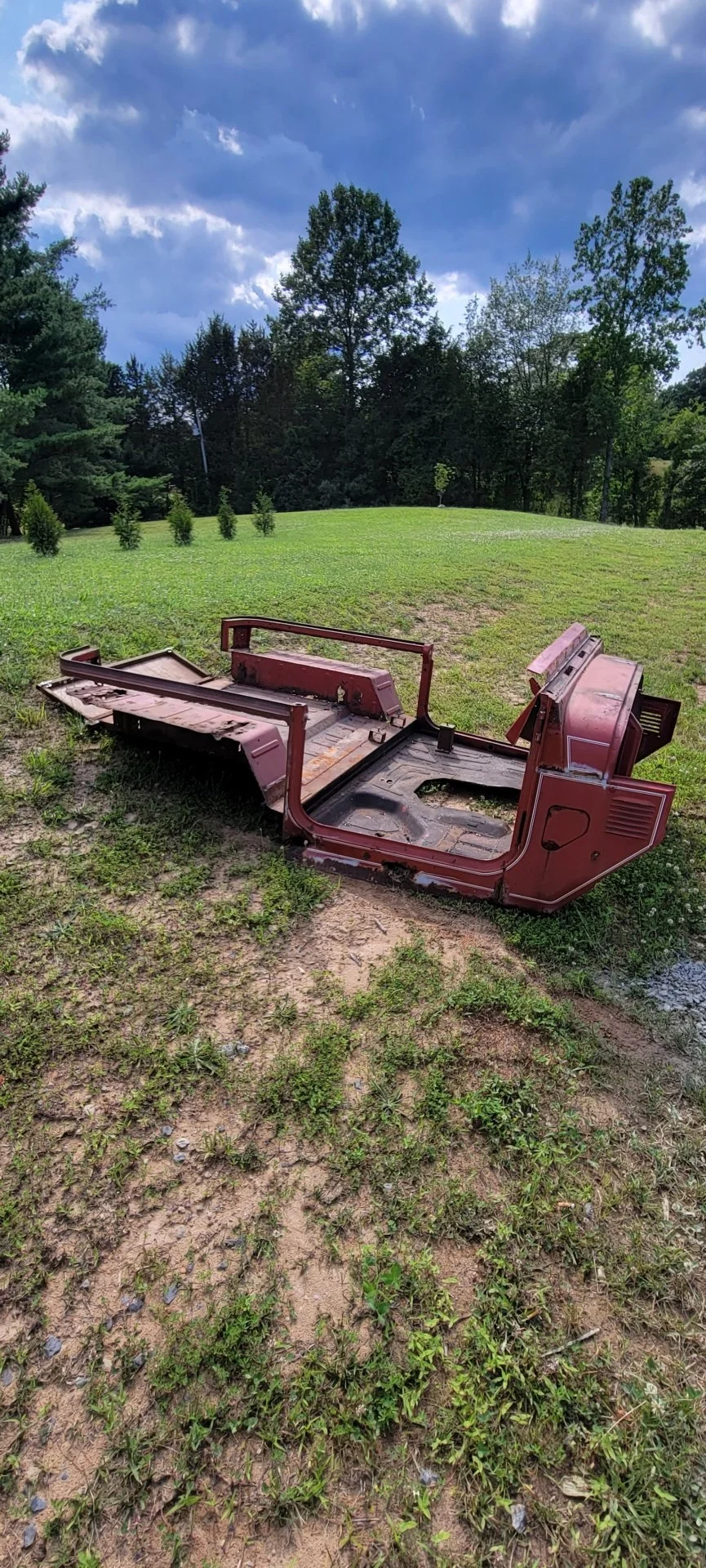

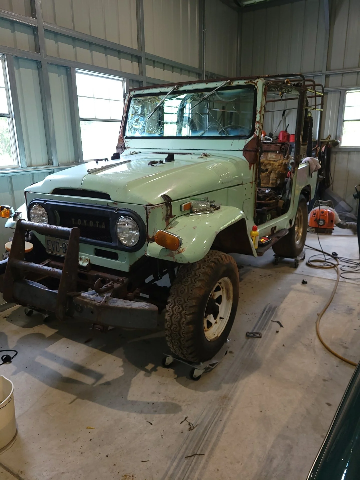

So the '78 project has been stood up in the corner of the shop and my focus and all parts have shifted to the '70 FST. I love this thing. The F and 3 speed will be pulled for the 2F and 4speed in the '78 chassis. The axles will be swapped as well. The front floors will be cut from the old '78 tub and and getto fabbed into place.

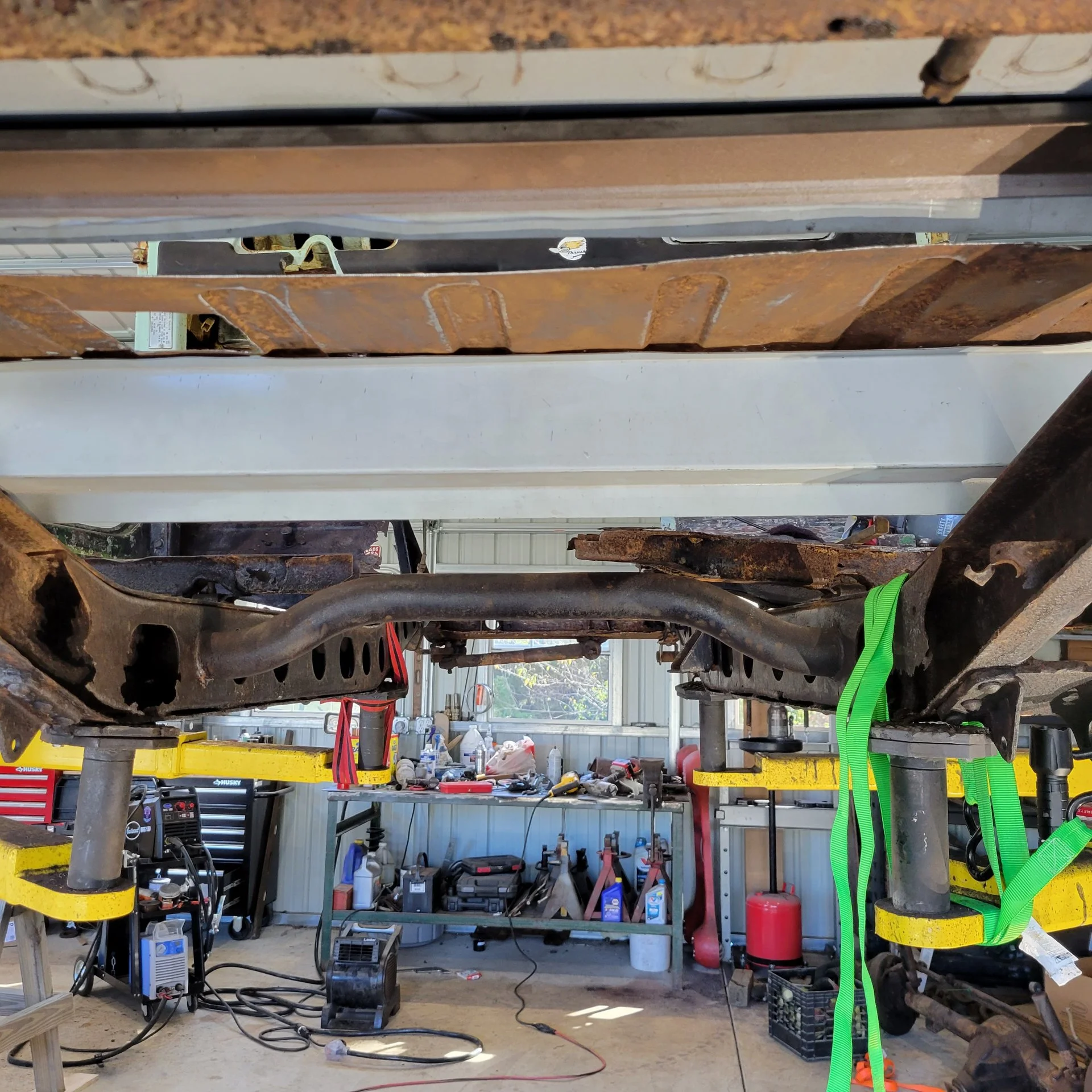

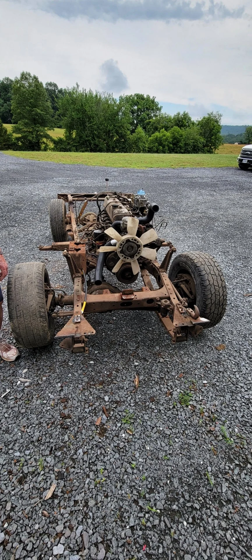

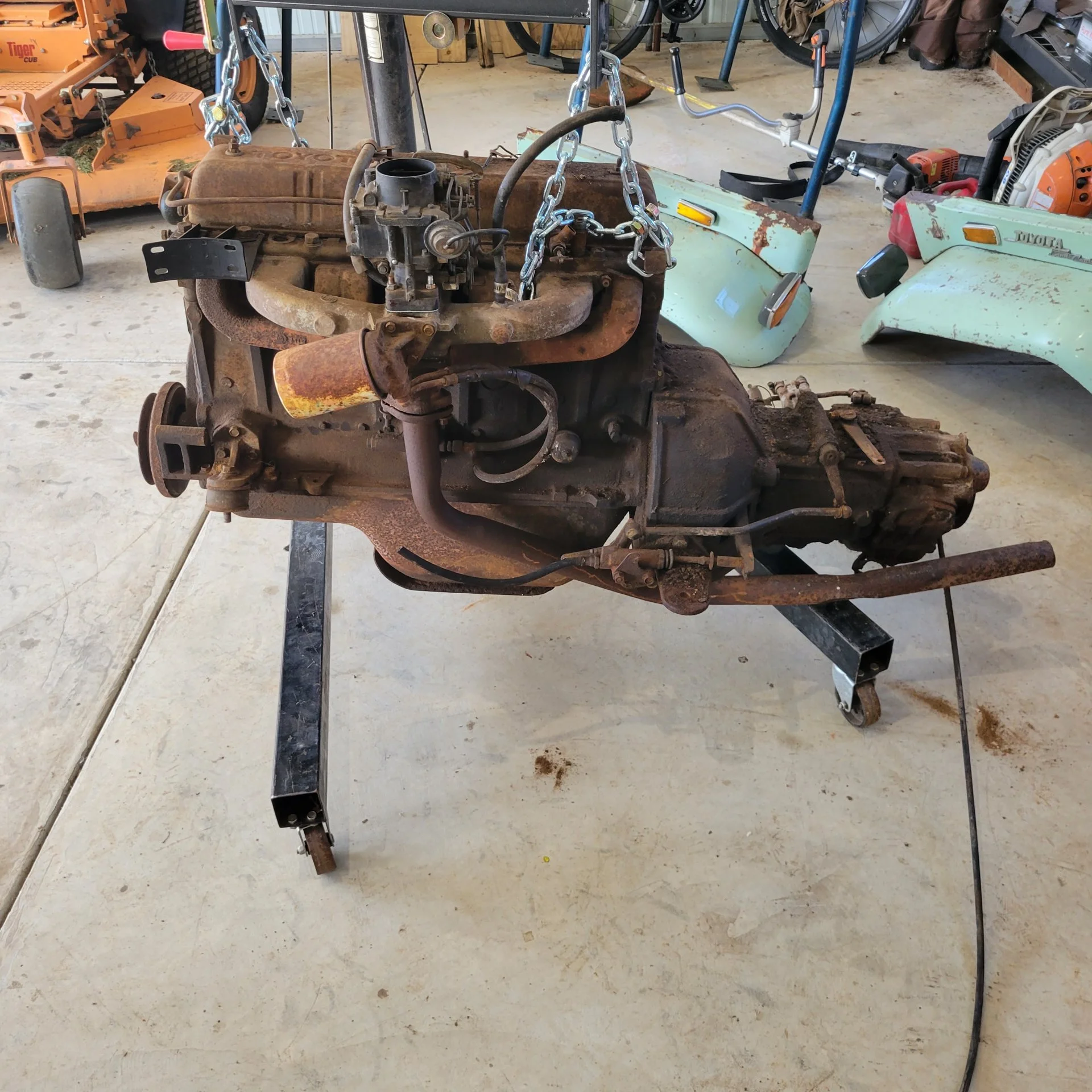

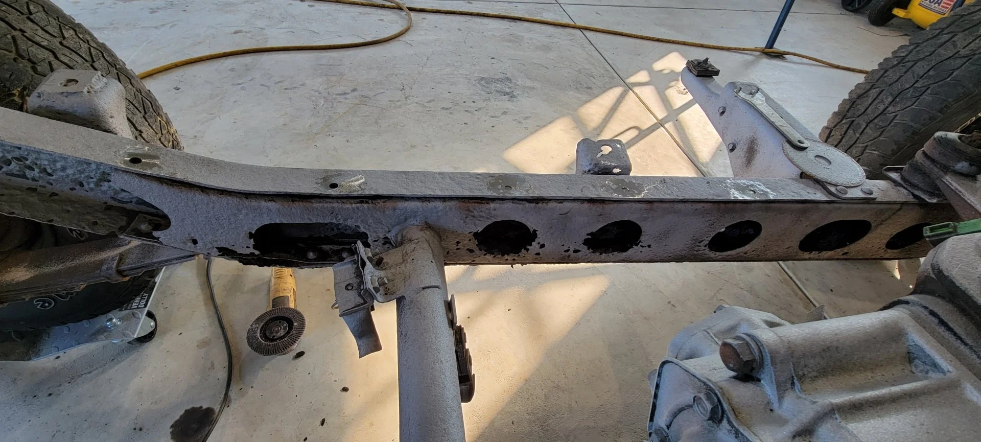

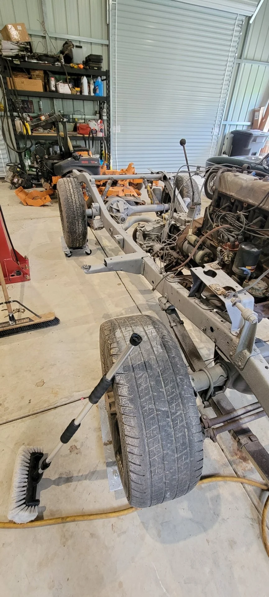

Got the axles pulled this morning. Motor is loose and ready to be pulled. Frame is prepped for rust converter and paint. On Vacation next weekend so hopefully the rear sill will be here by Oct. It's only been on order since July.
The only thing left to do, is everything.
Got the engine bay cleaned up today. Getting it ready for the 2F to go in. Also got the rust converter on the frame.

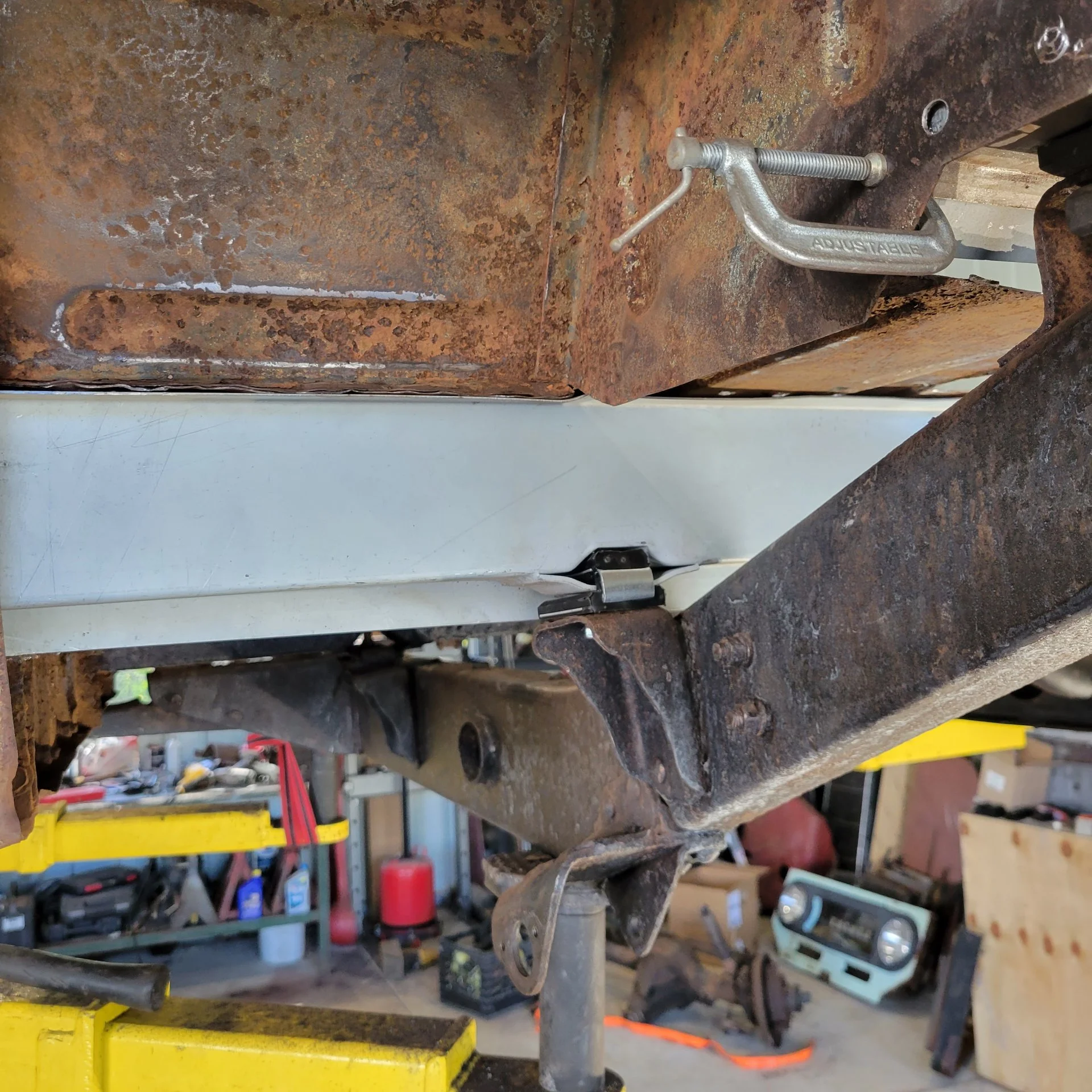

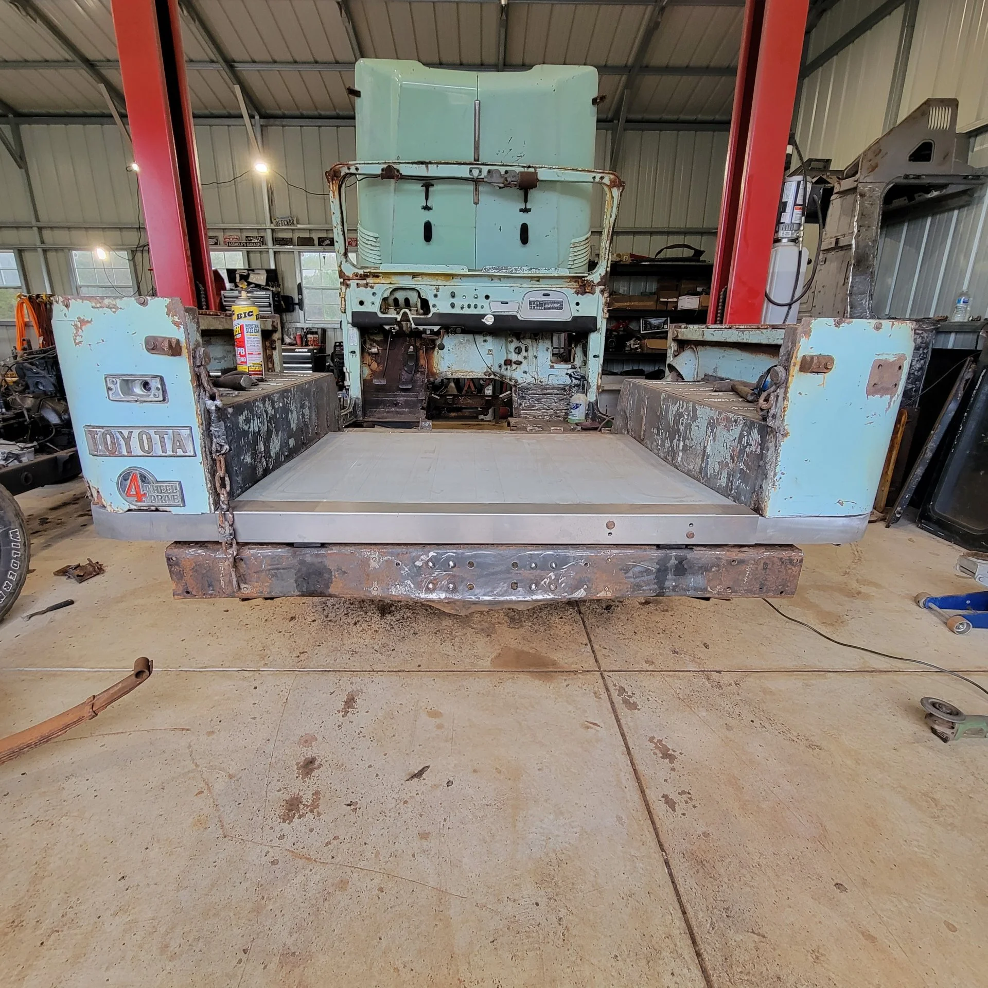

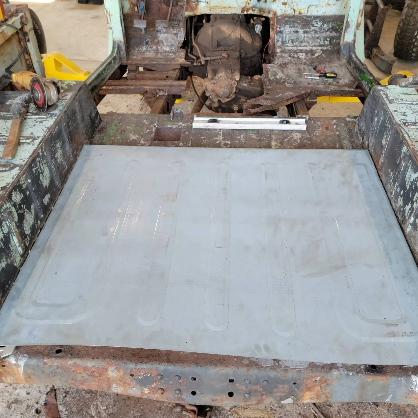

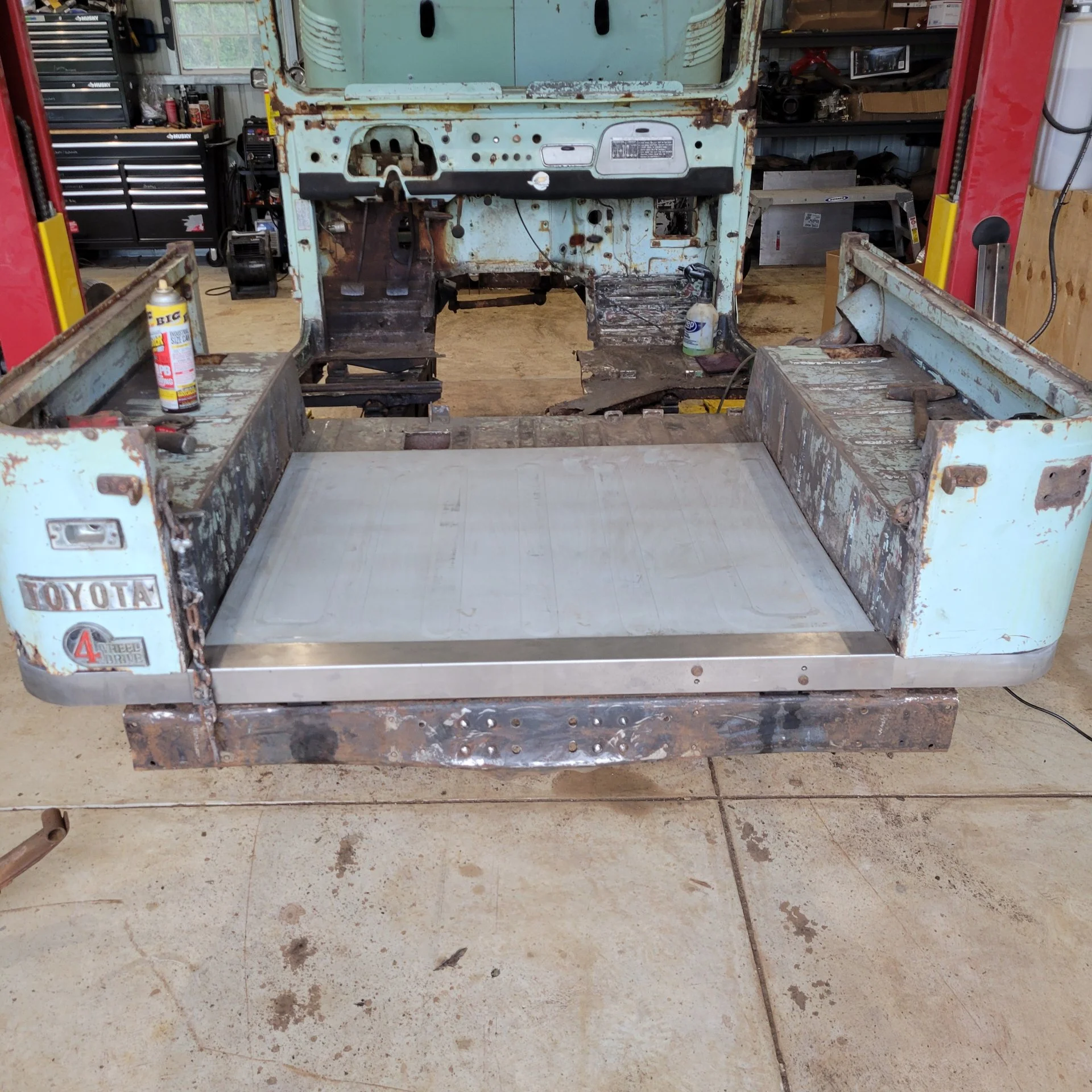

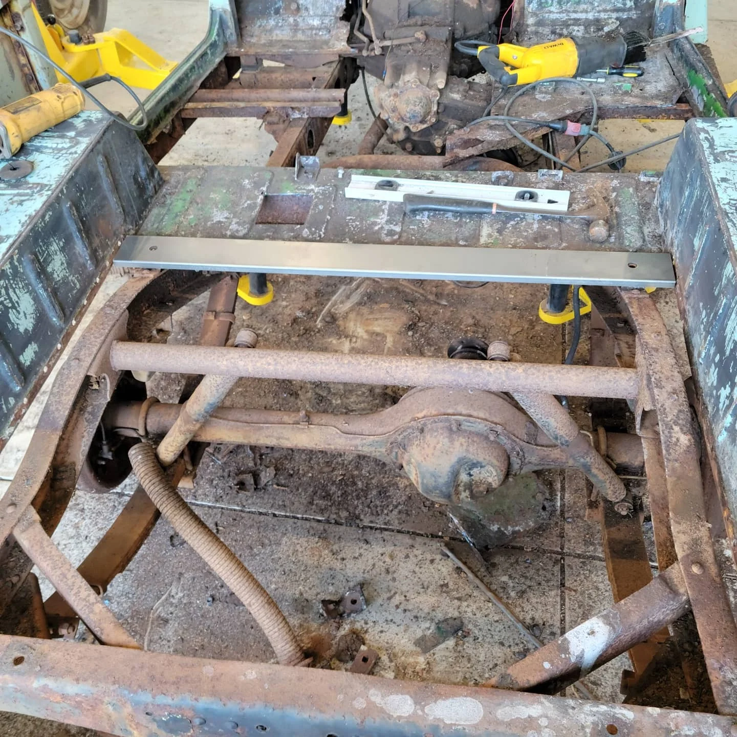

A little more progress today. Rear sill and bed floor mocked up.

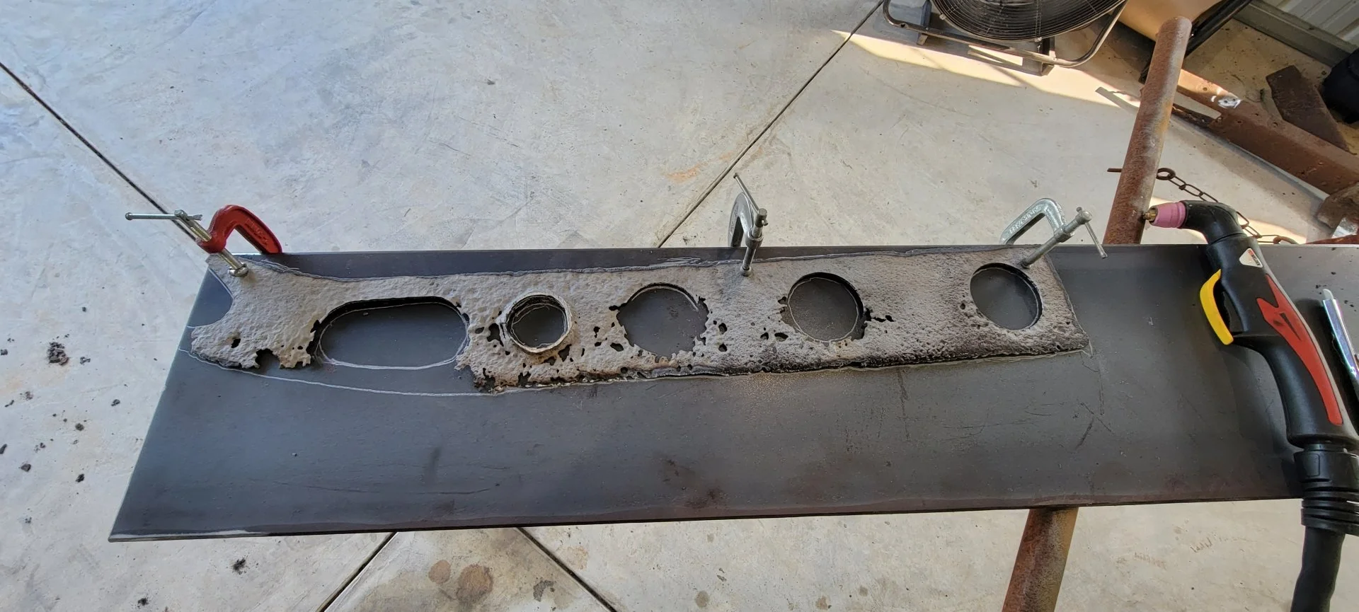

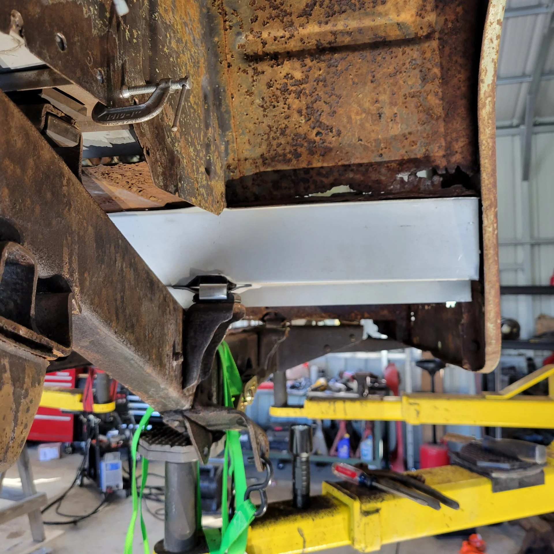

Out with what was left of the mid bed support and got the new one from CCOT mounted and ready for welding, which will happen this week. Also got the rear bed welded in.

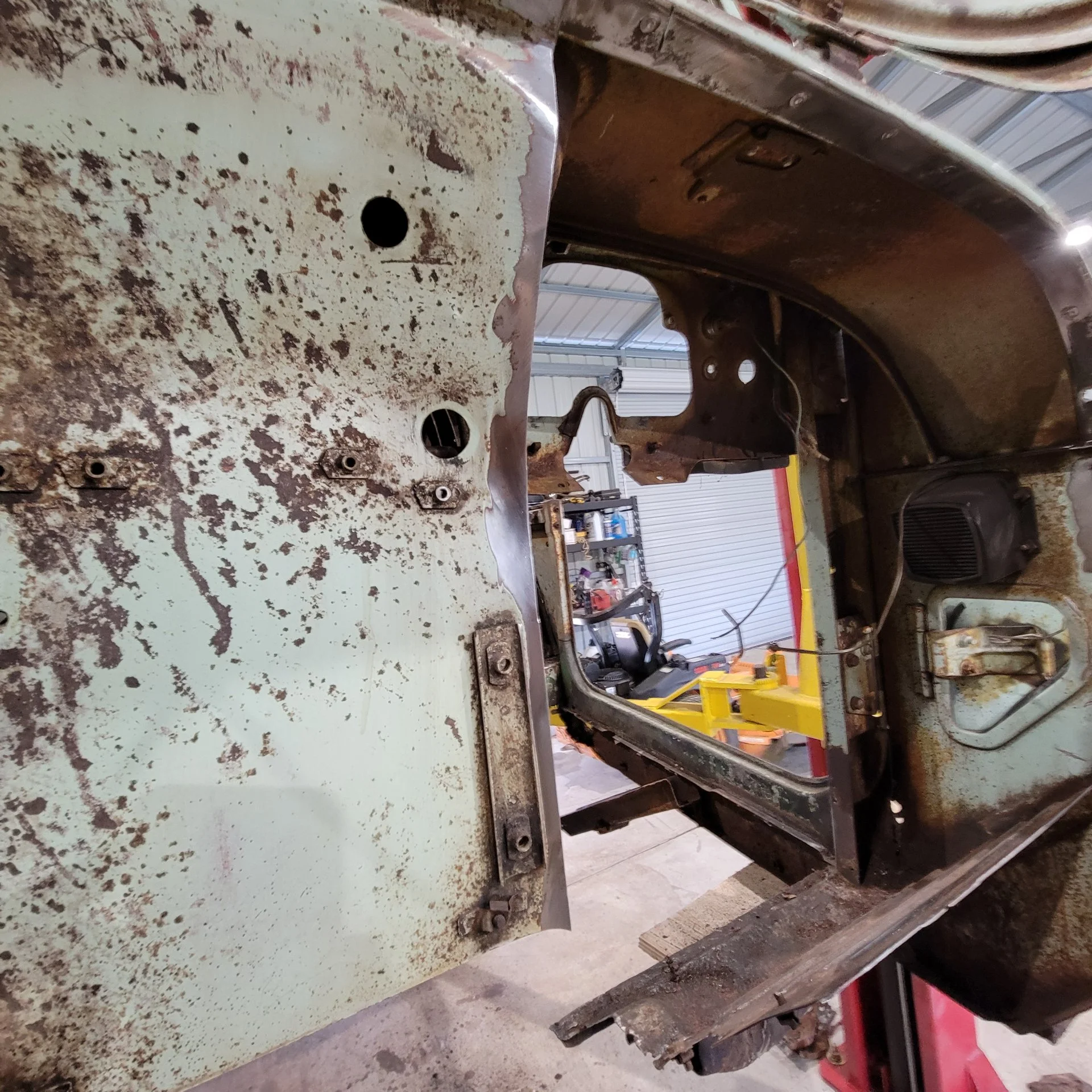

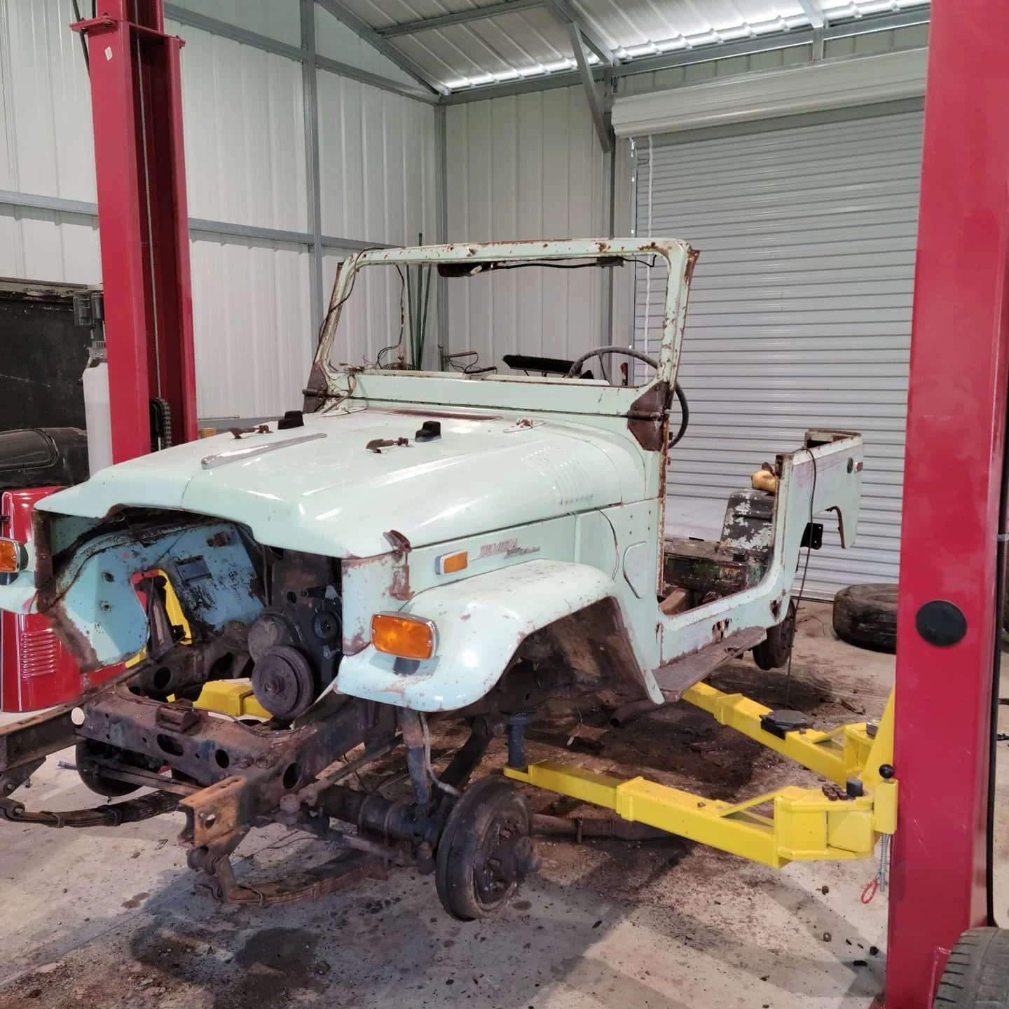

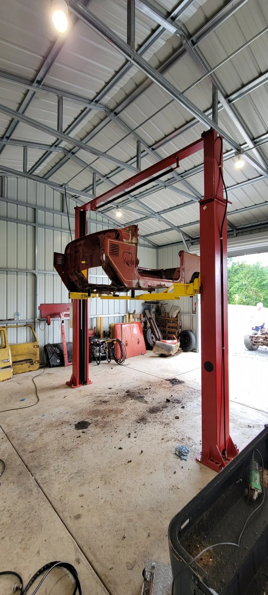

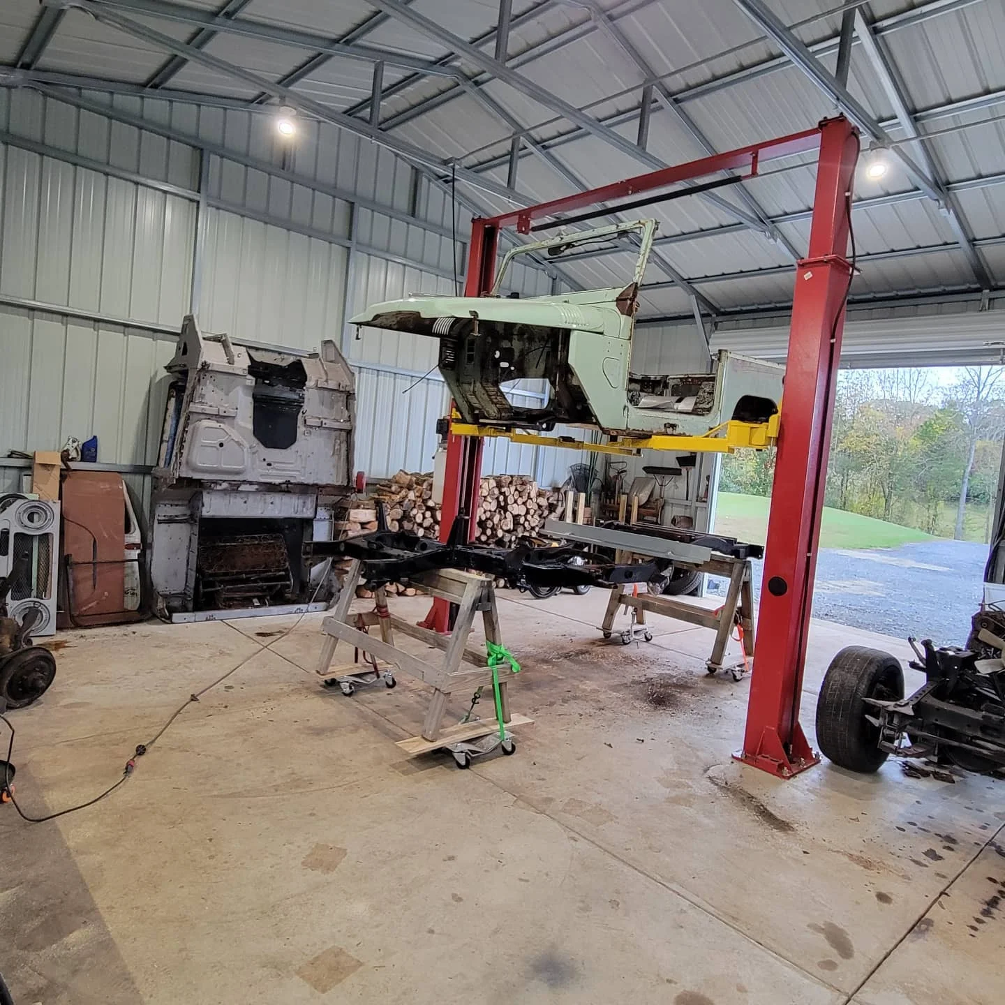

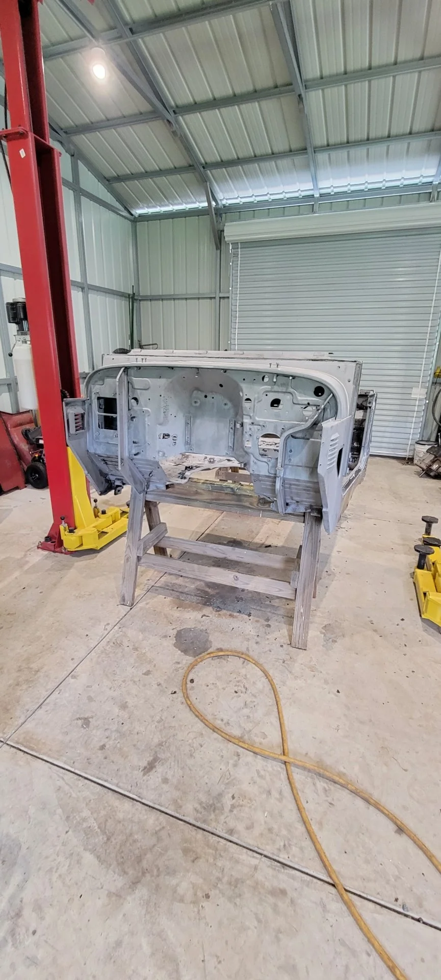

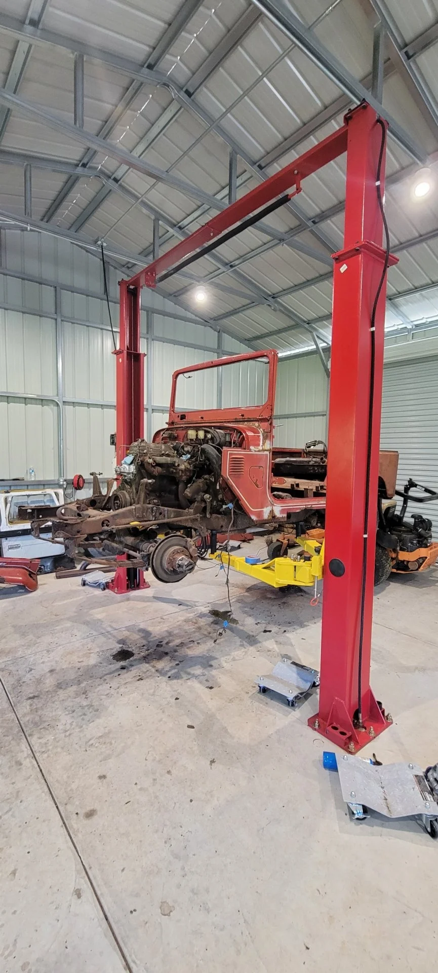

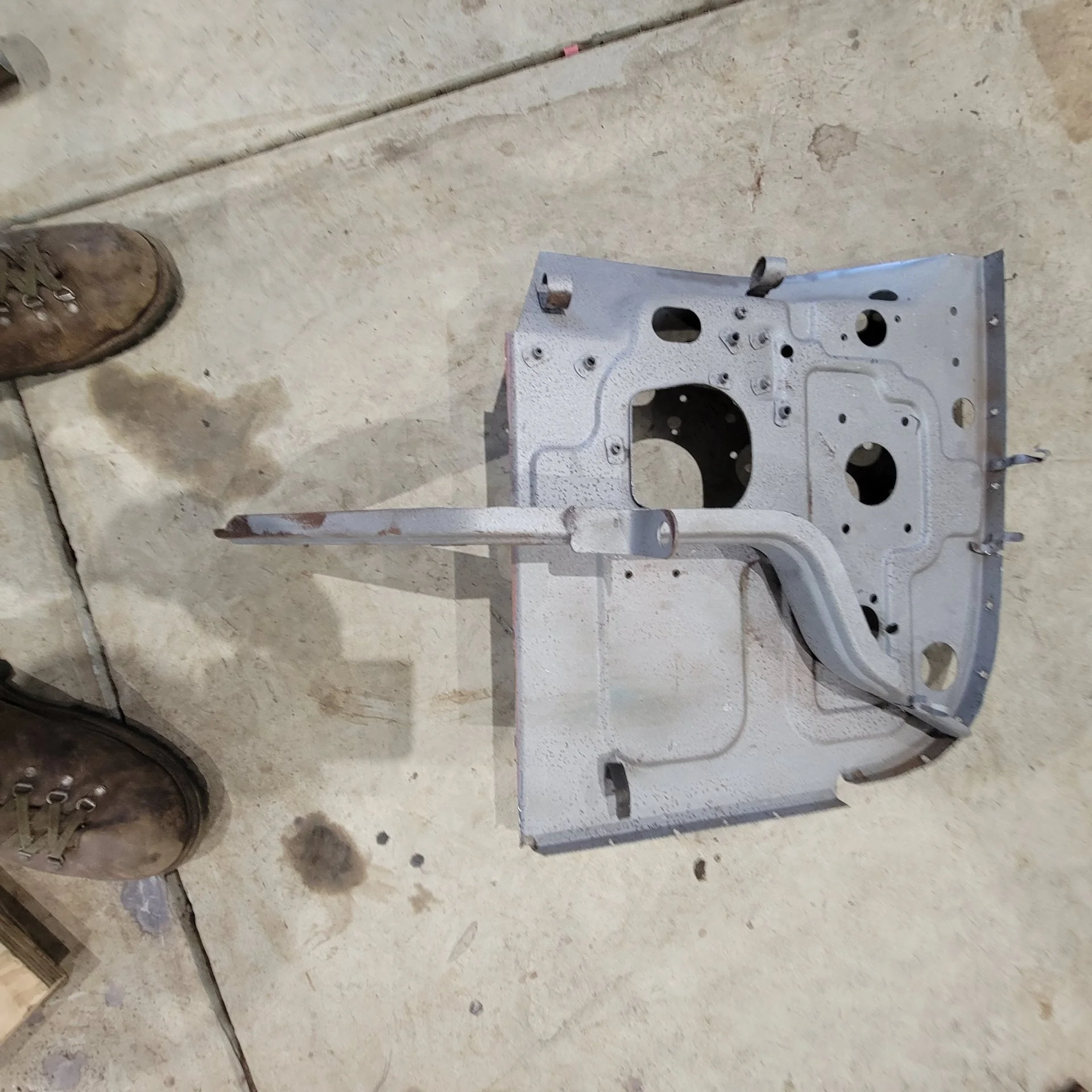

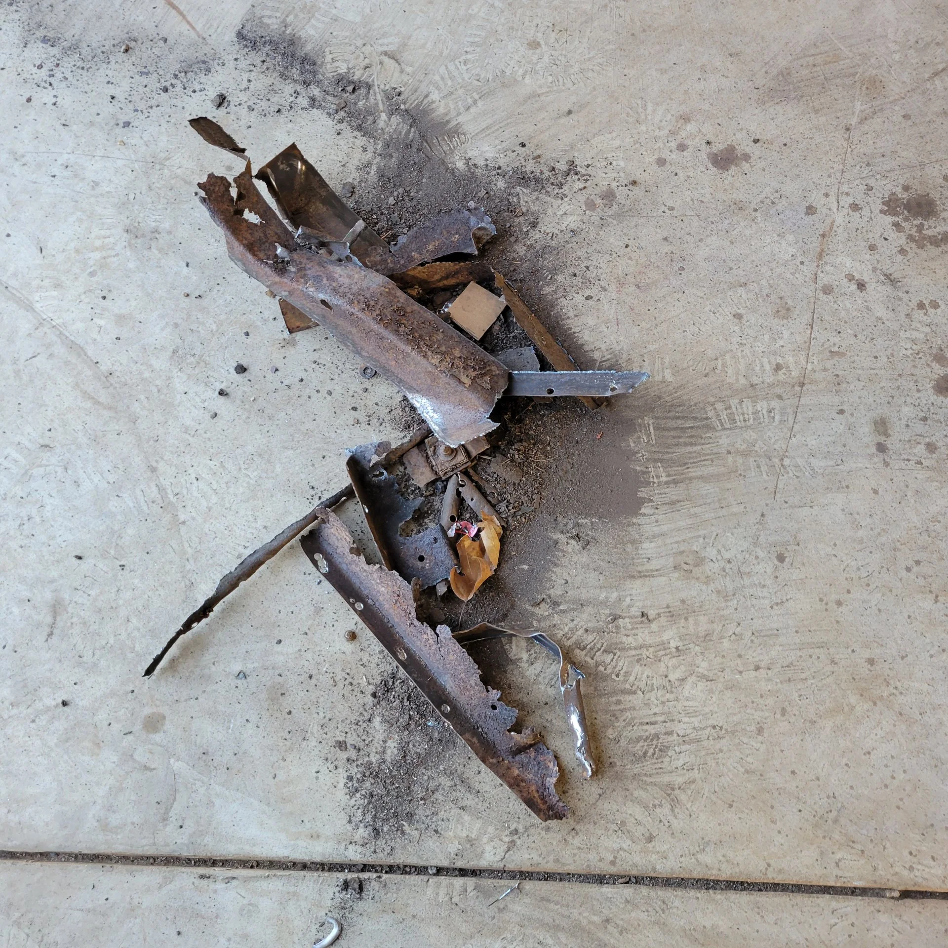

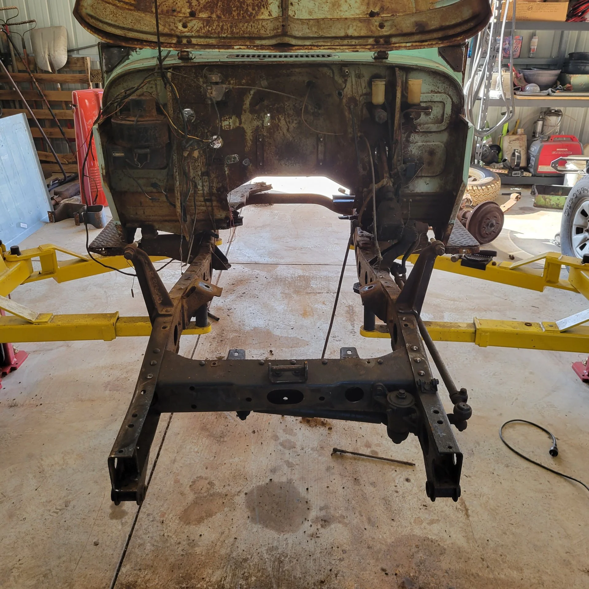

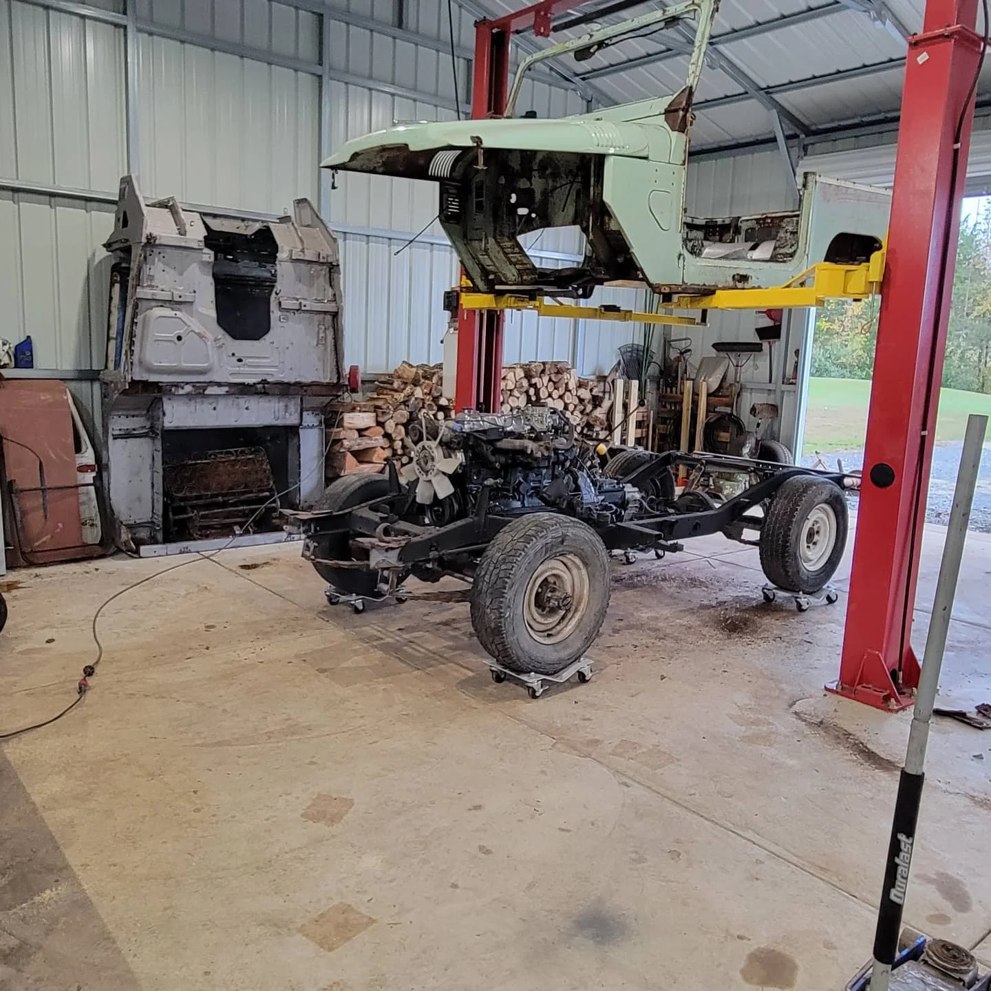

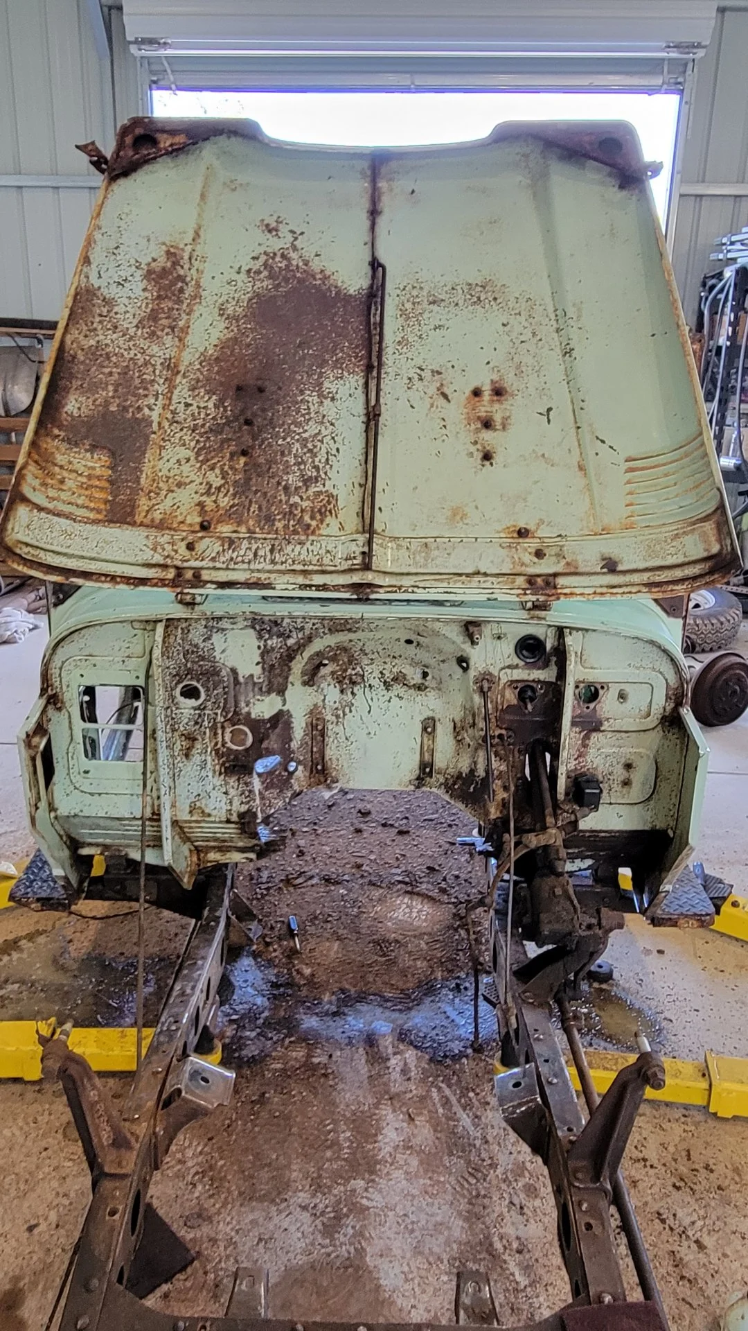

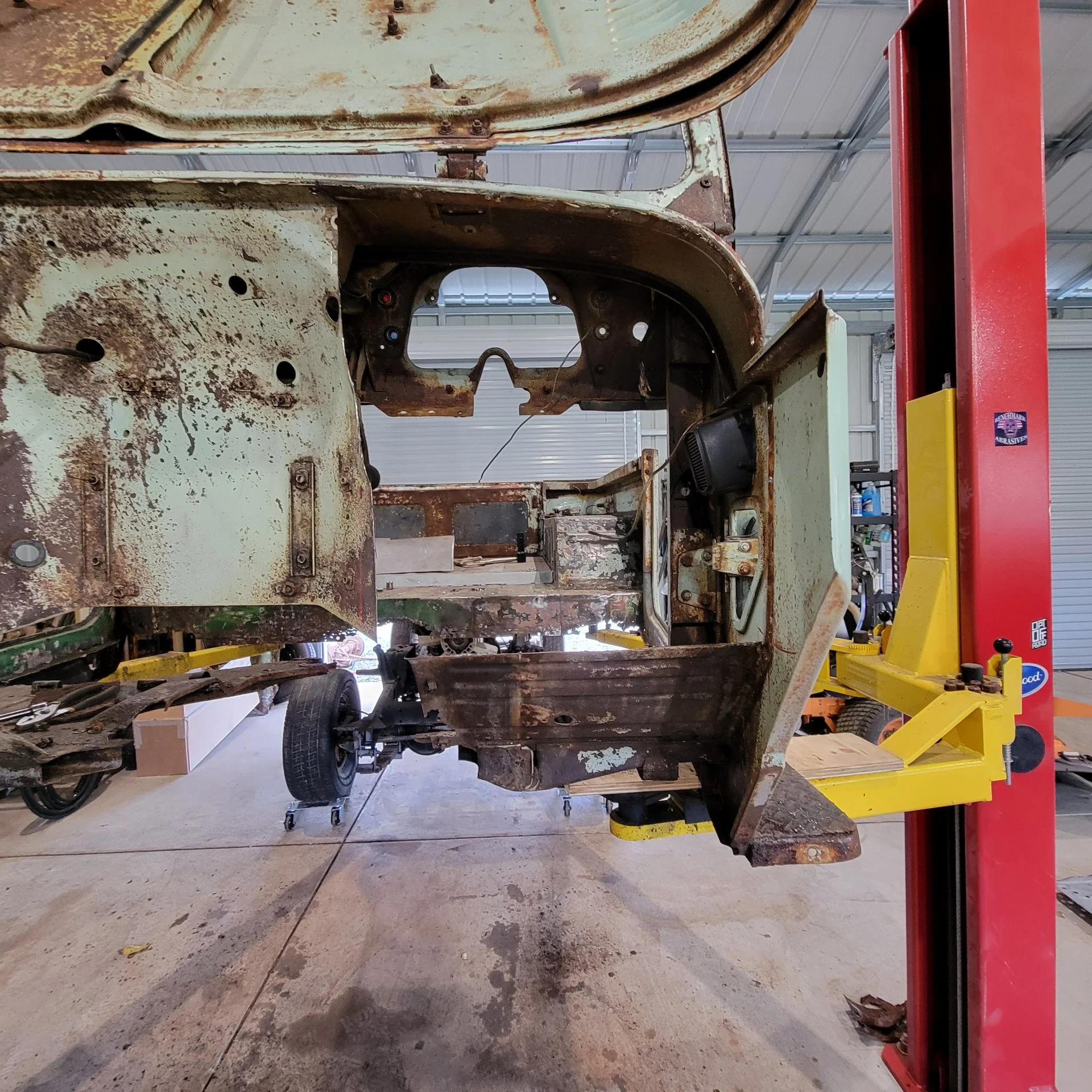

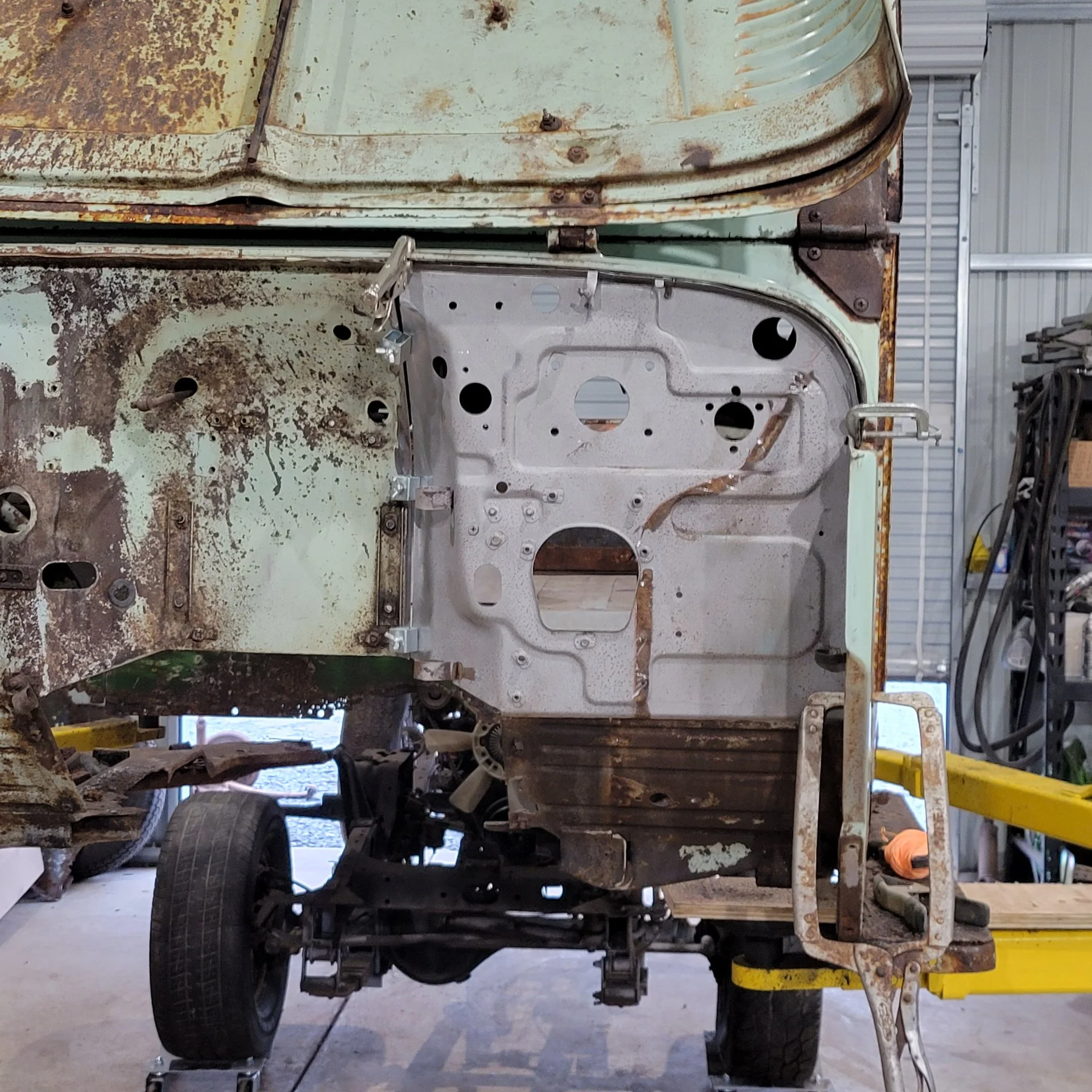

Got the body off the '70 frame and sitting on the '78. Got the firewall cut out of the parts tub and mocked into place and ready to weld in. I did this to be able to run a power brake booster. I bit the bullet and ordered floor pans for the front from Real Steel and will be getting everything ready to weld into place once they show up. Rockers will be cut out this weekend and patched with Real Steel ones I already have. still have to patch the rear corners as well. I have those also.

Looking good!
You will be glad you did the firewall swap. I wish I did it on mind. It gets tight up there with the booster extension.
Looking good!
I thought about it for a while but after taking measurements 120 times I figured what the hell, why not now while its easy to get to.
