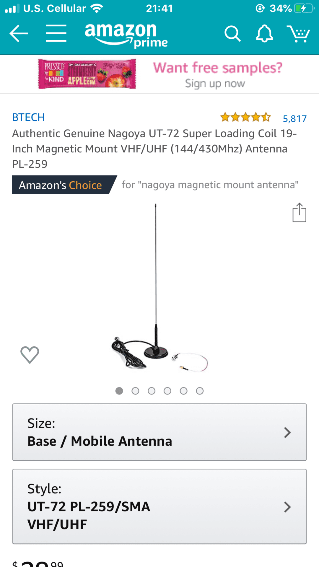

I had much better success with the external antenna. The 5r with Nagoya mag mount on the roof and a handheld mike has worked really well.
I did just decide to upgrade to an Icom mobile but haven't installed it yet.
Like this?
That's it. Then the Baofeng mic for better sound and ease of use instead of dragging the antenna cable. The radio tucks down under the e-brake when using it. I have been able to hit the Ceasars Head repeater from Boiling Springs with it but couldnt communicate a mile from inside the vehicle with the rubber duck.

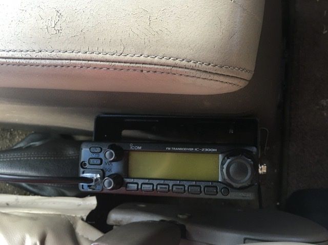

Word of caution when upgrading from a handheld: I installed the Icom and hit a couple repeaters. Great clarity and 65w power will reach out. Hopefully someone on the other end has the power to return the transmission. However, without thinking about it, I gave up UHF capability. Why does that matter?
GMRS and FRS are UHF. So if you are the only one in a group with a good 2m setup, it does little good if there is nobody to talk to and everyone else is chatting on their basic box-store handhelds.
I planned to keep the Baofengs around as loaners, but now have another reason. Anyway, here is the 2300. These radios us RJ45 jacks for the mic. I also got some rubber RJ45 dust plugs for when the radio is not being used and the mic is stowed. I have spares if anyone else wants one.
