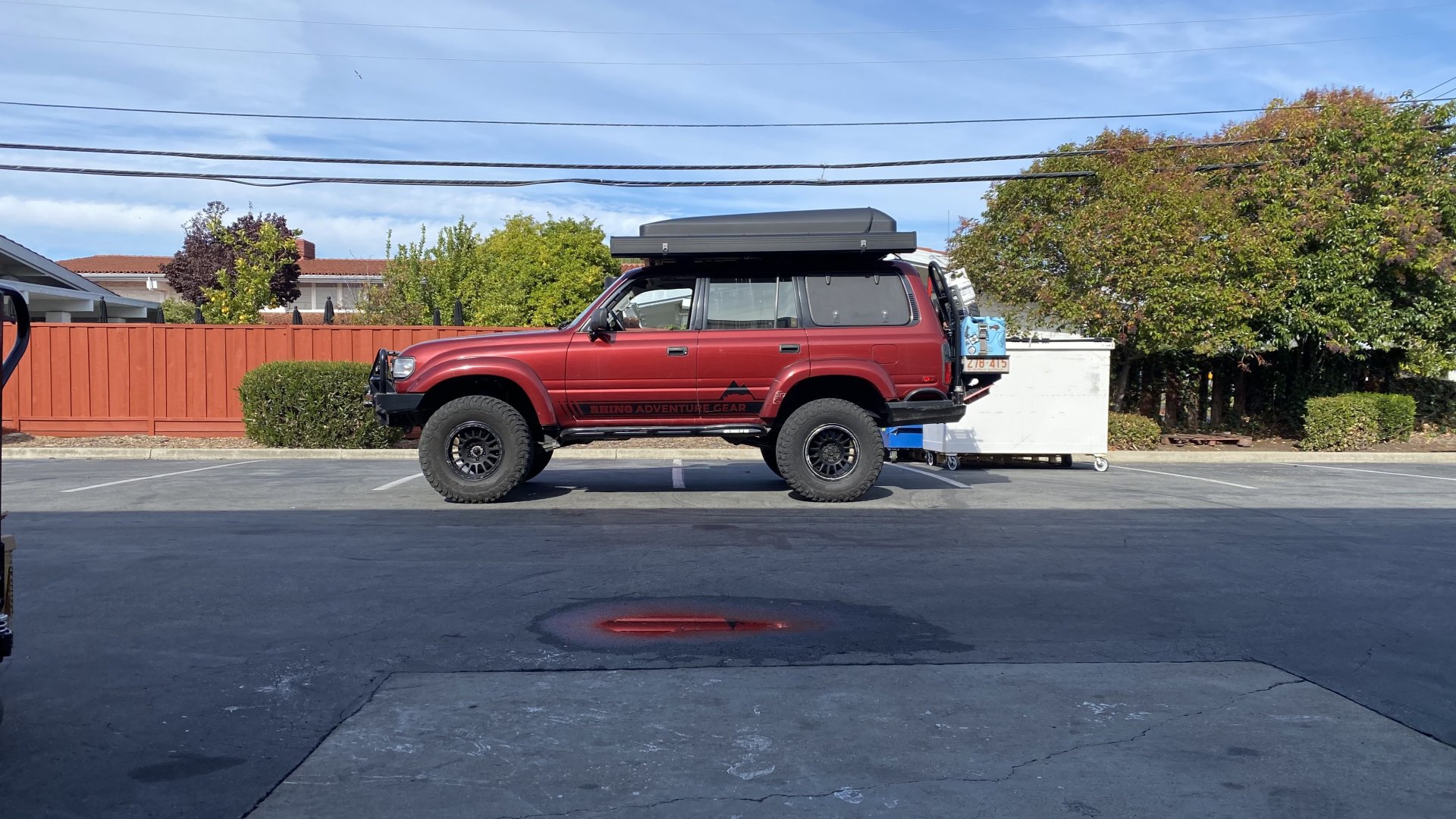

I’ve seen this come up a couple other times, but don’t recall if it quite answered the question. My bad if it’s somewhere in this thread. Might be a long way to ask a simple question. Truck has J springs with 2” spacer up front to make it level (pretty dead-on at all 4 corners). Depending what the agreed-upon stock measurements are, I’d say it’s 4.5”. Came this way and I don’t mind it, but would prefer a standard 2.5-3” setup with my 315s. Has caster plates that I assume were correct for front J springs w/o the spacer. Truck drives & tracks great either way & to my knowledge they confirmed caster within spec at the time, though I don’t have the numbers. I understand generally how height affects geometry, so that’s not really my question.
Simply put, given current setup, is it likely it will still be good if I go down to 2.5-3” (a 1.5-2” drop)? Or: with a kit that’s made for 3.5, am I still good at 2.5-3? Feels like a dumb question when putting it that way, but..
Springs are in fine shape, so I’d *hope* it’s as simple as swapping the rears and losing the front spacer. Maybe fine tune the front with a small spacer if necessary, depending on rear result. It has almost all other parts to correct the lift - only thing they didn’t do was DC front shaft (I have confirmed current angles for using one), and I added a 3” rear panhard bracket.
Even if we can say caster/etc will still be good, certainly wouldn’t hurt to have it checked and aligned again either way. I understand you won’t know for sure unless you do it, and that they don’t all behave exactly the same.
If it’s good to go, I’ll select an appropriate rear spring to net a ~23” measurement.

The short answer is yes, things will be fine after you drop 2” and probably better. If you plan to keep the 850j springs up front after removing the spacer then the standard 863 will give you a very close to level stance to slightly higher in the rear when the rig is unloaded. This is the first lift combo I ever ran several years ago. Note that I did have sliders and heavier 4x4Labs rear bumper and light weight tube bumper with winch up front.
Your caster is probably deficient right now but will be ideal once you remove the front spacer. How old are your castor plates? Do you know the brand? This set up should run nicely with a front DC shaft.
Thanks both. I probably said a lot that made it sound more complicated, as usual...
Current shafts are stock but I’ve replaced all the joints with Koyo.. if anything it should improve when it comes down a little, though I expect I’ll still be a candidate for DC because of the caster plates. Rear shaft angles are fine and no vibration, but front gives me light vibes due to the joint at TC. Front joint measures <1°. Preference would be a Toyota-built DC, but I’m sure I’d do just fine with tom woods. No shaft shops around here, so doing Toyota myself not as likely.
Extended lines appear to be a good length for current lift and also going a little lower, although I still need to replace one of them that had been rubbing on the front tire at full lock because of how they let it curve - the braided outer has a little fraying in one spot, but line itself is solid. I got it out of the way for now. I have a replacement I haven’t put in yet.
I doubt they touched the LSPV but will check that.
I think you’ll be right about caster. It feels fine now, but would expect a slight improvement. We’ll find out after another alignment check.
Based on vehicle history and other clues (date stamp on the 315s it came with, obviously installed at time of lift), the kit was put on in 2012 right before it came up to Juneau. I bought it in 2020 right before prices jumped. It’s only been a DD so nothing has been beat around or flexed much.. everything still looks really good, so I’m not worried about having to replace anything else, but who knows. Don’t know caster plate brand, but how many were available 10 years ago? They look like the common options everyone uses. For the spacers and swaybar drops/etc they used metaltech.

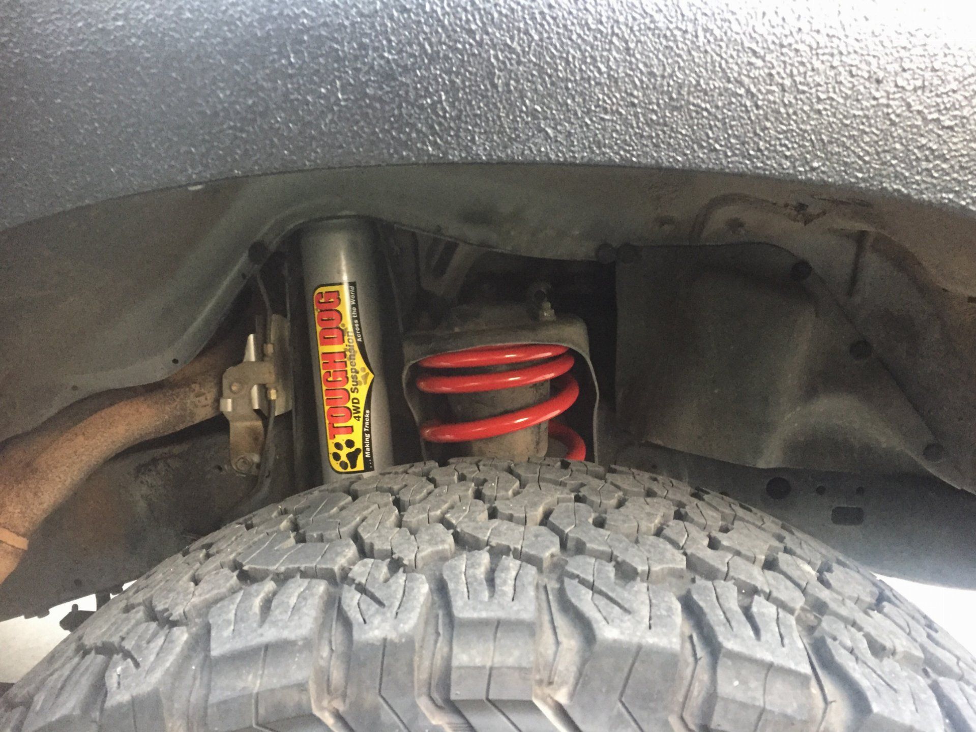

Trail Tailor Tough Dog 949L 2" lift plus 30mm spacer 220/280# (I have these & like them better then the last 4 sets of rear coils I've had)

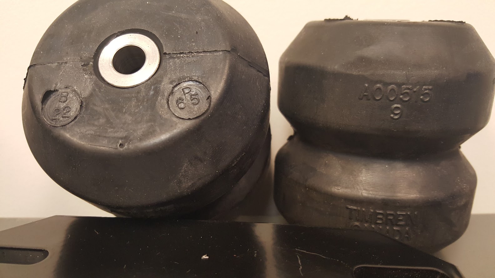

These are the rear AOR Timbrens for an 80 series.
They are way to tall, the bracket appears to be just under 4.5" tall & needs to be cut down for anything under a 40" tires. (I believe BoxRocket cut his down to 3")

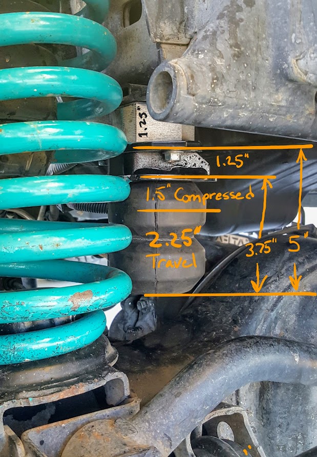

I Emailed Timbren & got specs for the 80 series AOR bumps.
3.75" free/1.5" compressed/deflected
The front bracket is 1.25" tall.

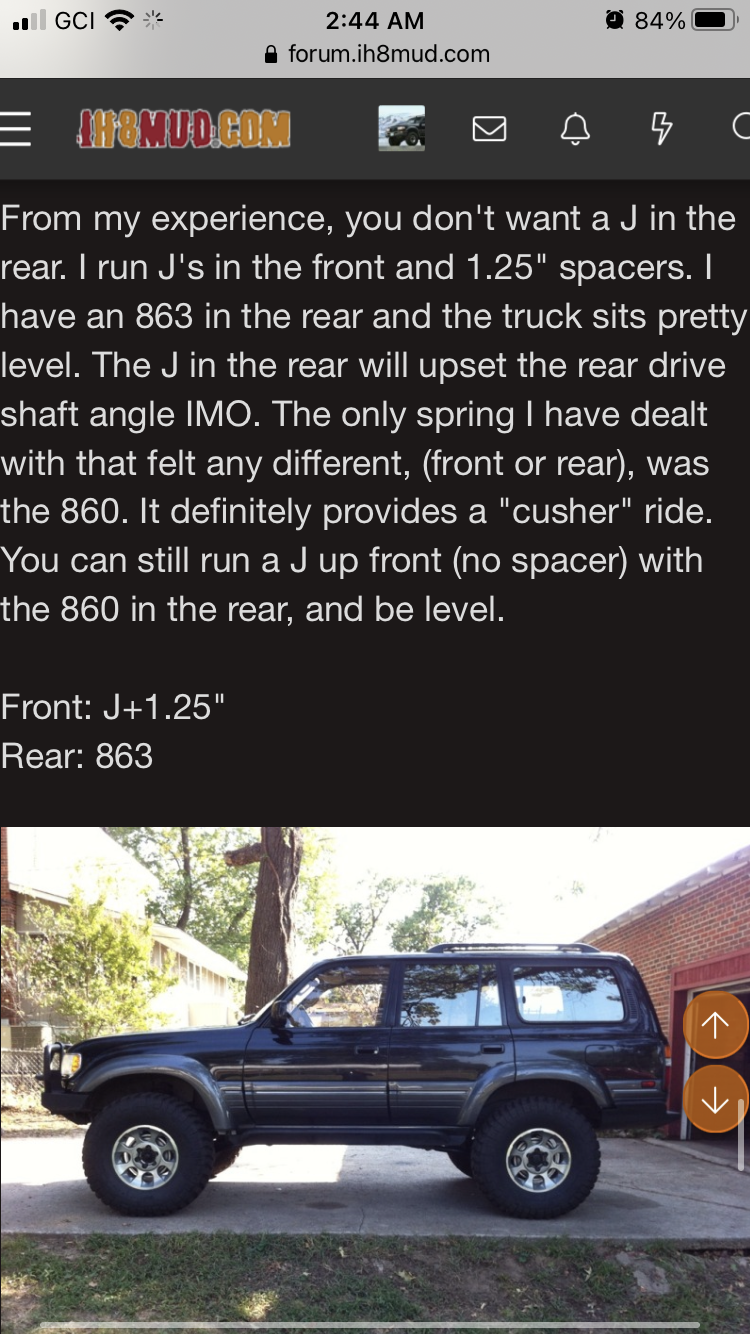

I already told you that the 850j/863 (no spacers) is a very nice stance near level, maybe a touch high in the rear which is favorable for cargo weight. ARB calls these springs “heavies” but I was never impressed. A simple weekend camping load pushes them down a quite a bit. If you don’t have, or ever plan to install a heavy rear bumper and don’t plan to carry more than a couple hundred pounds of stuff then mediums might work for you.
We gave you sound advice, if you must learn the hard way go ahead & install that 220# constant rate coil.

Found this if you want to DIY your own AEON bump/springs.
More resource info:
ANATOMY OF AN AEON® RUBBER SPRING – PART 3
This is an official Timbren pdf. chart.
adv-462e-aeon-springs.pdf - Timbren

The Front:
#A515-65
I've wondered forever why they use such a tall bracket on the rear 80 series specific bump stop kit. Especially when they state this:
ABSTORLC1 replaces the rear OEM bump stops on the Toyota Landcruiser 70 & 80 series. Upgrade to Active Off-road Bumpstops and experience the difference.

@malteserunner posted this install What Did You Do with Your 80 This Weekend?Knocked out the rear Tourflex suspension. Everything fit as it should. Very nice quality on these parts!
  1. OME L shock compared to 41mm Tough Dog...
    img_20180222_115757_541-jpg.1639556
    Obligatory coil comparison. OME 863J and Tourflex 3".
    img_20180222_110251_645-jpg.1639605
    41mm foam cell shocks are made by either Gabriel or Tenneco (Monroe) in the US or Mexico. Then sent to AUS for QA/QC, batch testing and final assembly/packaging.
    Mine have Gabriel on the bushing.
    img_20180222_115048_006-jpg.1639565

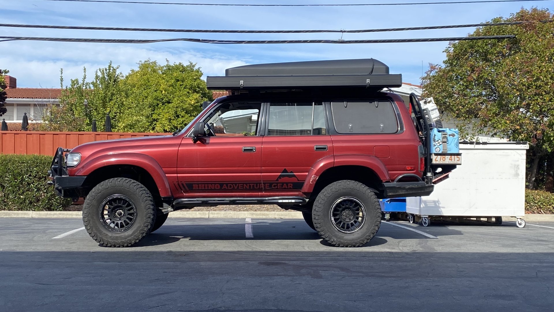

@gofast
My truck is outside right now and fairly empty at roughly 7400#. I’ll take measurements. Fully loaded it exceeds 8400#.
I have been running the 319 springs with a 30mm spacer in back in this pic. I love the springs. Can handle high speed hard hits and fast curves in the mountains. Tall spring too so can flex well.
Pictured
~7400#
319 w 30mm
144vt front
24.5” rear center of hub to bottom of flare
24” front center of hub to bottom of flare
If I removed the 30mm spacer it will likely be just below 4” of lift in back at your weight (7500#). Again, this setup is killer for a heavy 80.
