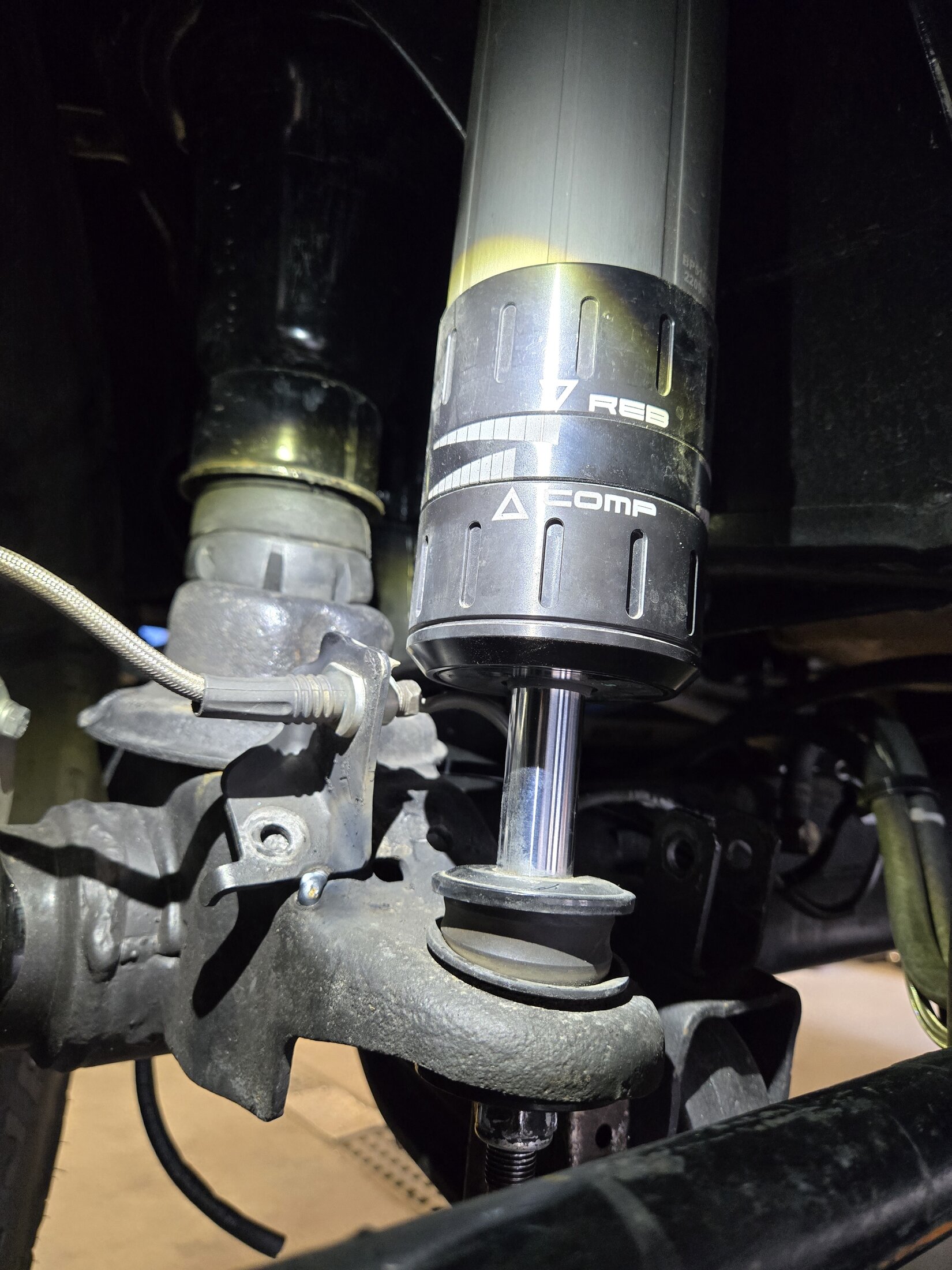

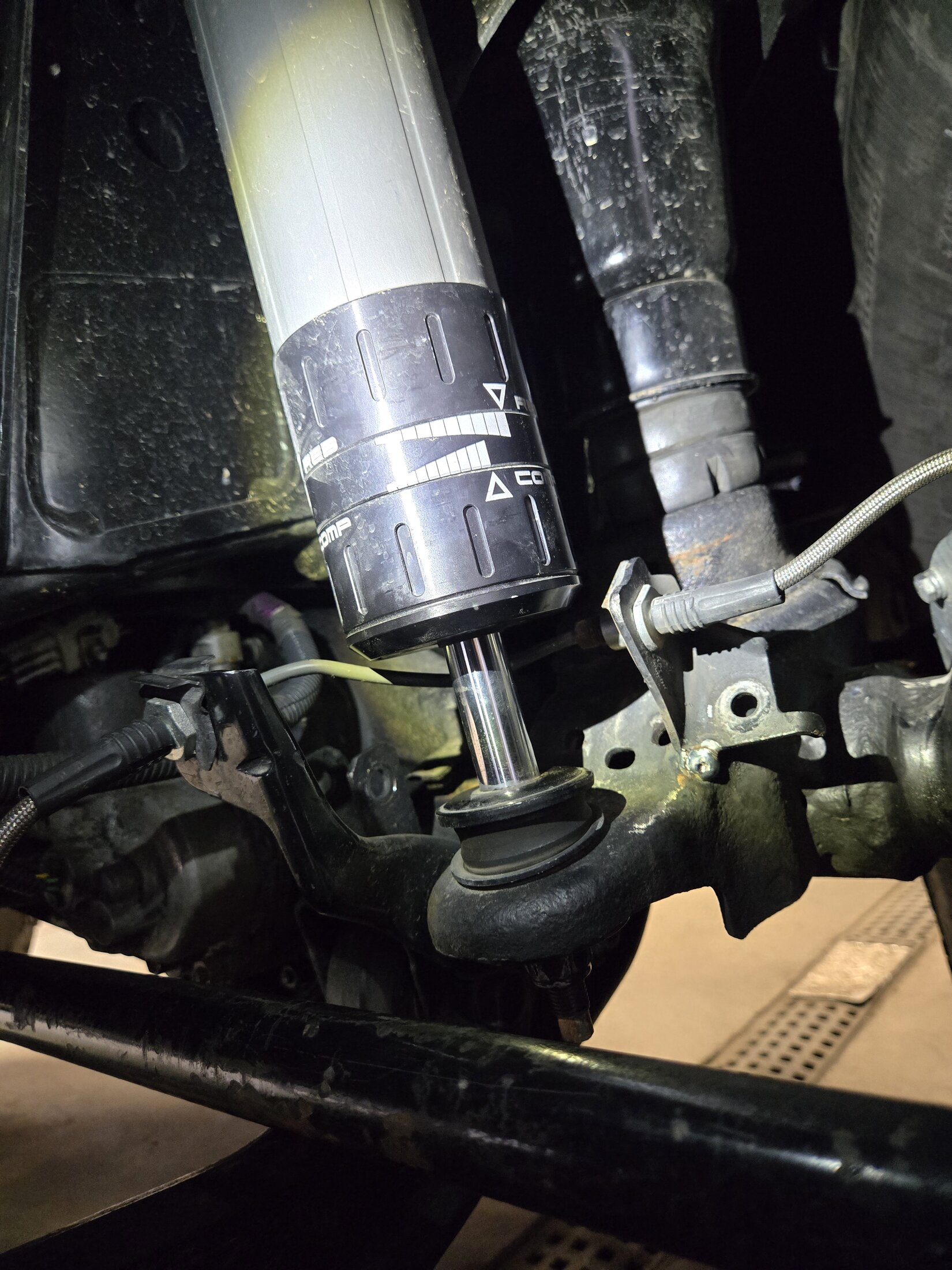

One thing I haven't noticed mentioned, or remember is the clearance problem with the OME BP51 shocks on full compression.
The brake line bracket on both sides will serve as a hard bump stop on the shock body itself. I relocated them outboard about 3/4"
The right side is a bit worse. The short hard line is also in the way. Gotta bend the bracket too. View attachment 3872517

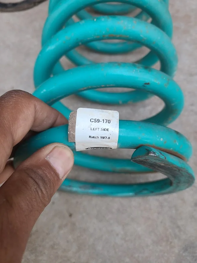

Hey fellas,
I did a search but didn't find the info I'm seeking. My C59-170 front springs has "left" and "right" side tags. In the USA, am I putting the "left" springs on the passenger front location? That's what I've been running for few years and this yielded the pass side being 1" higher. So, I was going to switch them so that the "left" side now sits on the driver location and see how the height numbers shake out.
Thanks for your feedback.
Hey fellas,
The fronts go on as labeled, but the rears get switched usually.

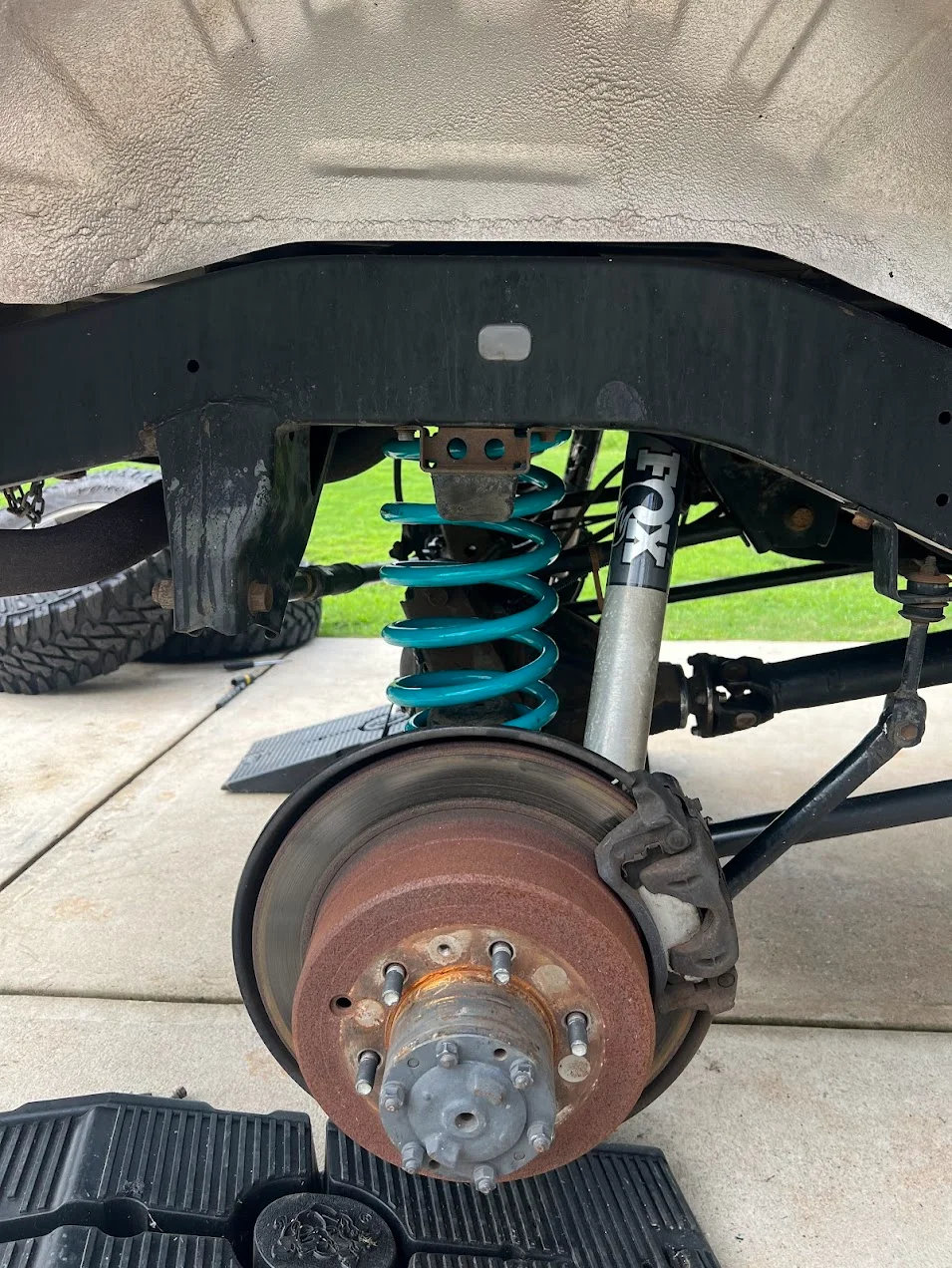

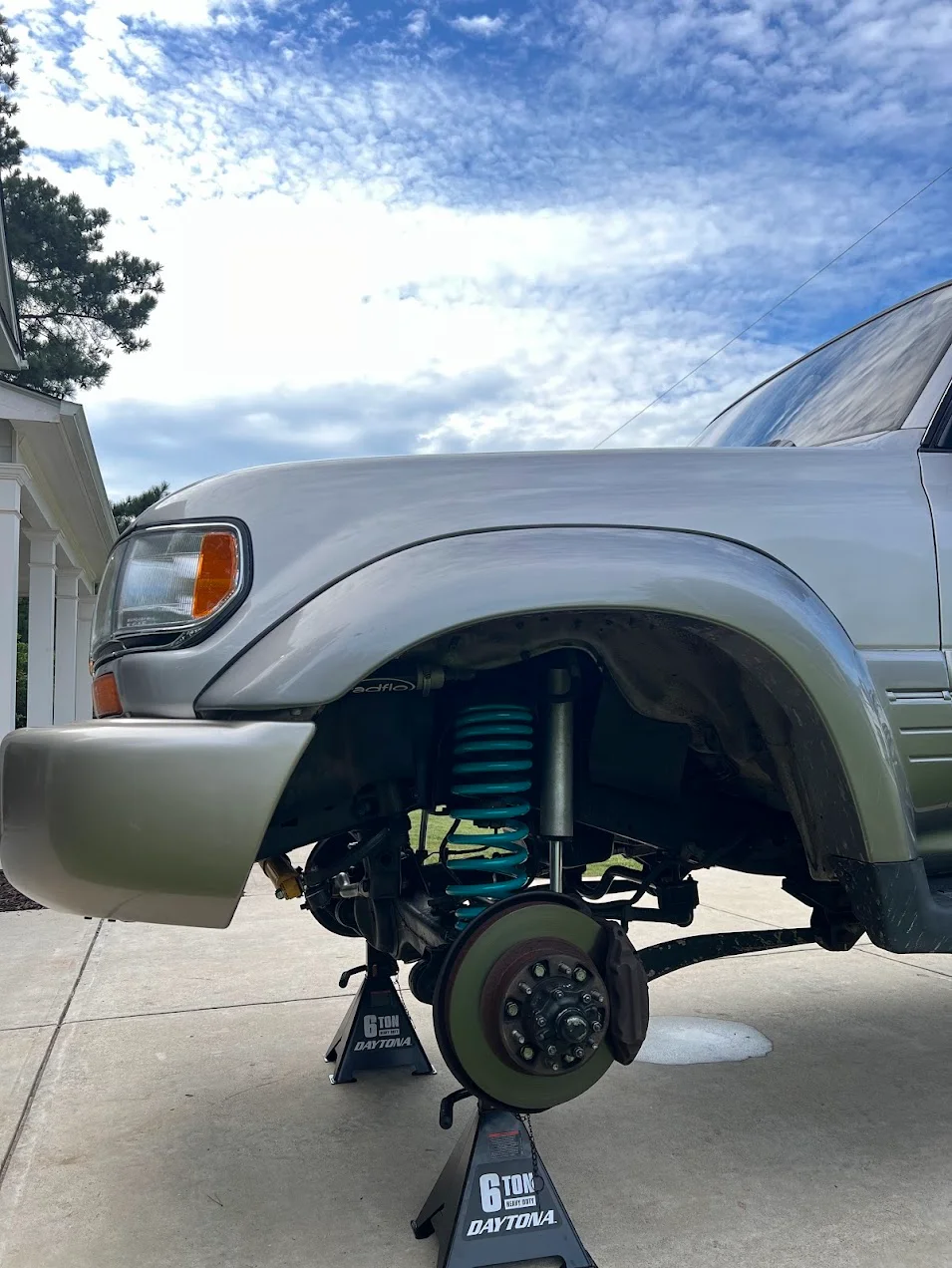

Current Measurements 1 week after install:
RF: 23.75"
RR: 24.75"
LR: 24.75"
LF: 24.25"
Dobinsons C59-612V 3″ Flexi Front Coil Springs
Dobinsons C59-613V 3″ Flexi Rear Coil Springs
Radflo OE Replacement 2.5 Front With Remote Reservoir
Fox 2.0 Performance Series Smooth Body IFP Shocks - Rear
Front Radius Arm drop brackets (uncertain if correct brand)
Front & Rear Adjustable Panhard Bar (unable to find brand/link)
Front Swaybar Drop Bracket (unable to find brand/link)
OME Steering Damper
Yokohama Geolandar M/T G003 315/75r16
Ride is VERY nice.
