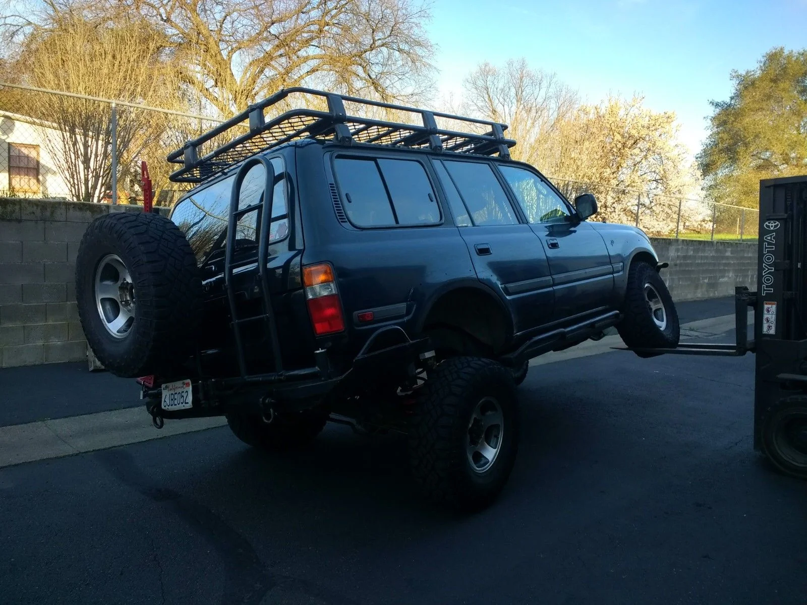

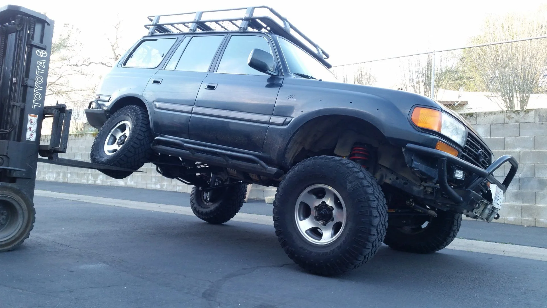

So glad you like the new ride. I got to play w/ @NorCal97 rig yesterday and flexed it out today with the forklift (28" Rear 26 Front articulation) My favorite part was when he said " hit that curb hard" 8-10" curb felt like a crack in the road to me. I have my 2" version going on my 92 next week.
The foam cell shocks are night and day different than a gas charged shock and I think you will find the longer you run them on corrugated roads and the freeway (new term to me being in CA now) the more you will like them in comparison.

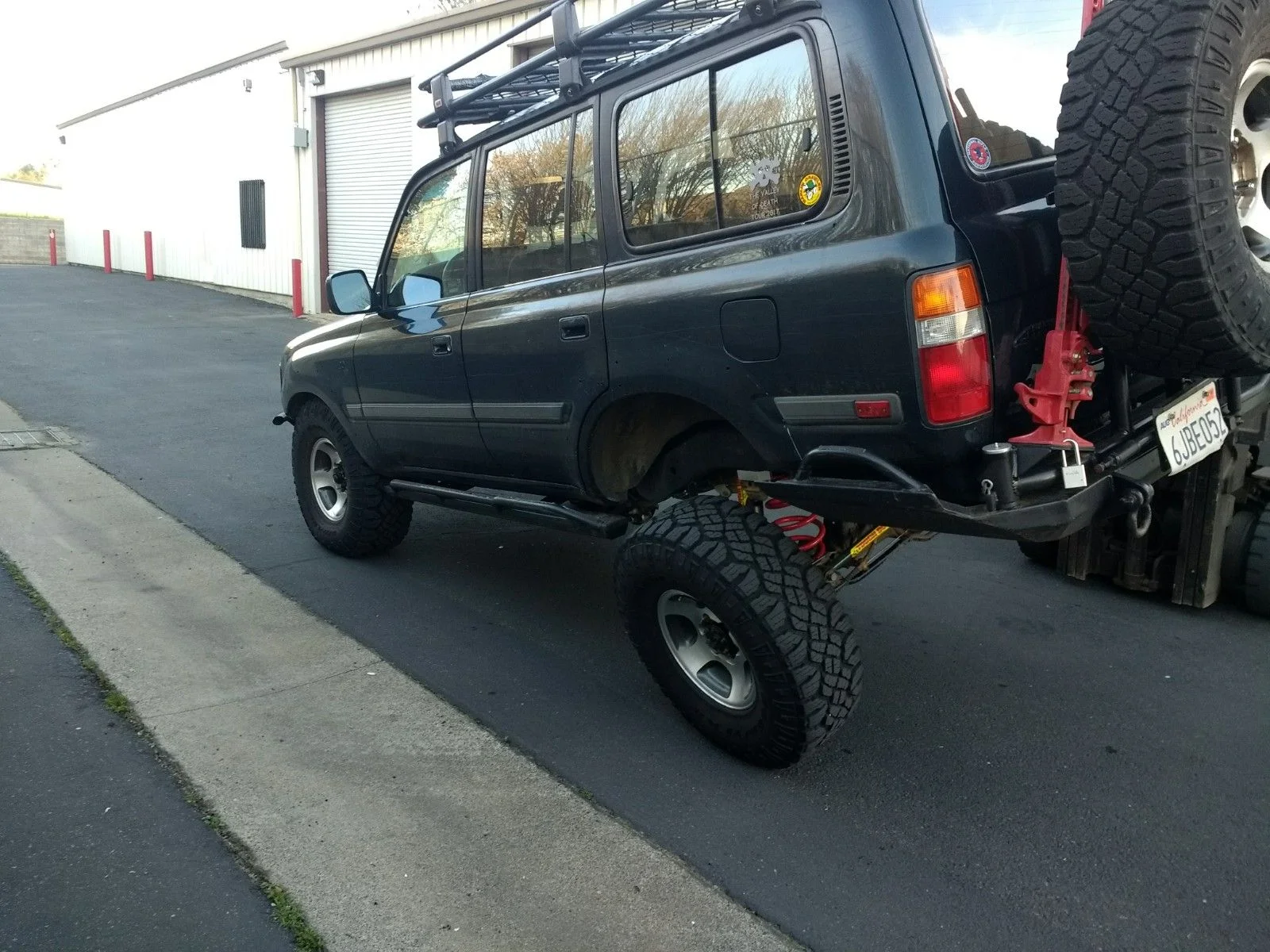

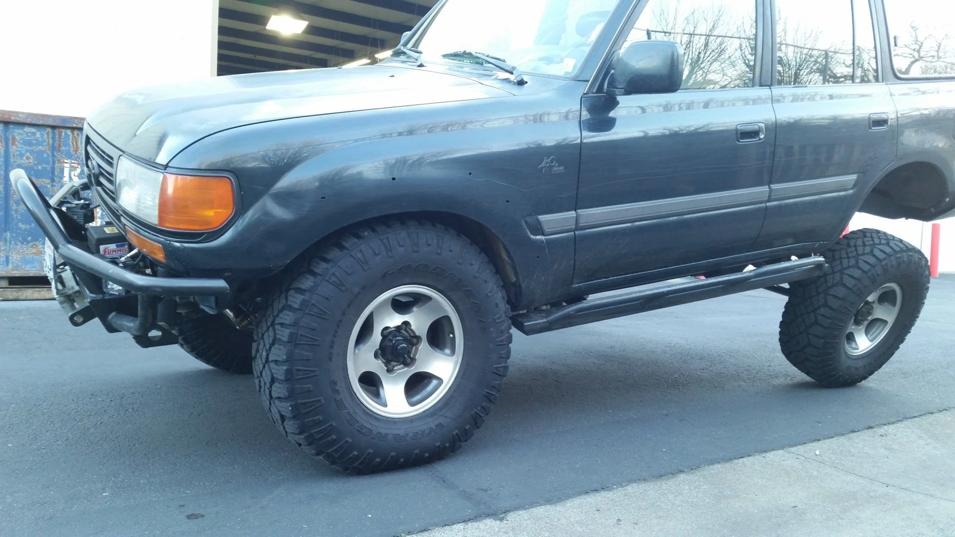

View attachment 1630597 View attachment 1630598
What springs and shocks is the green 80 sporting depicted?

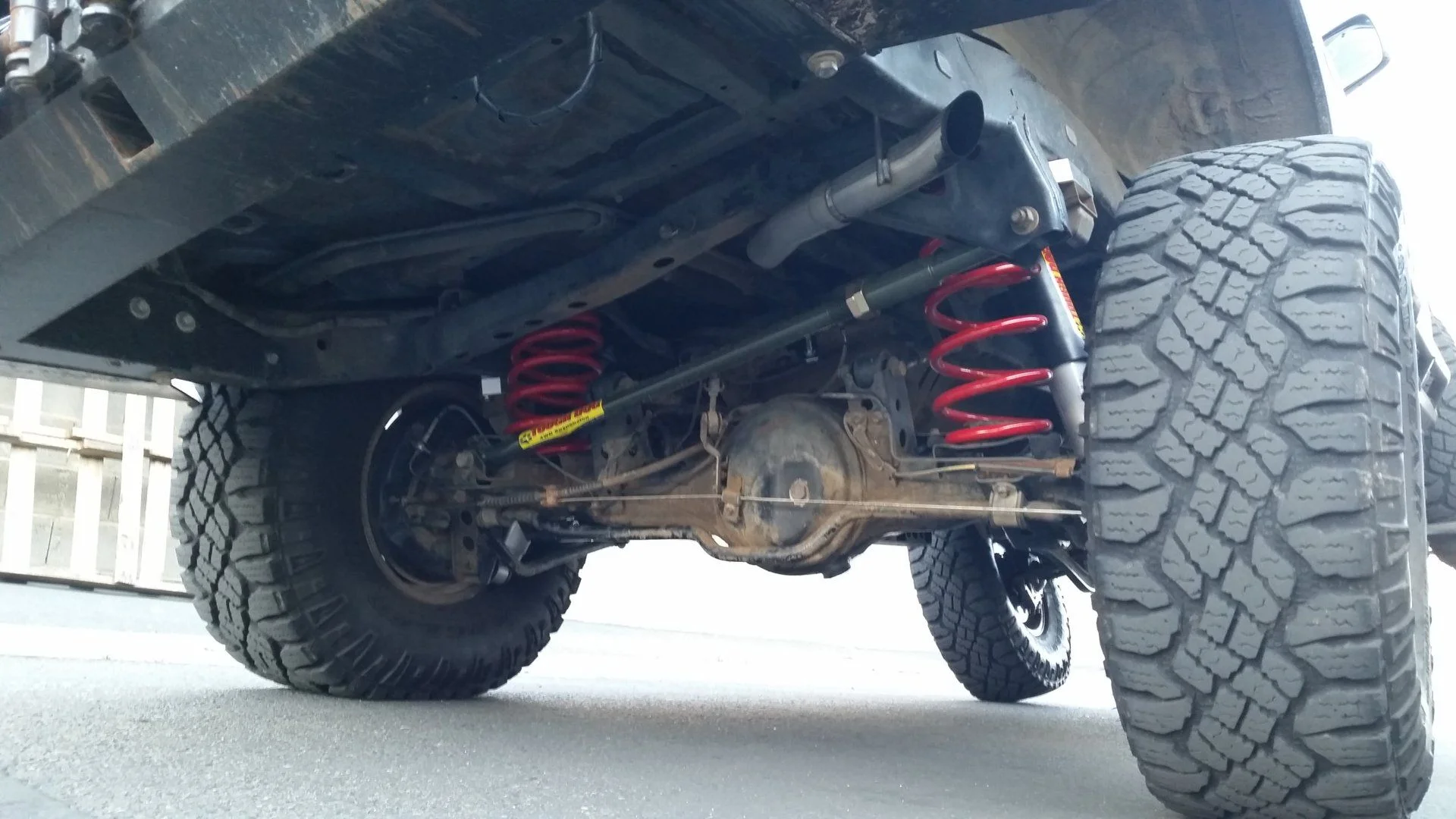

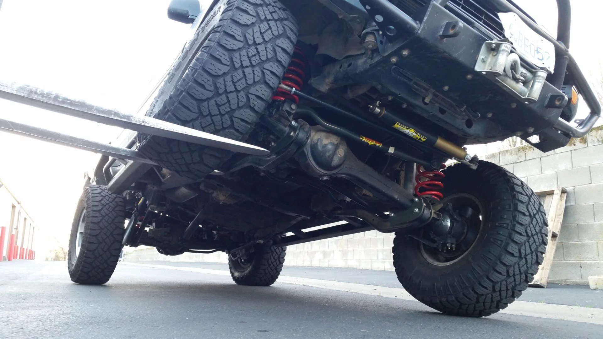

Rear sway bar disconnected?
How long is the rear shock when extended/compressed?
I want that kind of droop :)
Any pictures of the stuffed side? Sorry for all the question but am interested in this set up.
A
Hey @allan man, I'll let J speak to the shock & spring specifics...I'd screw it up if I try.
Both front and rear factory sway bars are attached, and are limiting flex a bit. Figured we'd run this flex trial with the sways connected to offer a better baseline from which others could compare (note that my rig does have a 1" body lift). I'd like to swing by his shop again some time and try without the sways...
Below are some additional pics.
Incidentally, I'm thoroughly enjoying the new ride.
