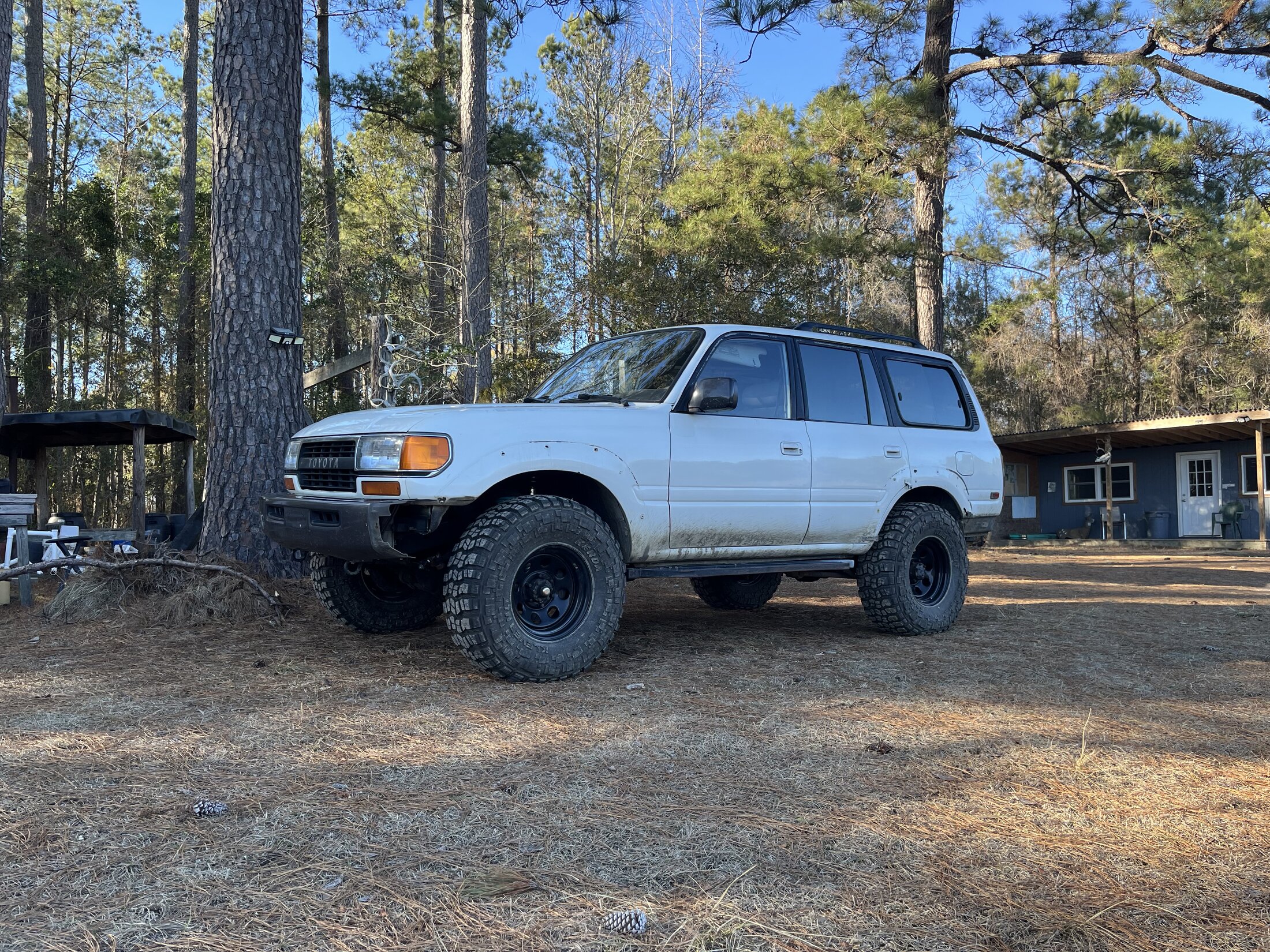

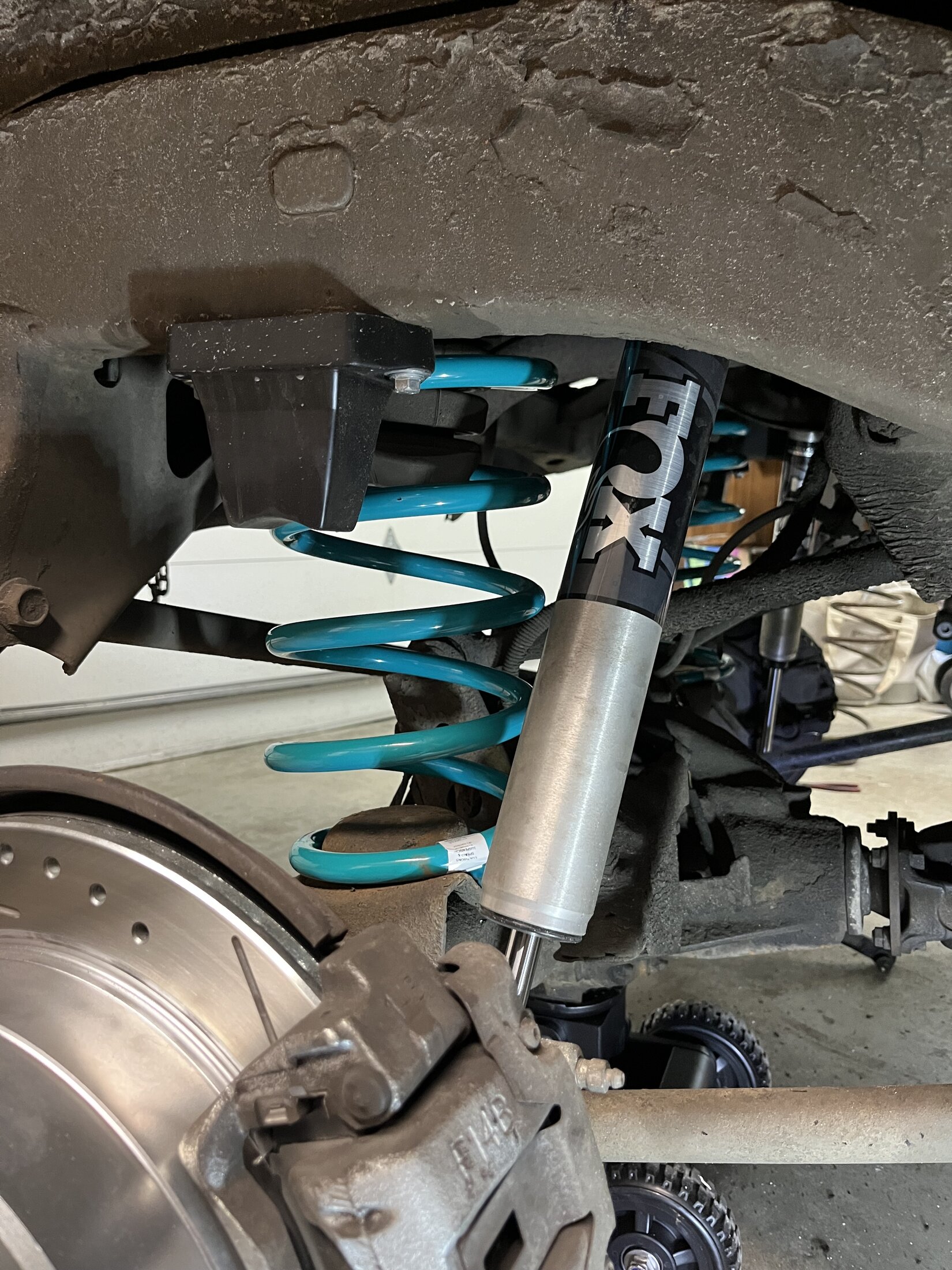

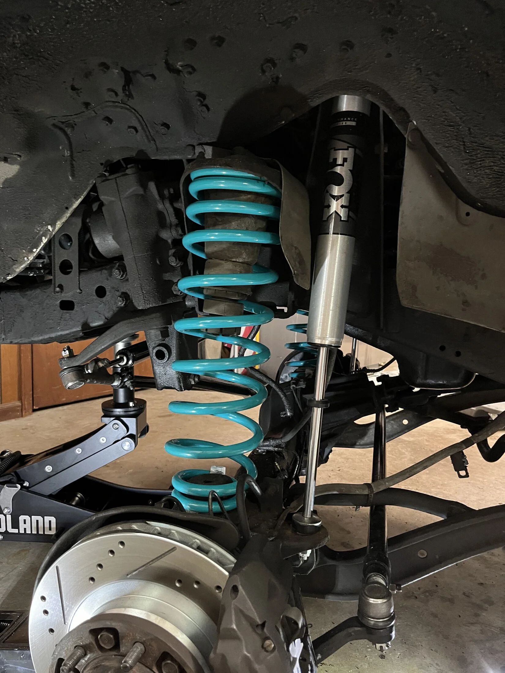

Hey all, I got a lot of great info from this thread and I recently installed some new springs on my 95 so I thought I'd share my before and after measurements and pics:
Springs- Dobinson C59-220v in front and C59-269v in the rear. The springs that were removed were presumably the factory originals with 273k miles. I have the third row seats removed, the running boards removed, the rear bumper end caps removed, and no weight to speak of added on just for a reference weight-wise; gas tank 1/2 full.
Measurements Before and after(center hub to bottom of fender with fender flare removed):
Driver Front: 20-1/4"---> 22-1/4"
Passenger Front: 19-7/8"---> 22-1/4"
Driver Rear: 21-1/8"---> 22-1/2"
Passenger Rear: 21-3/4"---> 23"
Shocks are Fox 2.0s which I put on before the new springs. Ride quality is GREATLY improved. When I bought this 80 about six weeks ago it was apparent 1 or more shocks were shot. The thing rode like a boat. Replacing the shocks helped but the springs made a huge difference is ride quality and handling. The ride is firmer but not harsh at all and roll is less pronounced. The pic from the driver side is with the new springs, the pic from pass side is with old springs, and the pic driver side with old wheels is how she looked when I bought it. The new tires are 285/75/16s for reference.
I have exact same setup! Question:
-when you go over speed bumps do you feel like suspension is bottoming out or the Fox shocks are possibly topping out?
The ride is great, just curious if you had any similar things going on over large bumps?
Unsure if I need to upgrade or drop my bumpstops or what the deal is 🤷‍♂️

I did Durobump extended bump stops in the back but I don't think they are quite enough. I think I'm right on the edge of bottoming out the shocks in the rear still, front seems ok so far. I don't really feel it going over bumps in everyday situations but off-road I think I could bottom out the rears shocks if I tried hard enough. I just jumped up to 315/75/16s so I need to go try and flex it out and see what is hitting where.

they make three different sizes and each unit is an inch longer than the next one. I got the 3.5” ones which are smallest as their site says that is for a 0-3” lift. Looking at the site again now I think I would have been better off going with a larger size. I did notice when I first flexed this thing out the Durobump stop has a tendency to deflect sideways when stuffing one wheel yielding less resistance than they likely do when bottoming out the entire axle at once. Maybe they base their recommendations off of this rather than stuffing one side at a time. Either way, i don’t see why you couldn’t use these along with a spacer like Slee or Dobinson so you get the progressive squish along with the proper up travel limit.
With all that said, I do think Fox 2.0s are probably too long with a mild lift like I have and are probably better suited for 3” lift or higher.🤷‍♂️

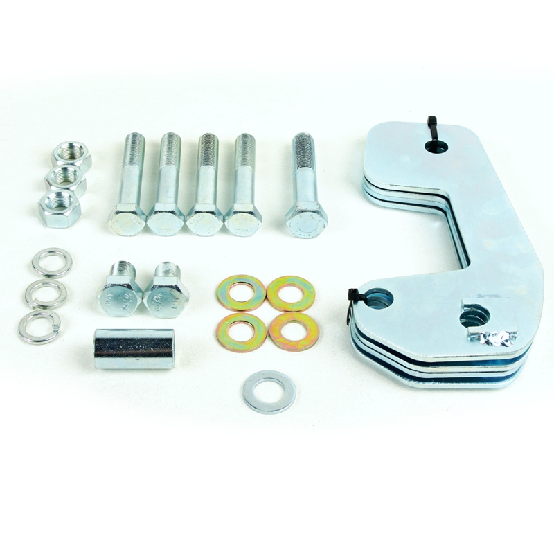

@Box Rocket. Appreciate the feedback.They all require notching or cutting into the frame side, correct? I was trying to consider if using the plates now, but changing my mind later would be a problem.
Only require a small notch to be cut on the axle brackets. It won't have any negative affect if you want to switch to aftermarket arms at some point. Some plate vendors recommend a small stitch weld of the plates to the axle brackets. I've seen many who choose not to do that and have no issues. Others just and a couple small tack welds that are easily cut/ground off if they ever remove the plates in favor of aftermarket radius arms.
So for a small amount of correction (say ~2 to 3 degrees), what are the options? I am at -1.3 and -1.5 today.
I see Land Tank has a nice set but doesn't span the top original bolt hole like some of the others. I assume that design would really need the stitch weld and would like to avoid welding this. I actually don't see any other plates for a 2" lift.

While they are designed for a 4" lift, my experience has been that the Slee caster plates work well for lifts between 2-4". I've had lift heights on my own 80s from 2" through 6" and with all of those I used Slee caster plates. Obviously the caster correction on a 6" lift wasn't quite adequate with the Slee plates, but I mention it purely to illustrate my experience.
Even if caster correction puts the caster on the upper end of the factory spec range it can be a overall positive effect on handling. Again, I'm just speaking from personal experience and speaking specifically in regards to caster correction plates. There are other ways to correct caster that are also effective (the most ideal being radius arms with the correction built in). But if you are looking at using plates to correct caster I've found that 4" plates work well even for slightly shorter lift heights (whether it's Slee or other brands).
Keep in mind that one possible side affect of caster plates is that the rotation of the axle can cause contact between the top of the radius arms and the tie rod. *Minimal* clearancing of the top of the radius arm will usually eliminate any contact.

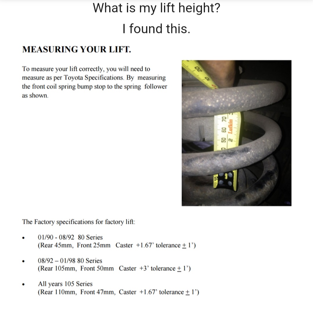

I'd overlooked it initially, or forgotten it, but the method of measuring lift...
Fronts only have 50 mm of up travel and rears have 105?
That sure doesn't seem like much.

Based on the bump stop distanced inside the springs of front 50mm and rear 105mm for stock lift.
This is with 5,880lbs. Front is 2,760 and rear is 3,120.
On the 2861 fronts there is about 90mm. 1.4" lift.
On the 2862 rears there is abot 105mm. 0 lift.
On the 2850j fronts there is about 143mm. 3.7" lift
On the 2863j rears there is about 165mm. 2.4" lift.

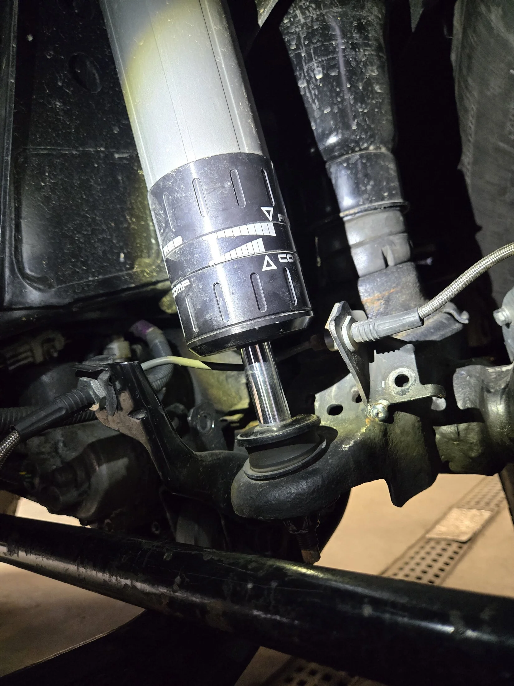

One thing I haven't noticed mentioned, or remember is the clearance problem with the OME BP51 shocks on full compression.
The brake line bracket on both sides will serve as a hard bump stop on the shock body itself. I relocated them outboard about 3/4"
The right side is a bit worse. The short hard line is also in the way. Gotta bend the bracket too.
