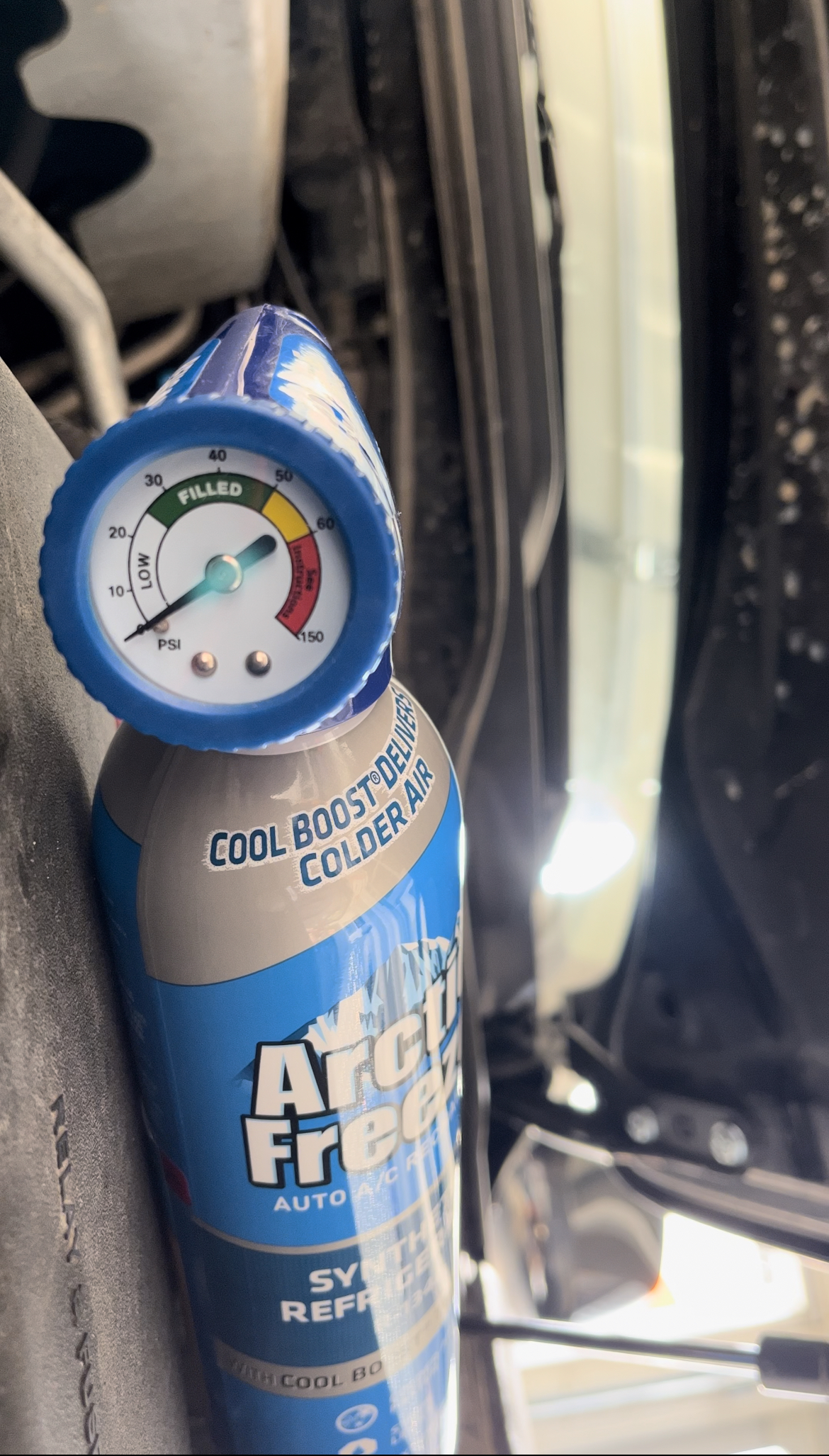

first pic is when the Ac is off and pressure holding.

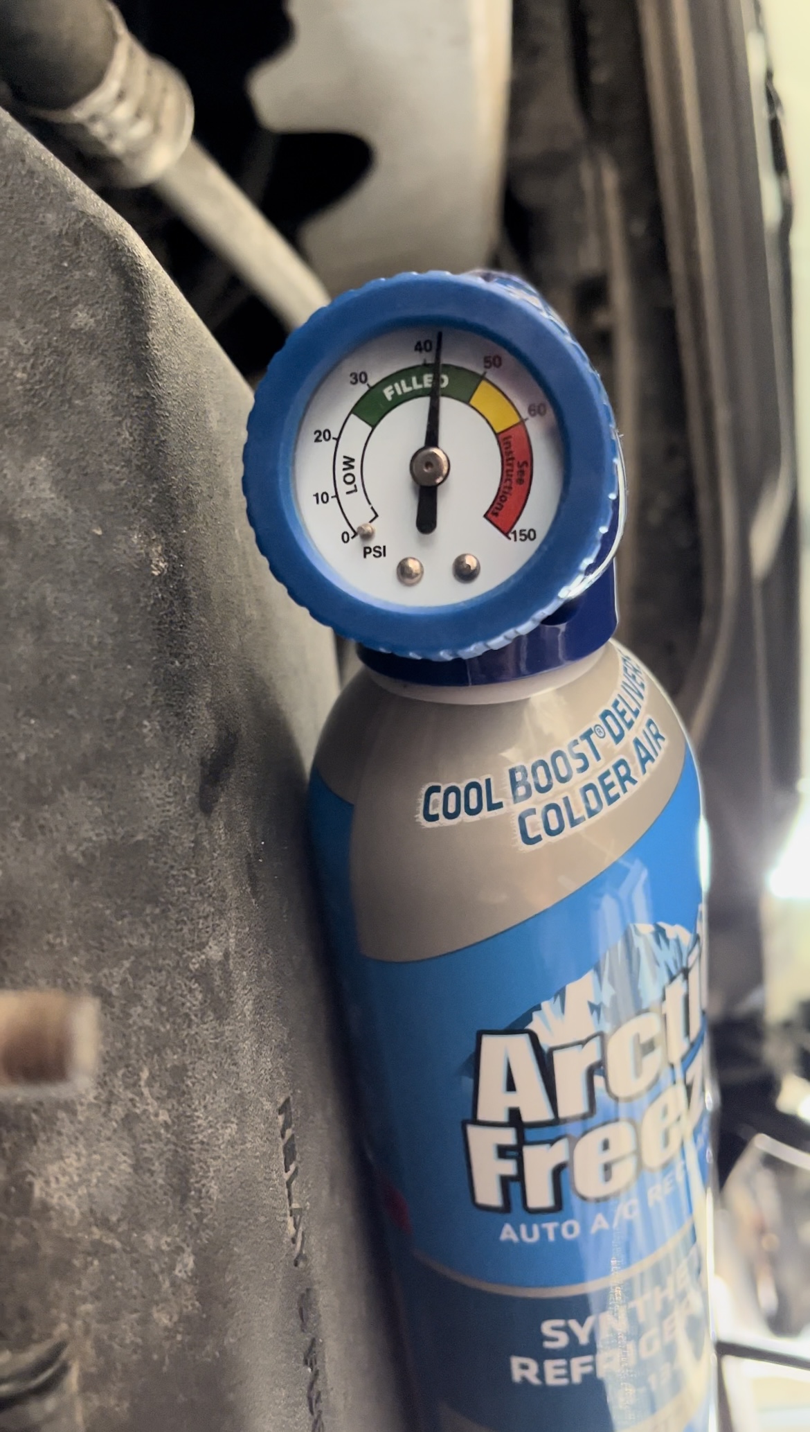

When I turn the ac on I hear the condenser click on and the gauge drops to 0.
And when the ac is turned off the gauge jumps back up to full
All while the ac still doesn’t blow cold.
Not sure if this means anything but if so chime in. Thanks!
That is expected behavior when the system is under-filled.
Should a gauge be showing any signs of it being filed while the ac is on? Or does a gauge drop when it’s on
If you will base it on the gauge on the can it should be in the green area once the system is near capacity. That is compressor engaged and low side hose/line should be cold. Look for wet spots in your a/c lines and front of condenser you could also have dye added to the system.
When the system is running correctly the low side should drop no lower than ~20-30psi before the compressor cycles off. The specific low side/high side target pressures vary by vehicle, ambient temperature and type of refrigerant used.
When the ac has been stopped for a while the low and high side will equalize to the refrigerant vapor pressure at the local temperature, assuming some liquid refrigerant remains in the system. That’s why it is more accurate to refill ac systems by weight vs v pressure.

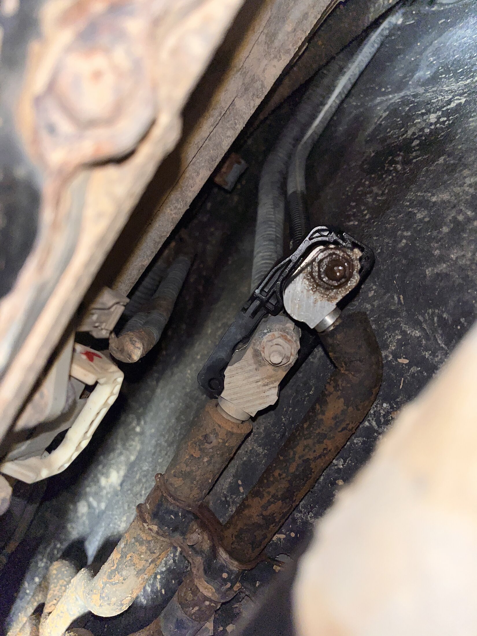

Went and had a shop replace some ac lines in the rear which they claimed fixed the leak. Got the truck back and found a puddle in the street under the drivers side in the middle and found this….
Puddle of what? Water? That’s where the air conditioning condensate (water) drain for the dash climate control is.
Also, the liquid didn’t evaporate like water does.
Then yes it’s probably AC system oil and that is likely a leak source. If you have a cool box in your console those lines run up into it. If not it’s possible that’s a joint before the lines run back to the rear AC.
The leak at the rear is somewhat common in vehicles with corrosion. From memory this would be one of the first I’ve seen posted with a leak in this specific spot.
But yes the condensate drain is in that area, sorry for the confusion.
