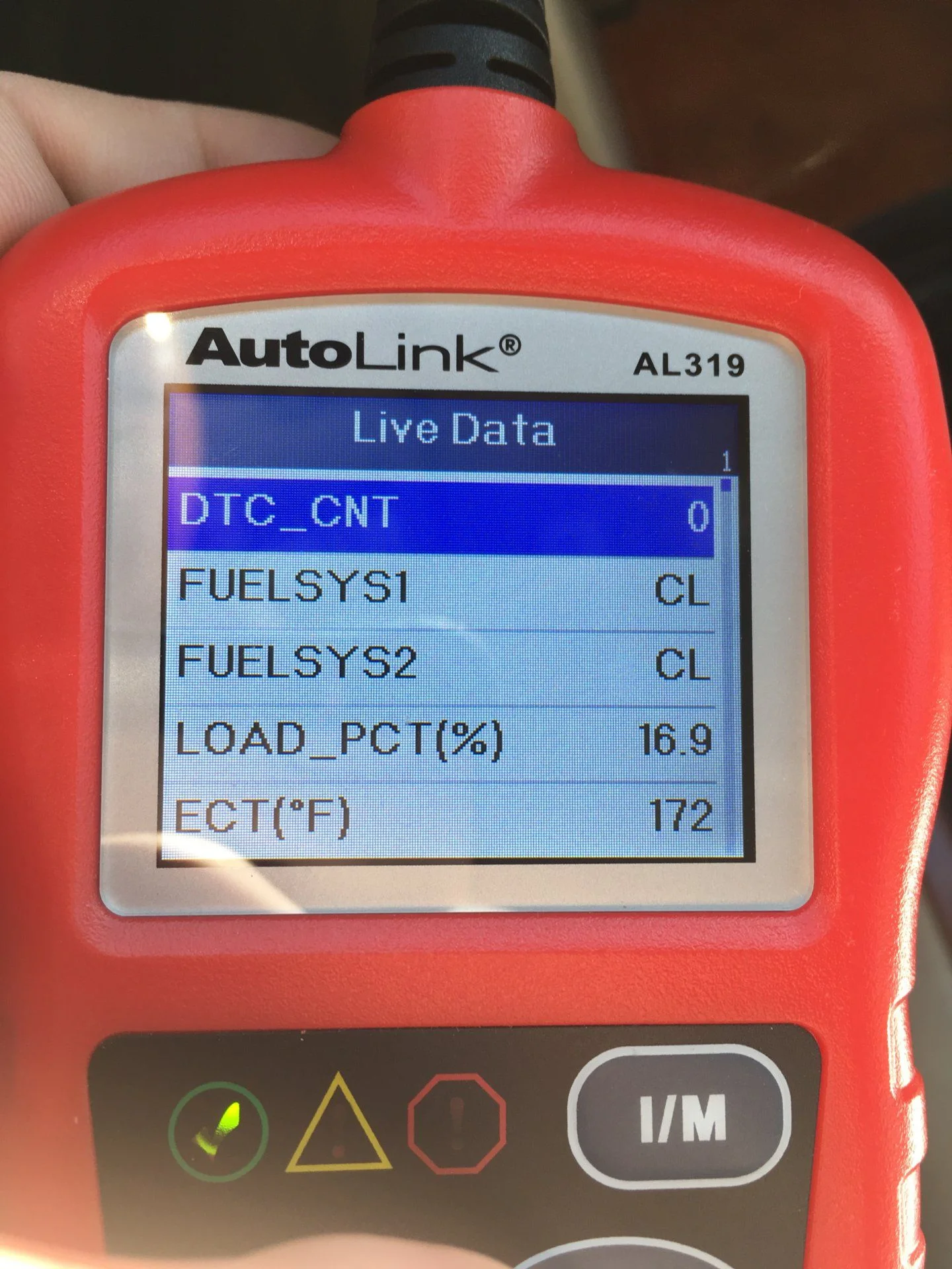

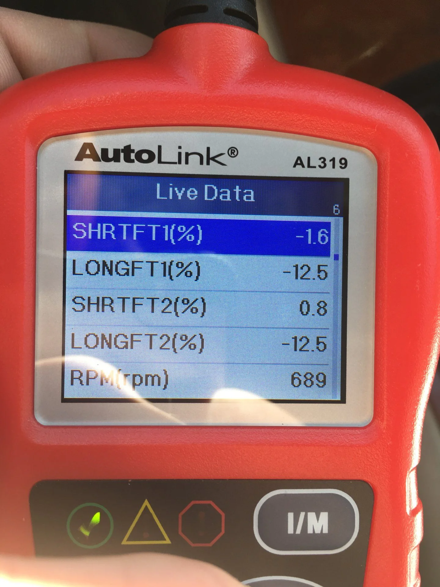

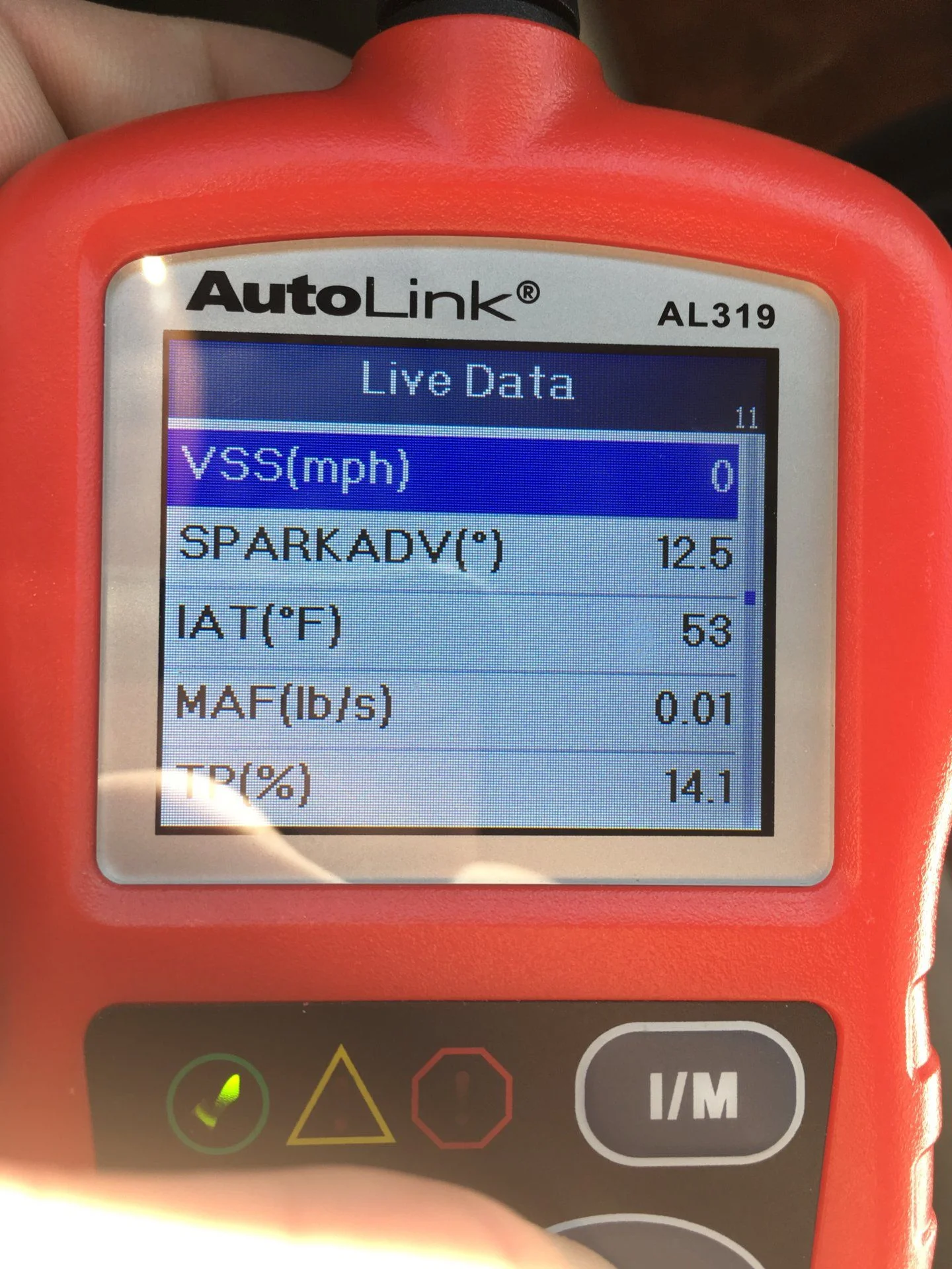

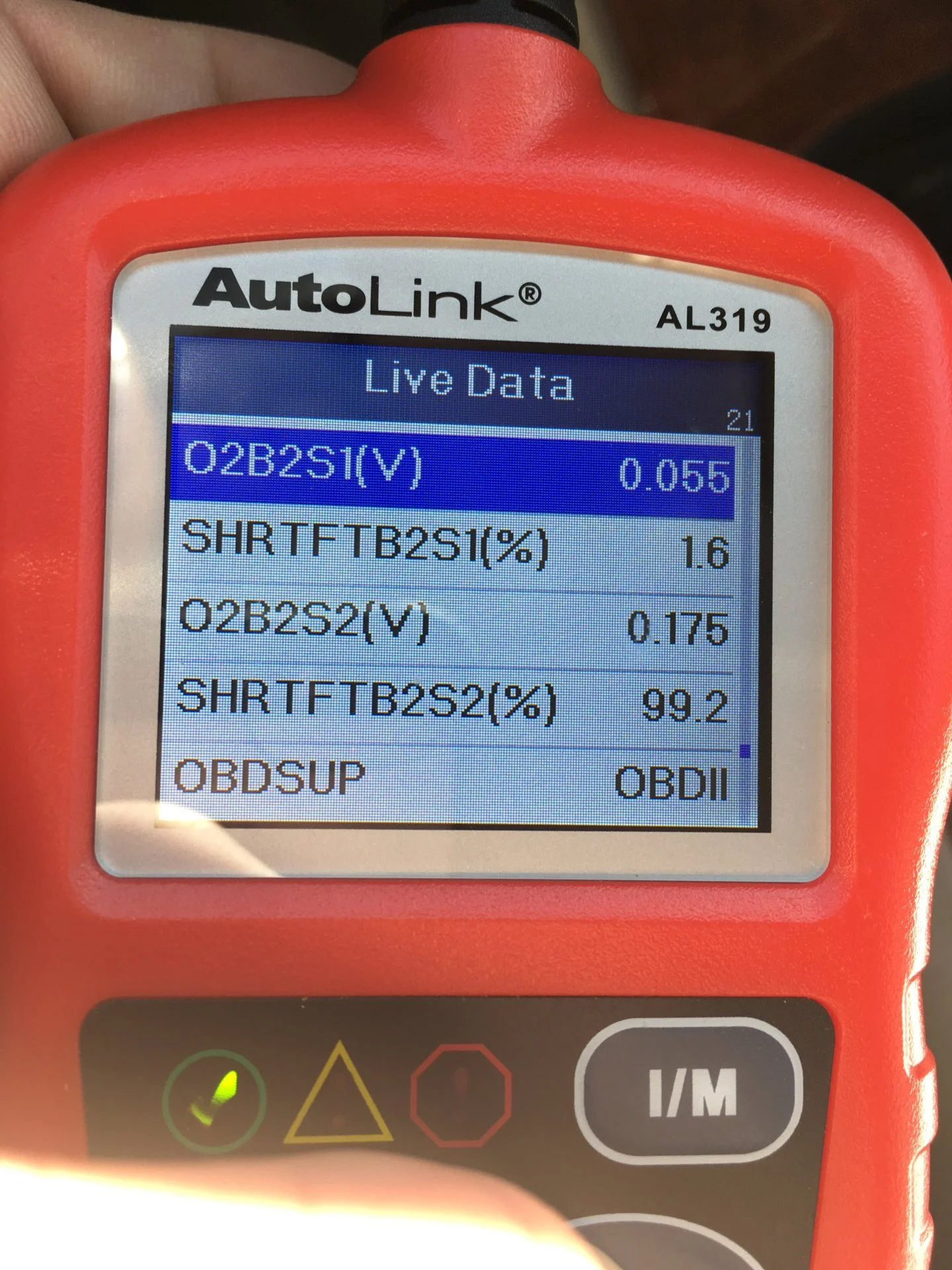

Also I checked the live data with a code reader and its showing the engine is running rich on start up at idle (Negative fuel trim levels). I'm getting 15-17mpg average highway driving.

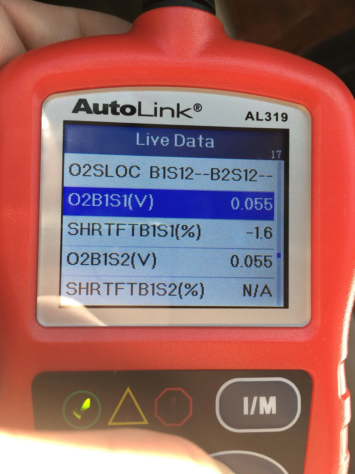

I looked further into the live data after the vehicle was warmed up and at idle. long term fuel trim stayed at -12.5. It looks as though a few sensors are messed up though. the short term fuel trim Bank 2 sensor 2 is reading 99.2% which looks out of place. also the short term fuel trim for B1 S2 is reading N/A. the volts on my O2 sensor for Bank 2 S2 is much higher than the others, so could this mean it would then send too much fuel in and cause a rich or lean running engine? I'm a novice when it comes to engine issues
O2B1S2 and O2B2S2 (secondary) sensors are only used to determine cat efficiency (emission requirement).
B1 and B2 (L&R) both have around -12% total fuel trim (ST+LT). Since both banks have similar trims, the problem is affecting both banks equally. That indicates a MAF issue or high fuel pressure (stuck regulator?).
Positive fuel trim can also be caused by a leaky injector but you would need an equal amount of leak on both banks to have identical fuel trim numbers. That is very unlikely.
I would start with the MAF. Do the total trim numbers get worse at higher RPM?
My car had negative fuel trims of almost identical numbers before I changed my MAF. Get a used one for cheap and see what happens

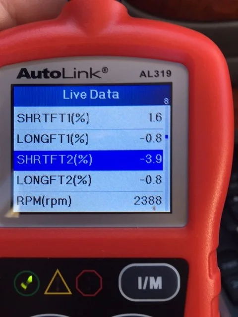

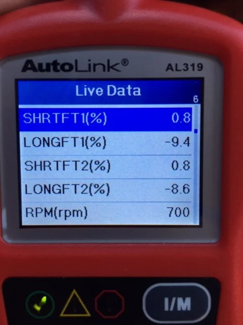

So after work I disconnected my batterie for 30min then drove 60 miles. here are the numbers after and during the drive. What do you think?
Car at idle
1951804
Car cruise control set at 65mph
1951806
parked and reved to 2100rpm
1951807

Do those numbers above look better?
coolant levels good. must not have been completely warm. these last numbers are with coolant temps at 186F. new oem thermostat last summer with TB job.
Still a little steep at idle, looks fine at RPM.
Again, exactly what my car was doing with the bad MAF.
But, definitely go through all the other tune items first. Vacuum leaks plus a bad or sort-of-dying MAF will cause issues.
