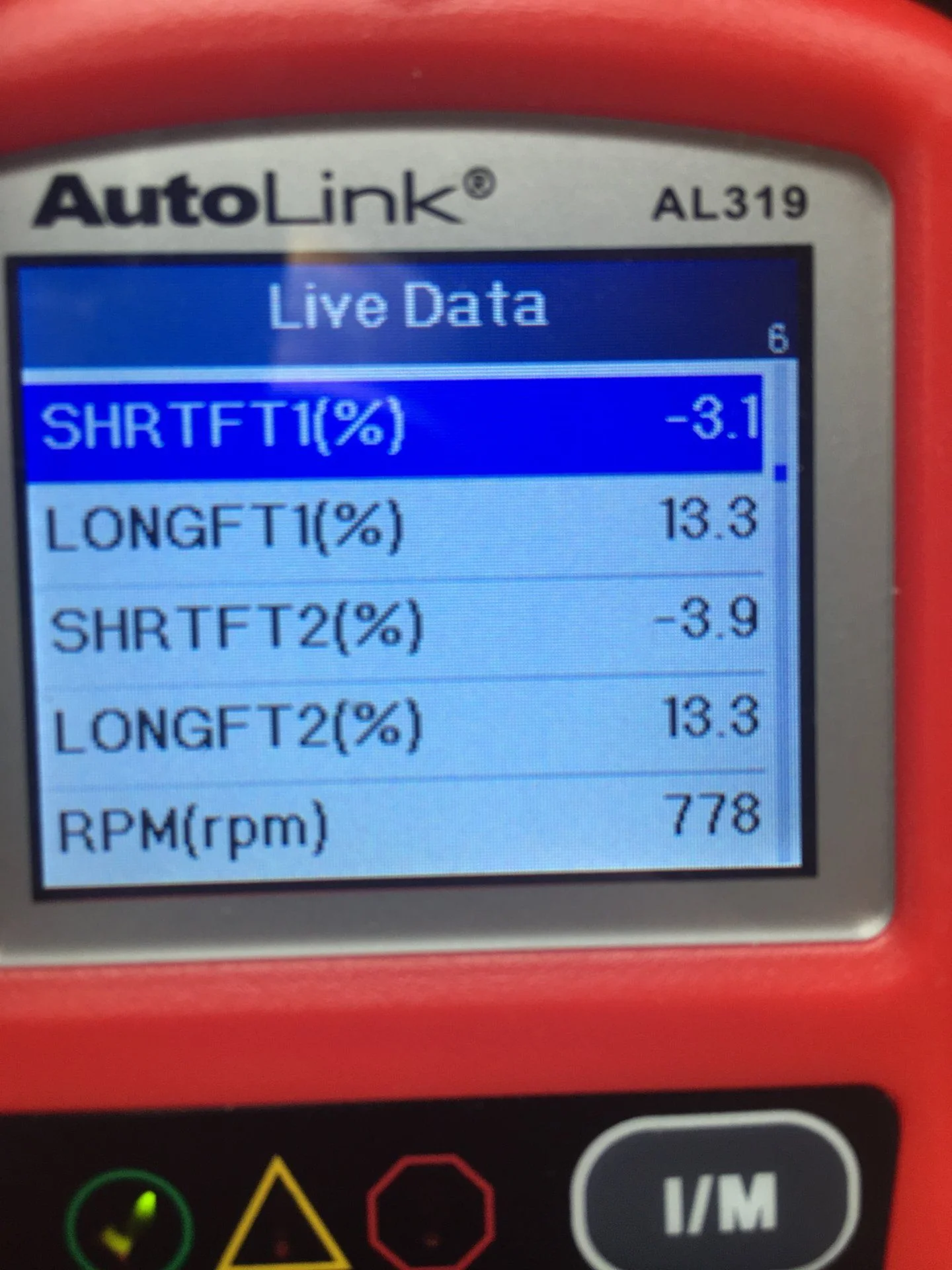

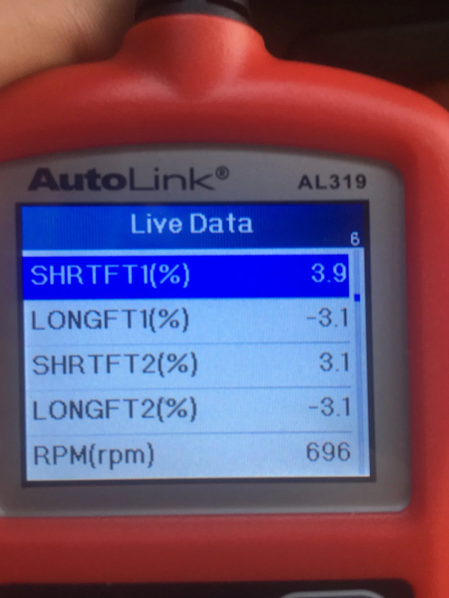

Guys does a car still run fine even with a bad maf sensor or there are always symptoms like idle etc.Had issues at cold start low idle and would sometimes die unless I rev it cleaned throttle body and maf sensor made a huge difference.
So after work I disconnected my batterie for 30min then drove 60 miles. here are the numbers after and during the drive. What do you think?

did you reset the computer(disconnect battery) before your replaced MAF?

Do those numbers above look better?
coolant levels good. must not have been completely warm. these last numbers are with coolant temps at 186F. new oem thermostat last summer with TB job.
The numbers do look better. But still LT FT to far off 0 at idle.
I like replacing all 8 plug if I replace any. Coils are a bit pricey, but I've had very good results replace all 8 with Denso. Coil boot kits are second choice and wroth it if any cracking boots.
Bad gas, MAF, clogged "fuel injector", bad plugs, coils or boots, vacuum leaks, weak current from battery, oxidation in wiring, etc. all make a deference. Getting all back as close to factory is the goal for running optimal.

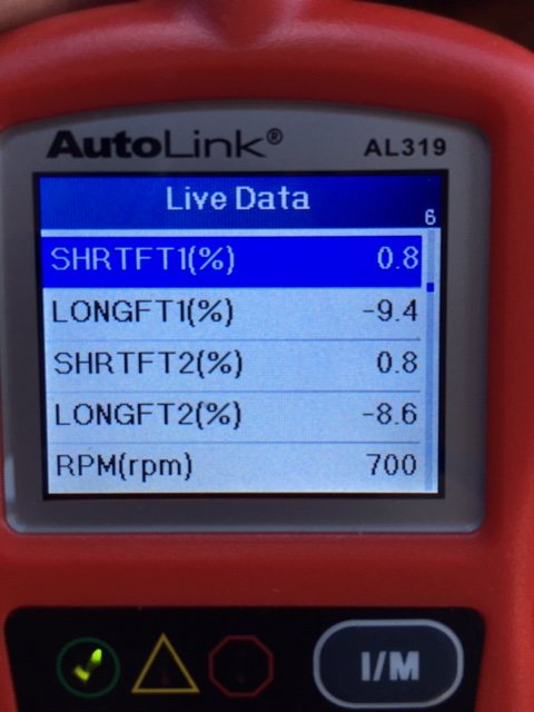

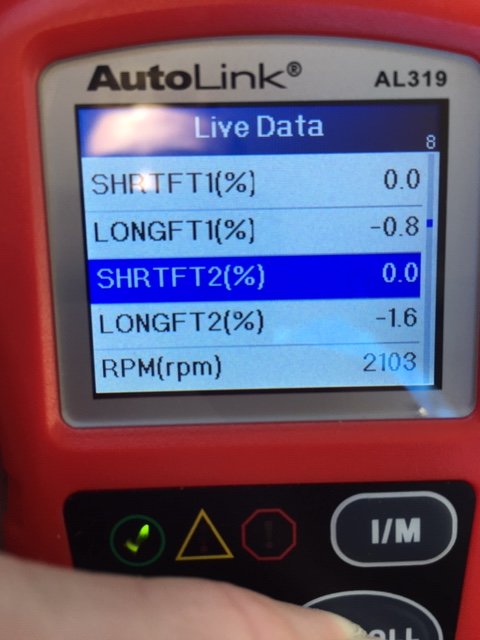

So just to update this I added a new MAF last week while waiting for some new hoses, PCV valve, and rubber grommet.
These to readings are with new MAF and reset computer. It was fluctuating between the two.

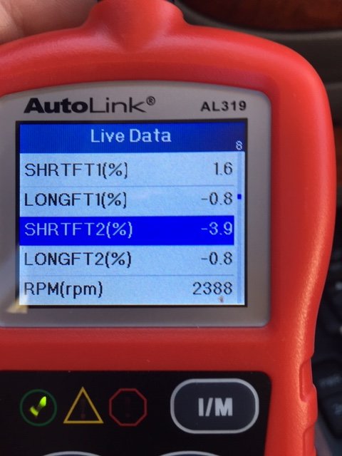

Then today I added new hoses, PCV, and grommet and reset the computer.
This is what its at now

How do these new numbers look?
No clue if this was the cause of my cold start issues, and I won't know for a while sense its no longer cold in Kansas.
New numbers look much better. You probably had something similar to my situation: vacuum leaks on top of a failing MAF.
