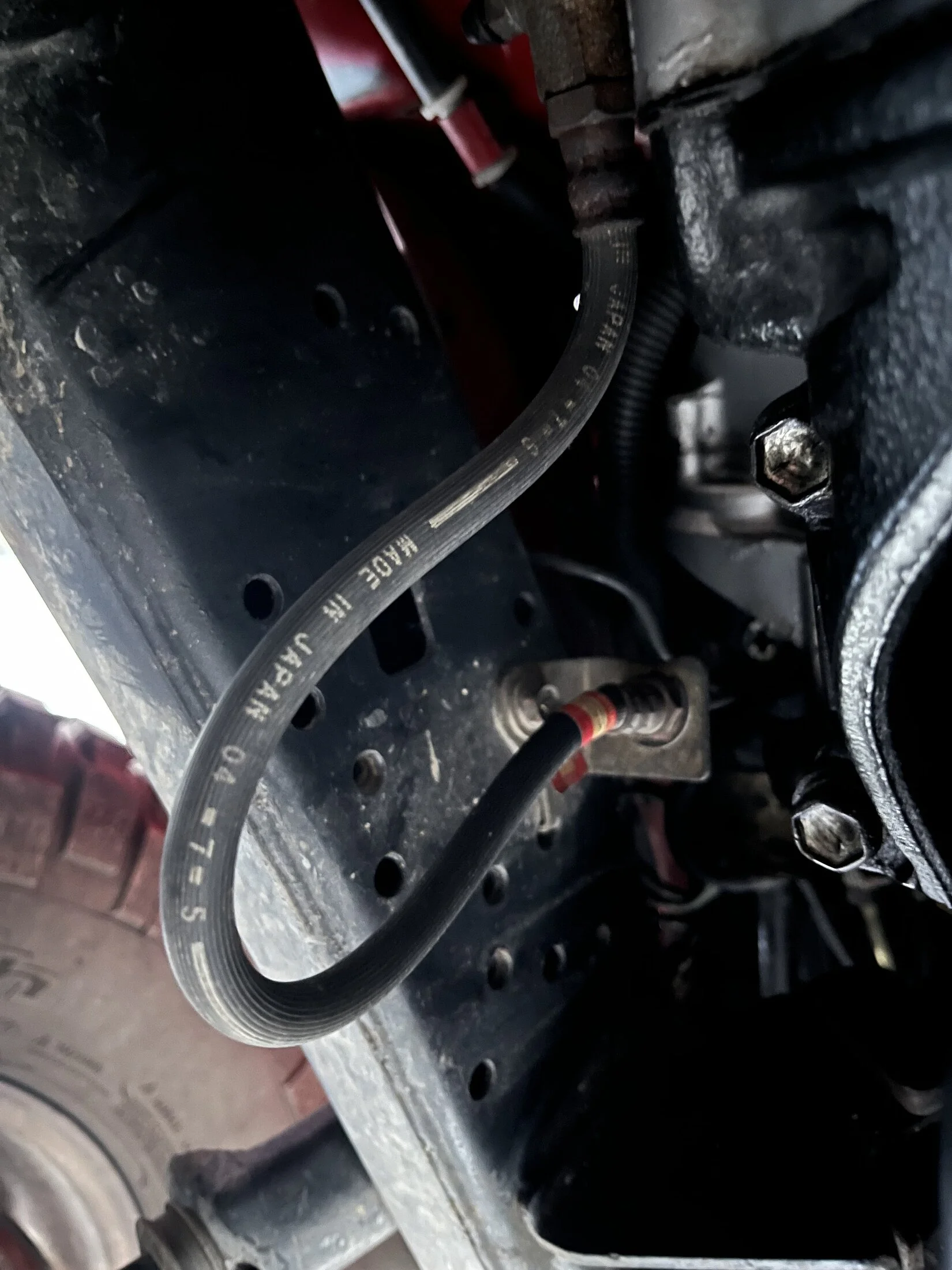

This is the installed hose which appears to be too long and is aftermarket from Japan, but was installed by the previous owner.
This hose is 10” long and when measuring the distance between the hard line connection and the slave cylinder; the correct length should be 7-8” allowing for movement of the transmission while driving.

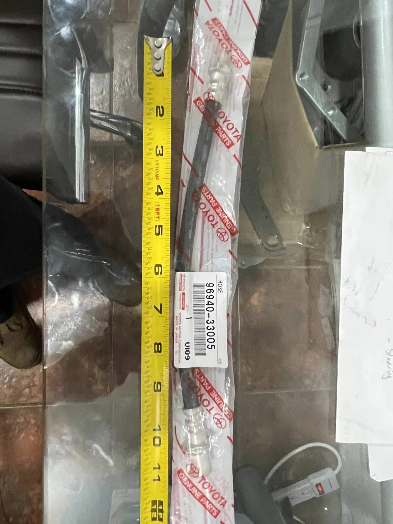

+85 FJ60/62 hose should work just fine. And readily available globally.
@cruisermatt
I don’t suppose you have the PN for that application.
Can I order the part thru you ?
IF so…. I would have you ship the part to my Jacksonville address.
Absolutely, and I will double check the length when in the shop tomorrow with some other hoses. I know we have 3-4 hoses we stick around that length.
