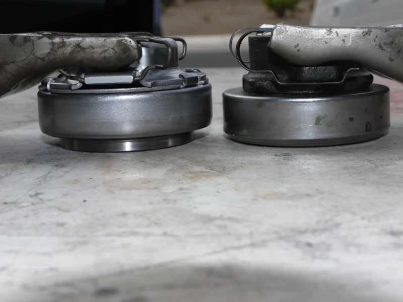

I went from a W56 B with the two piece TO bearing (cast part with replaceable bearing) to a R151F that came with a one piece TO bearing assembly. They looked very different but in reality the contact surfaces/dimensions were exactly the same and were interchangeable.
I did a post over on Yotatech with a lot of info on the clutch forks/levers and the TO bearings. I had 3 different types and they all worked on my W56 B and the R151F. I was going to give the link but the pics are all gone.
So I guess you need to mock them up and compare fit/measurements.

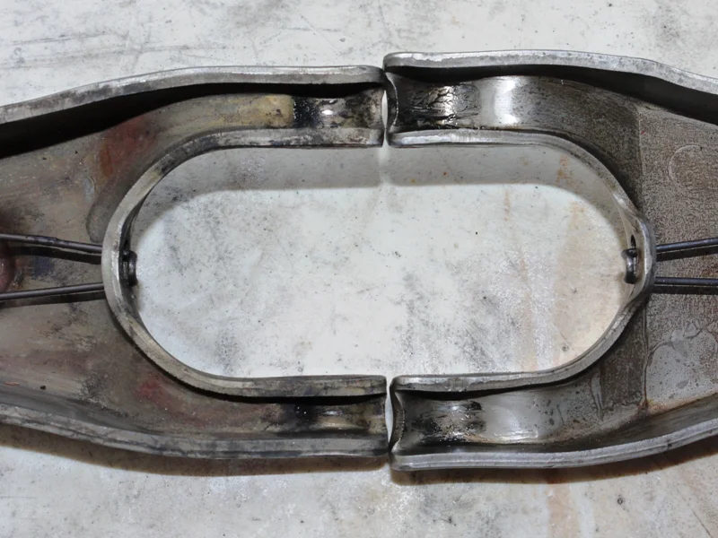

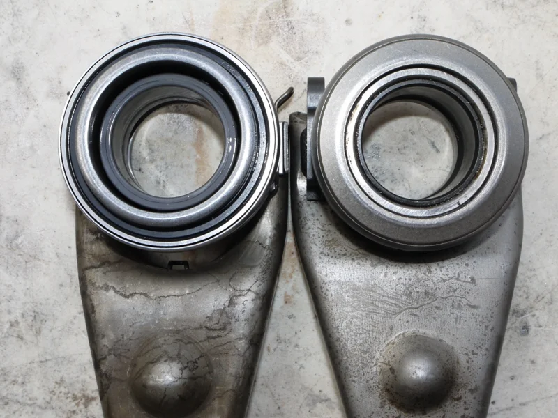

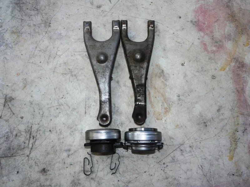

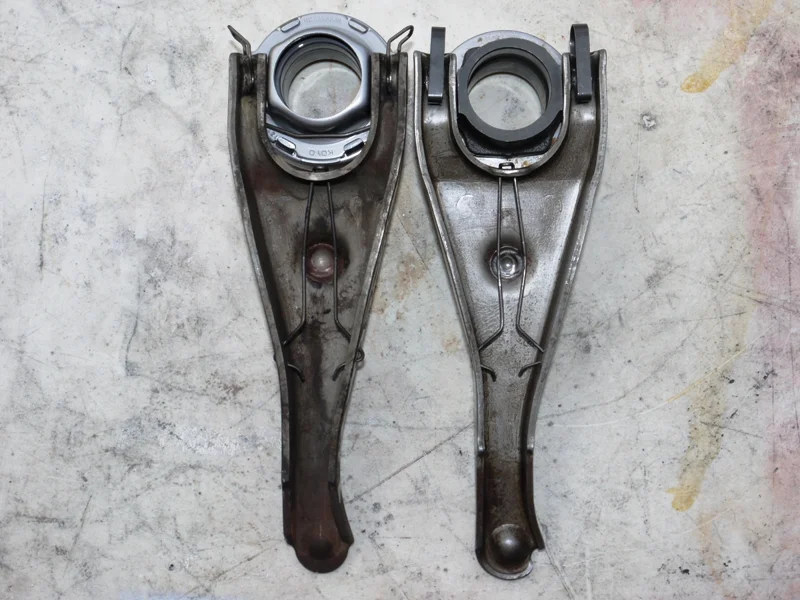

It is definately a different part and they both connect to the fork differently. the older style is a sleeve where you can just replace the bearing, the new style is a one piece deal.
I found my pics of the two different ones I had anyway. Either one worked on my W56B.

In the early 22re/W56 years the TO bearing was a two piece deal. Later, around 1989, Toyota went with the one piece bearing with the 22re/W56. They interchange. As I recall the one piece TO bearing was the same part number used on the 3RZ in the Tacomas.
I understand, but...
