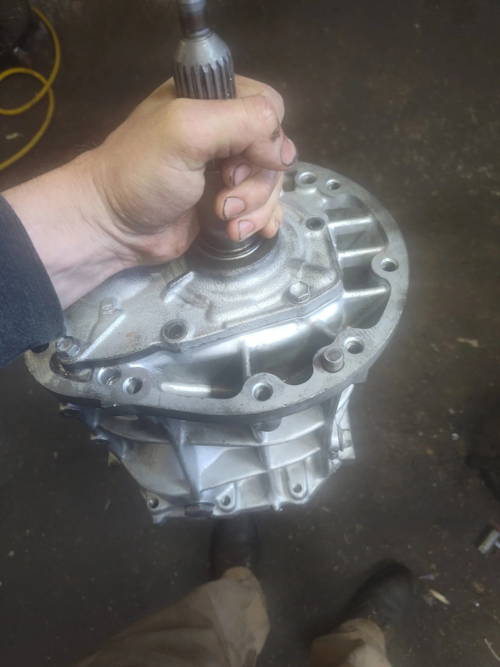

Introducing, test fit transmission.
Can be picked up with one hand. While I have a transmission jack, the asphalt ground paired with a slight slope usually leads to staining, cussing, drinking and sometimes even throwing of objects while trying to wrestle the r150 in place.
Now I can mix and match my clutch sets, new LUK flywheel and try to get proper clearance on this guy.
