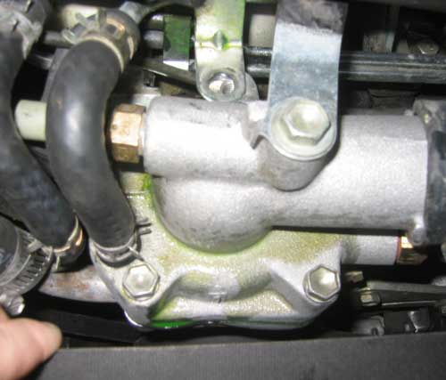

Also looked again at the t-stat housing. Looks like it's leaking. Can't tell exactly from where, but I suspect the cobbled-together gasket or that bolt hole (if that's possible).

That looks like a thermostat housing bolt that's missing, but I could be wrong as I've never looked at the motor in a 60. If it is- well duh... :D

It looks like the leak is higher than the gasket, maybe one of the sensors, or the fan is blowing the coolant up there?
Since I didn't see any coolant actually in the bolt hole, I tend to believe you fan-blowing theory. Where are the CSIs when you need em? :confused: :D
The missing bolt is just to hold that hose bracket on, so no issue. There is coolant higher than the gasket, most of the time it doesn't flow up hill and IIRC that gasket was nice and thick, shouldn't leak? The leak maybe from one of the sensors or hoses?

That gasket shouldn't be leaking, but anything's possible. I agree with Kevin in that it looks like it might be that hose just to the left there. The leak's probably coming from up high. That cruddy connection below has got me stumped. I can't quite tell from the pic where or what that is. You got a bigger pic of it?
