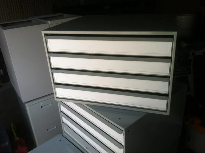

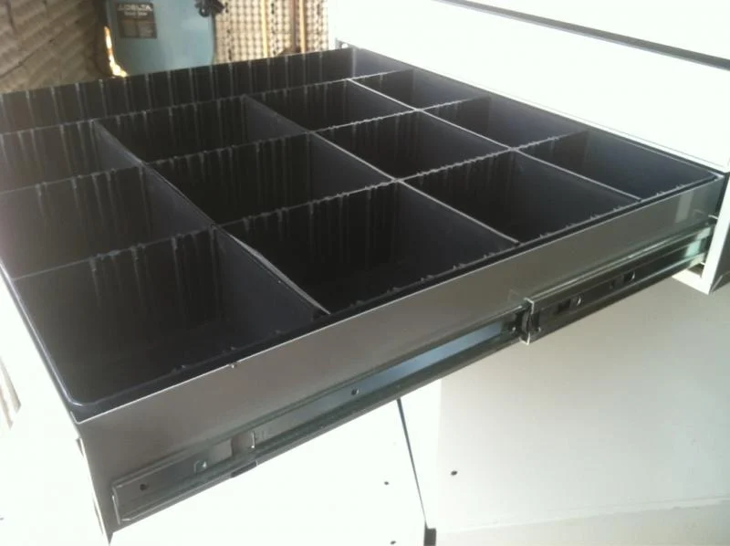

Donating 2 of these for the trailer build. They will come in very handy for storing parts and tools. If any of y'all want these for your shop I'm selling these as well.
