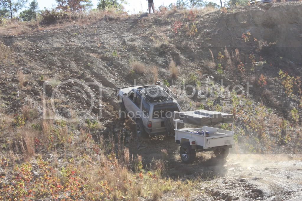

I like the concept but my concern is if we do this we will have to have a 6 - 10" block welded to the bottom of the trailer to attach the unit to, other wise if Marshall is towing it with his sprung over 40 the tail end of the trailer is gonna drag all over the trail. In adding this block it would seem it would make the trailer more top heavy and the center of gravity higher and have a greater tendency to tip. The other concern is the spring made out of hollow rubber, do they make a spare incase it breaks on the trail?

That height's [edit: see link below for dimensions] not any different than an axle under a leaf pack. (The only thing tighter to the frame would be a torsion axle.) And as Marshall said, the frame could be incorporated. The tongue height can be handled by any truck with an adjustable hitch receiver that will always travel with the trailer. I think its safe to assume that any truck towing the club trailer would be lifted at least 2 inches. The difference can be made up with the adjustable receiver.

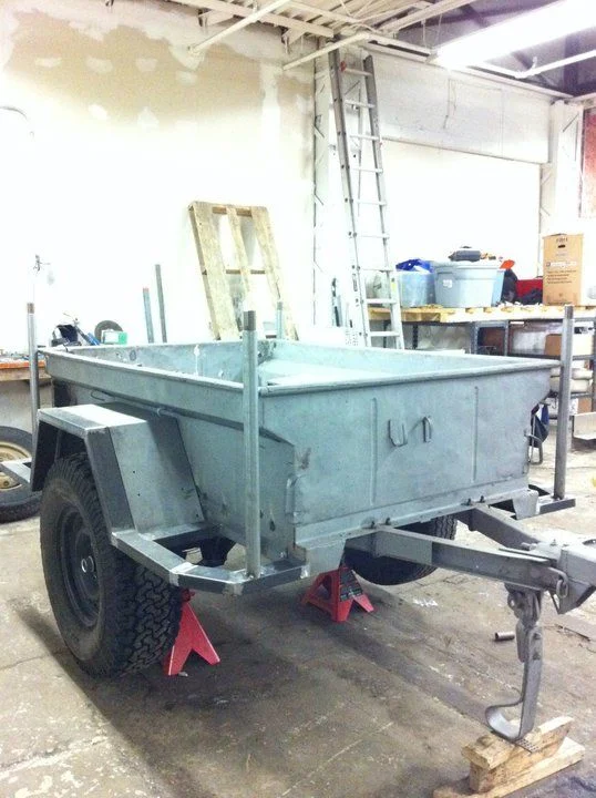

I really like what this guy did with his military trailer fenders.

Simple strong and hopefully not too heavy! Looks good to me. :)
Wonder if we could make it out of sprinkler pipe. That's light and somewhat strong. We would have to miter the cuts though as we don't have a die for it to bend.

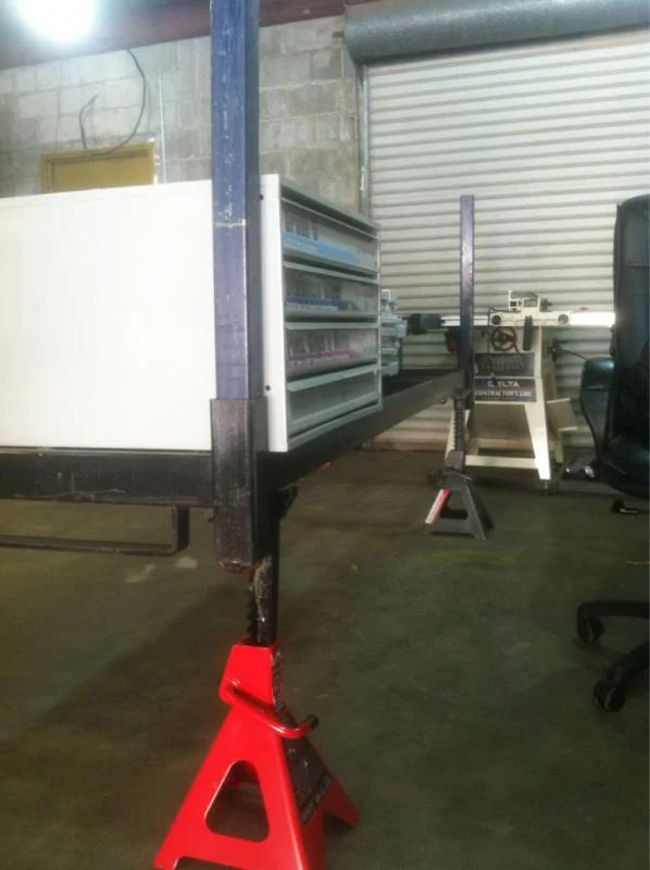

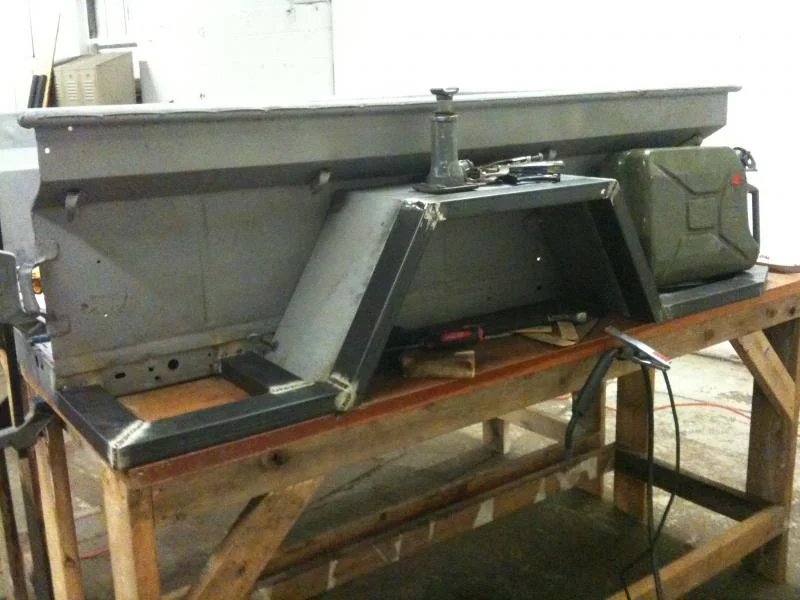

John Lee and I did some more brainstorming today. Got the trailer up to where it should sit. Chuck there is no way the grill will go on the bottom of the trailer. The fenders are going to be too long and tall. Maybe just do away with the idea of a slide out grill? If not its going to need to be at least above the height of the tool boxes.
