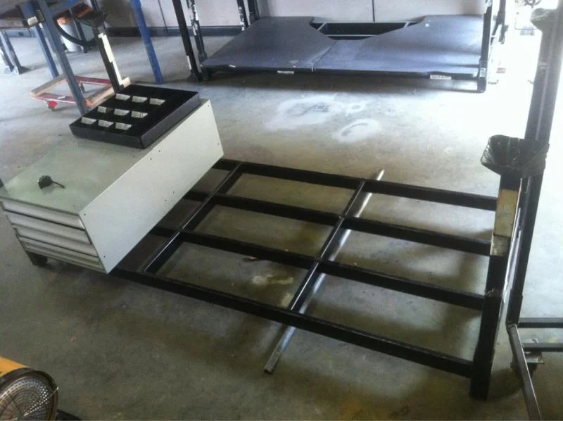

Chuck came by today to help on the shop. I had a little time to spare between work so I suggested we get the trailer frame out and start planning how we are going to build it. After about an hr of bouncing ideas off each other I think we have a plan. Here is the basic shape of the trailer to come.
I know it's had to visualize it with a pipe as the axle but until we can get everything on the trailer and the weight figured out I don't think we want to go out and rush into springs and axles when we don't know the weight of the axle.
We also figured out how we can store water. Build 3 tanks that fit up under the platform in the recesses. Each space is roughly 30"x12"x3". Equates to about 5 gallons in each tank. Giving us 15 gallons total of water capacity. Or 10 for grey water (think sucking up 10 gallons of water at the last stream before camp for the shower) and 5 for the sink and drinking water. Just some ideas.
There will also be four smaller posts that fit inside the main posts to use as a leveler. Also we came up with a top that raises up to give us additional place to put things and give us access to the inside. As well it will have two fold out leaves that can fold out and give us a little shelter on both sides.

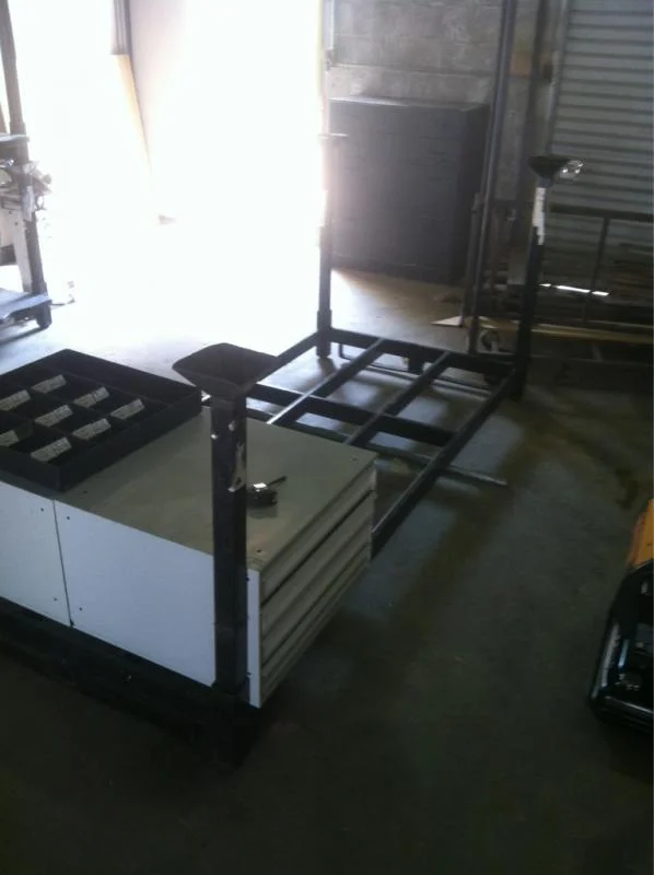

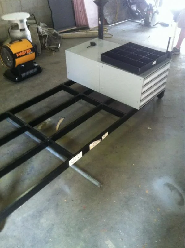

starting to grow
