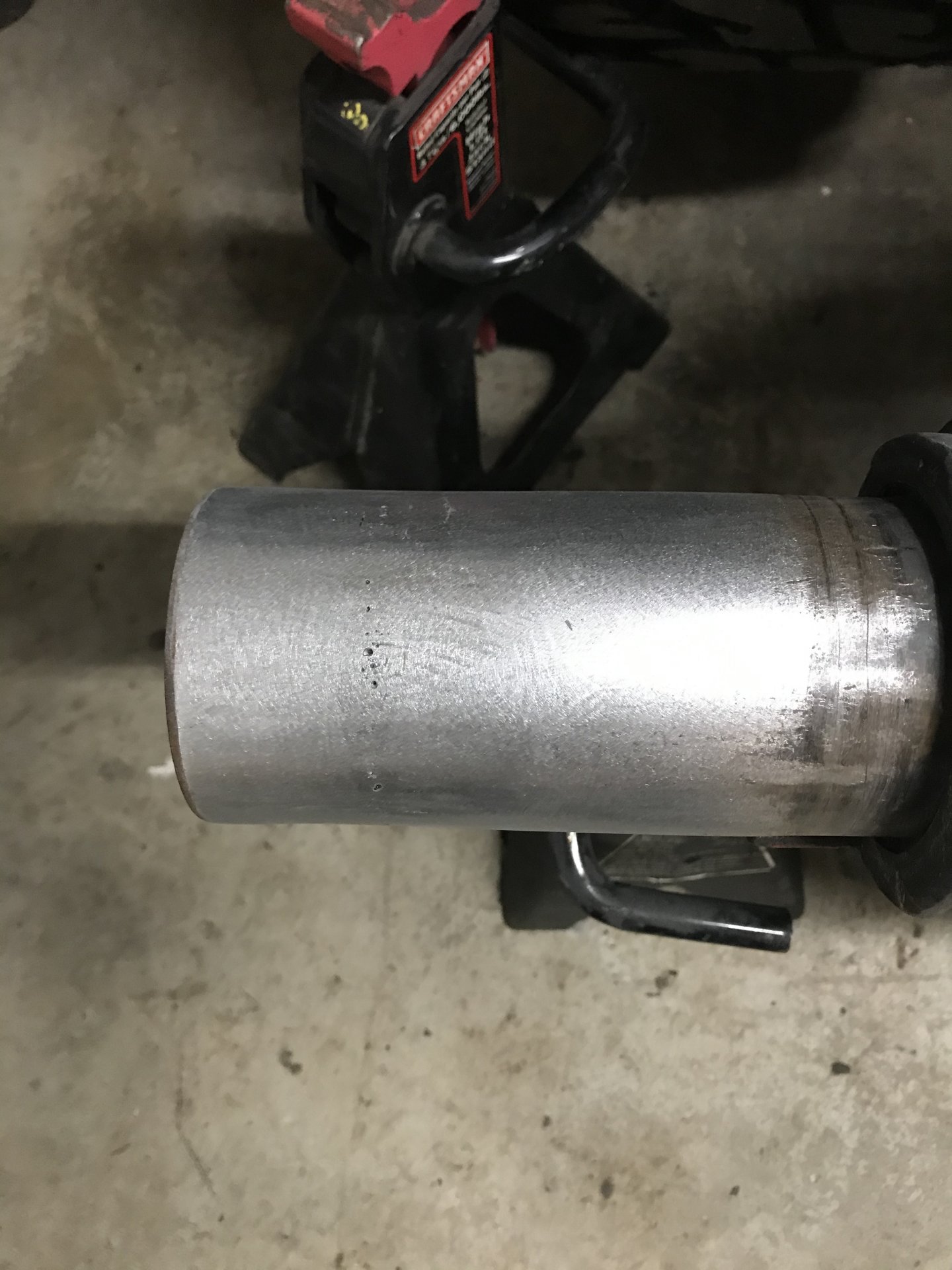

A few questions, why did you cut the inner c? it comes off without cutting it. Also looks like you have cut the tube on the inside and out. You need to fill those back in and grind them down so it does not create a weak spot.

The inner C was stuck. I tried to wrap the tube in an ice cold towel while heating up the C and it would not budge so I decided to replace them. The notches in the tube are from the original weld after the grinding was over. I’m not sure what happened there. It’s possible that I hit it with the plasma and it filled back in with hot metal, appearing to be weld. I will fix that today.

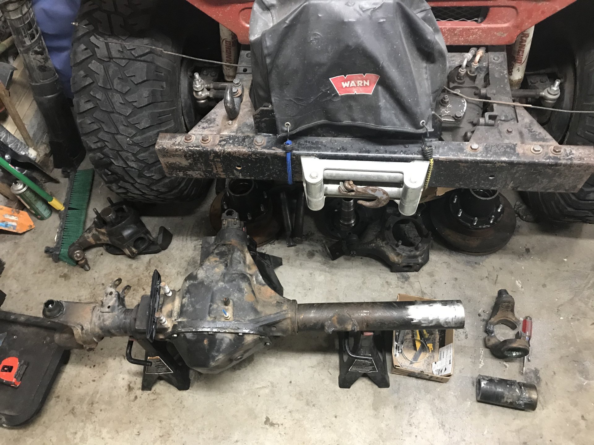

I have the right side to remove today. Any other tips would be greatly appreciated, @matzell
Use a chop saw or angle grinder with cutting disc and cut tube at C. Then use a sawzall and cut a slice in tube inside C the press out. This way you save the C.
Great tips, Bob. I see what you are talking about now. The through and through cut was part of the tube that I was removing so I was trying to alleviate pressure so that I could save the C.

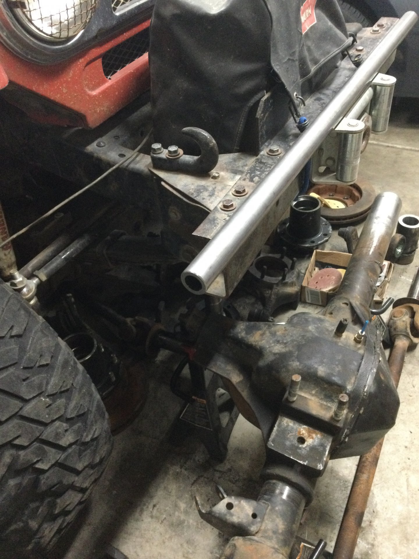

I decided to go with Reid inner Cs in the middle of the project so I went a little crazy with the cutting. The right side was even harder to remove and I was being extra careful because I am not shortening that side. All is well and I am ready to press the new Cs on.
heat the C on a grill and it will slide right on. check first as is looks like you sanded down the tube. It should be a press fit. weld the side with the exposed tube only.
