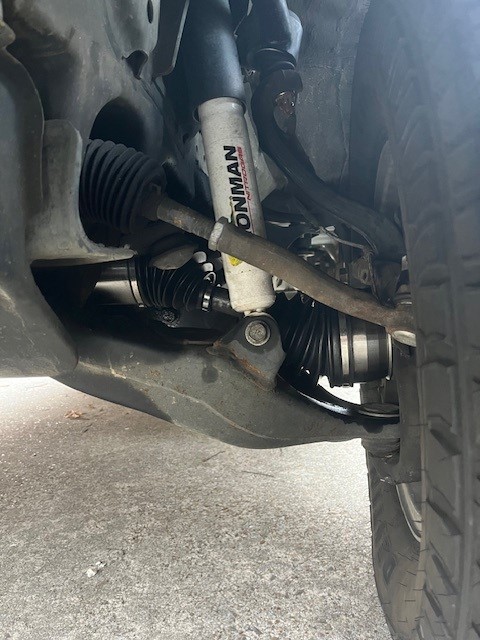

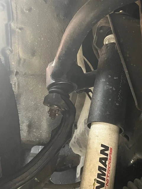

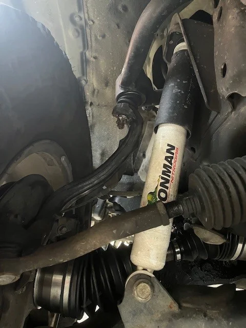

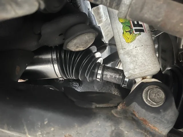

Out of blue heard some louder clunking sound come from front end , mainly only when under power.
Took to local shop and they were confident CV axles. Replaced for $600 and now similar sound, but quieter still there making me believe it was something else.
Including some pics as thought the angles into upper control arms looked extreme.
Looking online possibly lower control arms / ball joint issue? Before taking to another shop thought would run knowledgeable crew here.

Yes came with the Ironman kit. Been on for over a year no issues. Still the CV angles looked extreme to me, but my knowledge is limited .
The Stage 2 kit comes with a front differential drop kit to help correct front driveline angle reducing CV wear, and includes all brackets, spacers and fasteners. This is a 100% bolt-on solution with no welding or drilling required.
