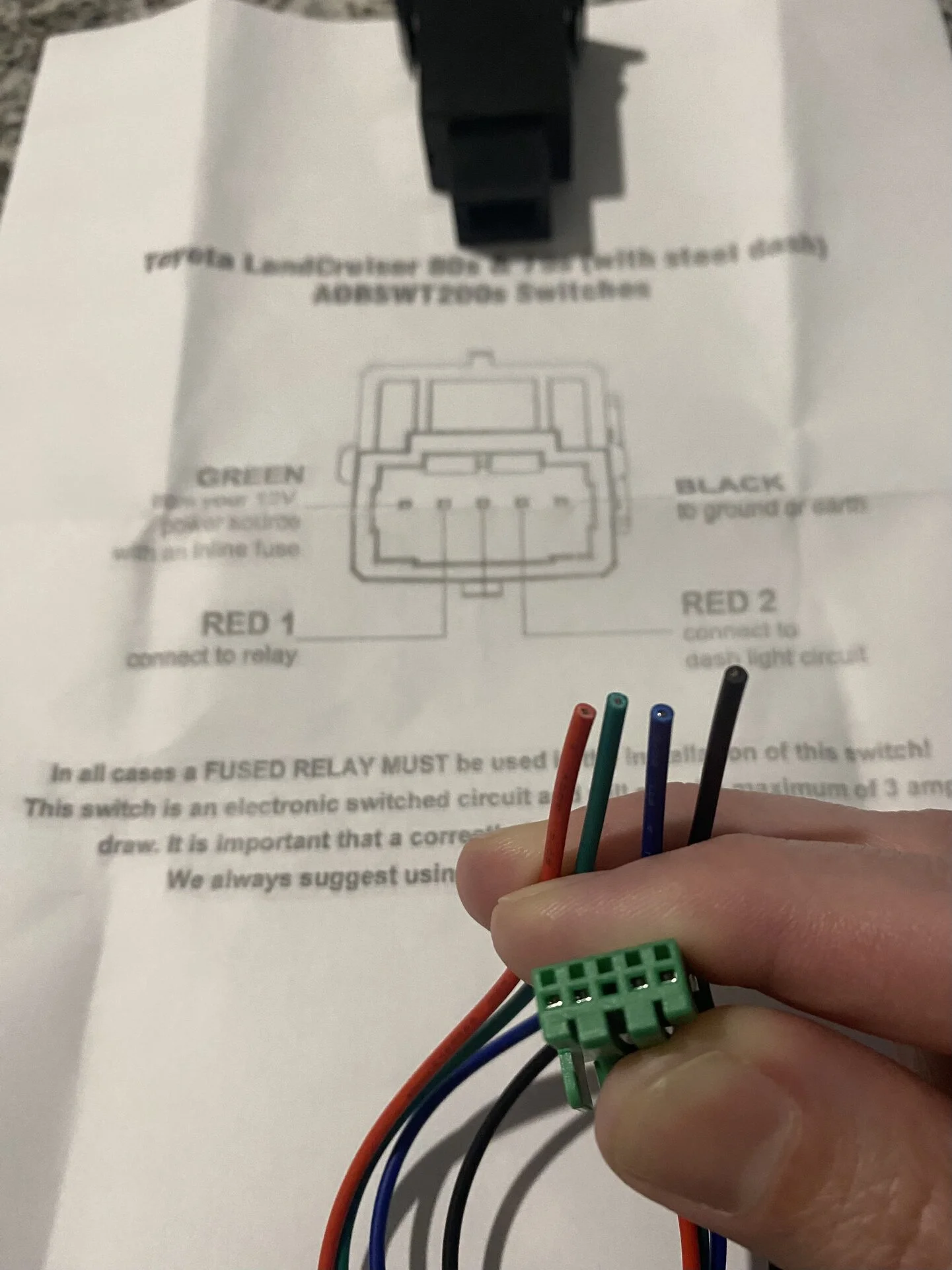

This is what i have. Red/green/blue/black
I emailed aob because their instructions do not match the pigtail supplied. Their response,
“red power in from fuse box
green power out to activate the relay
blue is for dash lights (optional)
black to ground”
Still leaves me wondering where to connect the blue wire.
If I am thinking correctly, the blue wire will illuminate the switch in question. If there is another switch near by that illuminates when the headlights are on I would try and find that switches source of power during illumination and run the blue wire off that wire. Hopefully that makes sense.
Digging deeper, how do i get the switch backlight to act/dim along with the remaining interior lights?
Seems if i just connect to the green 12v going in to the rheostat, the new switch backlight will just be on with no adjustment??
Correct, but the switch more than likely has an LED backlight. It won't dim like the rest of the dash lights and might just switch off instead, hence solid green.
Good read, would solve your backlight issues.

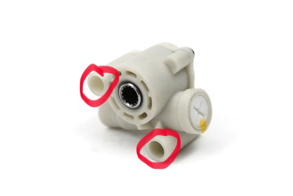

Today I discovered when i went to rebuild the seat gears with gamiviti plastic replacements that someone has already been in there and replaced the gears with brass style. Both my seats work but they pulsate when moving forward and backwards (reason I wanted to rebuild).
So, because the brass gears are one solid piece and they looked in good shape I cleaned everything up and re-greased everything before reinstalling. Well, both seats still pulsate.
Any ideas on this one folks??
Mostly fixed the issue. Its about 99% smooth as butter now.
I believe i had the 5mm allen bolts too tight. They are now just snug and things have smoothed out.
Its these bolts.
