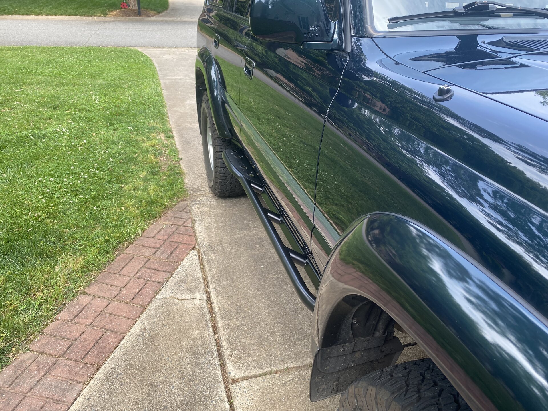

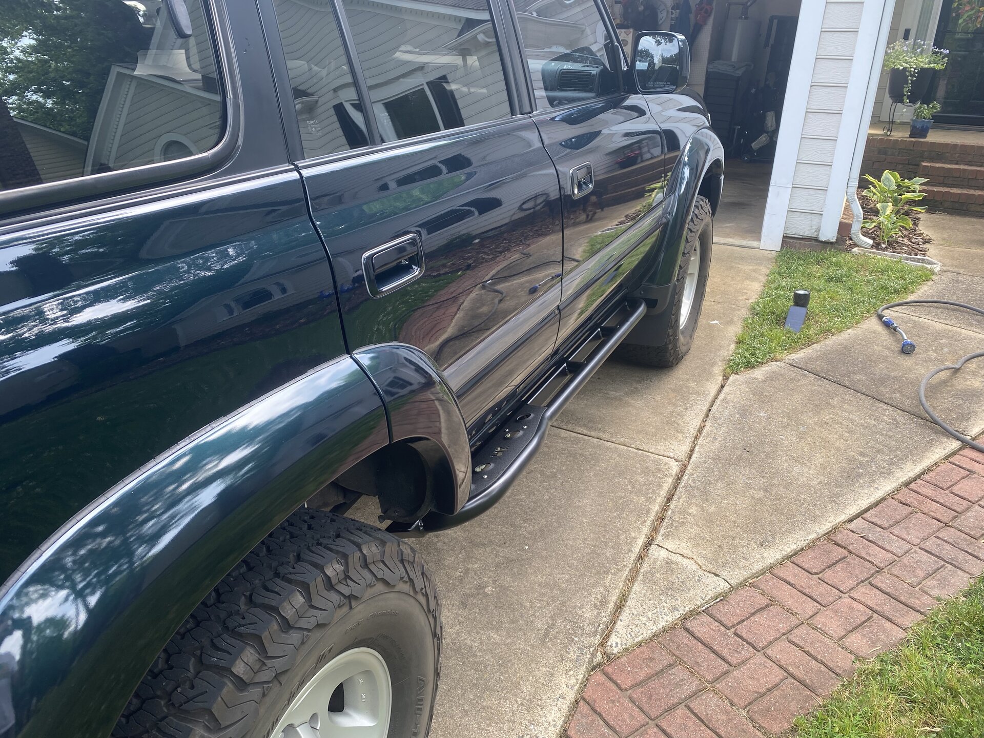

White knuckle sliders fit like a dream. These are the full length 20 degree version.
The powder coat leaves a bit to desire. I had been spoiled by the crazy good powder coat shrockworks offers.
