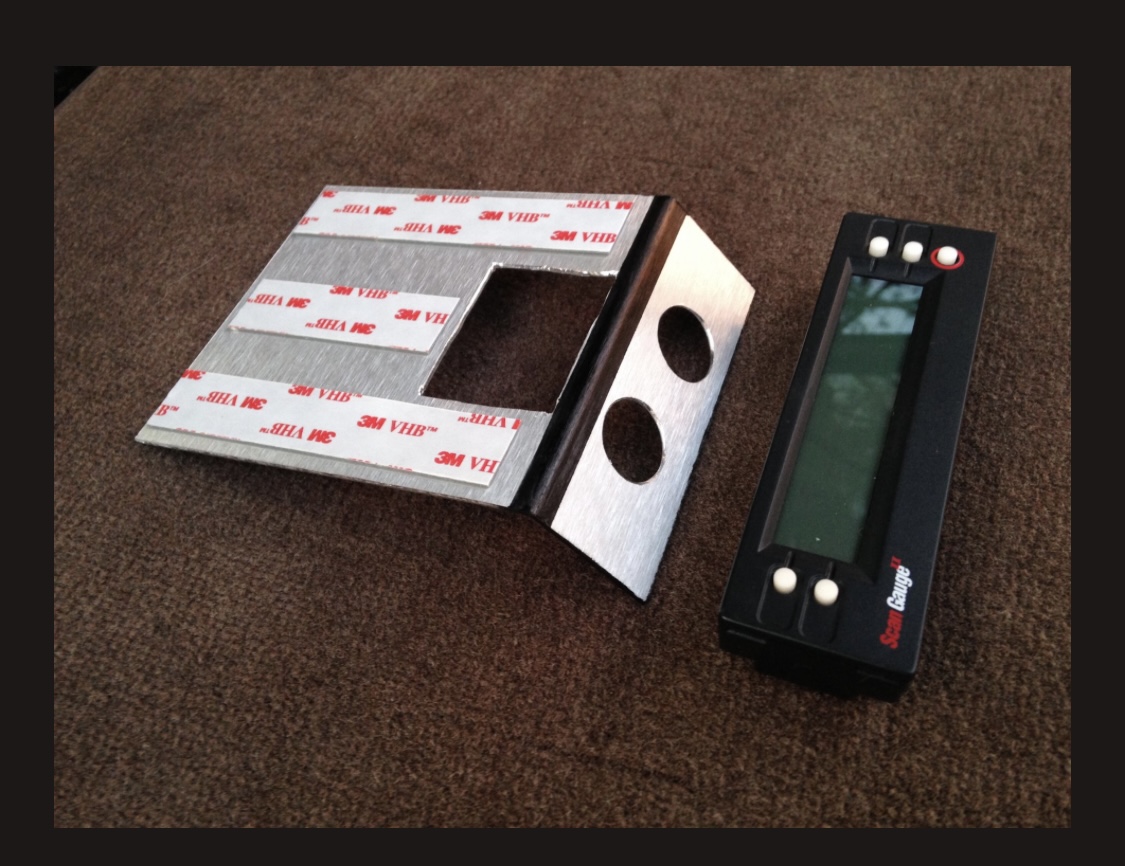

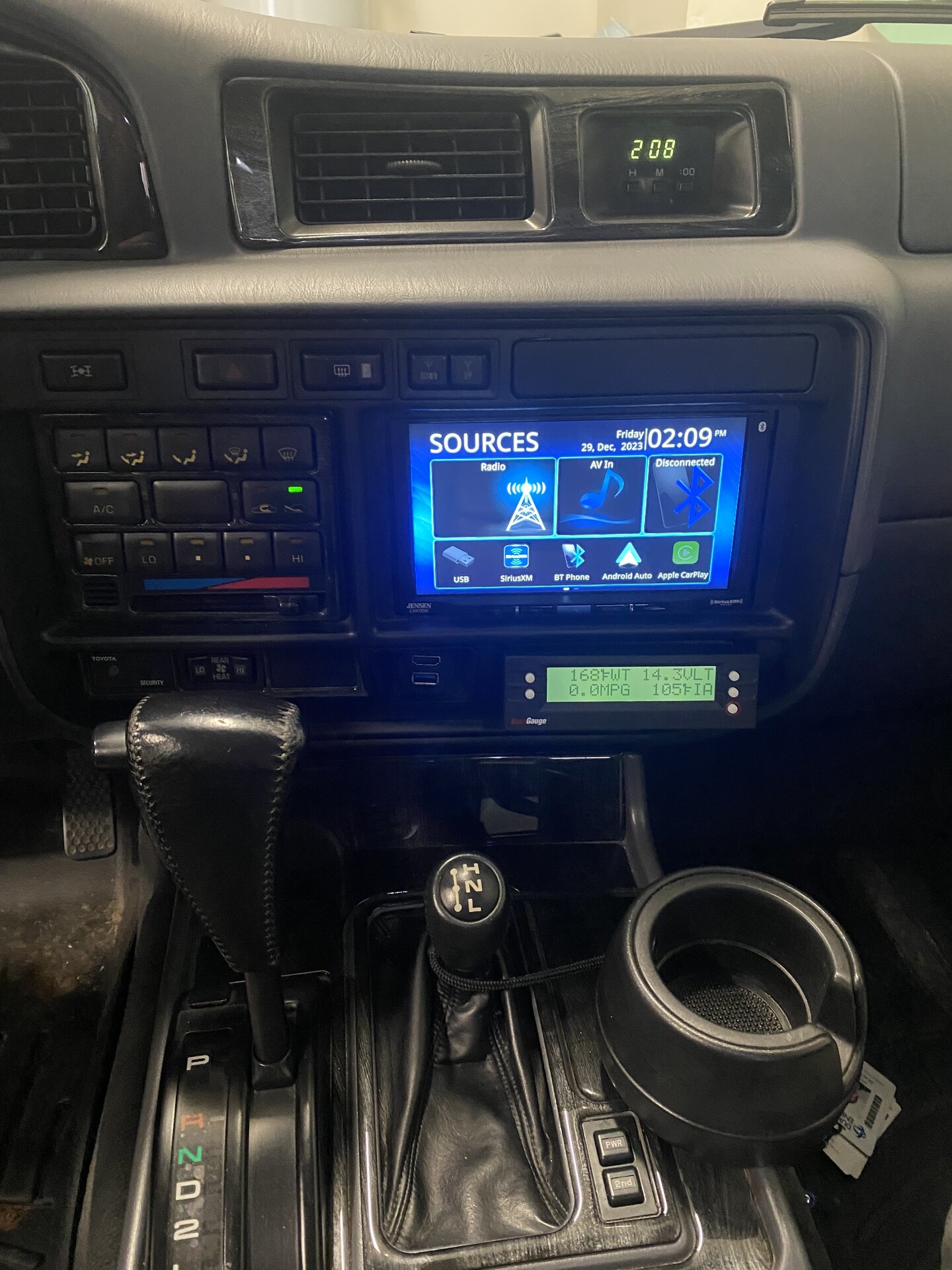

Christmas has been installed. Nice little gadget. Had one for many years in my 2005 tacoma and I’m sure I’ll like it in this vehicle.
The awesome part about mounting the scan gauge here is I now have console mood lighting like the modern Toyotas because of the way I cut the bracket.
Copied this design.
Oh for sure. That was with the headlights off in my dim garage. When the headlights turn on it dims very well and there is lots of adjustment to set it to your preferences.

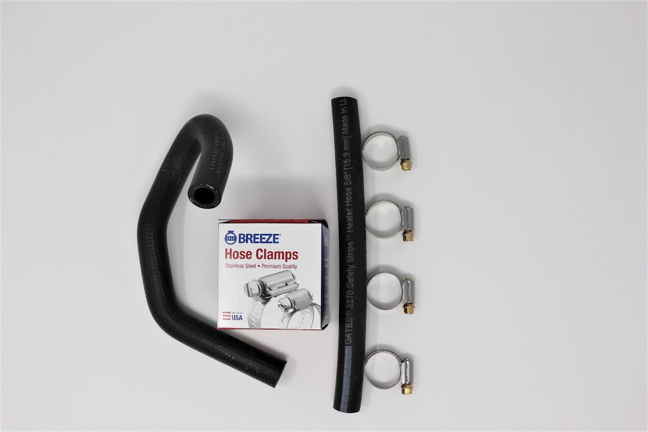

Also ordered the LCP rear heater bypass kit. My steel lines are not healthy looking on the firewall. This will be more piece of mind and is much easier to handle while the valve cover and throttle body are removed.
I’m not thrilled about blocking the rear heat but it seems to be the best method right now to not worry about the hard lines giving out. I may bypass the firewall hard lines with some soft line to keep the rear heater.
LCP rear heater delete

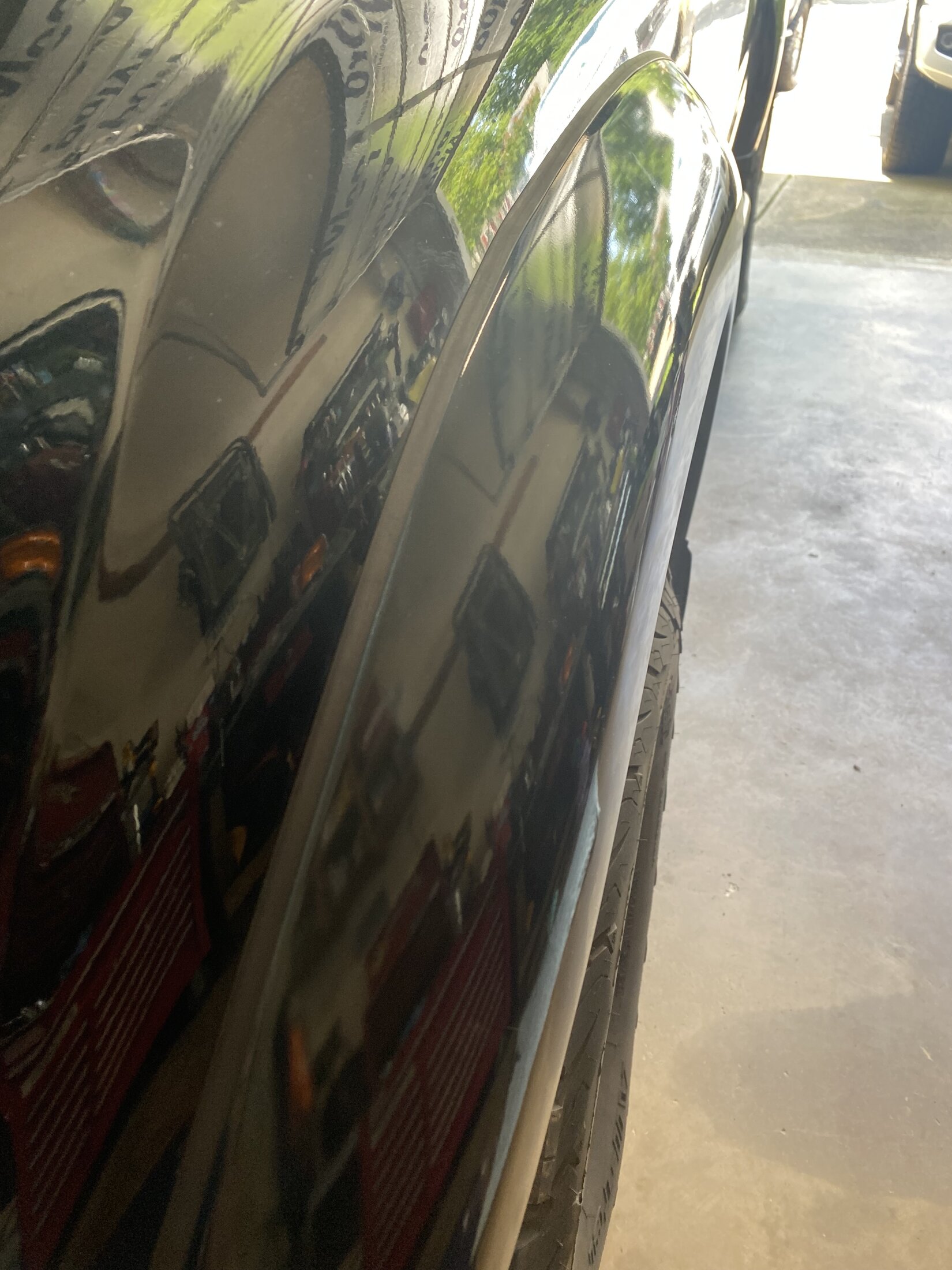

-Fender flair seals on all for corners
-Extended brake lines and LSPV.

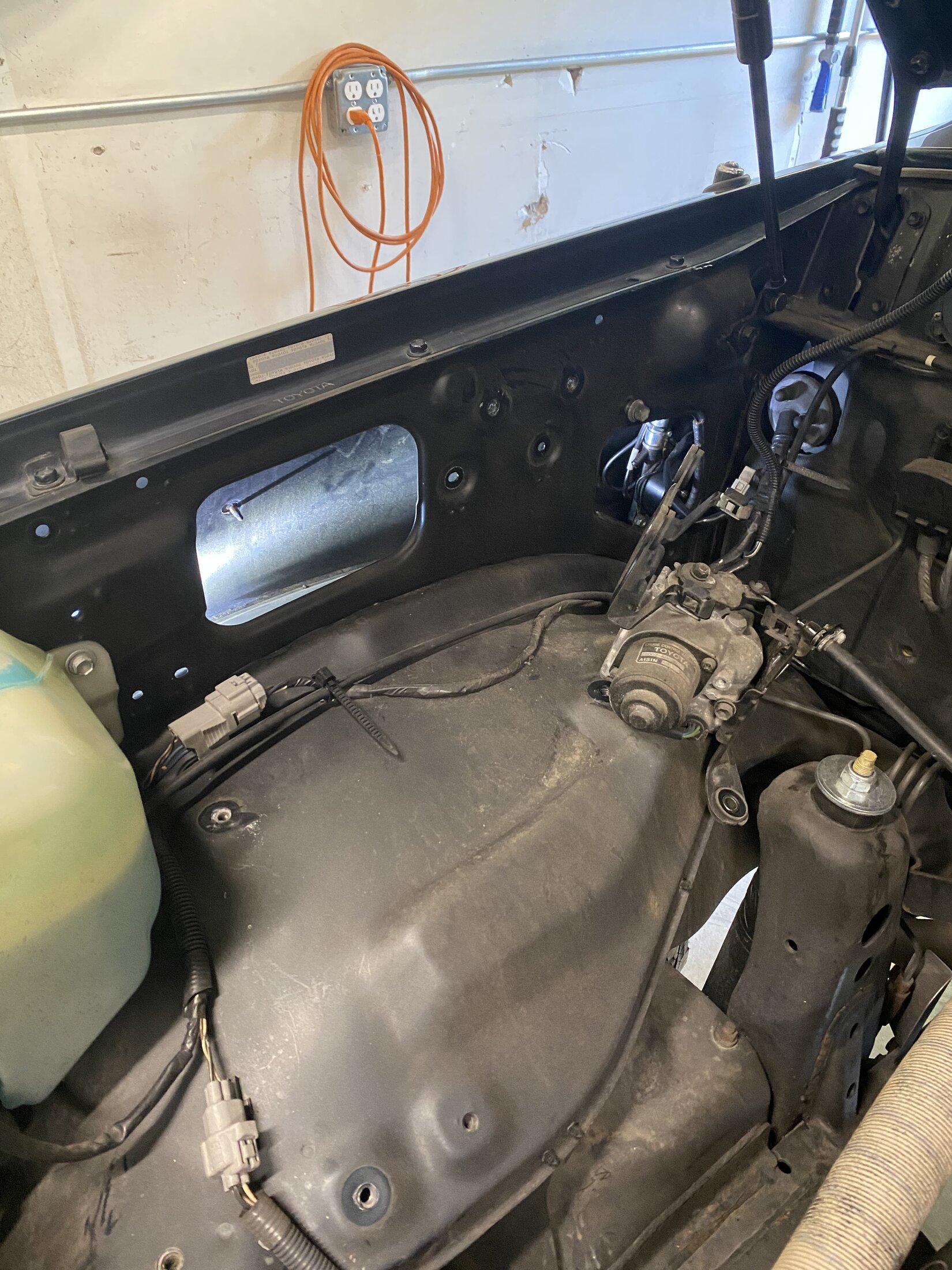

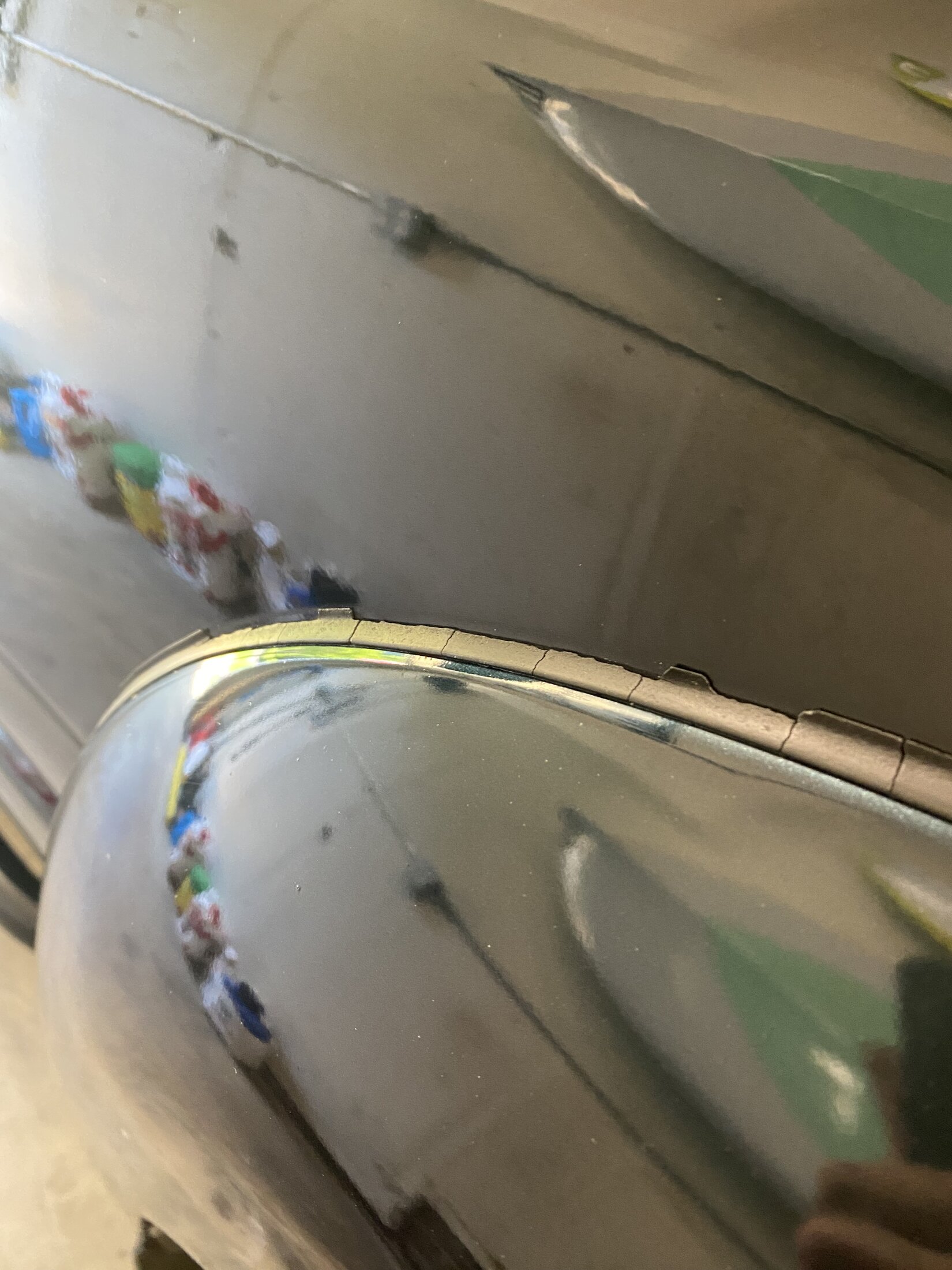

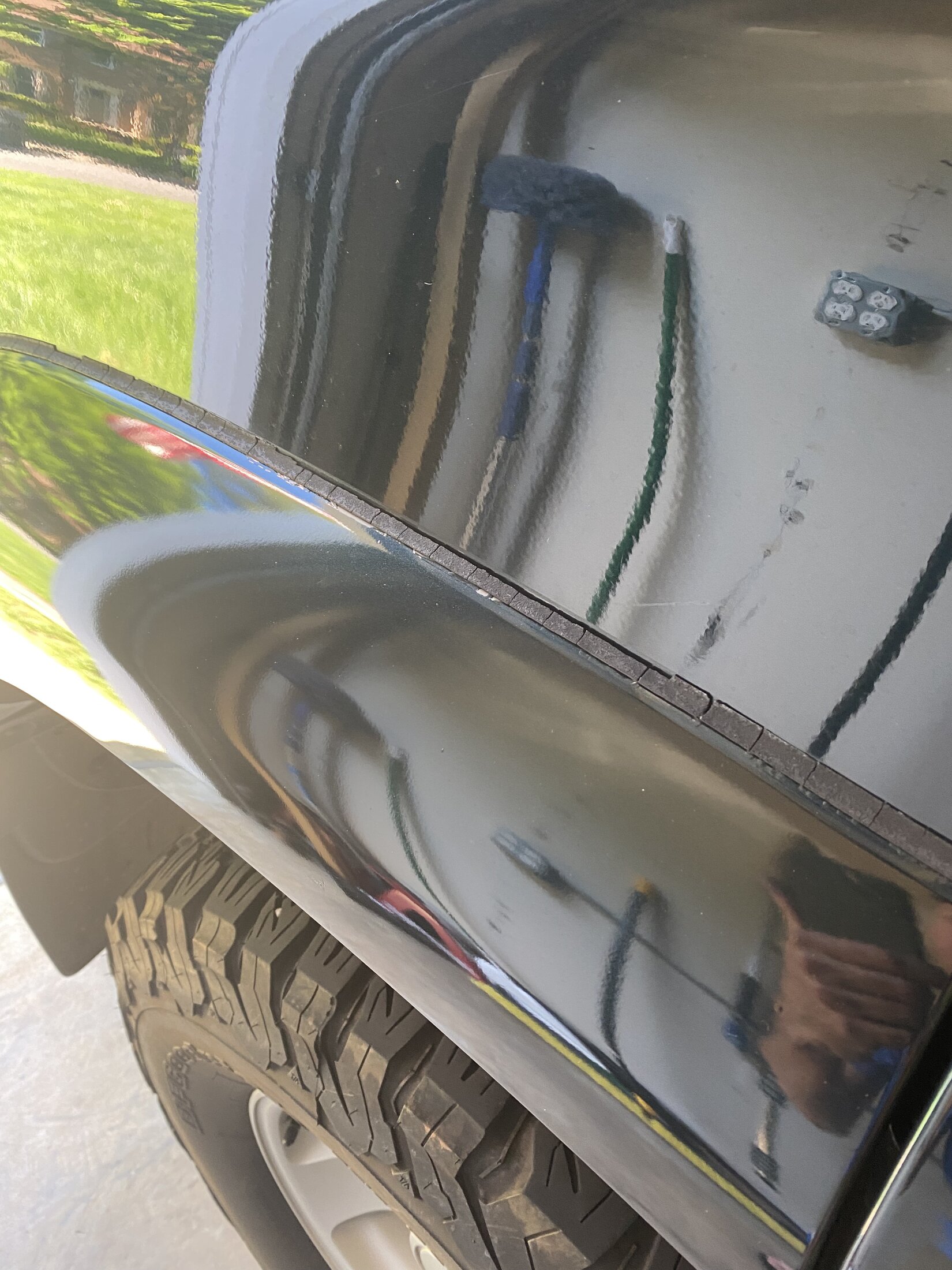

Flare seal repair is underway. I’m fighting two of the flared nuts that are corroded and will not let loose. Got one with the dremel but the last one of course is the bolt at the lower back of the front passenger side. It’s going to be a nightmare to get at with the dremel but it must be done, tomorrow.
Any ideas for that last bolt would be greatly appreciated
I did look at that option but it looks like there is a nice seal between the fender and fender well along the fender arch. The panels are so nice on this one I don’t want to break that seal.
Success. I got to the flare nut with the dremel by removing the air box and inner fender snorkel. The flexible dremel extension was very helpful.
I’ll get it all cleaned up and then back together when the new flare bolts show up.
Well I’m glad that’s done. What I thought was going to be a 4hr project turned into many hours to do it to my level of correct. Cleaning the old goop off was a bear.
The last picture is how I had to repair the stripped flare bolt. JB weld did the trick perfectly. :/
Overall the new seals came out near perfect.
