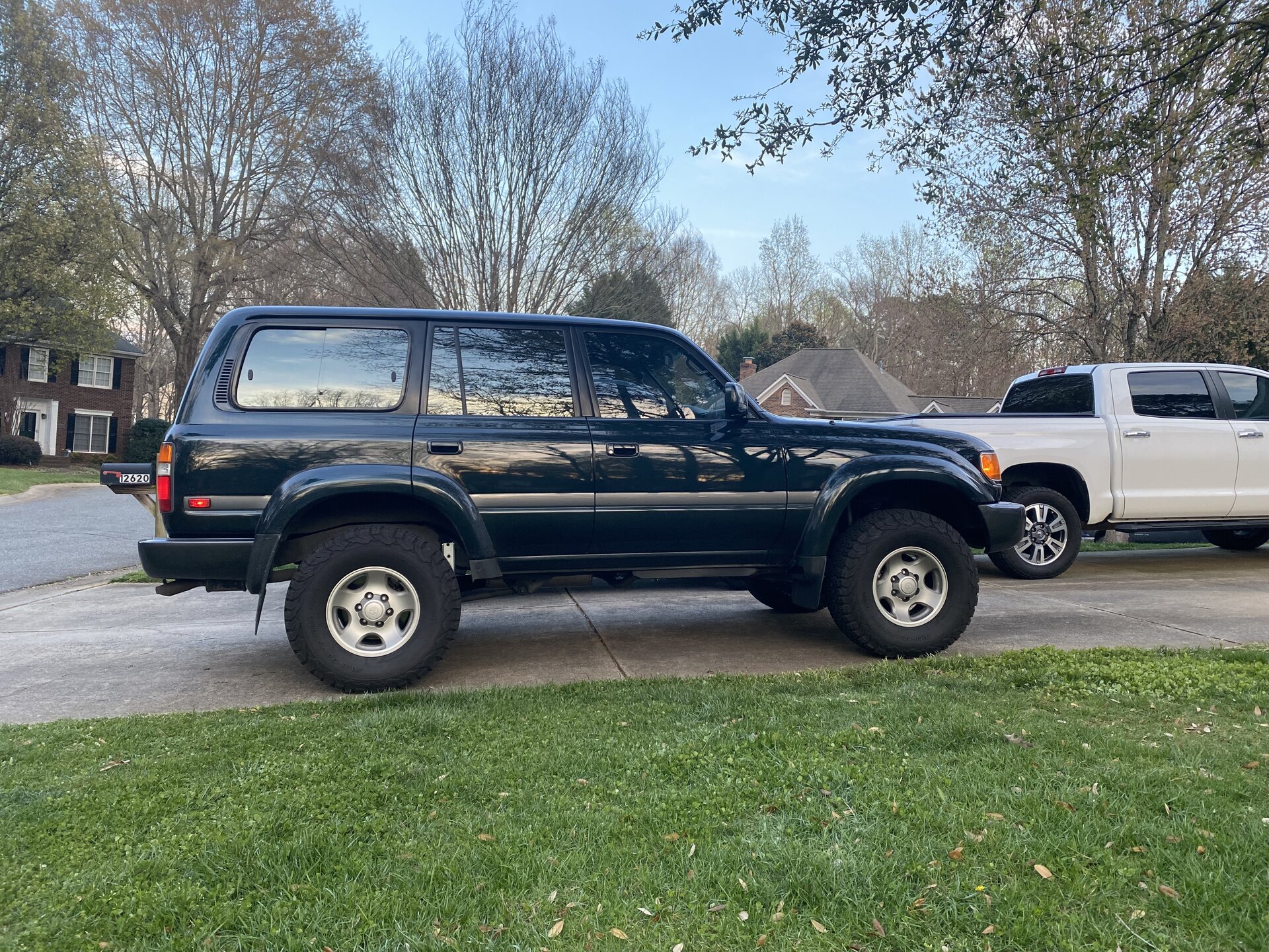

Lift is on. New power steering pump is in. Next up is all the engine seals know for leaking.
OME 850 front 860 rear springs. Slee caster plates, front/rear sway bar drop. Delta rear panhard correction.
That grey stripe is painted on mine. My paint code was originally 2AC (dark green with moon glow bottom). My flares were repainted at some point and they just matched the bottom to the top leaving the belt line moon glow color. I like it…
Good luck finding it without the "FOUR WHEEL DRIVE" letters. If you do, let me know where you got it.
Doubt I will. My 40th side cladding is bowing and deforming. I may opt for the overseas variant.

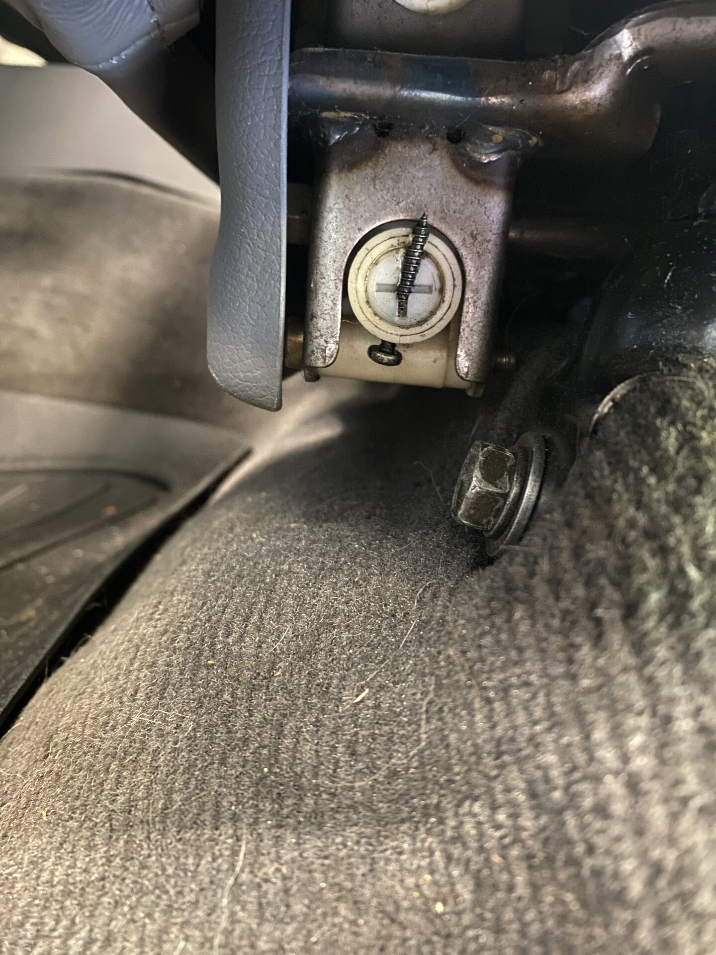

My seats work but are jumpy like the gears are worn. As I look to see if the caps are missing i find this bull****….
Lets see how that affects replacing the worn parts. I’ll be replacing with the gamiviti kit and solve function cap guards.
My seats work but are jumpy like the gears are worn. As I look to see if the caps are missing i find this bulls***….
Well, to be honest, there is a thread that talks about inserting a screw between the cap and the housing, but they are tiny, like a #4 screw about 5/16" long.
That's a bit overkill or misinterpretation of the directions.
It’s laughable really. All will be ok. I didn’t know there was a screw fix thread.
