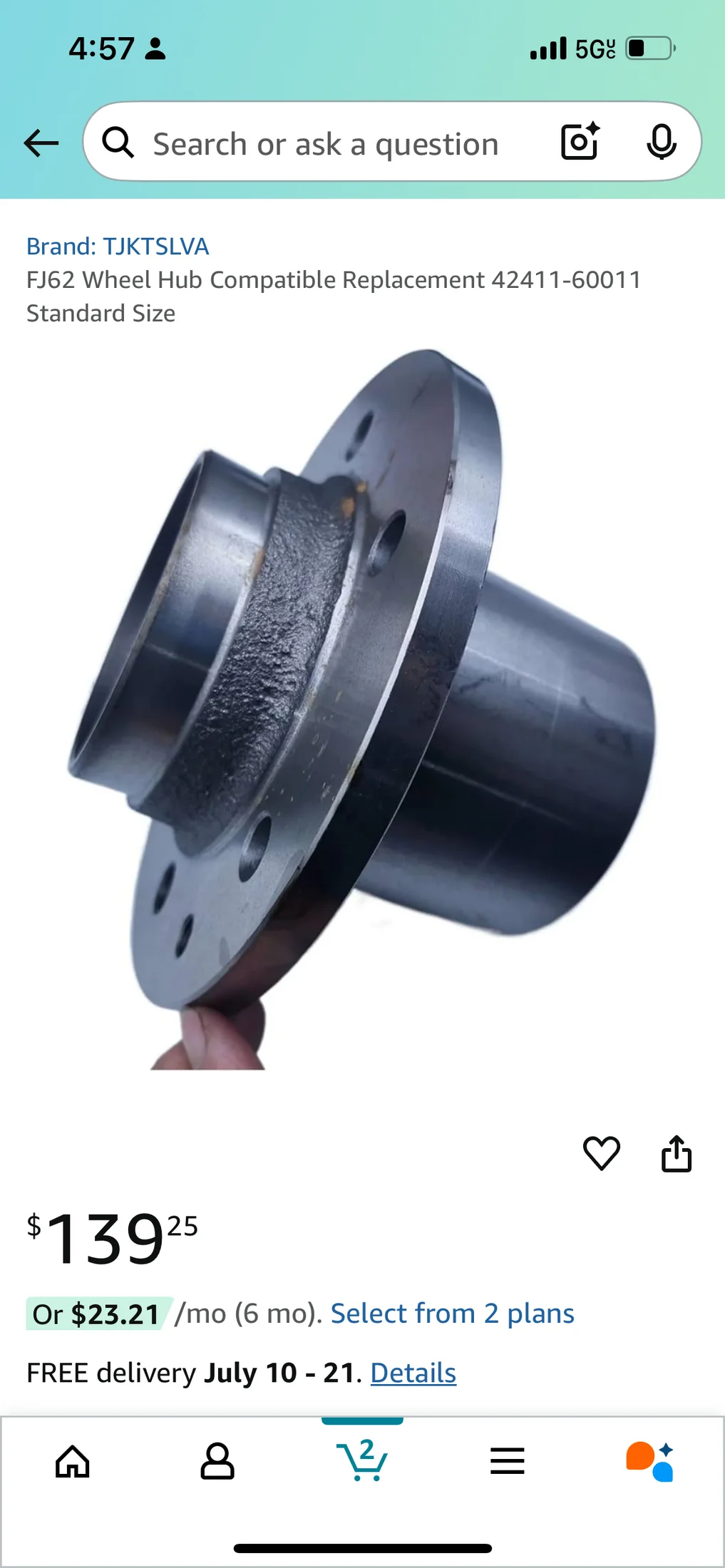

I recently bought a 1979FJ 45 out of Saudi Arabia. It’s got a number of basket case issues one of which is the rear hub leaking. On further investigation it looks like one of the studs became stuck and they tried getting it out with a grinder so the mating surface is not flat and I also have a crooked wheel stud on one of my other hubs upfront.
Looks like the OEM and even Japanese aftermarket rear hubs are unobtainable. Cruiser outfitters sells a higher quality Japanese made version but it’s out of stock with no idea if/when it will be restocked.
The only place I’ve been able to find a *potential* Japanese made hub is on Amayama but they tend to say they have parts available when they really don’t and I’m awaiting confirmation from them.
What’s everybody else using? I’m hesitant to use an Amazon/Chinese version. I have OEM bearings and seals and would use OEM wheel studs, but I’m concerned with the fit/finish and metal quality of Chinese products.

Yeah, I called but the gentleman I spoke to said it didn’t know if it would be coming back in stock. After scouring the Internet and finding every source essentially out of stock/discontinued it’s starting to look a little grim. I’d hate to put a Chinese hub on so I might just weld this a little more and try to grind it flat and re-tap.
